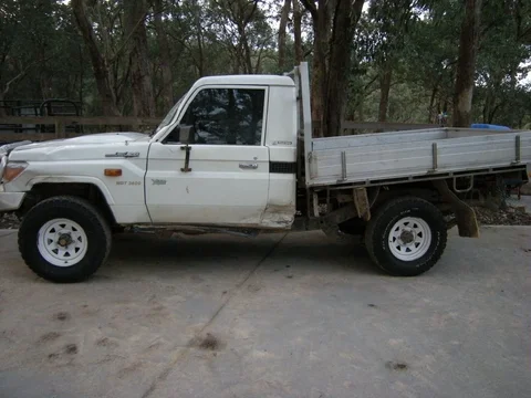

Here's my donor vehicle for box and motor. The banana as it had been involved in some bad accideent and there isn't one panel there without some damage. The motor starts and runs fine as well as the gearbox.
