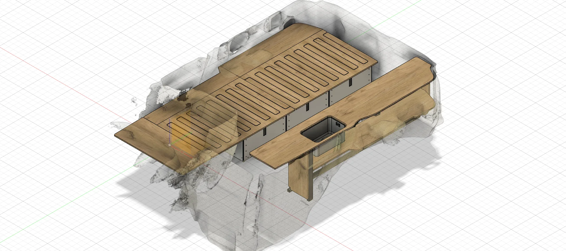

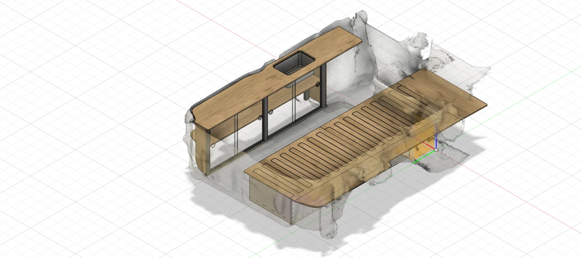

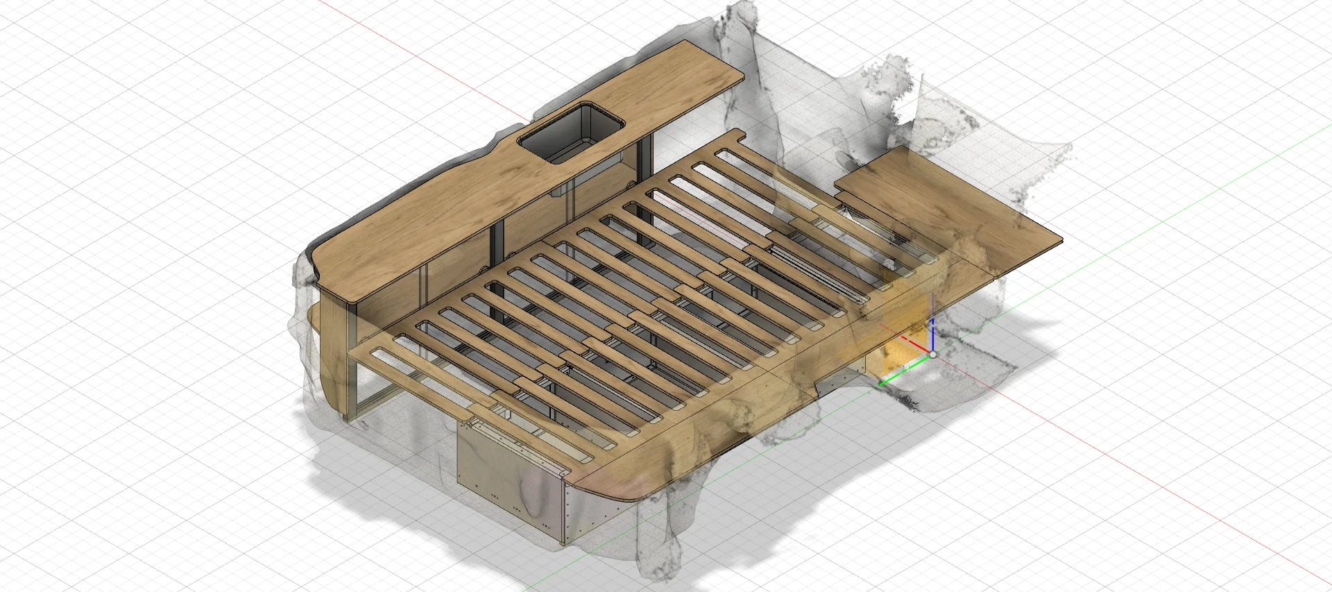

I've started with removal all plastic trims, carpet, etc. and 3D-scanning the interior with my Wifey's iPad. The precision of this method isn't great but it works fine for basic design.
After 2 weeks and several ok-let's-start-from-scratch iterations (and several different build technics) I came up with this.

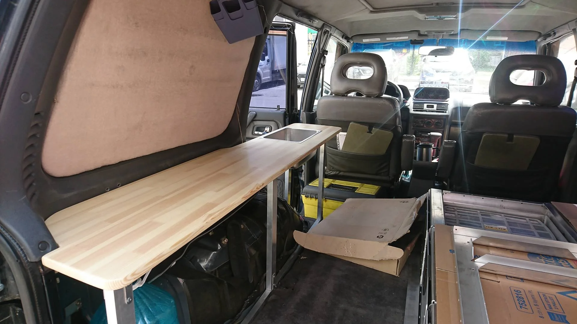

Left-hand side of the vehicle is occupied by let's say... a kitchen module with sliding doors and a sink. Kitchen module has a frame structure made of rectangular aluminum tubes from Leroy Merlin interconnected by steel brackets and stainless steel rivets. I cut tubes by myself using a custom made chop saw. A countertop I cut out from a sheet of solid pine furniture board with a jigsaw, rounded edges using sandpaper and, varnished it with Tikkurila acrylic matte varnish. Sliding doors are made of 3 mm (3/32") plywood varnished with the same Tikkurila varnish. I cut out doors by myself since they are just rectangles. Other parts I've ordered to be manufactured from 10 mm (3/8") plywood. A local company milled all parts using CNC milling machine by my blueprints and varnished them with matte polyurethane varnish. To be honest... I wouldn't be able to do this job better using my cheap jigsaw :)

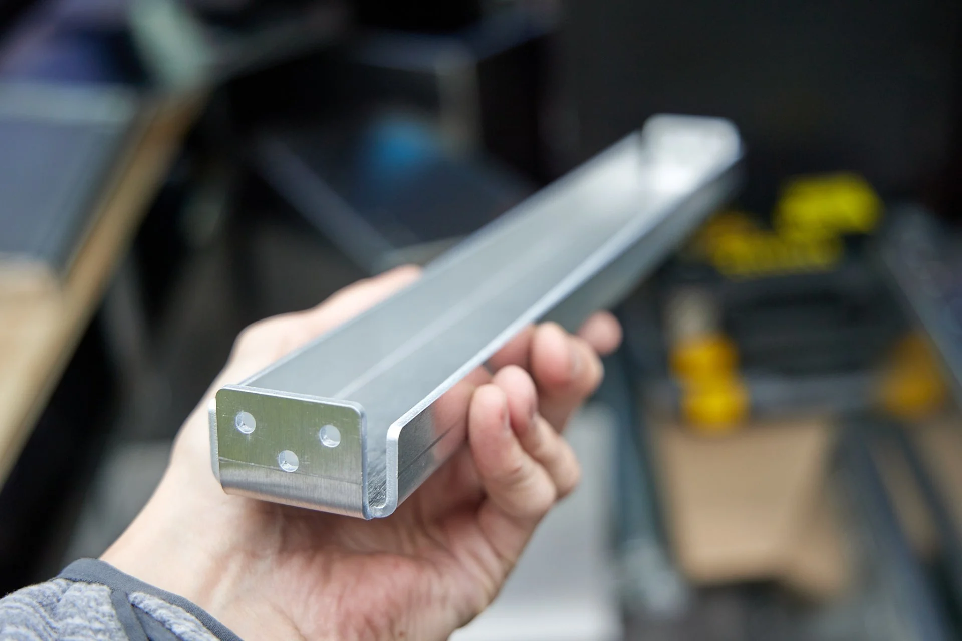

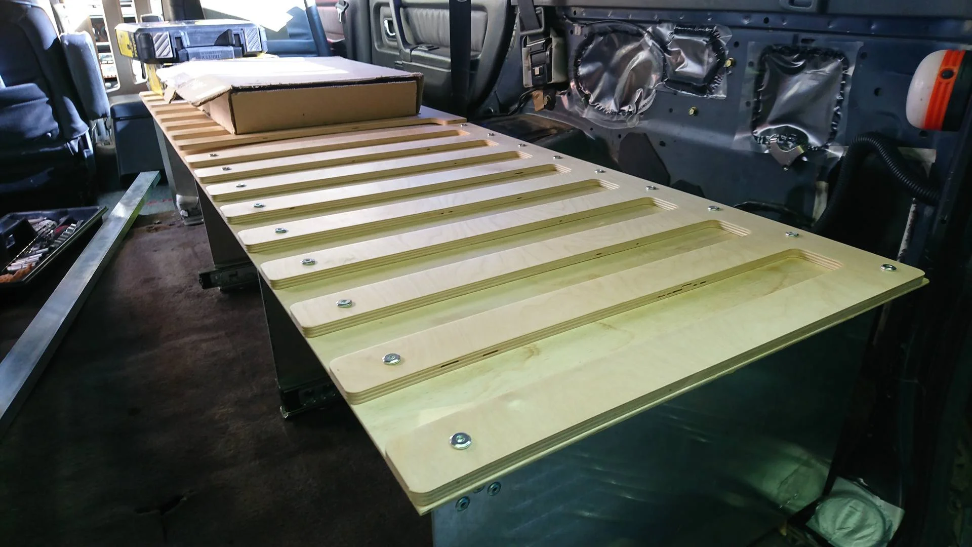

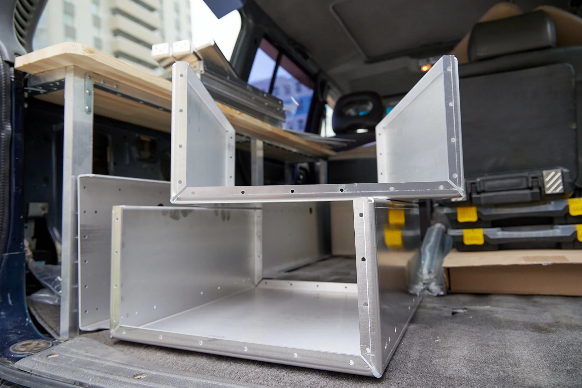

Right-hand side is a place to sleep - extendable bed a top of a drawer system. The drawer system is made of 3 mm (3/32") laser cut and bent aluminum alloy АМг3М (AA 5154) sheets. It took 1 week to find a local company who can do the job and they did it perfectly! It was a thrilling moment when I got all the parts which I'd seen before only on a screen of my laptop. All parts of the drawer system are connected with stainless steel rivets and bolts (where were impossible to put a rivet). The bed made of 10 mm (3/8") plywood by the same company which made kitchen parts.

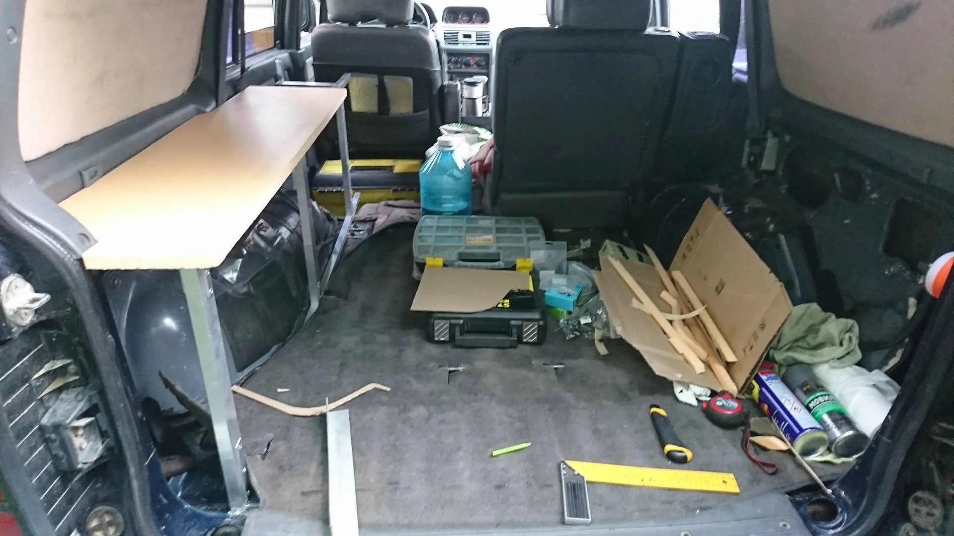

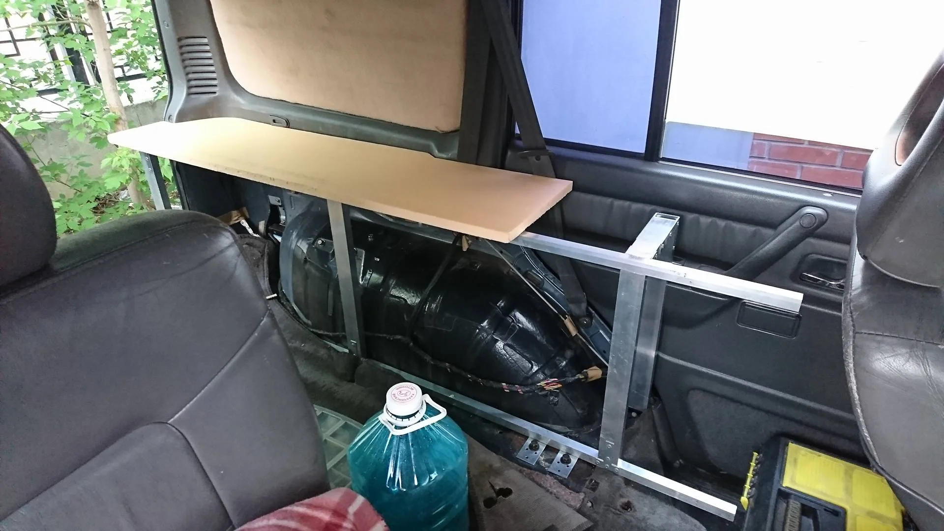

I've bought rectangular tubes and made a kitchen frame. I cut a model of a countertop out of foamed insulation material.
I think this parts was done in 2 days. The most difficult part was to make brackets which align with existing mounting holes in a body.

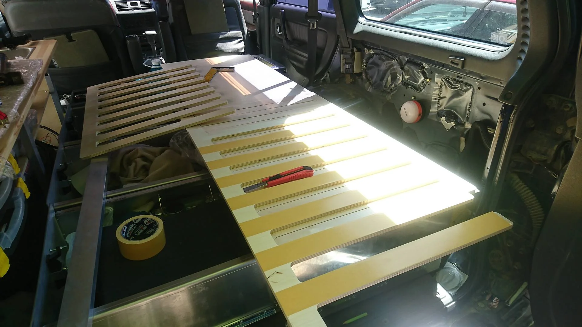

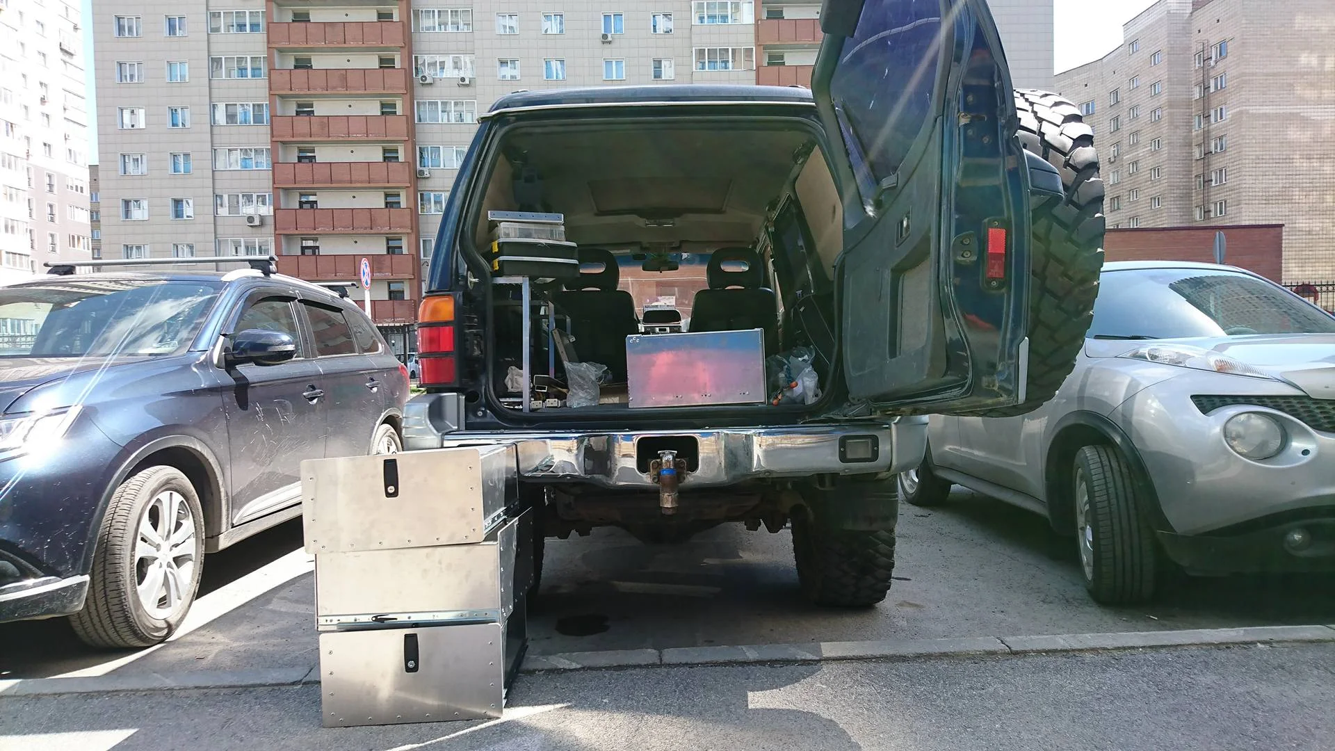

Then I got parts for the drawer system...
They look so much better then what I'd made for the kitchen module :)

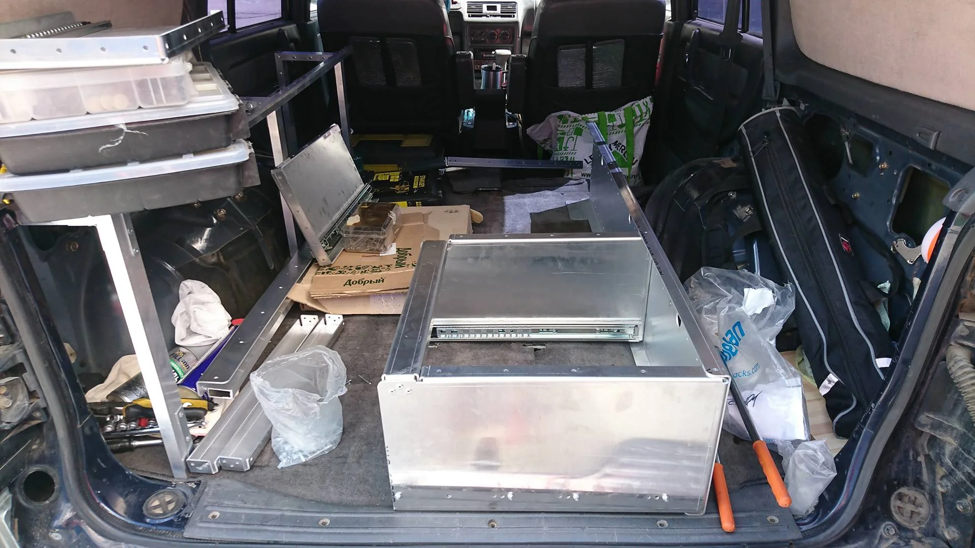

I assembled the drawer system in 3 hours on a parking lot next to my apartment building (in comparison with 2 days I spent to build a kitchen module frame).
I bought cheap Chinese full extension sliders for drawers. They work fine and last long. Really impressed with the quality.

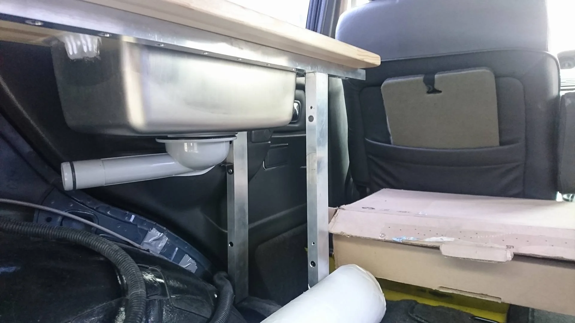

When all riveting was done I switched to the kitchen module. I put a sink in place.

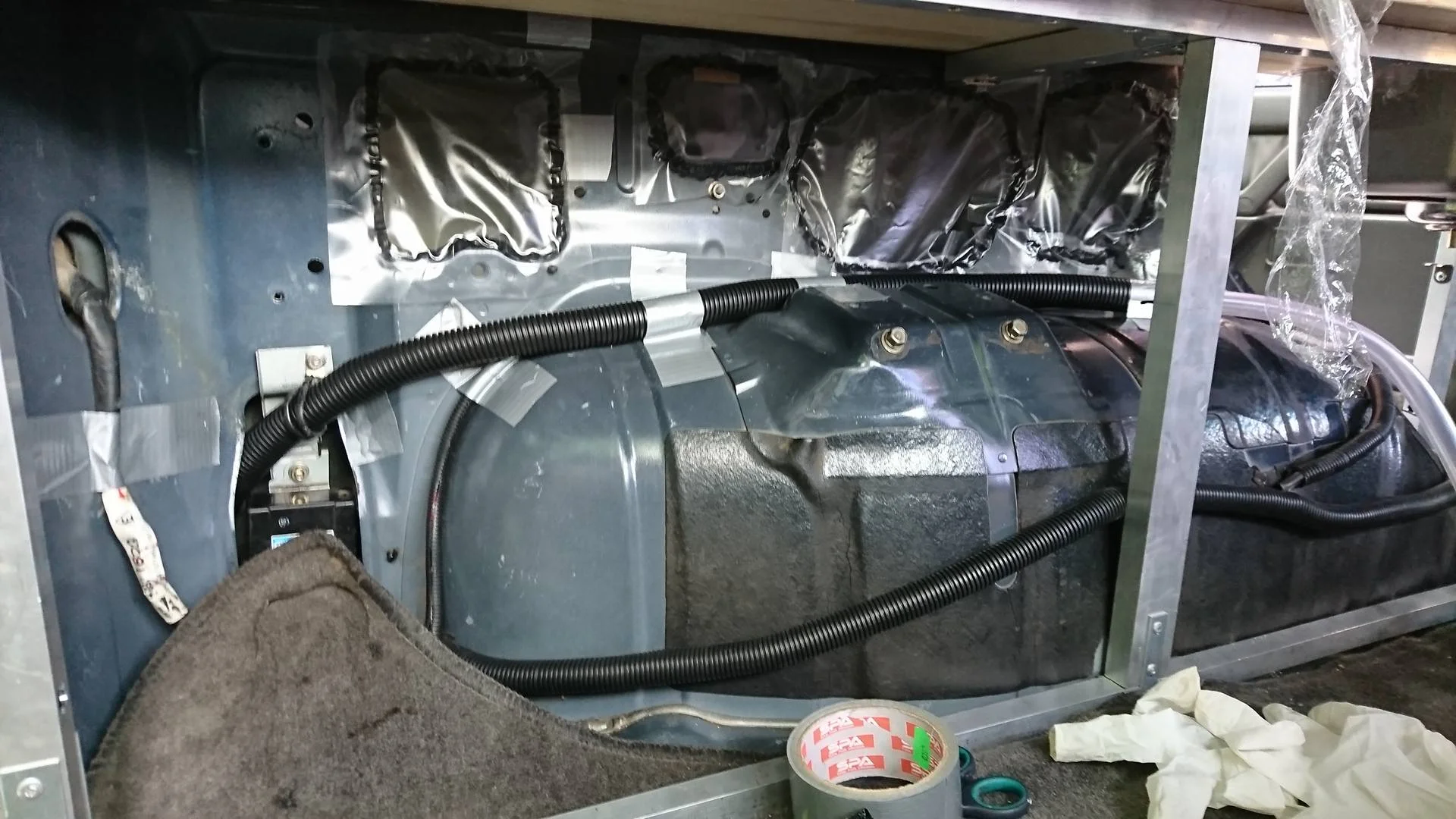

And did all the piping work.
A pipe from the sink goes into D pillar and connects with a sunroof drain there.

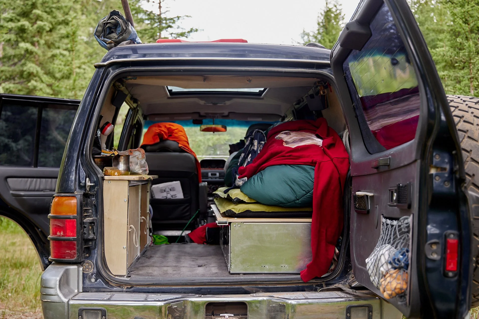

I think I'll skip some boring steps here... so we went to the mountains.
So that how it looks right now.
We have a running water on board :) I put a mixer here to be able to use it inside and outside. When a rear right door is open a sink is easily accessible.

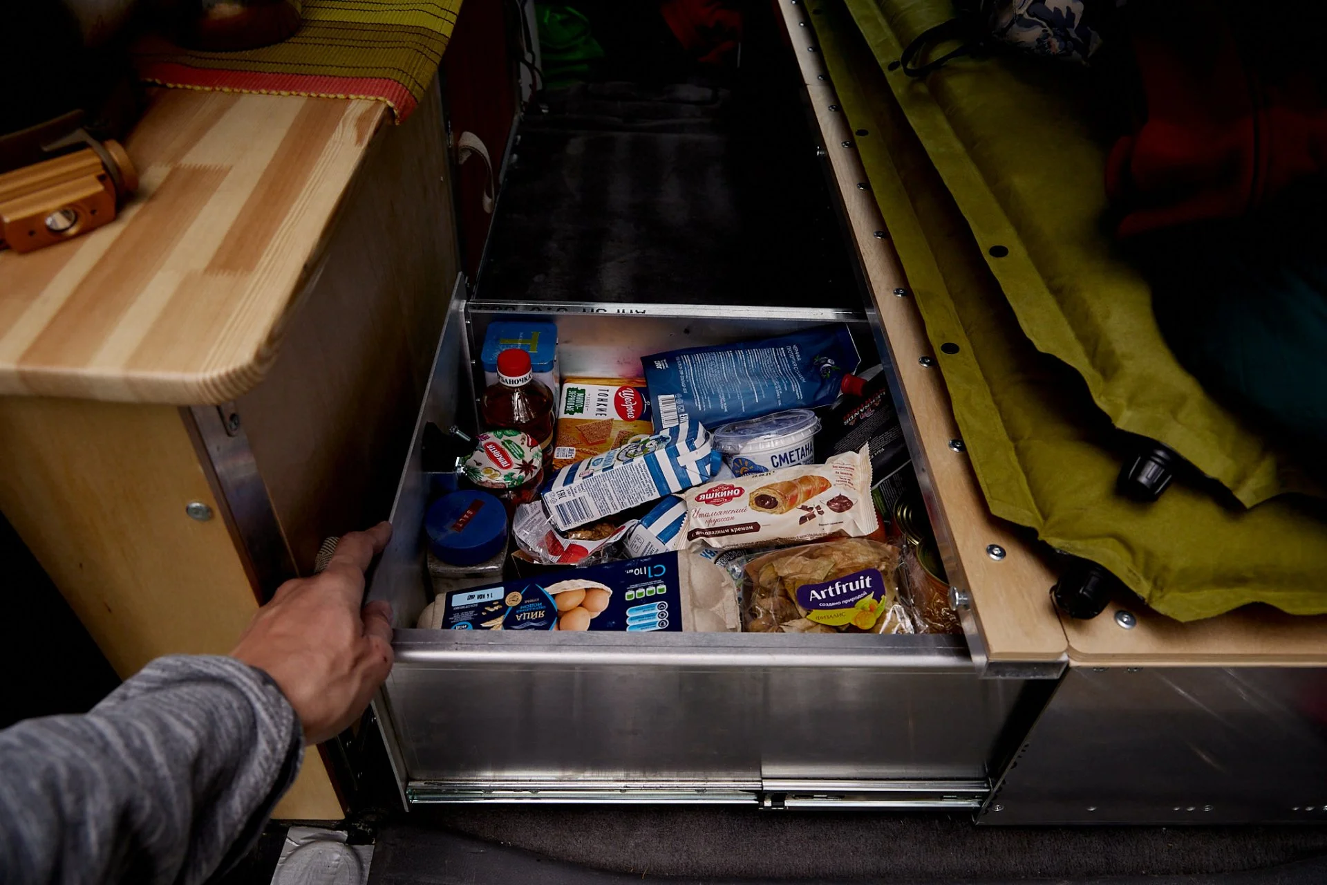

Drawers. The on thing I was really impressed that it's really cold inside these drawers. It was June and it was really hot outside... and milk and water was cool all day long.

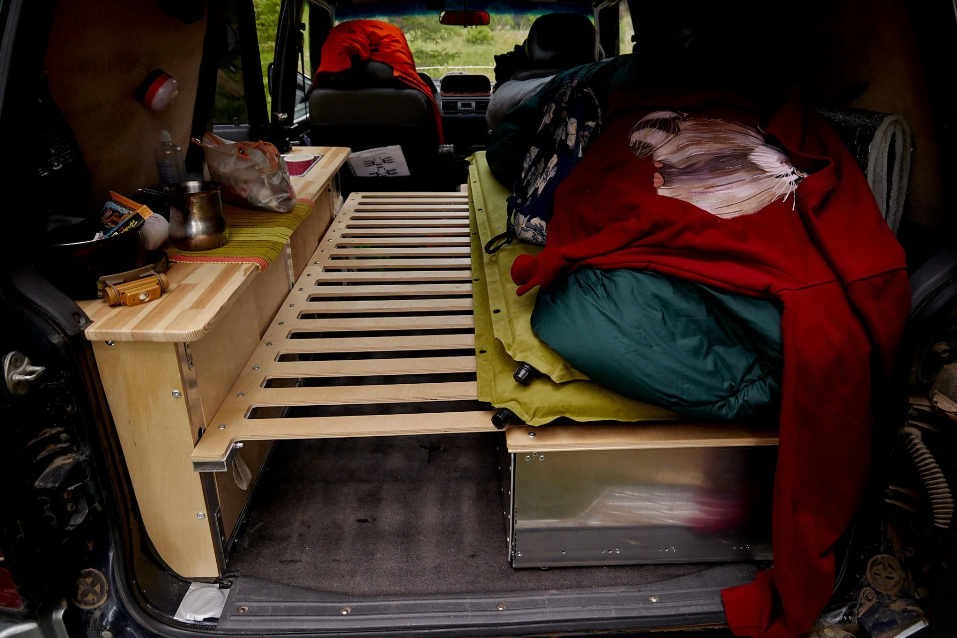

Bed using the kitchen module as a support when extended.
I like the sliding platform design. Haven't seen that one used before but I like it.
Thanks mate :) I've got the idea from some Sprinter build I'd seen on youtube. I was afraid that it will rattle on gravel roads and offroad, since it is not secured when folded. But it doesn't make a sound and stays in place pretty well.

Wow, good job. Great use of the space your have to work with. The storage and drawer system really makes me rethink the way you use the space in the rear. Love the extending bed idea for two and the drawer system is a great idea. My 80 exhaust would cook that down low but there are always to insulate it better. Is that just a drawer with ice or a working refrigerator?
I think my command of Russian would be just enough to start a bar fight... :rofl:
:beer::rofl:
It's just a drawer. It was kinda surprising for me... since the drawer is just a metal box and on Montero exhaust pipe goes right underneath the drawers... our last summer trips shows that everything inside these drawers is pretty cool. I was expecting everything to be at least warm...
I was thinking about a fridge... I've decided to try a small one which goes between front seats. But it'll be done later... I wanna install second battery and a solar panel.

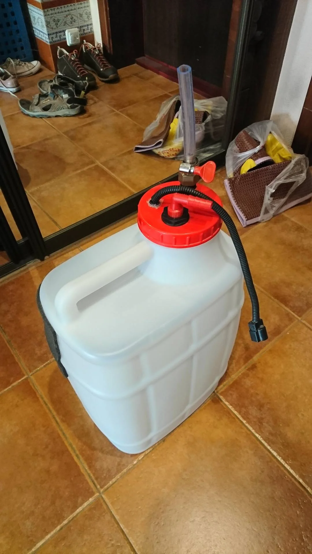

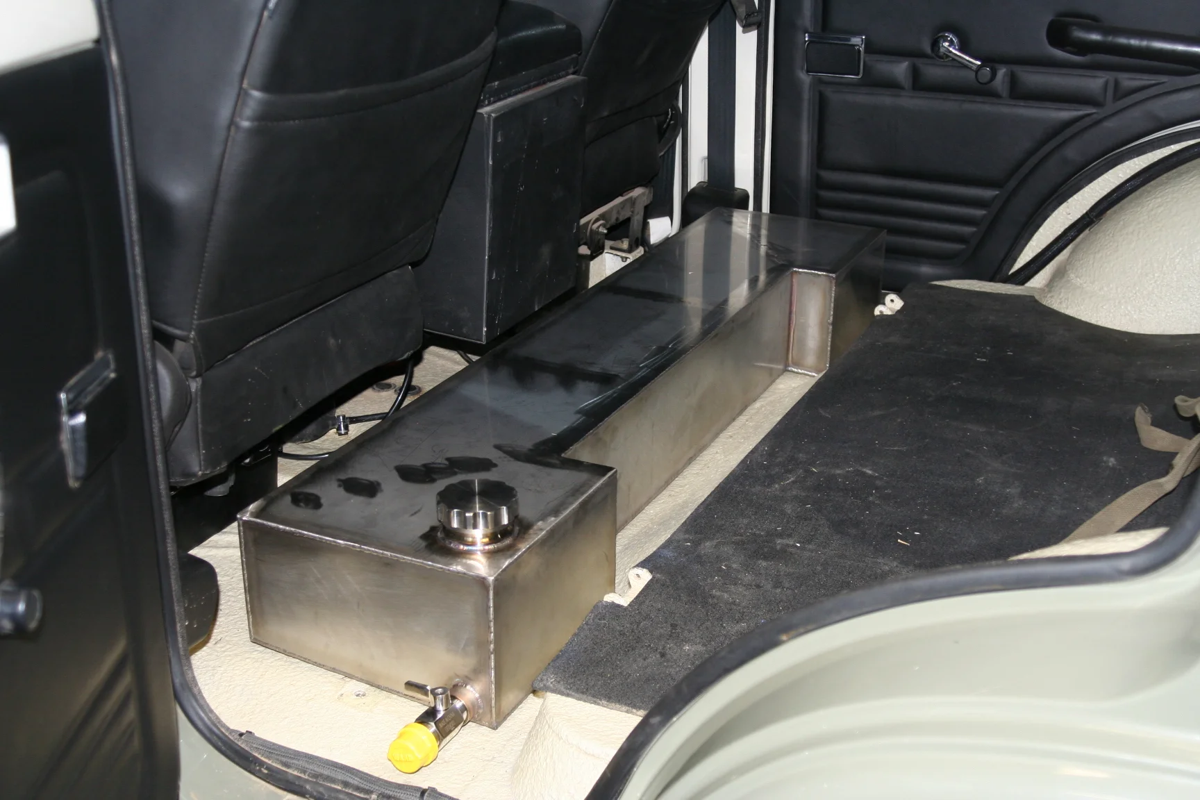

Good Job! Did you remove the rear seats or just fold down. With the rear seats removed you would have space for a water tank, etc.
I removed the rear seats completely :) I put a water tank right behind the driver' seat between the seat and the kitchen module. For now it's just a 30 liters (8 gals) vertical plastic canister. I drilled few holes in a cap and installed a pump inside. I couldn't find a horizontal rectangular tank which fits behind the front seats. In local shops all tanks are much bigger (made for real campers) like 70-100 liters (20-25 gals). Maybe later I'll make a custom tank... dunno, a canister works fine though, it's dirt-cheap and easy to replace if broken.
