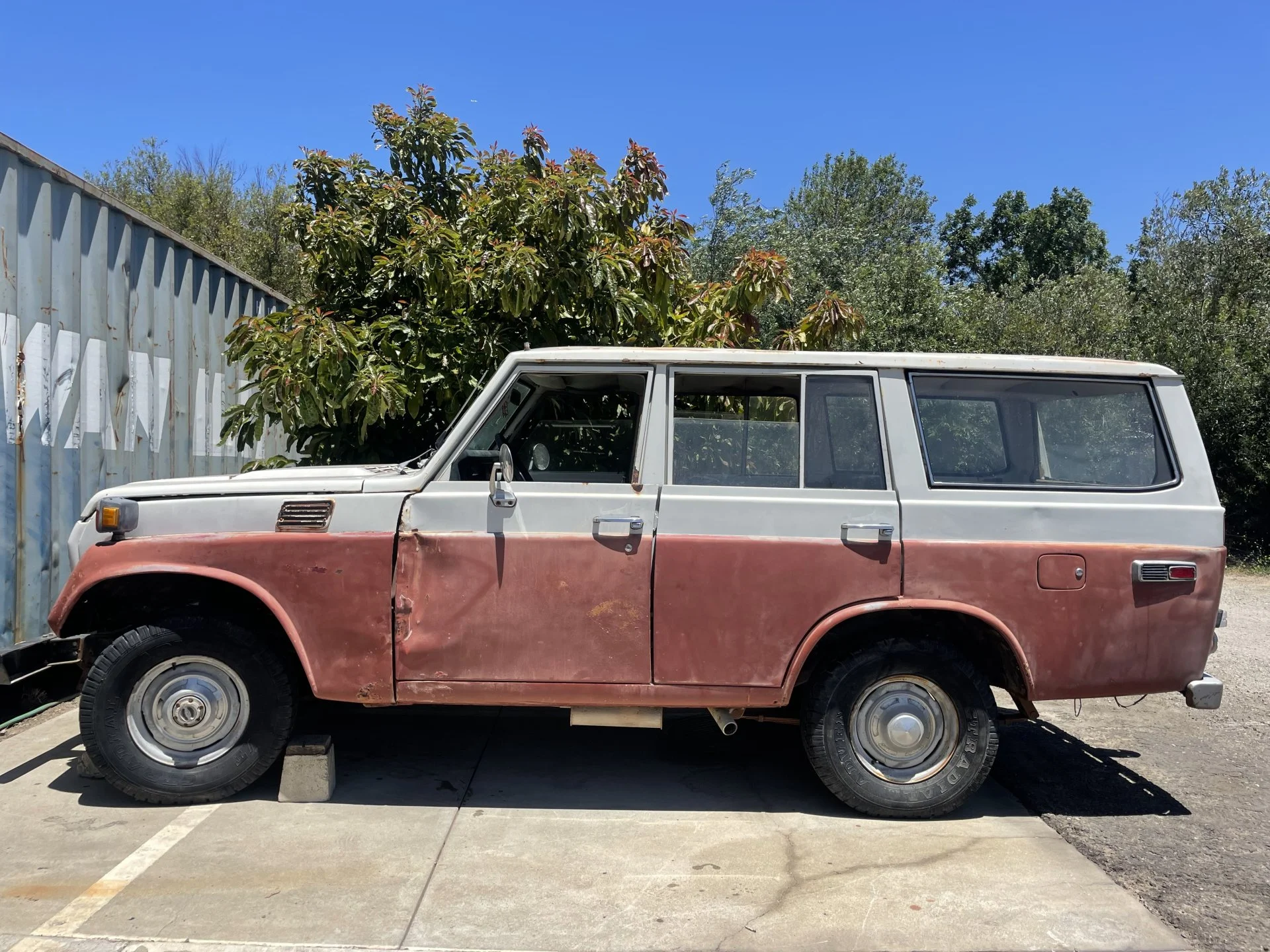

Recently obtained this 1975 FJ55 locally here on the Central Coast of California. Previous owner stated it had sat for 6 years, however most recent Oregon registration tag was 2011 so who really knows... They moved down from PNW and brought this toy along with.

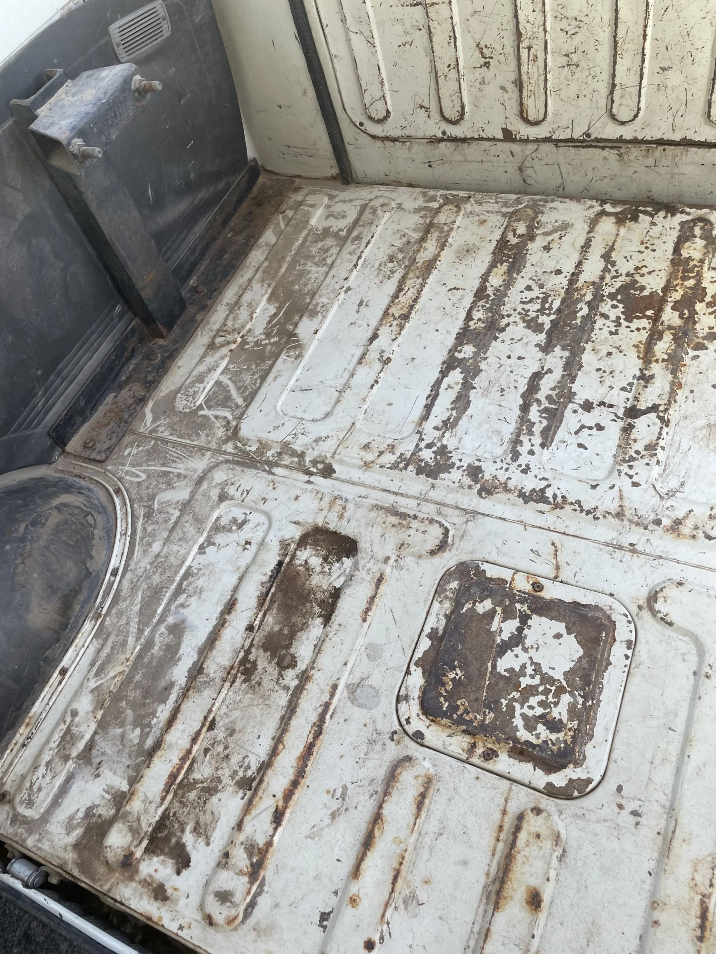

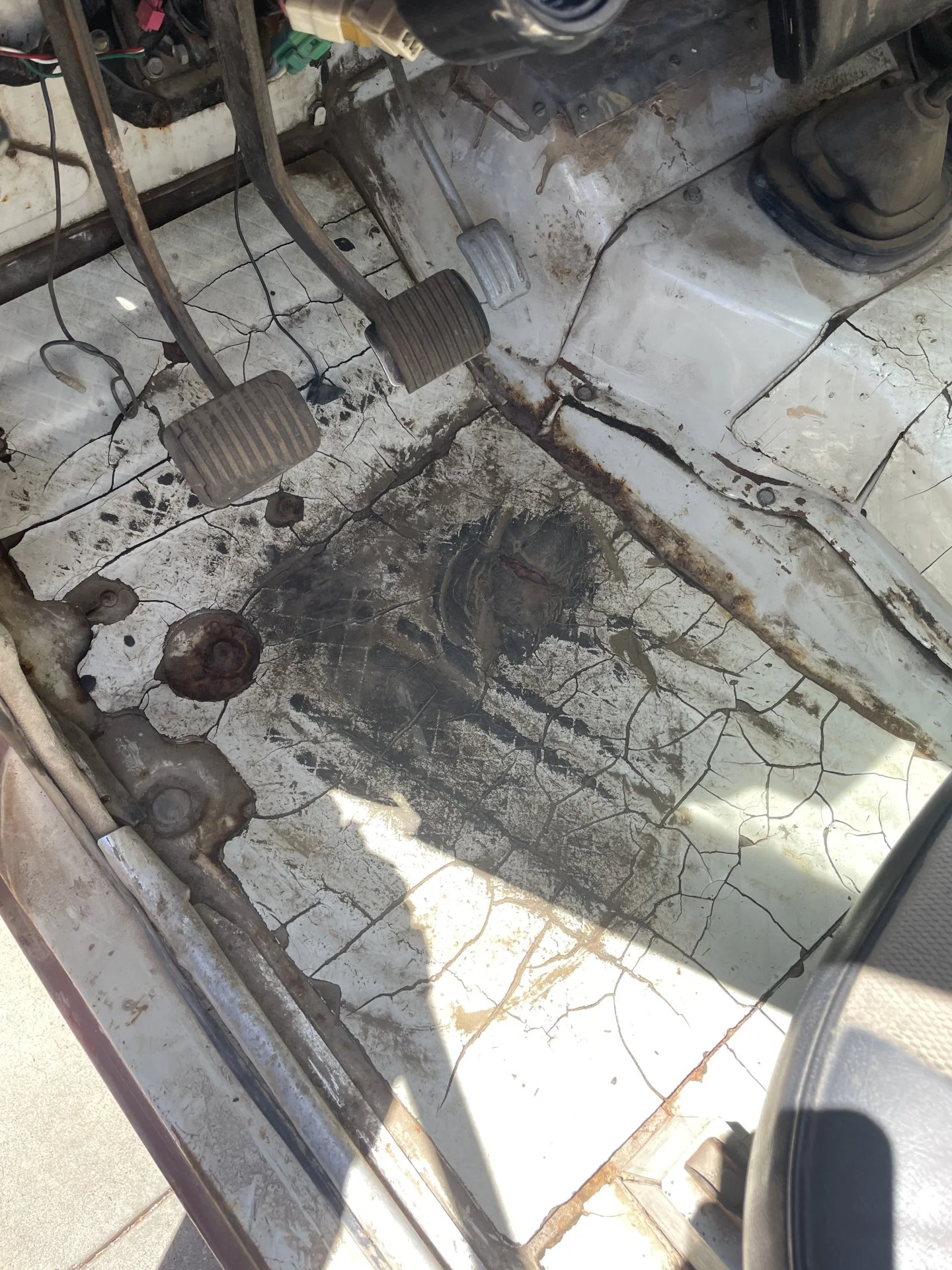

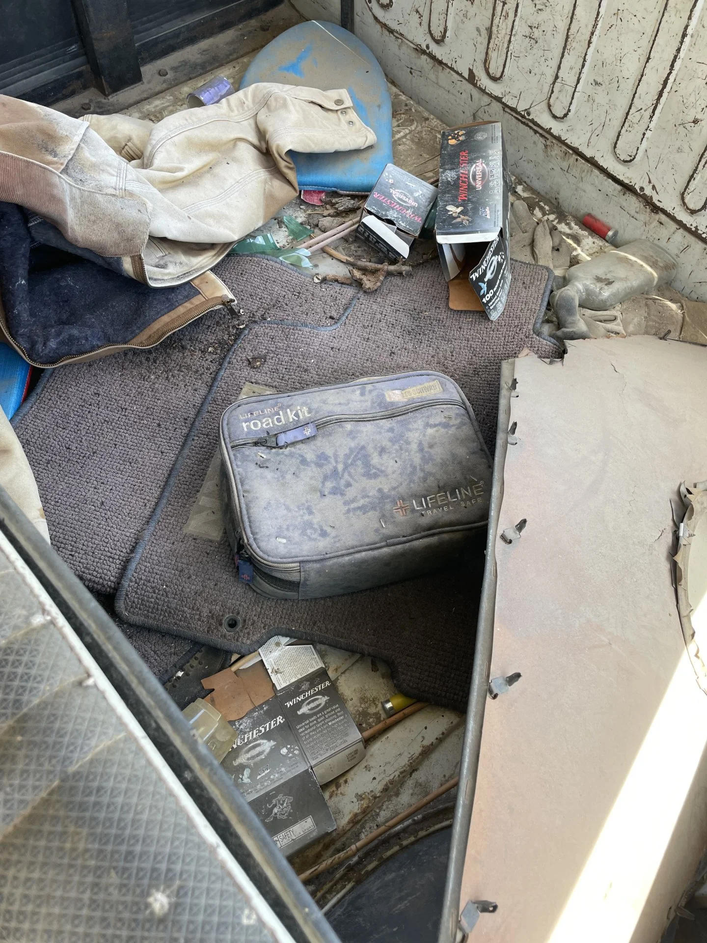

You'll notice the dings and dents and added character to give it charm. Front passenger fender and the grille bent in from the son driving a tractor into it. Inside full of dead mice and droppings throughout. Back seat had the usual equipment scattered about.... 2 gallons of CAT delo, fence wire stretcher, Winchester 20 gauge, and some old Carhartt jackets.
Looking it over and cleaning it out I noticed not too much rust. No really folks, for a FJ55 i'm extremely impressed here. Mostly stock other than the V8 swap and this overly large AC conversion setup in it. I'll be debating what to do with the AC, seems like i'd be opening a can of worms.

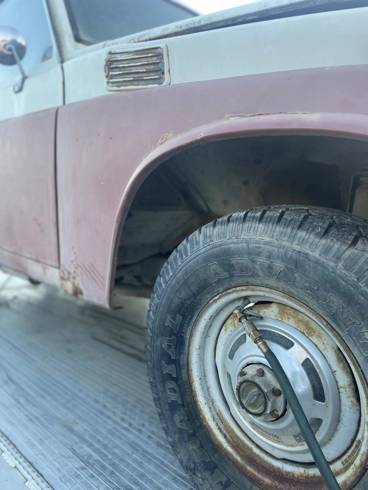

Pulled the passenger fender out with my hands to prevent the tire from rubbing it. Didn't bother to air up the tires the ole Harbor Freight 12,000 did just fine.

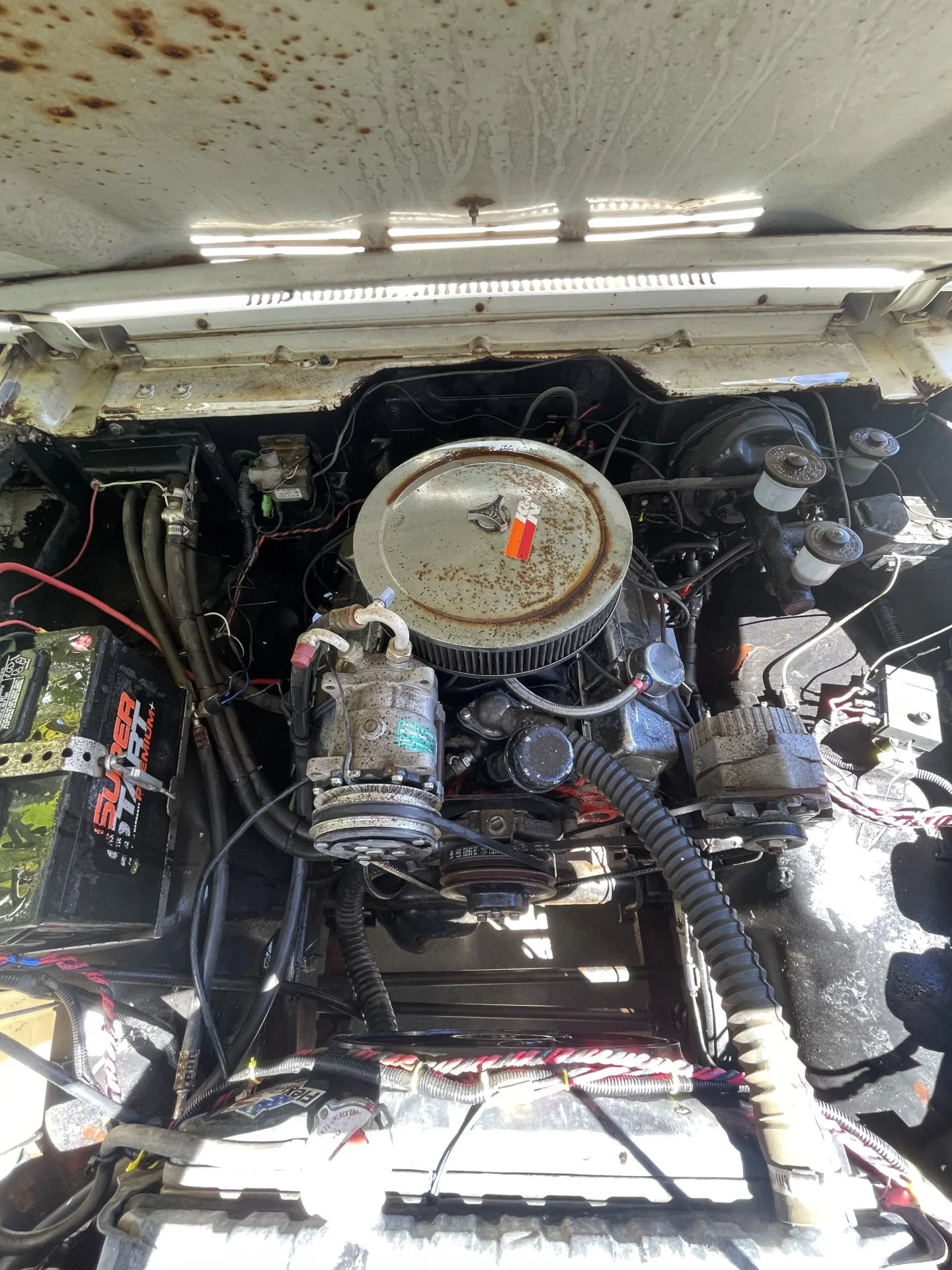

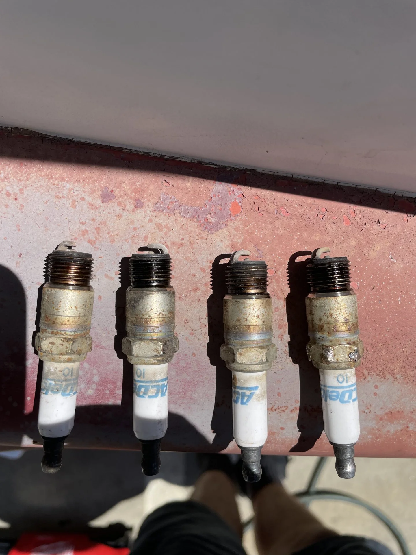

Plugs looked good, glad the motor turned nicely by hand. Anything that sits over 3-4 years I will always try by hand and lube the cylinders. Last thing I want is to snap a ring.
Changed the oil and oil filter just plain old Castrol GTX 20w 50 and a wix oil filter.
Motor did have oil in it so that was nice. Looked half decent too.
Was curious on what the motor is read the block casting located the top drivers side rear. A true 350 Hecho en Mexico per the decoding web sites. Sounds good to me it’s just a putt around cruiser. Would I love a 2F in it? Yes but that’s not the case folks.
Turned the ignition pulled the fuel line off and cranked for a second. It cranks. Okay cool. Next.
Find some gas and see how this goes.
Vroom. She’s fine. Hell the rear window even works fine. 🙄

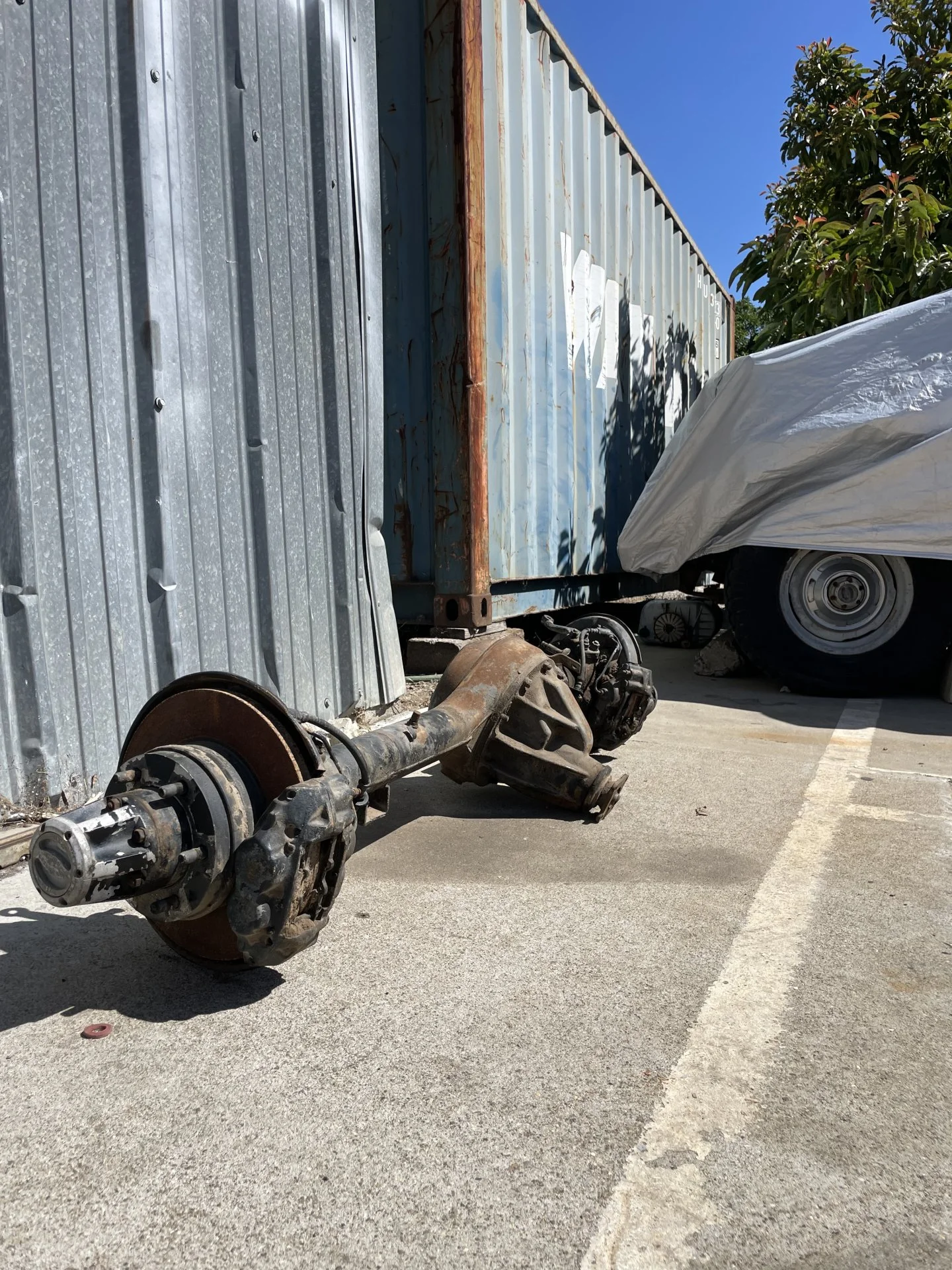

About a week ago I located a front axle off a FJ40. The yard that had it wasn’t too familiar with Land Cruisers so I purchased a majority of the other large items that were still salvageable. 😂 (slight cruiser addiction) 🙄
@RodrigzCrzr came to the rescue and loaded up everything in his 60 then brought about 1/3 of the load on his trip up to Monterey in his gas saver. Check out this legend!

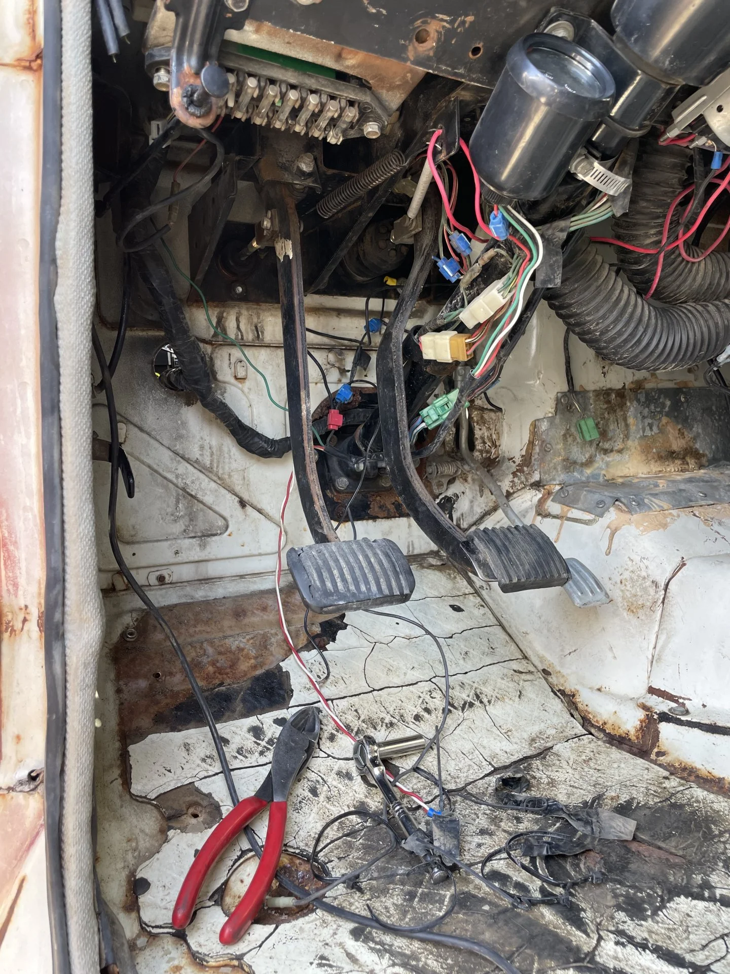

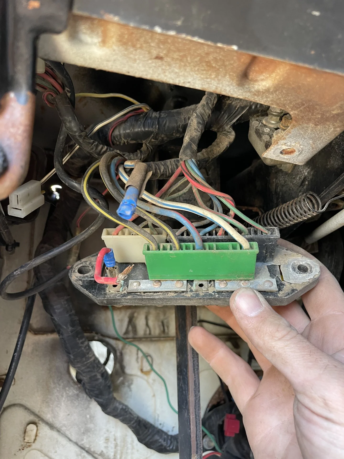

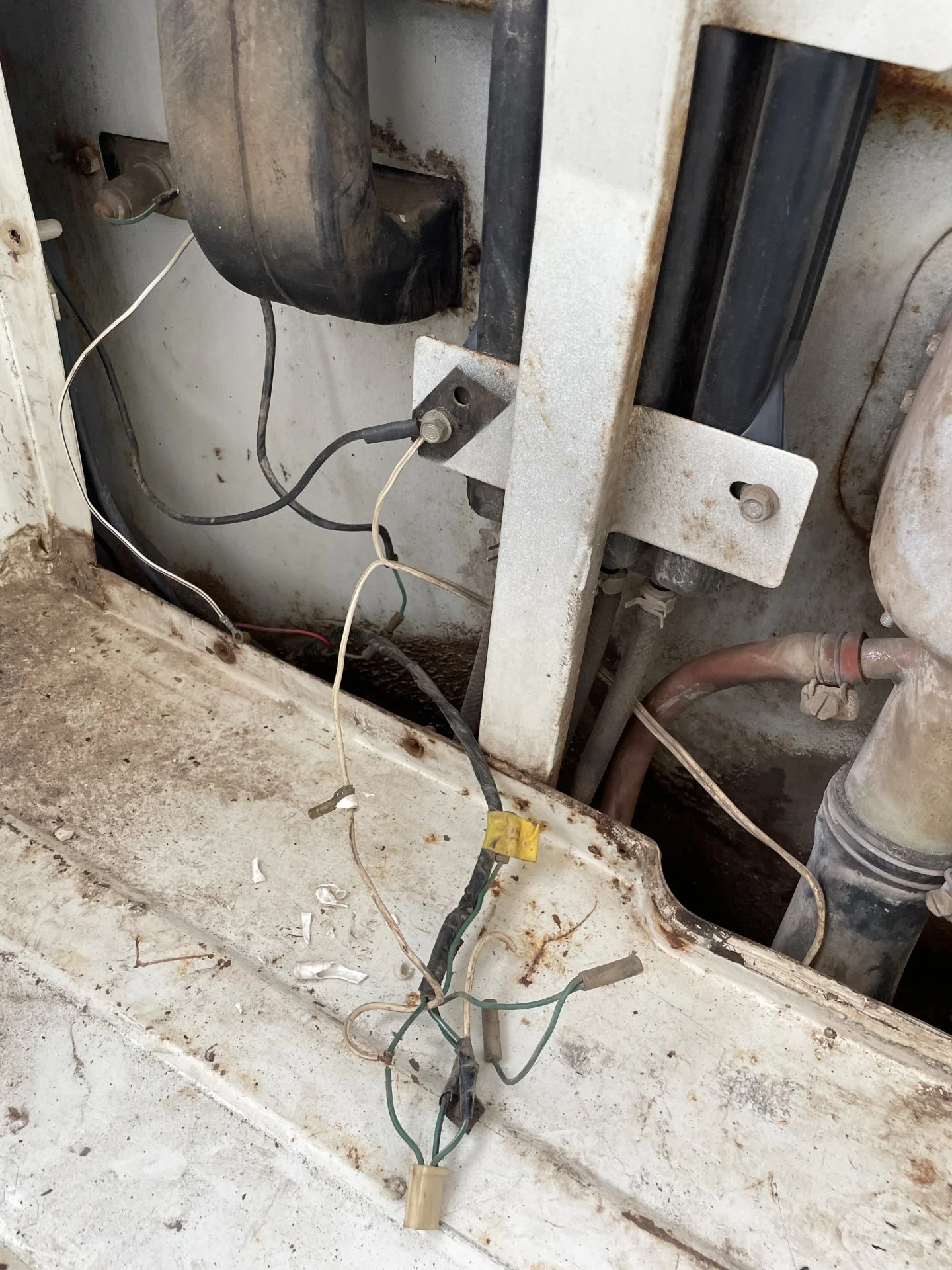

Removed the carb for a rebuild and tore into the wiring mess today. Surprisingly not anything too bad overall. This loom will clean up very nicely.
Gave @orangefj45 Valley Hybrids Cruiser Brothers a call today for the front axle essentials to freshen up this thing.
Wiring loom cleanup begins…. Out with old aftermarket wires and will get around to cleaning it up.
When getting any car I usually trace the harness from end to end. You just don’t know what has been done over the years. Mice can destroy things just as well as previous owners.
Not too much to do here but it’s a peace of mind knowing that I’m not going to nuke a harness.
