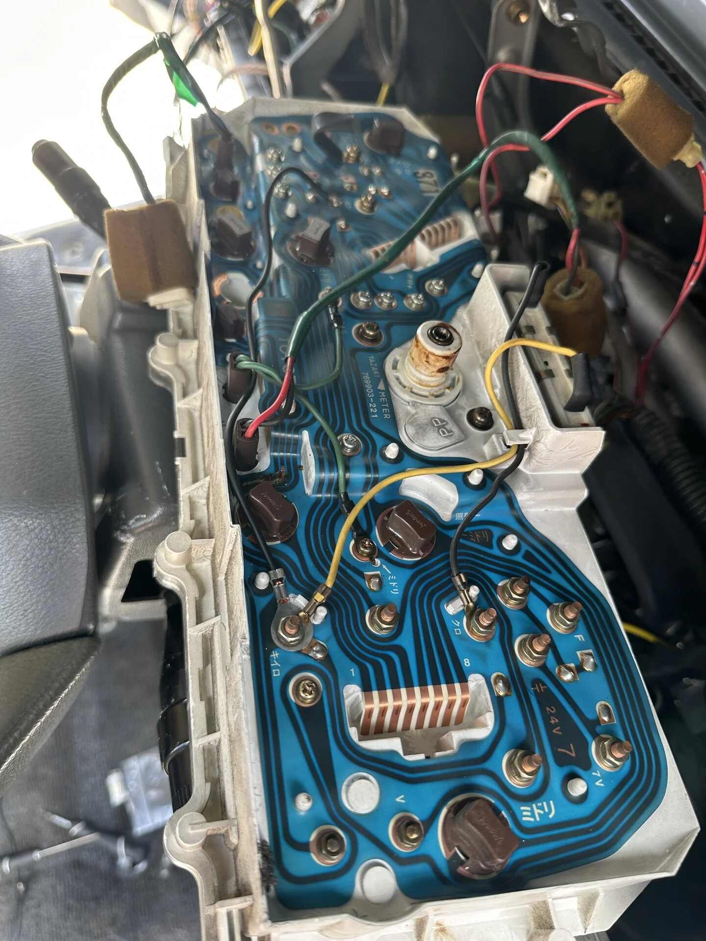

Hi all, I am the new owner for this 91 RHD JDM. I got her with only 80k miles. She already had new exhaust, fresh maint on birfs, 4" OME lift. Driving her home from the purchase, the master window switch broke, leading me to my initiation of the 24v world and sourcing unicorn parts from AUS and Japan.

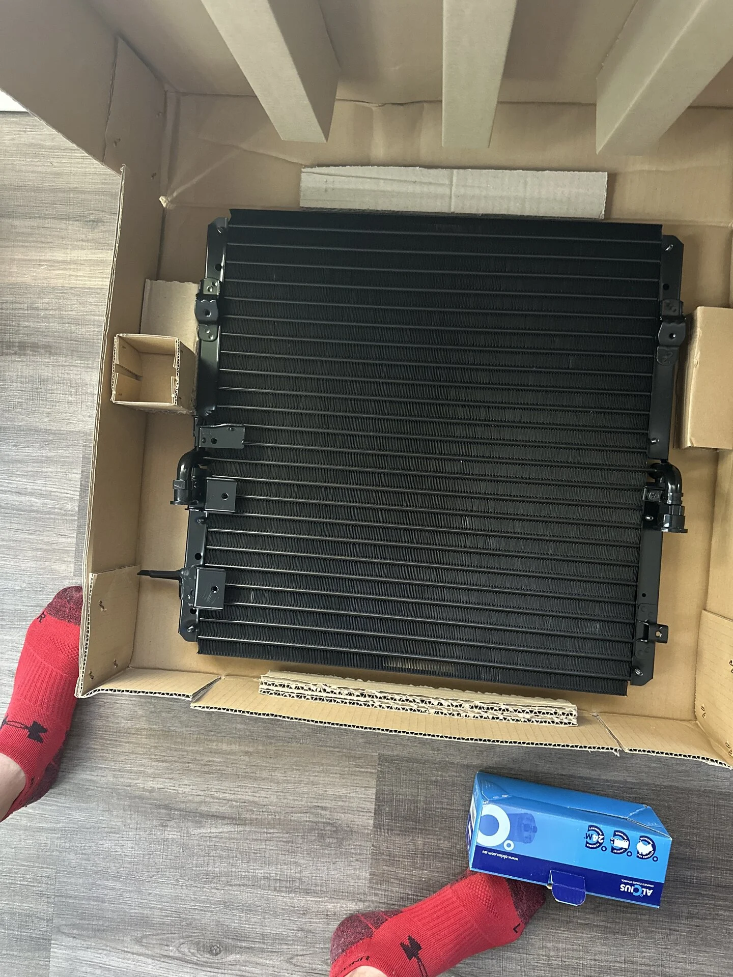

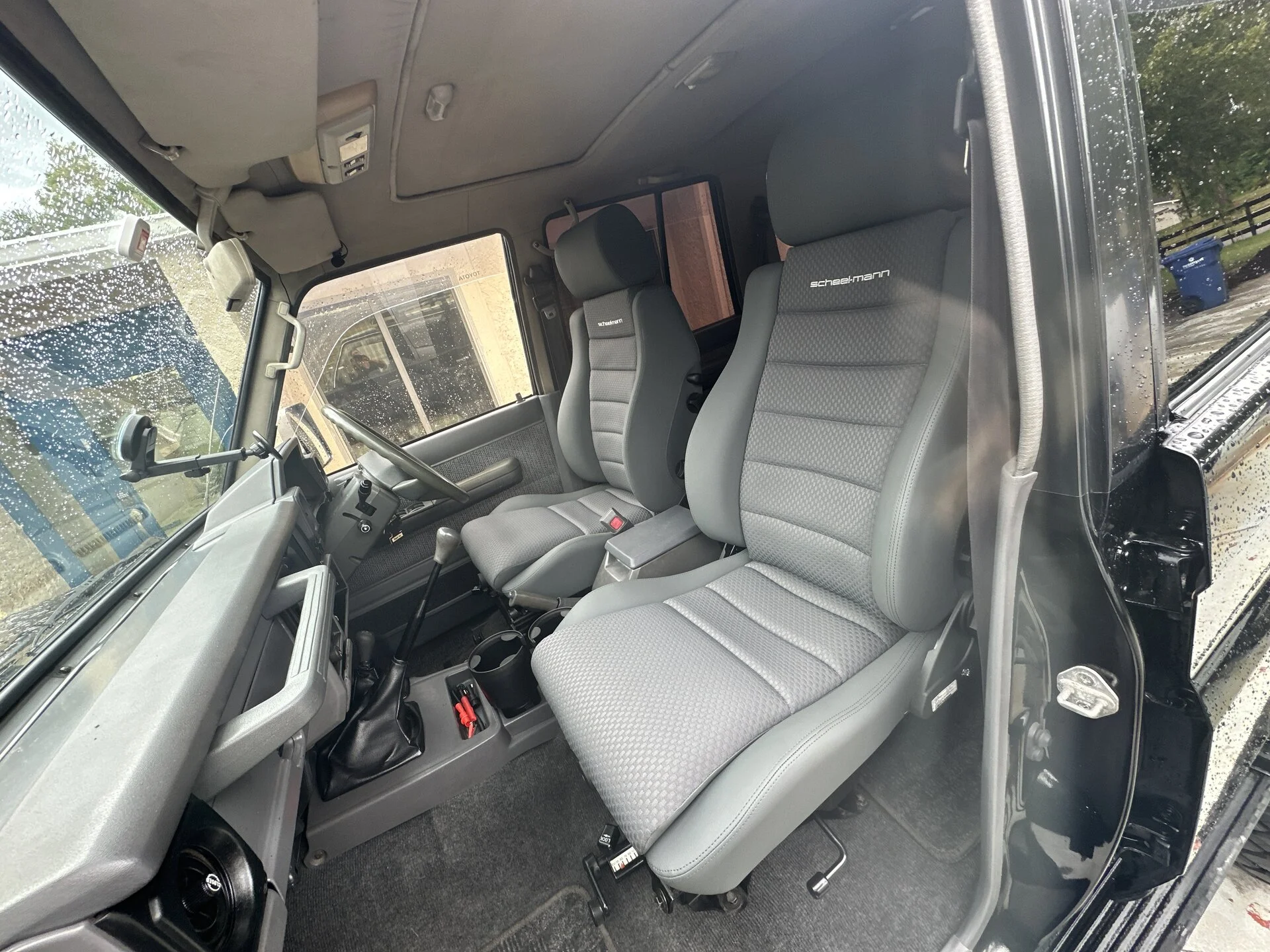

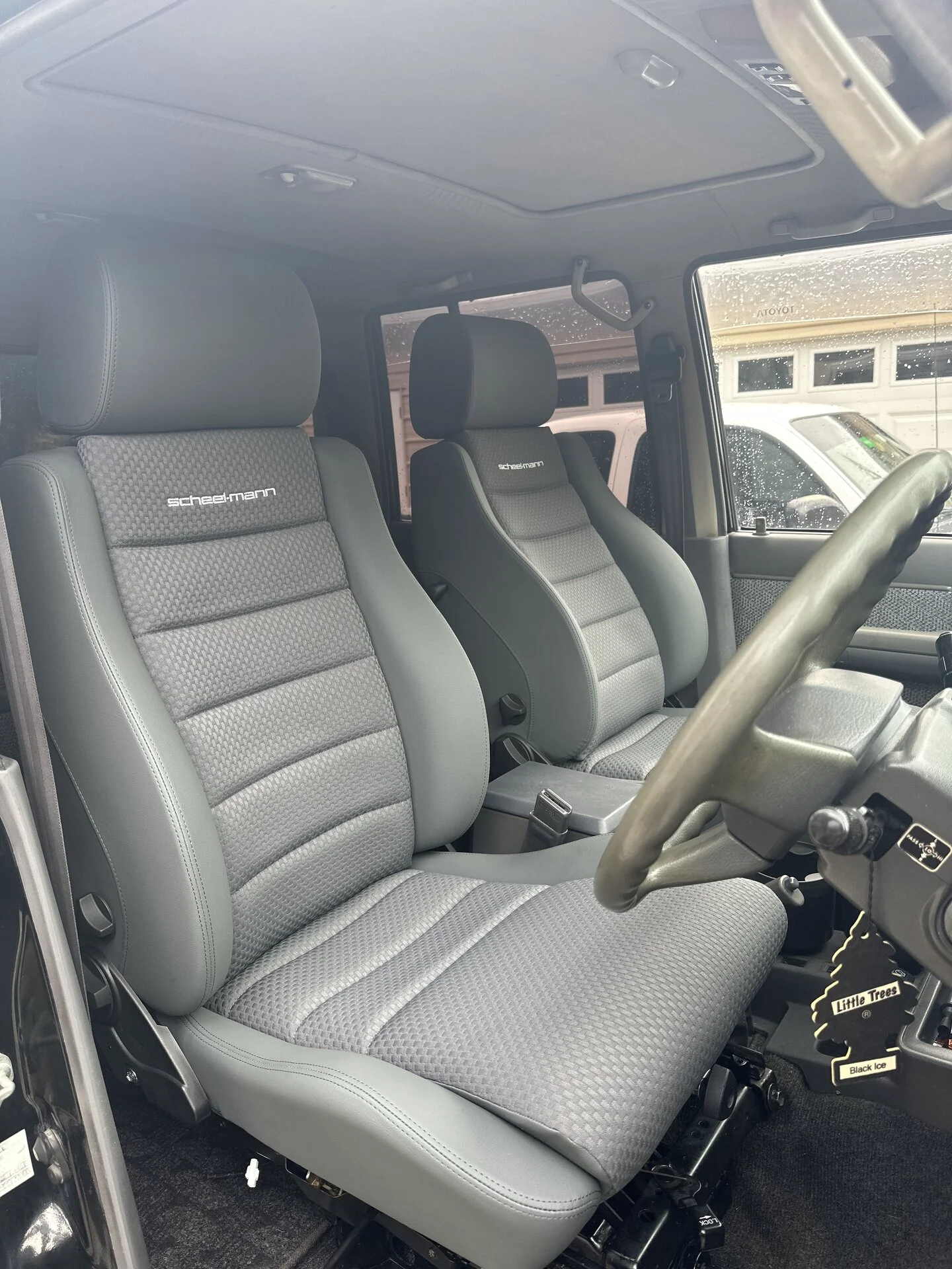

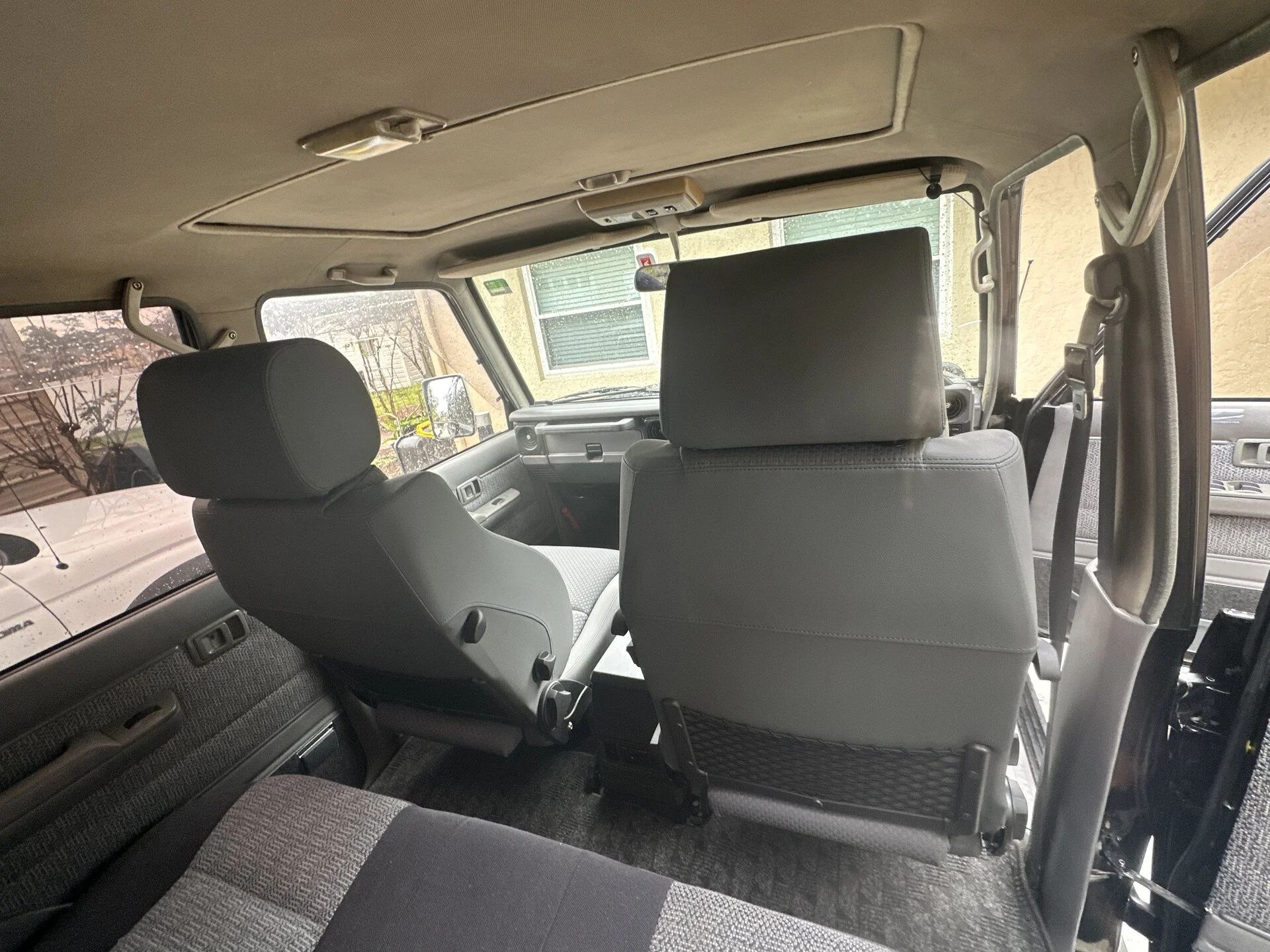

Today I got my replacement ac condenser, drier, Koito headlight upgrade kit, Hella horns, and my Scheel-mann seats. The bracket from Planted does not fit the top of the suspension base. Wish I would have known that ahead of time. I will get the bracket modified.

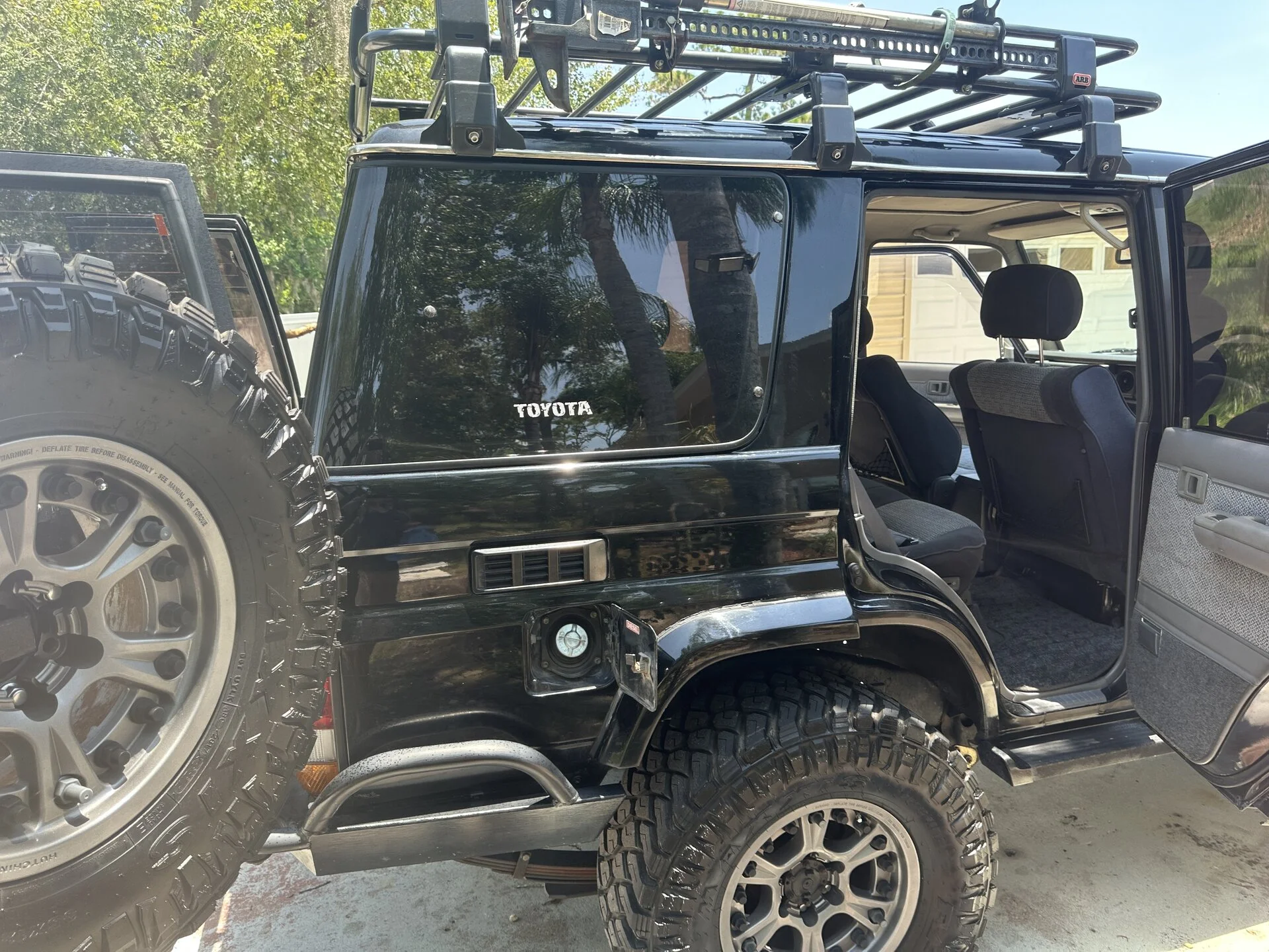

Anyone have good experience replacing the pad rubber between body and flares on rear doors/sides? Seems like mine are quite rusted out and the rubber is toast.
Looks like you removed the suspension base itself from the floor. The planted brackets are indeed for a cruiser that never had the suspension bases to begin with.
I am running scheel-Mann seats mated to the suspension base. So is @sleepydad69 as well. We are using different methods to make it work.
Thank you. I will get the Planted to mate to the top of the suspension base with some mod of course. Joining the Scheel club here.
Once you go scheel-mann, it is hard to go back to oem. Looking in figuring out a way to get some into my Tacoma now because I really like them in my HZJ77.

The flares are pretty easy to remove for rubber replacement. Some attachment points between the flare and mounting bracket on the body may be secured by rivets which can easily be drilled out and replaced with what I think is the (90119-06278) M6x1.0 10mm bolt.

Working with @sleepydad69 I was able to obtain the brackets needed, thank you good sir. A call to Jessie at Scheel ended well with them emailing me a return label for the sliders and Planted brackets (total $640) as well as a service note on their side that this series may have the suspension base. Excellent and friendly service.
The @sleepydad69 brackets are top notch.
@CrewzerITIS when you added your new seats did you notice if they sat up any higher? I have suspension seat bases in a new to me truck and a little bit extra of height would be welcomed.
