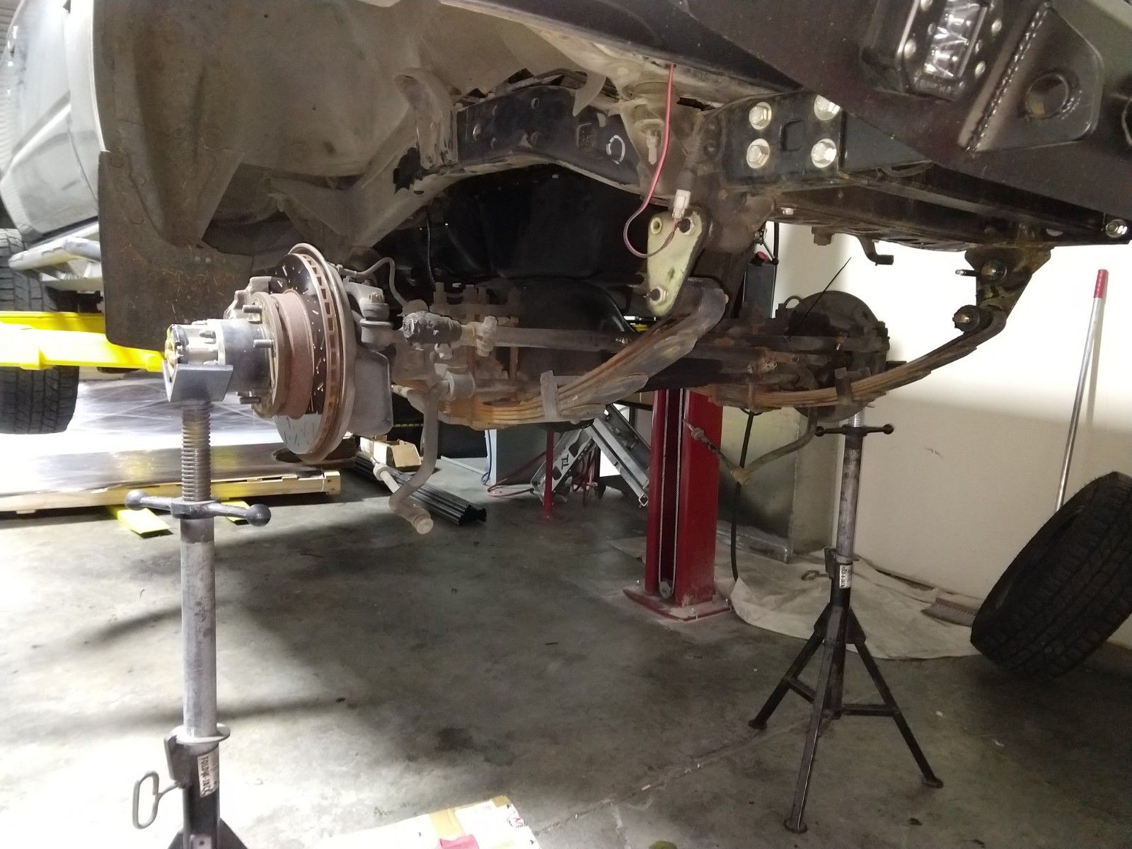

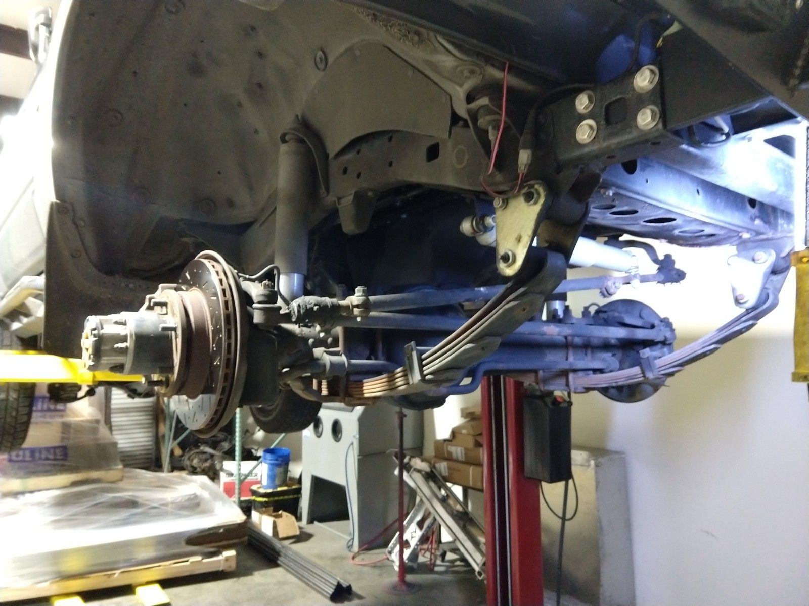

Progress on the front brackets.

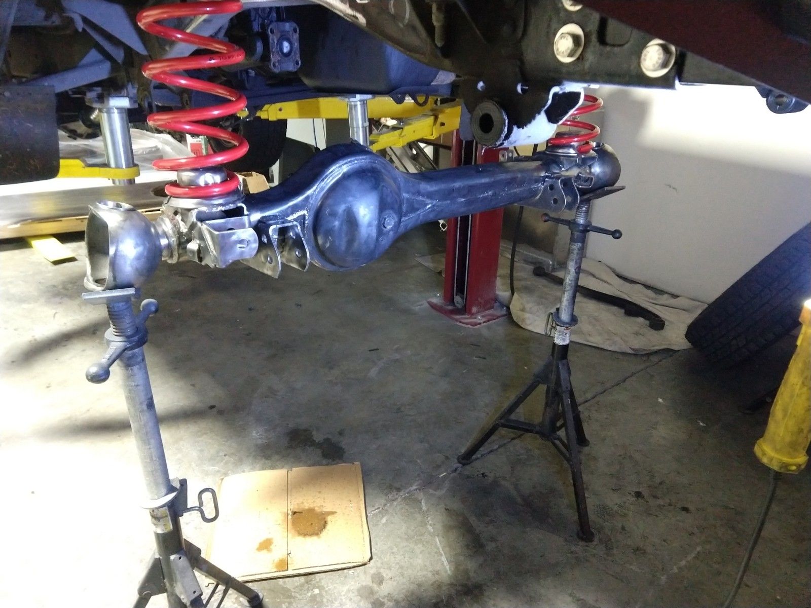

80 axle/coils swapped over today. @matthews940 and AJ have both helped out tremendously on this little project with me being sick the last 7-8 days. These are my custom TourFlex 2" tapered wire lift coils. We designed it based off a 2" lift. So if you want a 1" lift ... Order a 1" lift coil... Want a 3" lift... order a 3" lift coil. Perfect 1" rake on this rig. Should dial in around 4 degrees of caster and ride amazing with the custom tapered TourFlex coils
We tested 3 coil sets today and we are at a perfect inch to inch ratio. Stock coils-- no lift, 2" coils-- 2" lift, 3" coils-- 3" lift.

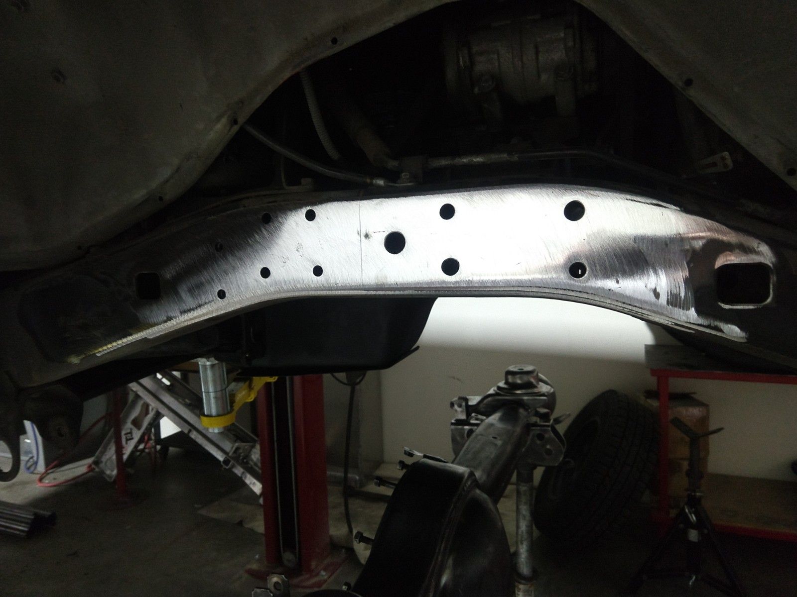

Have all the little stuff to button up on this and then on to more conversions. Final weld out in the morning.

@TRAIL TAILOR and "AJ made custom extended front sway bar brackets for the front 80 sway bar this morning. Suspension cycles beautifully from coils 1" off/loose from the buckets to 2" compressed."
New Proforged TREs, all new bushes and new MOOG sway links and bolts.
Got most everything welded out this morning too.
