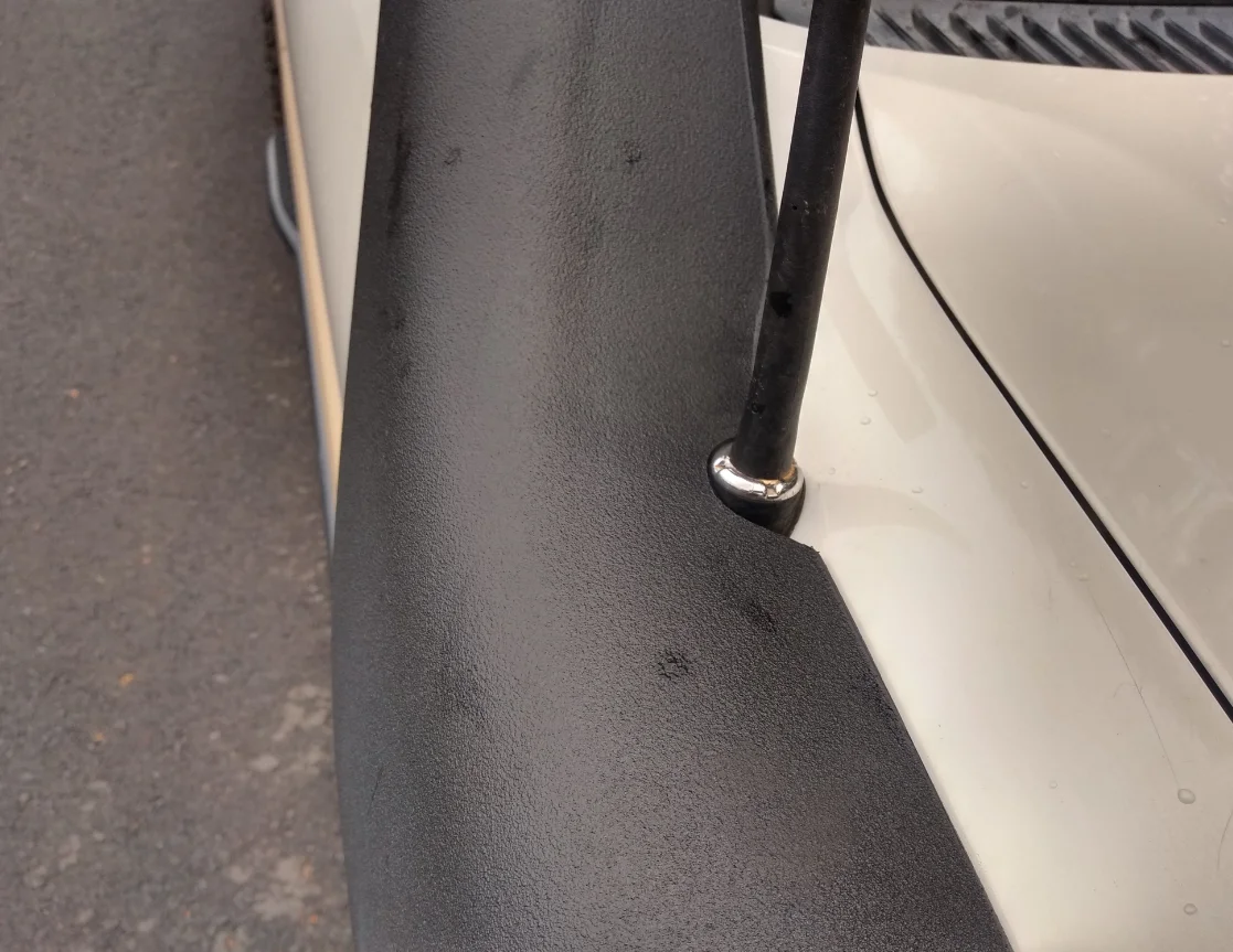

Now if this is a rep, who made/designed it originally?
Couldn't choose that one just based on type spacing alone :rofl:
Lol I intend to get this sanded down and leveled as obviously someone only had one job and failed miserably. And the whole snorkel color matched with the body.
Looks like at attempt at a TJM clone, also looks like it may not work with the US antenna location.

When I got the Safari Snorkel, I wanted my local cruiser shop to do the installtion. I was uneasy about cutting through the fender and knew they would do a good job. They heated a small piece of 2" copper pipe and used it to melt an indentation into the plastic that allows the antenna to work. They had to be careful to let the plastic melt and then sanded the area to smooth it after they were done.
Not about the dent for the antenna as much as it's about where that style enters into the fender - right where the antenna motor is. Think most that have gone with that style have just gone with a fixed Tundra or non-us manual antenna. Search around, def. some threads on both.

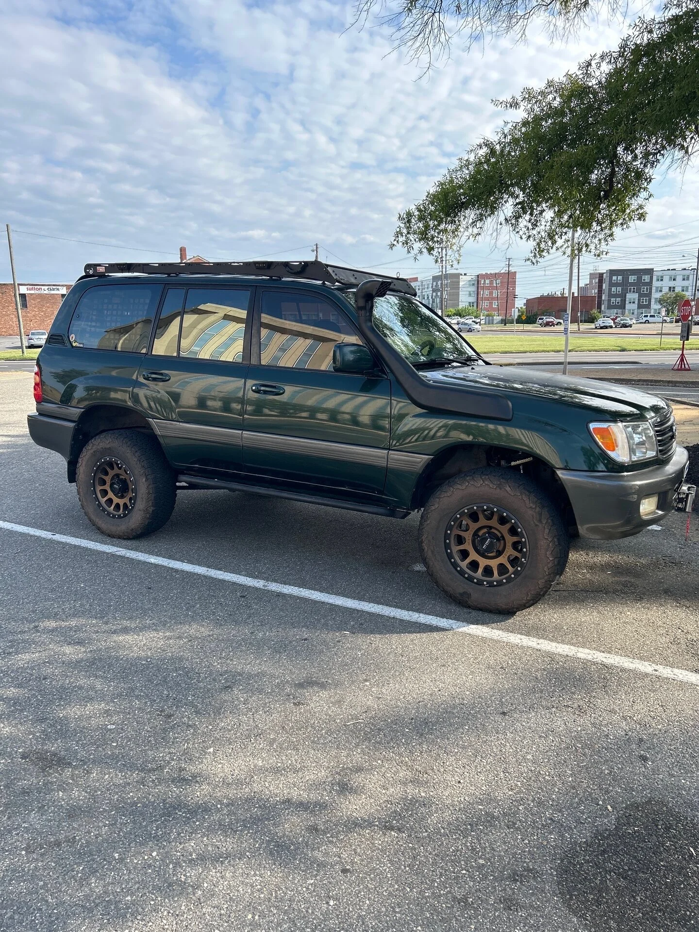

Just installed this one last week, Intake Snorkel Kit for 98-07 Toyota Land Cruiser 100 Series Lexus LX470 4WD | eBay - https://www.ebay.com/itm/322564953297

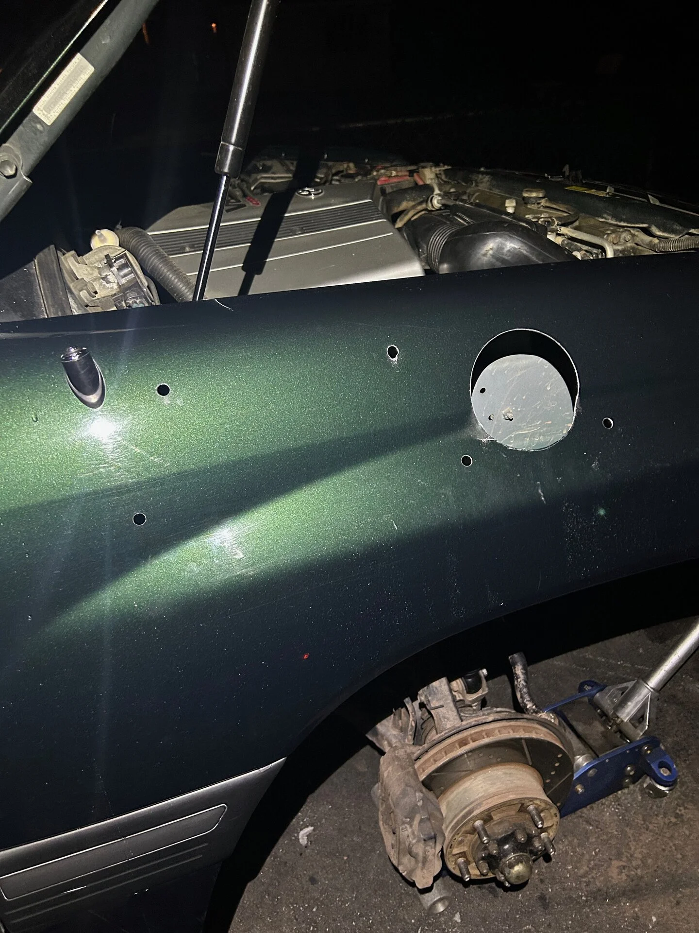

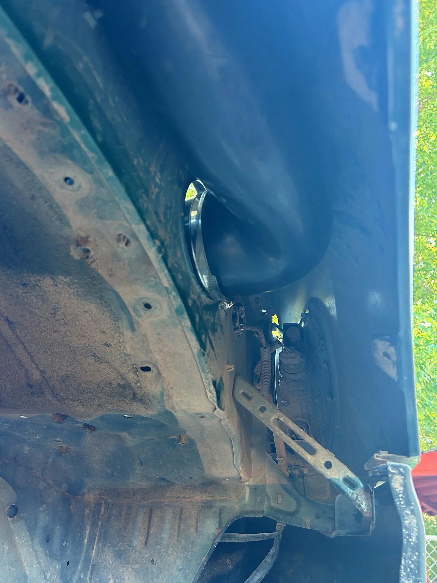

Template lined up well for the big hole. I followed the youtube videos and threads on here to make sure I did it correctly. Made sure to use nail polish on the snorkel bolts for the smaller holes on the fender after I drilled the large hole to have the most accurate hole cutting locations.
All I needed extra were some 10-24 bolts from lowes and the $20 rivnut tool from harbor freight. I also used RTV for the A pillar holes. I used a 4 1/2" hole saw to make the cut. Also had to buy an arbor. I think all in all around $160 to get it installed.
