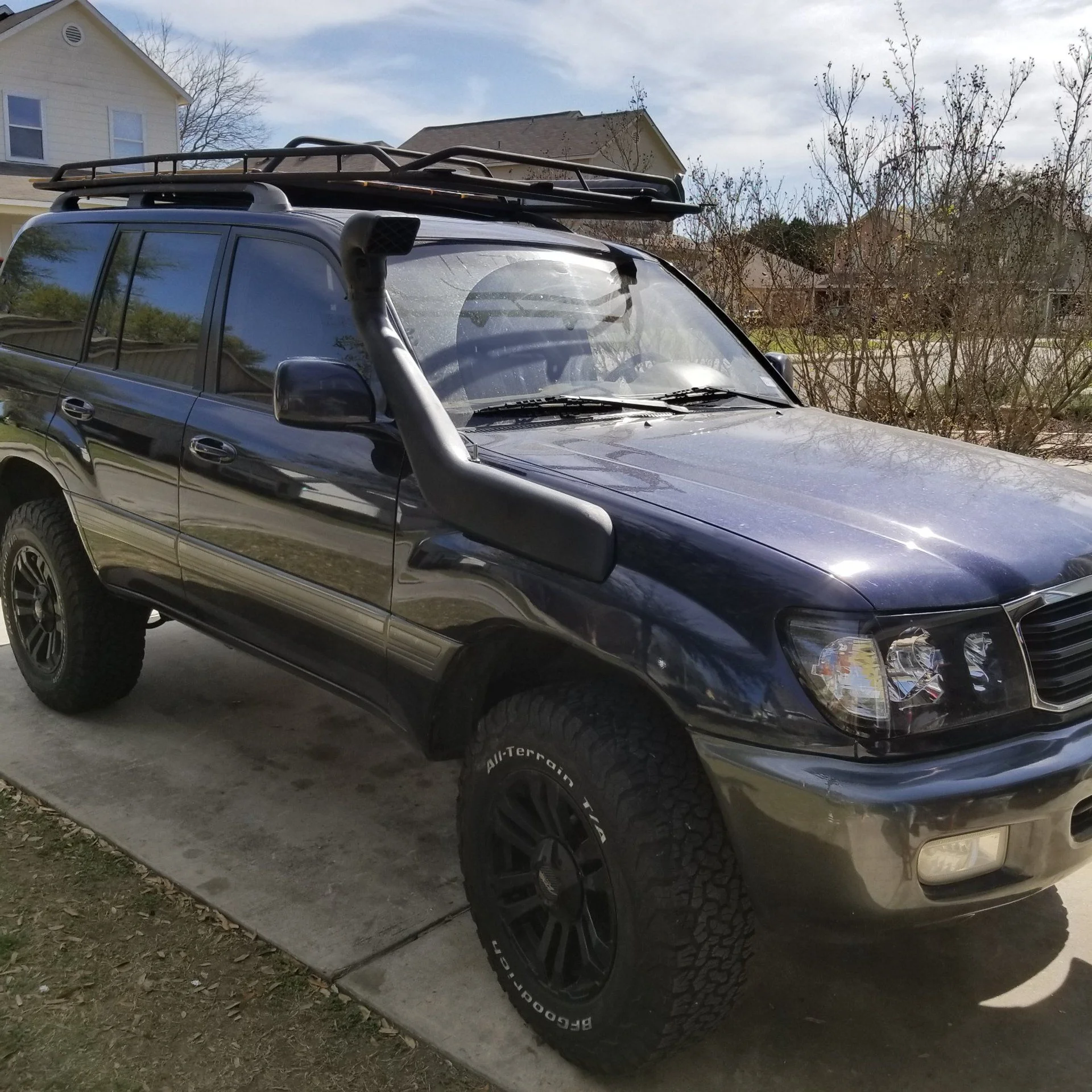

I got one on for $98 on Amazon and installed it today, did a write up of the installation here:
$98 ARB-Clone Snorkel install -- It turned out GREAT!!
here is the link to the snorkel on Amazon. Free shipping took 4 days to arrive here in Austin, TX:
https://www.amazon.com/gp/product/B01NBIQFK3?tag=ihco-20
I'm super happy with it, and can't imagine a more expensive one being of better quality. This one appears to be an ARB clone, but with a perfectly molded antenna cutout. The install was straight forward, and like I said, I'm super happy!

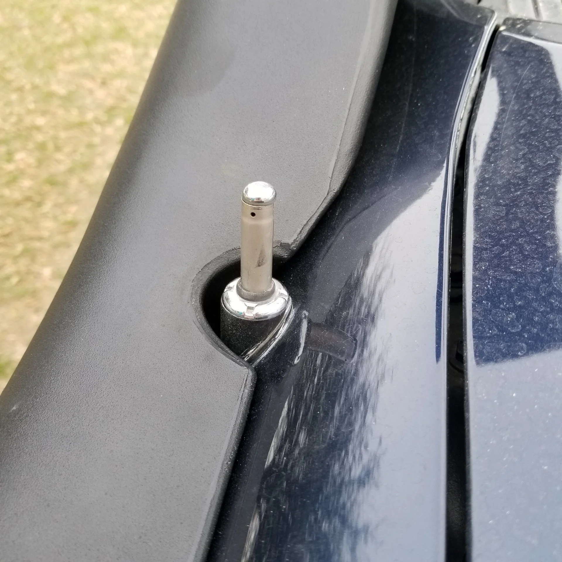

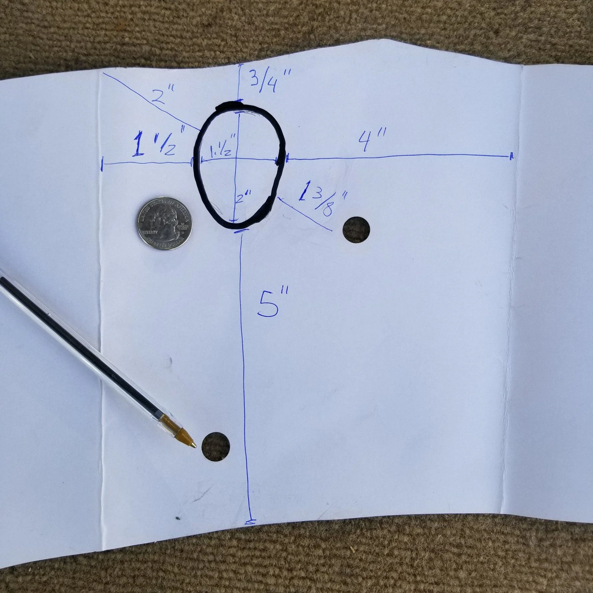

The only negative was that there were no instructions (Use a 4.25" hole saw!) and the template needs to be modified to go over the antenna. This is the egg-shaped hole that I made, and it might help the next guy.

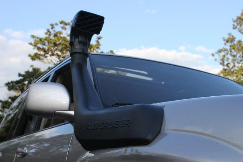

Bumping this up, I see that now these are down to $65 on Ebay, still about $100 on Amazon. I found one thread where someone's knock off cracked by the antenna dimple, but otherwise it seems these are fairing ok? Anyone noticed a difference in quality of the various knock offs? I don't see the ones with "land cruiser" printed on them available any more.

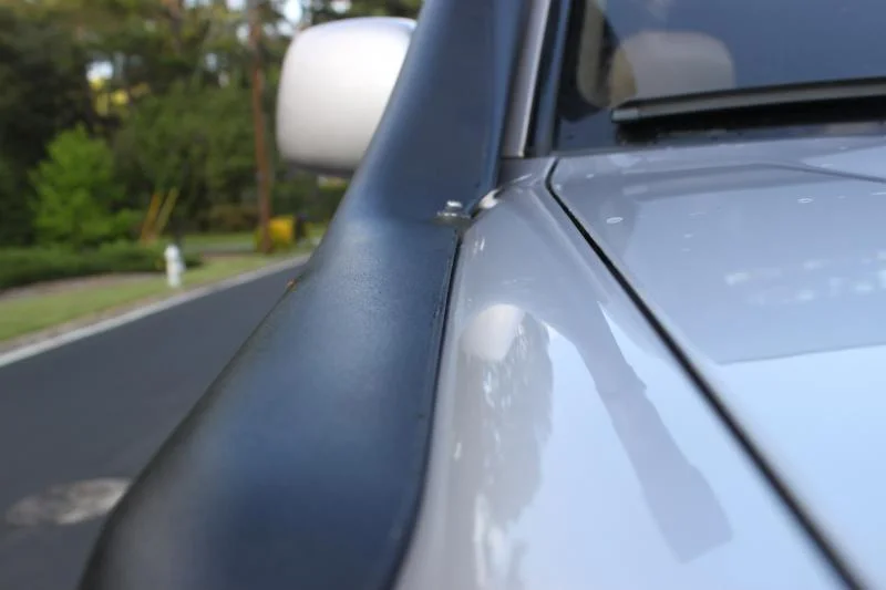

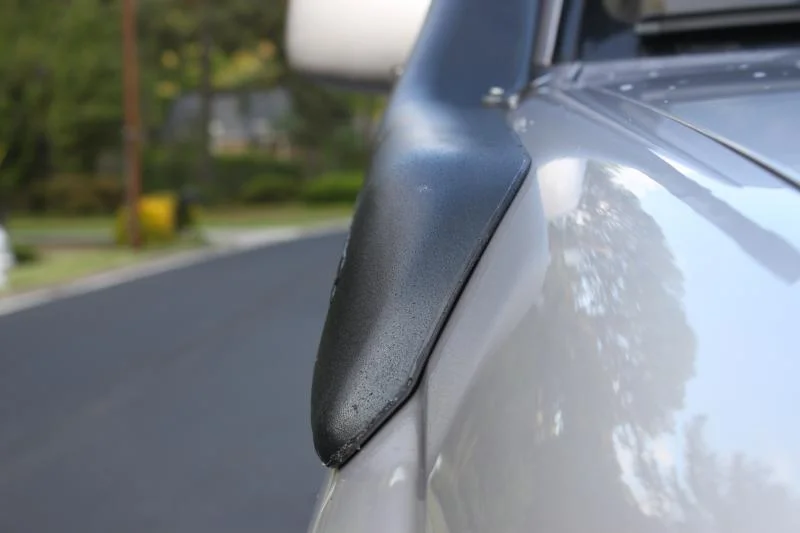

I have seen many 100's with Safari Snorkels installed and I can say this one fits perfectly. 100% contact with the fender on all sides. The A-Pillar bracket is rivets, I wasn't to sure about it but it seems pretty strong. The intake hole is 4" exact and the template was correct with that. I managed to drop the snorkel mid install on concrete, so the front of the snorkel has a little...uhm, roughness :bang: oh wel
I have seen many 100's with Safari Snorkels installed and I can say this one fits perfectly. 100% contact with the fender on all sides. The A-Pillar bracket is rivets, I wasn't to sure about it but it seems pretty strong. The intake hole is 4" exact and the template was correct with that. I managed to drop the snorkel mid install on concrete, so the front of the snorkel has a little...uhm, roughness :bang: oh well.

Please help...Hello, I know this thread is very old, I have an lx470 and have been looking for the same snorkel with the land cruiser lettering on ebay and amazon with no luck so far . Any idea on where to find one
I think Mr. T probably did the ol' cease and desist to the manufacturers of them.
