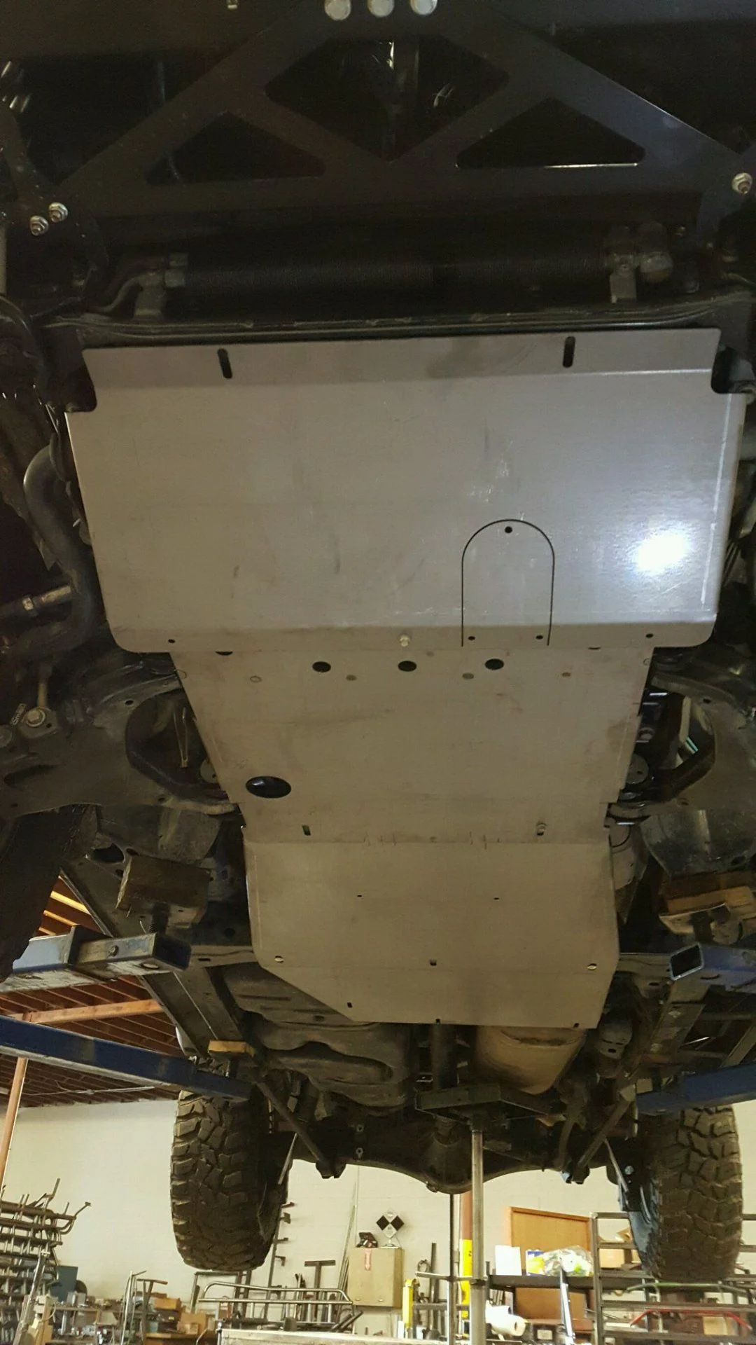

To me the Bud Built design looks more bullet proof in that it essentially encloses the entire underside of the truck with steel plate. It looks like the underside of a Abrams tank. The Slee skids look more "engineered" in that they don't completely encase the underside in steel plate but rather cover the critical or most vulnerable areas, uses varying thicknesses of steel, and has what look like vents and drain holes.
I'm curious if anyone with the full Bud Built skid plates has experienced any problems with heat or muck build up that Slee has seemed to engineer a solution to. I am sure that there would be some heat trapped with the Bud Built design compared to stock and potentially mud and dirt could get built up too and be a PITA to clean out but are those things really causing anyone big enough issues that would make them want to trade for a system with less complete protection?

What you’re asking is not overkill, that’s what Bud did.
He has 15 sensors that record ambient temperatures on his little computer. I had a scan gauge that showed all the normal temperatures, coolant, ATF pan, T/C to name a few.
While in North Carolina, Bud would conduct driving sessions with factory skids, no skids, and BB skids. Then we went backroad driving, then we went to uwharrie for low range wheeling. This was over a few weekends to get base numbers, and it was about 8 hours each session. What we found was it didn’t make a difference at all, skids or none at all. I took the stuff to Savannah and recorded city traffic for all three skid configuration also.
Then for Lone Star ‘17, we both went to east Texas and I did everything I could to over heat something in 90°F heat. Then the next day, I ran the easier trails, but with no skids, but the same low range chugging and lugging in the same weather. Basically he wanted me to mimic conditions as close as possible.
When those 22 days of testing were over (in total) he said, “well, you can’t beat thermal dynamics. Heat rises, it’s just how it works.” Toyota puts in a cast aluminum front diff with heat sink so they don’t need to have cooling vents like on the 4Runner. So you don’t run the risk of getting grass seeds or mud shoved into your radiator from holes in the front of skids. Which would really increase temps.

First, I gotta say that both Slee and BB make great, quality stuff...and I have been VERY happy with my Slee products...and also VERY happy with my BB products. Like “super* happy, actually. And...both Slee & BB have shown that they continue to test & tweak designs if needed & and it’s been my privilege as an early adopter of products by both to help push the limits. If a limit was found with a product by either in early versions—they were then fully remedied by both shops...and the evolution led to even better stuff. So kudos to both Slee and BudBuilt.
So from the perspective of positive experience with both...here is my 1.2 cents (if anyone is reading along) from a guy who has beaten on my skids really hard:
I have experienced no heat issues with my BB skids, despite the fact they are the heaviest, thickest version metal BB makes. These have been severely pushed on my heavy, hard-run truck—including long days of low-speed (low air flow), technical wheeling in summer heat...all day long...without a cool-off period anywhere. It includes thick, cookie-dough mud, rock bashes, and massive hits where they did their job.
Speculation is all I have ever heard being applied to the idea of heat in this example...and as far as I know, the results have never risen beyond that. No one, to my knowledge, has reported any actual issues. -If someone has testing data or measurements contradicting BB’s tests (or contradicting my own positive experience), please chime in...but I have neither seen, heard nor experienced any such thing.
I get the speculative concern...as I tend to try very hard to look ahead to anticipate problems as I’ve carefully considered armor and other changes to my truck.
The lack of negative evidence pitted against positive experience means the “balance scale” in my head feels pretty clear. We can do the “what-ifs” thing all day...but what matters to me is testing, real-world hard-wheeling results & looking for contrasting results.
When the question was originally raised...BB responded with additional, direct testing. With my own skids...I put them through my own heavy wringer and...I have been very very happy.

“The 200 skid system was designed to strike a balance between big hits, weight, and trapping heat under the truck.
We’re super lucky to have such high quality options in our small market. We’ve designed a skid system that we feel satisfy’s most 200 owners needs.
I’ve personally and intentionally set them down on rocks, buried them in nasty gooey mud, stuck them in snow, measured operating temps in 10 locations simultaneously (and compared to factory temps) and tested the amount of pressure it takes to deform them in their most vulnerable areas. Throughout the design iterations, we’ve beefed up the areas most likely to take a hard strike and lightened areas that are far less likely. We played with different materials and geometry.
Take home point - Wether you choose bud built or Slee skids you’re getting high quality and well thought out system. If the above sounds like it meets your needs, we’d love to include a set with your sliders :)
Above is from my original post.
We’re still actually testing around heat when we have the chance, out of curiosity. One area we were concerned with was around the trans. The stock setup in that area is wide open to airflow.
Our goal with temp testing was to make sure that there were no substantial heat differences in the areas we measured from stock (we also used ARB skids as a “control” if you will). So we aren’t trying to cool the truck, we’re just verifying that we aren’t causing any extra heat build up, and the trans area was the main focus.
So the louvers, they do a couple of things. Venting is one.
1. In testing we saw that without them the ambient temp surrounding the trans pan (while moving) went up about 30degF avg. With them, we ended up about 10deg cooler avg from stock on our test runs. (This was not a fluid temp measurement, just ambient air in 2 places)
2. They allow dirt and crud and water to flow out (and in). They are open enough to get them cleaned out (for the most part) without removing them. If you sink your truck to the doors in a mud pit, probably best to remove them for cleanup.
3. They add a small amount of rigidity.
Again, we were not looking to split hairs, just making sure we didn’t accidentally induce a heat issue.
We most definitely struck a compromise between, strength, weight, and overall safety/protection and based on our testing we feel they are adequate for 90% of 200 owners.
We’re a full service shop, and get to see how good/bad these trucks are treated. Sometimes I’m down Right surprised (impressed) they still drive straight lol.

From the gauge I was using during all that, it was my normal 130-160. The slower the wheeling, the cooler the tranny runs. Low range is basically idling around. At the end of the day, we have a tranny cooler with an auxiliary tranny cooler and an electric fan and clutch fan. I mean damn... awesome. But if we want to talk about overheating, we need to start talking about all the aux lighting that blocks our grills where all those coolers do their job.
Skids are irrelevant to the tranny, the absolute biggest tranny heat building situation is running down the highway with the torque converter unlocked. This happens all the time to lifted trucks that are on stock gearing.
