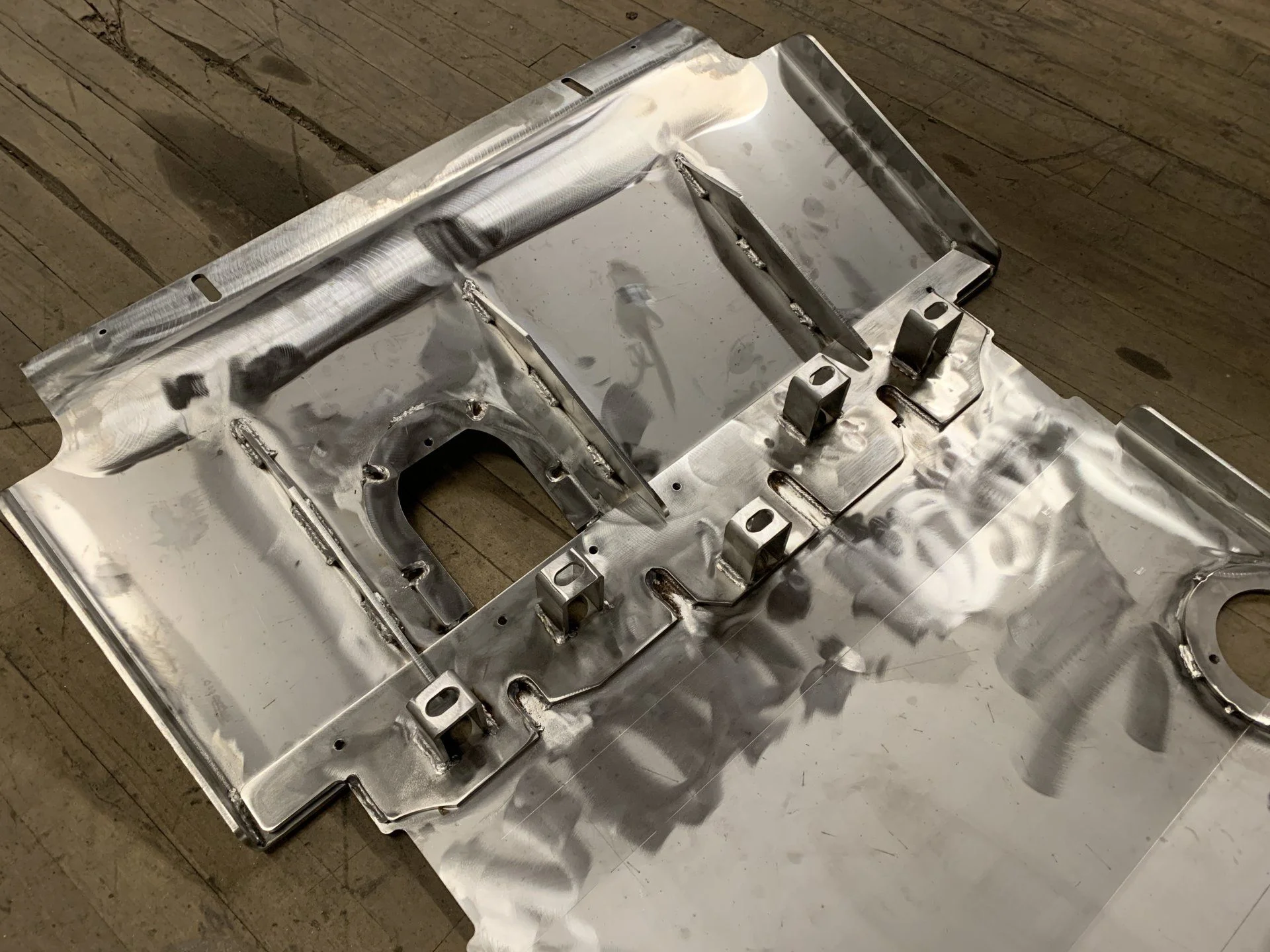

That said, for BudBuilts, they are called 1/4” aluminum but the inside is reinforced with another 1/4” of aluminum. (Here is a raw set of stainless as an example, but aluminum is constructed the same way, just thicker)
Some have said that BudBuilts are simple flat skids. Nothing could be more wrong, there’s a lot going on in there, it’s just all hidden on the inside.
The design takes into account that the radiator crossmember is weak as snot (along with the frame horns). So during front end impacts, the forward load is transitioned to the engine skid plate and onto the engine crossmembers. The only thing the radiator crossmember takes is upward impact, which when driving forward, is much, much less.
Plus the lead edge is double stacked, and all those weird recesses and angles exist to distribute the impact load across the plate and even it out across the frame. That’s that whole “material science” background of Bud's military engineering past comes from. Which is far beyond me. While I also worked in developing next generation combat vehicles, I was the warfighter that told the engineers their ideas don’t work in real life/offered what I thought an "improvement” would be over legacy equipment.
The big difference I see is Dissent's reinforcements are on the outside and exposed, and BudBuilt’s are hidden. Which is (in our opinion) the ONLY way to make skids.
