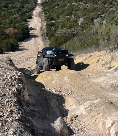

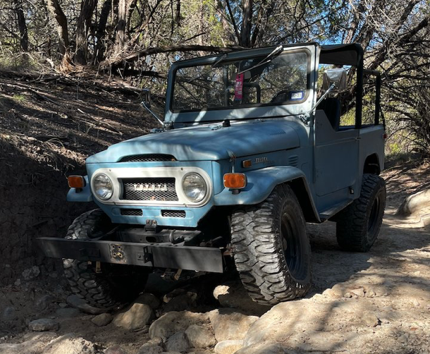

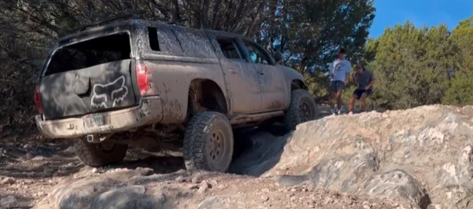

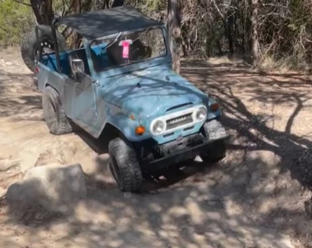

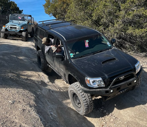

I had a good time wheeling yesterday. The tacoma is double locked, 35s, 488s, 63s and 14" travel in the rear so it is by far the most capable. But the 40 stole the show. Below are a few pics.

The struggle with 40's steering is because the kingpin inclination is off on a Cruiser when you install much beyond a H78-15 (about 29x8). The problem goes for any setup, but, it is far worse on a solid front axle because the design has a big old birfield in the way of the lower ball joint and there is no camber changes with the flex of the suspension to keep you on an inner sidewall when the trail is pushing on the outboard side of one of the front tires contact pattern, so it causes the steering to turn. The issue is no one wants to run trails with those smallish treads - not enough clearance for the contemporary motorsport. Of course, the folks running trails with you will want to see the 40 do as much as the Tacoma, but personally, my stomach can't handle a whole lotta leaf sprung, off-camber truck.
yeah - for now the 40 is happy running the bypasses and getting 'nice truck' complements along the way. Agree on the off-camber. For both trucks I'd love to know how far you can tilt before going over.
I fit in one of two boats, original 40 or SOA. SOA rides flex so well, they make challenging trails fun, just not the section paved with highway. For actually getting dirty and some healthy sunburn, the Tacoma rules, anyday.
