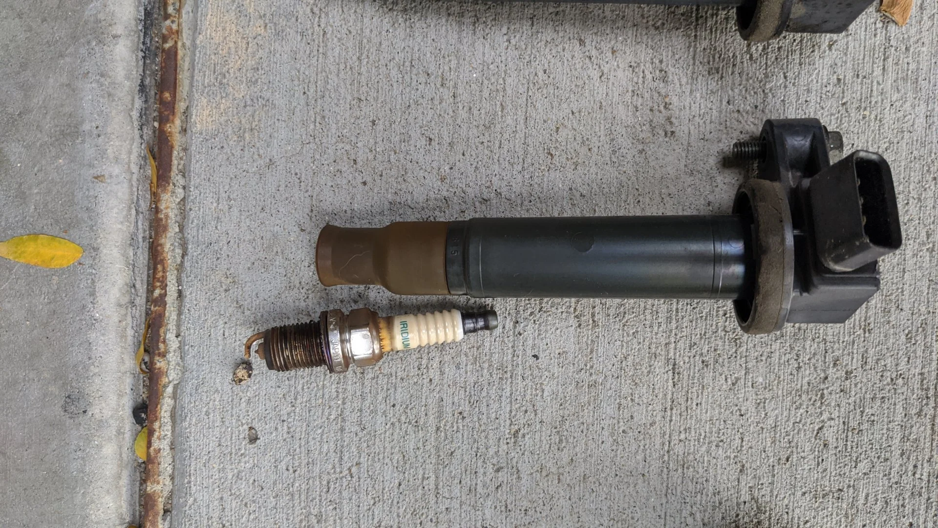

Through a series of fortunate events, I managed to get the full history of my LX all the way back to 2003, and found it had been nearly exclusively Lexus serviced. 60 pages. But in that 60 pages, somehow Lexus had never replaced the spark plugs? I hopped right on it, got them done no problem. They were in pretty sad shape, but the truck was still running fine.
But, one sparkie was particularly nasty, and the boot had browned around it. See photo. My gut tells me this is likely from exhaust that was seeping out from the edges of the plug as it may have loosened a bit over 230,000 miles. The browning on the top of the plug indicates that as well. Thoughts? Anything to be concerned about? Thanks.

Same happened here for one out of the eight of mine. I didn’t replace but should have since you can buy the boot itself. Also be aware of using anti seize on the plugs. There’s a write up about it from 2001lc.

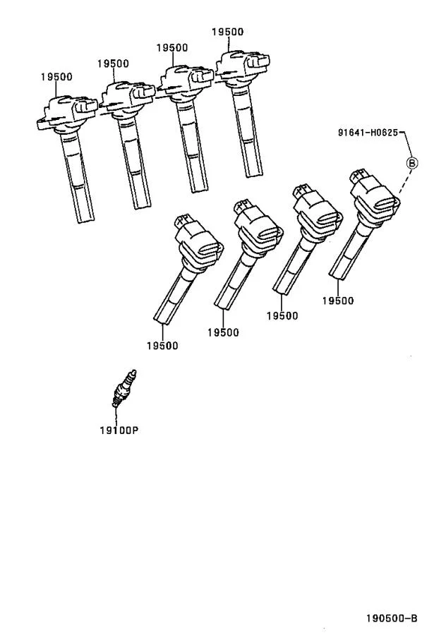

Toyota makes no specification for a parts number for just the boot, not the full coil. Anyone know where I can get just the boot? I dont see it on toyotapartsdeal.com, unless i missed it; I only see the full coil .
Denso is the OE manufacturer for LC100 Coil Packs....
There's also duralast cp091. I bought these a while back and they seem to be pretty good quality. They had them in stock at autozone.

Here is what you are looking for to service the OEM coil packs. You can replace just the rubber boots/gasket/spring so long as the coil itself isn't burnt and cracked.
Amazon product ASIN B00FRMAL8M
