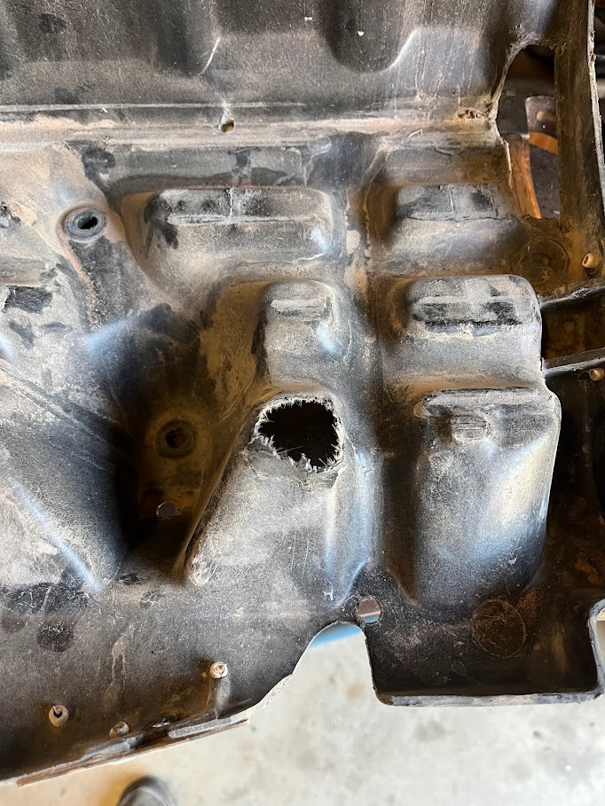

I welded the that tab at the bottom of the J hook to help spread the load when I went to the Land Cruiser Phil Battery hold down.
The battery is a grope 31 80 pound battery, the hold down held for 7 years and I have a new tray.
Question did the 31 year old tray just give out or do I need to add more support to the new tray some how ?

Also found this after the last trip 😲View attachment 3913126
The new Fan Shroud & tray are going in today, need to get ready for the upcoming Rubithon event :cool:
I would say, the way in which your 80 is driven, more support is needed where the J-hooks are secured to the tray. Maybe a plate can be fabbed under the tray between the J-hooks that "sandwiches" the tray between the battery and the plate.
Thanks for your input, I wish it was that easy.
Bottom of the tray.

The Battery tray is highly modified already as it was moved up from the OEM position so I well tackle that tomorrow and see what I can come up with for the hold down.
The back side was pretty easy, I was able to just add a piece of angle iron.
I do think age had something to do with the breakage. But a little more to hold it down would install more confidence.
I’m surprised no companies have come up with a better battery tray, or at least a way to make the stock tray stronger. I was thinking about trying to add a metal floor to the battery tray and rivet it to the battery tray in a bunch of different spots to hopefully spread the load. Then have the j hook go through the metal floor
You might be able to fill the cavity with epoxy to help distribute the load from the j-hook..
Flip upside down, cover current drill hole, fill with epoxy, maybe also embedded a little flat stock for added strength, and then drill a new hole through the battery tray, epoxy, and flat stock.
I was thinking the same thing.
This is what I came up with filled the void with fiberglass resin then a 1" x 6.5" strap. I think it well hold
