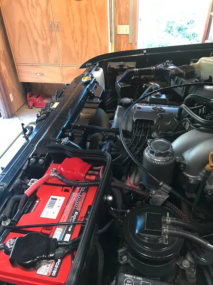

Progress has been really slow.
But I did get some stuff done. all new fan and AC belts, radiator installed with fresh coolant and foam in the gaps, oil and filter change, Battery and battery reinstalled.
Fired her up and she's running great. Set the hand throttle to 1200 RPMs and let her run. The temperature gauge went to 184* and then the thermostat opened and she dropped back down to 169*
Then I let her just sit there and idle ( 800RPMs ) for about 20 minutes, temps bounce back and forth between 169* and 171* about 10 degrees cooler with the new 10% overdrive pulley :)
I also order some used LS400 horns off of Ebay. At $40.00 delivered there a great upgrade over the wimpy stock 80 horns.
There a simple plug and play upgrade, wires literally plug right in and they bolt right up with a small modification to mounting tabs.
Sound improvement is night and day over stock, very happy with these.

engine is surprisingly CLEAN!!!

Man that's a clean engine bay. @FMC80 is probably going to print it out and put it on his wall.

Old pic and engine bay definitely not as clean!

what is next to the dipstick?
remote mount oil filter with an area to fill oil? or a power steering fill point ?

That's a oversized power steering reservoir with cooling fins and utilizes the same motor oil filter that 1FZ uses ;)
