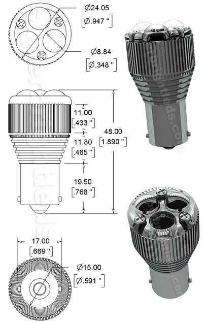

I've tried to run a backup LED bulb - the high output first gen i got did not fit. Specifically there wasn't enough taper to the bulb to allow it to seat and lock in.
So my main concern with the one you pointed out (and i'm a HUGE fan of cree chips)
not much of a "waist" and I bet it won't seat correctly...
Compared with the 2nd (or 3rd) gen of the ones i originally used:
the only output i see is "5W" on the JLC site. So potentially 5W vs 4W for hte ones i showed.
I'm all about LED's - see if you can find one with specs and measurements to make sure they will fit.

The fit is perfect !!
I took pics just now and will post tomorrow morning .
Sl33py I too had the same luck with other bulbs not seating properly and or not locking the pins like they supposed to, not the case here!!
These fit like oem one's do, n light up great. The light pattern is great around 120°
