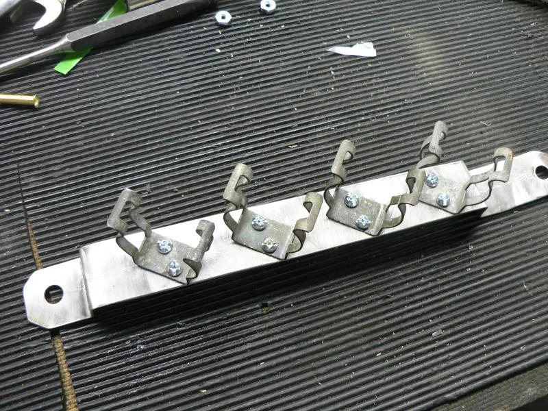

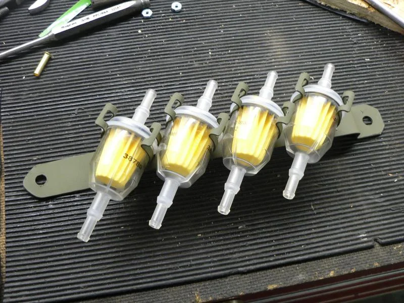

@ atomicshawn. I see you have organized those hose neatly. Now, why are there 4 lines: 2 diff, 1 alt, 1 starter?

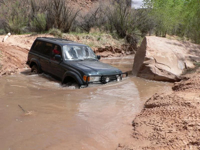

winstonclein-albums-internet-somehow-have-impressed-picture19538-diving-crossing-river.jpg
^^^Crazy picture. He needs to turn on his wipers ;)
Four lines: 2 diff, 1 t-case, 1 AT. Keeping them separate to avoid cross contamination in the event water is introduced some other route, say through a seal. Apparently it can mix with the oil, froth up, and blow it out the breather. This possibility is one of the other arguments why running it to the air box is a bad idea as some say it could foul the intake all the way into the manifold. Maybe on a jeep, but the way the ’80 box is designed it would take a gallon of fluid to fill the canister and get into to the engine. My argument is, if this happened the mess would be contained in the box vs. running down the firewall or in the interior of the veh as some have suggested terminating the lines. We’ll see. It’s an experiment.

So is that guy in the picture a few posts back creating a "bow wave"? ;) Seriously though, I appreciate your insight Jack. If you were in water deep enough that it was choking your engine to the point of stalling, and that was your only problem, that scares the **** out of me. It's the "it would only take going too deep once to ruin your engine" argument that has me leaning toward finishing this little project off with a snorkel.
In this case, that guy in the pictures's been pulled from the other side of the creek to cross it, but with the engine running. He has to get in and out of the water by himself unless the vehicle is unable to perform that. If that is the case, the LC will be pulled out immediately of the way.
In some other cases, it is not necessary to be pulled.
A bow wave? it'd be ideal in some cases, but:

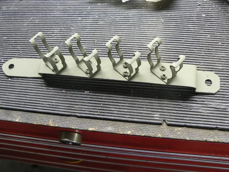

The next piece of the project
atomicshawn
Post some information on the filter and bracket.
