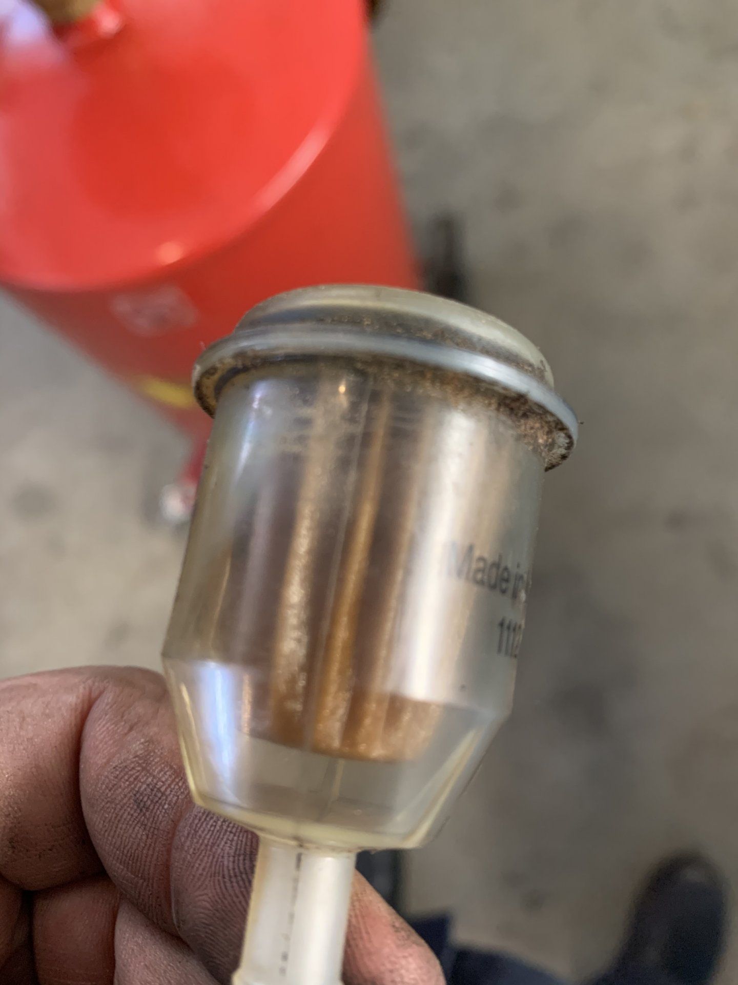

Looking over things today I noticed rear axle breather filter dark and oily
Clearly got some fluid migrated up into the line. The rest of the filters look fine. I changed diff oil a few months ago. Old fluid still looked new. Just checked again. Level and condition look fine... magnet is clean... no signs of water or overheating... Weird. Wonder what caused it? Over the years I’ve had it had it vertical 1000 times...
Can’t think of anything that would cause it. After a decade wonder why I got this now?
Anyway, line isn’t plugged. Checked all of em and everything is still breathing 👍
