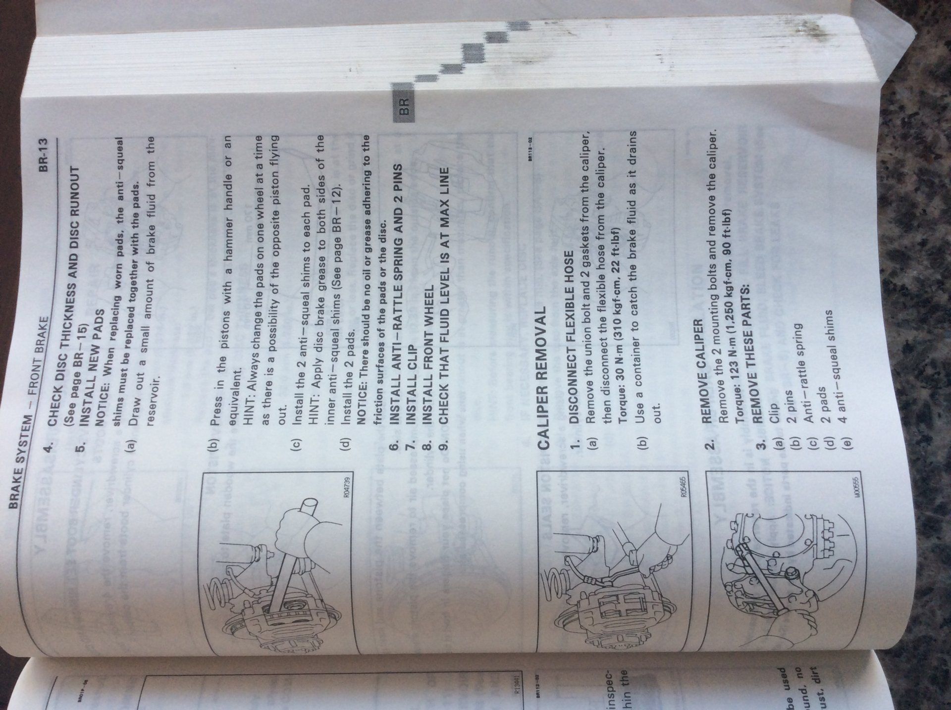

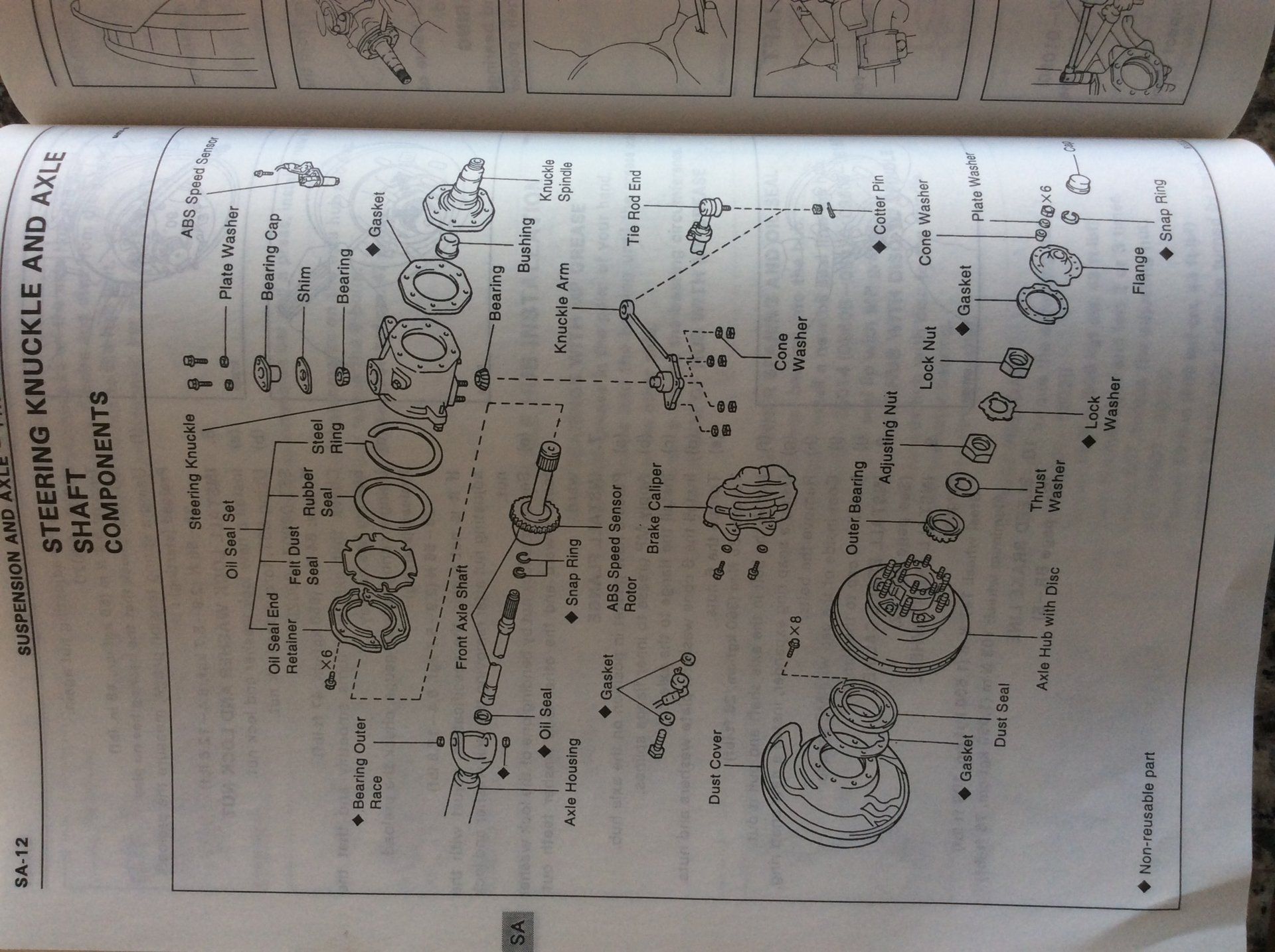

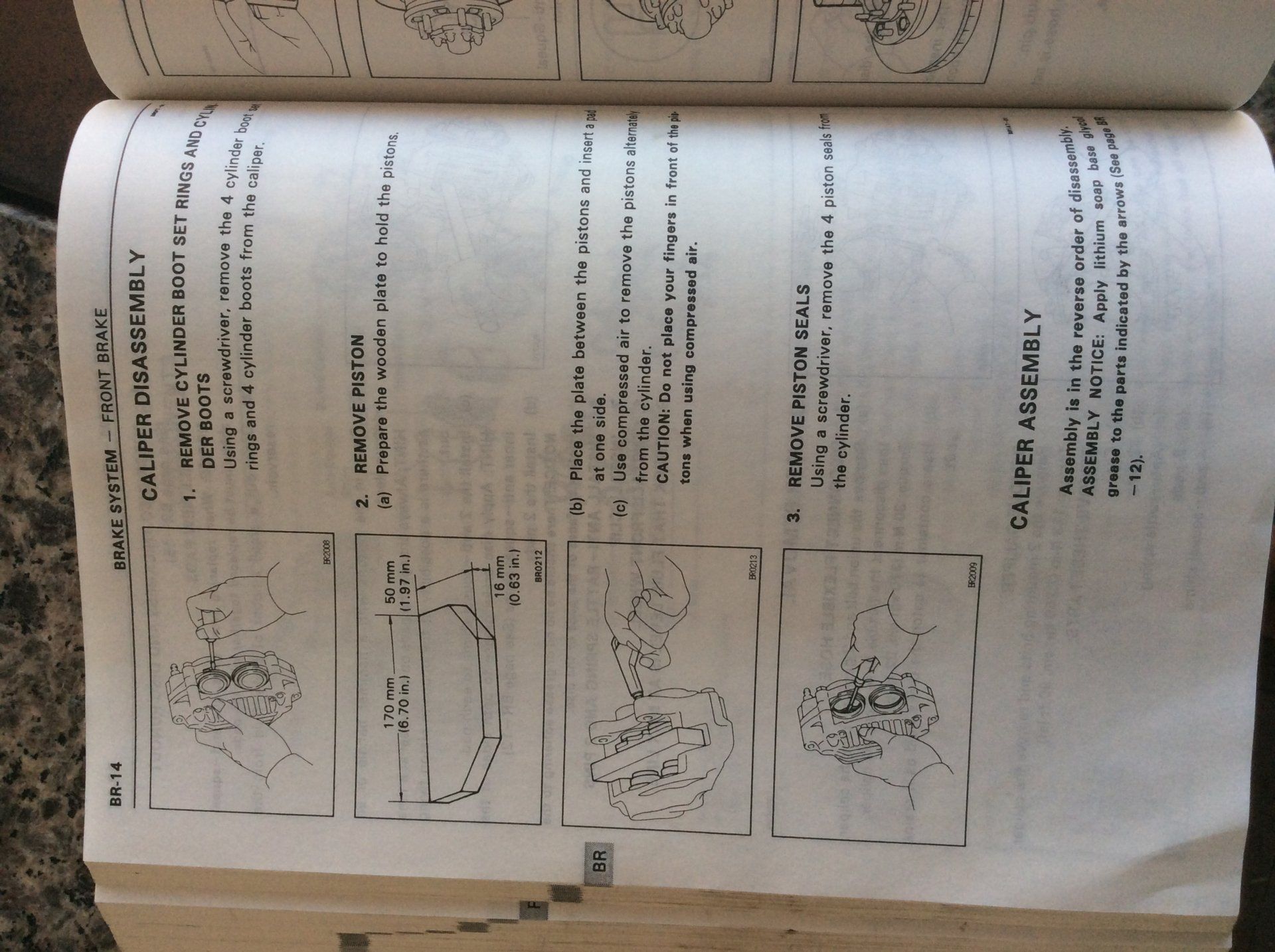

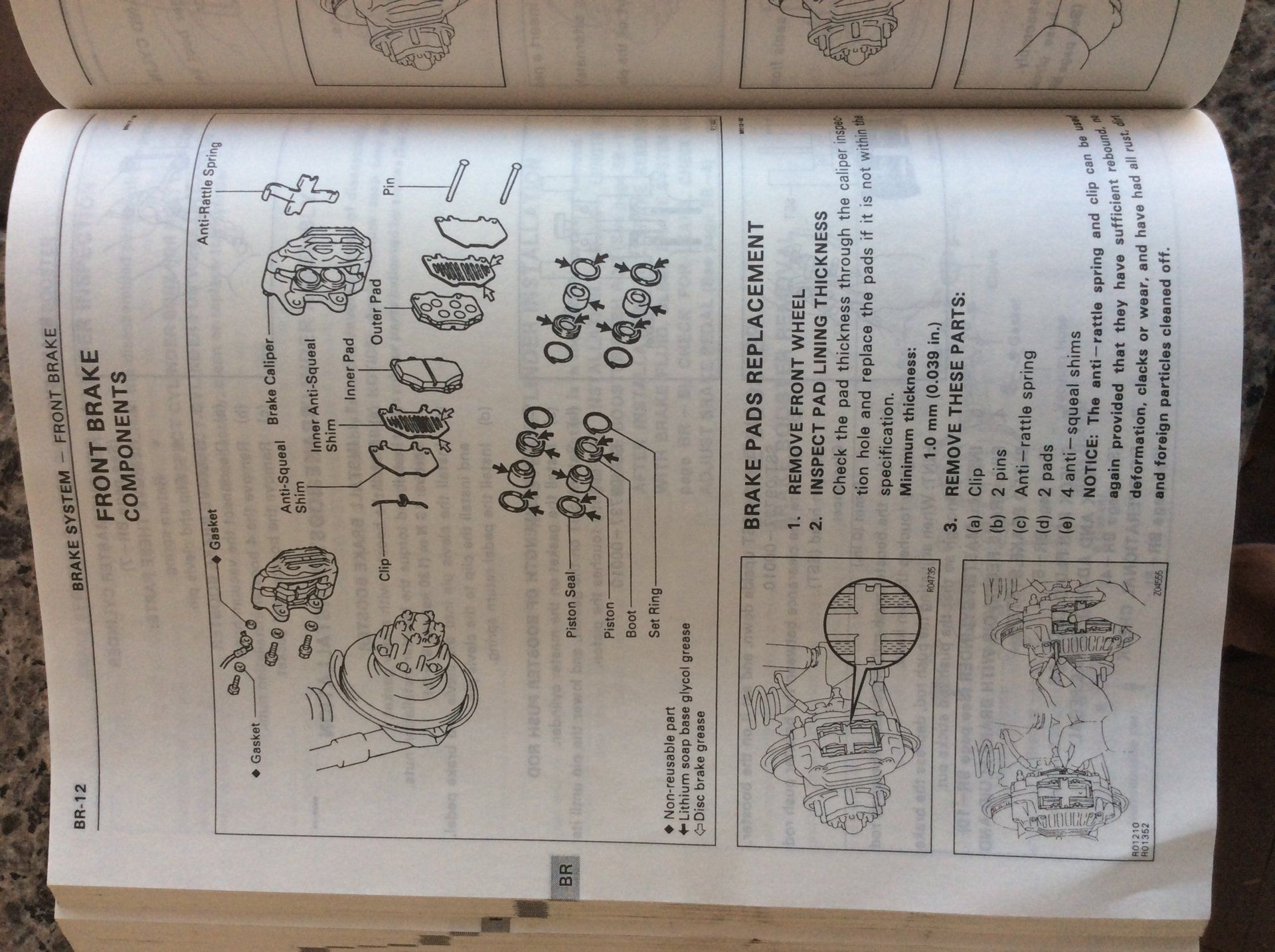

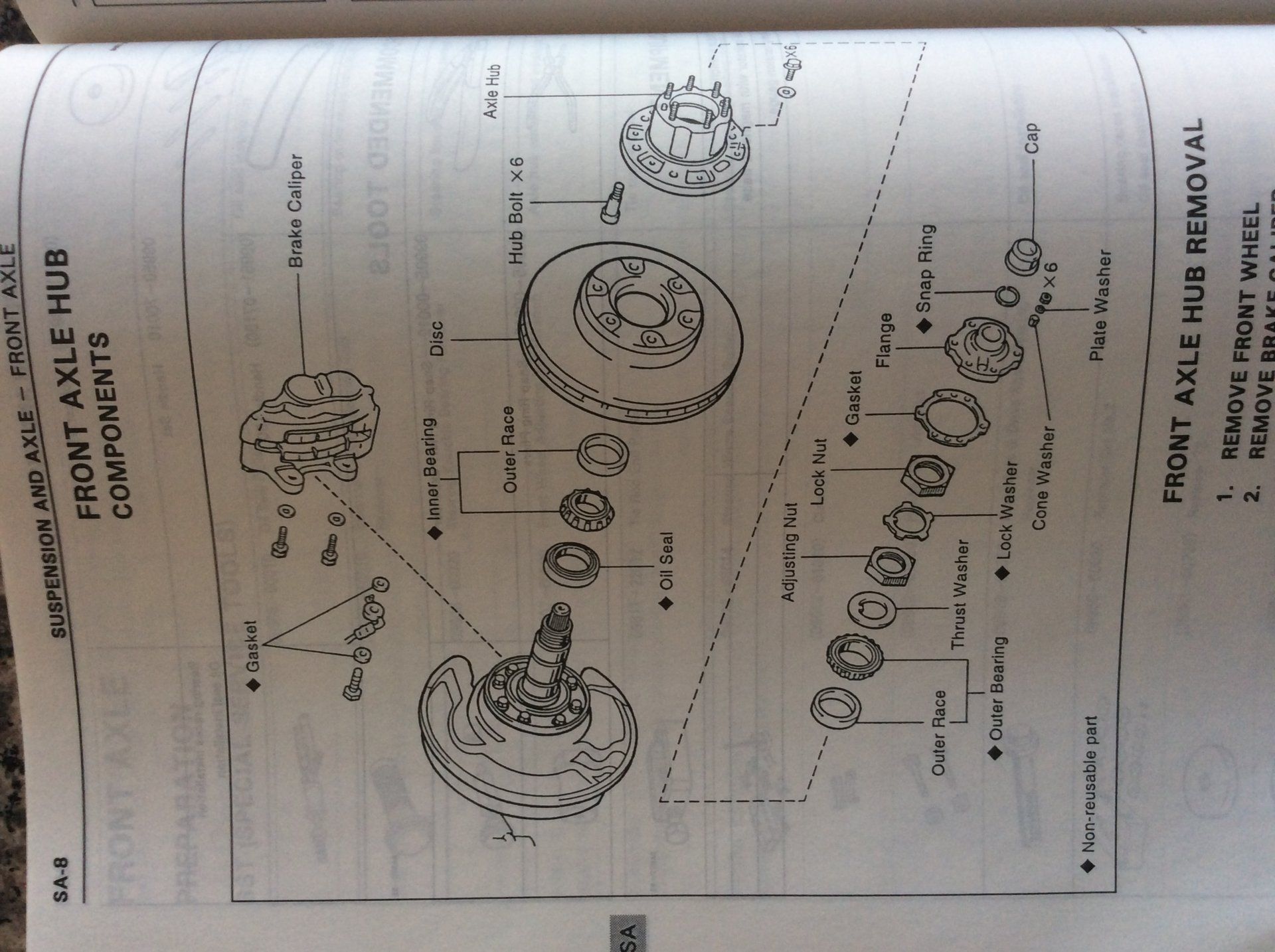

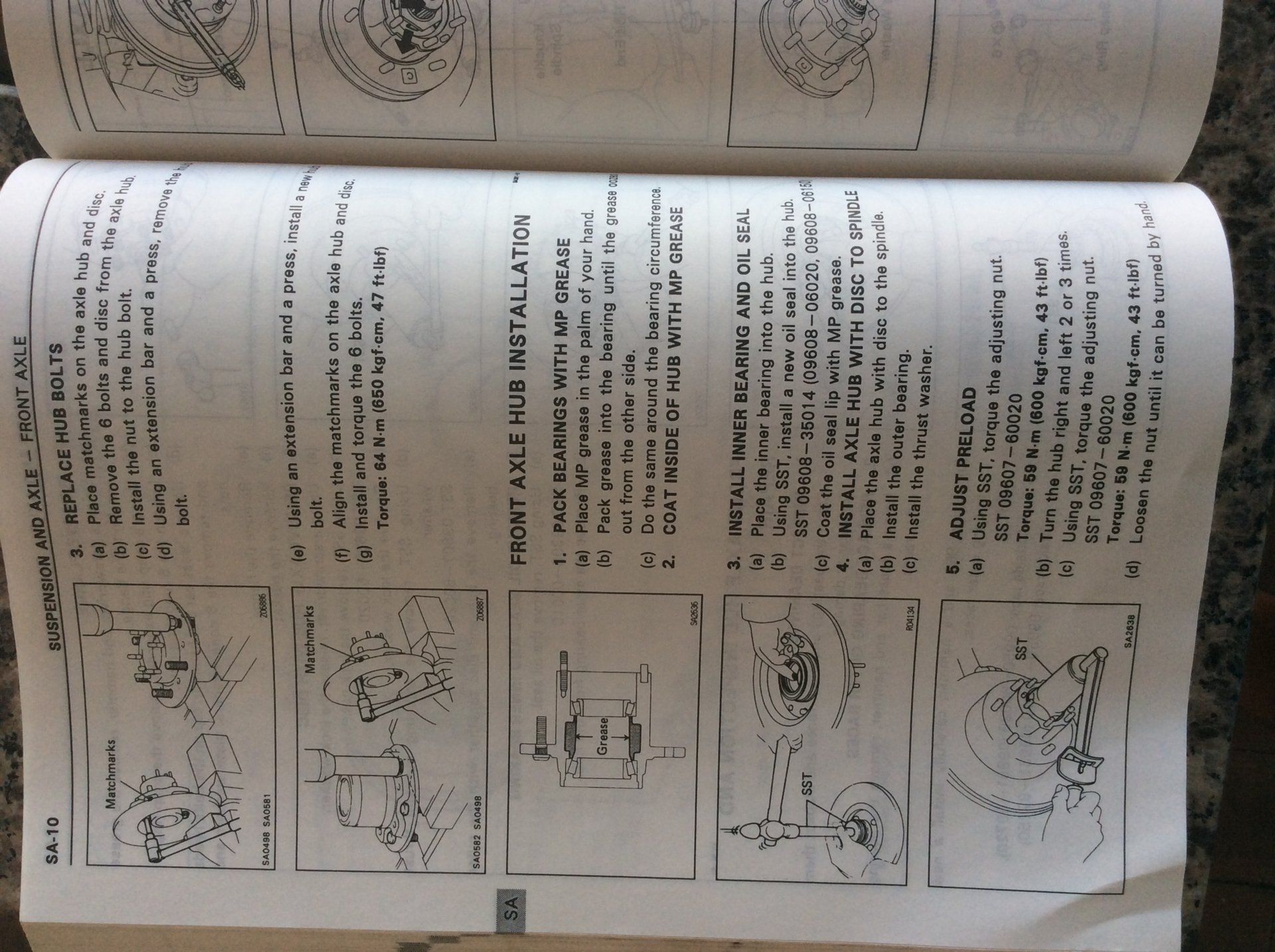

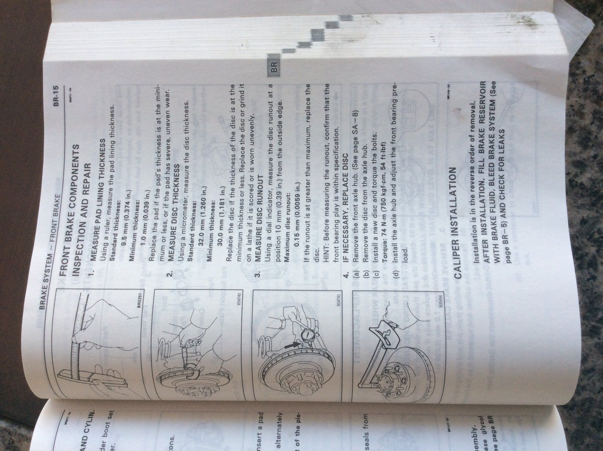

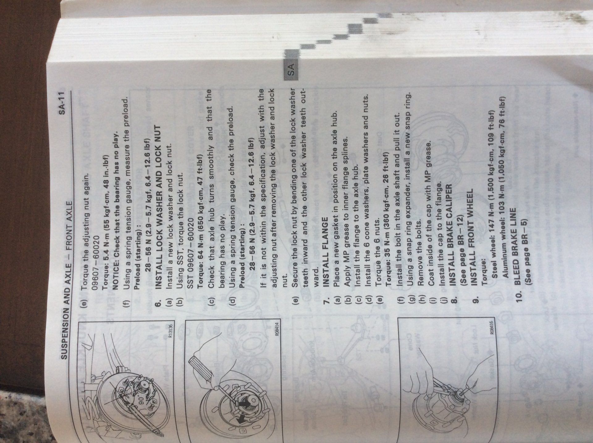

You need an FSM-
When reinstalling the hub you need to make sure the bearings were packed with grease, don't go crazy with the amount inside the hub but use a moderate amount.
You will feel some resistance from the wheel seal as it seats on the spindle. Then you install your washer with the notch at 12 oclock. The inner nut should be torqued to 45ft lbs to seat everything. Rotate the hub a few rotations ( brake caliper should not be on yet). Back the inner nut back off and retorque to about to 25-30 ft lbs. Spin the hub and make sure it all feels good. Install the lock washer, outter nut torque to 45ft lbs. Bend the tabs over. At least 1 for inner nut and 1 for outter.
Now install the cailper.
