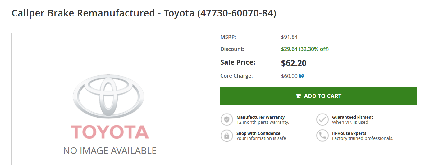

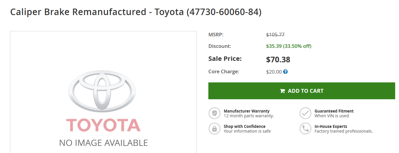

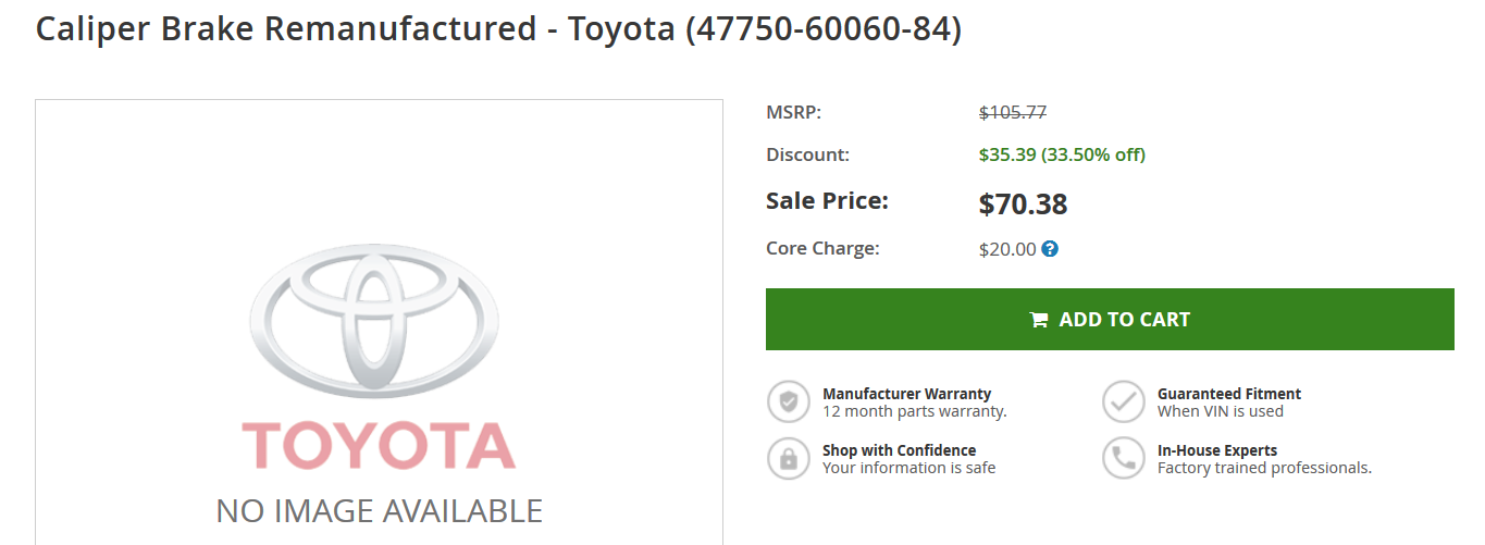

Latest word was, the Eclipse plant in Mexico, which supplies both Napa and Toyota, is running behind. The screenshots I posted are from McGeorge, taken about a minute before I posted them. Best to call them to verify availability.
