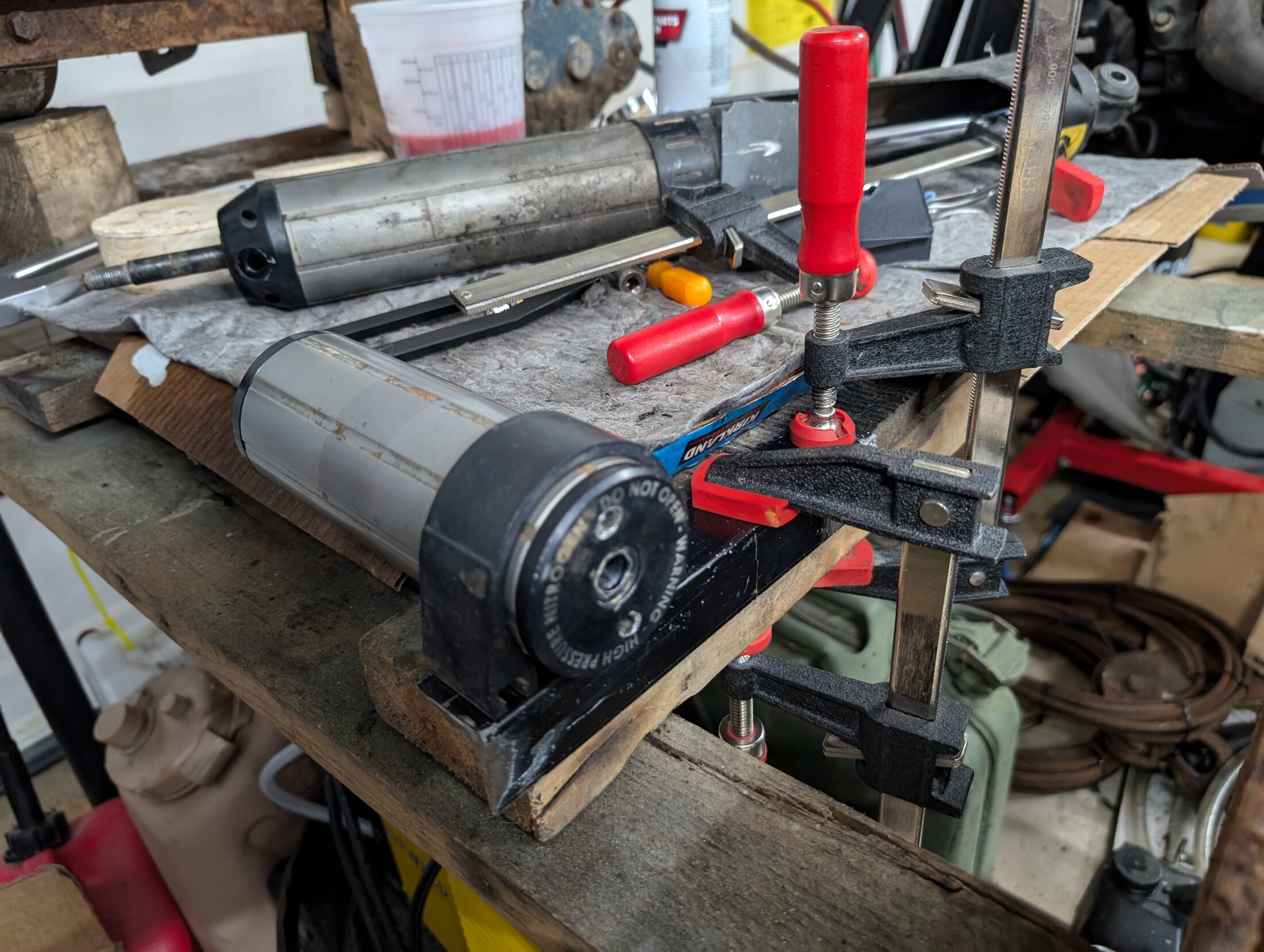

I ended up making my own pin spanner because the one I bought from ebay, we'll you judge.. Also you'll need a 38 or 39mm 'blind inner bearing puller' to grip the inside lip of the IFP, since there is no threaded hole like other brands.
While I wait on the hydraulic shop for my hoses, they said they'd have to special order the fittings..
The previous shop had a hell of a time getting these caps off and mangled the pin holes. Since they had them off, I figured this would be much less hard for me.. Or maybe they didn't actually get them off.
you just need to torque it while opening it so use some leverage but be careful not to ruin the holes more.. well im not sure the length of the hose. but it usually takes just a little bit below a liter of oil.. but you really need to clean the whole thing well

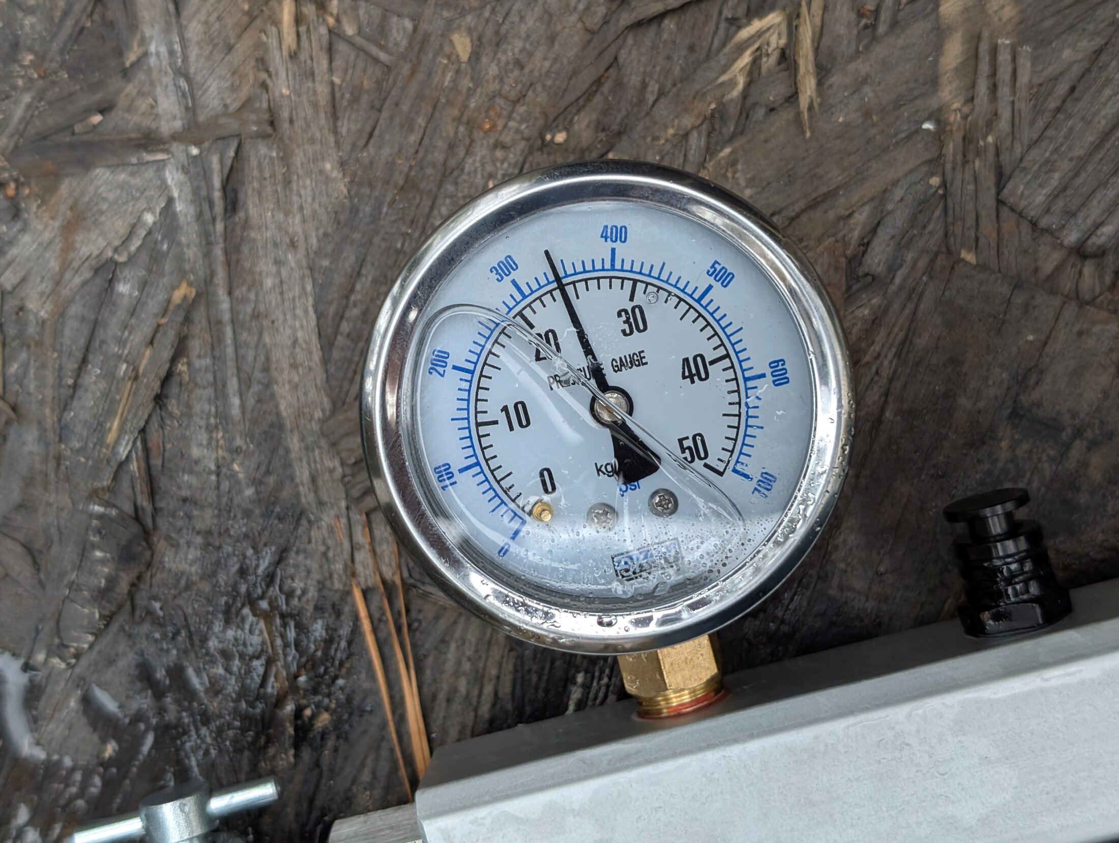

Hopefully this is the last from me on this. I bought a no loss gauge capable of 700psi($70), the wrong size 1/8npt to 1/4 flare adapter($5), and grabbed 1/4npt to 1/8npt reducer from my stash. Talked my HVAC Tech neighbor into letting me use his nitrogen. Unfortunately he doesn't have an adjustable regulator and we were too lazy to get his gauges hooked up so we over shot a little at 340psi. I figure I'll check the pressure again later and the little bit of loss(from the no loss valve) might bring them down close enough to spec.
View attachment 3776351that is too much try to drop it alittle anything from 240 to 290 is good
