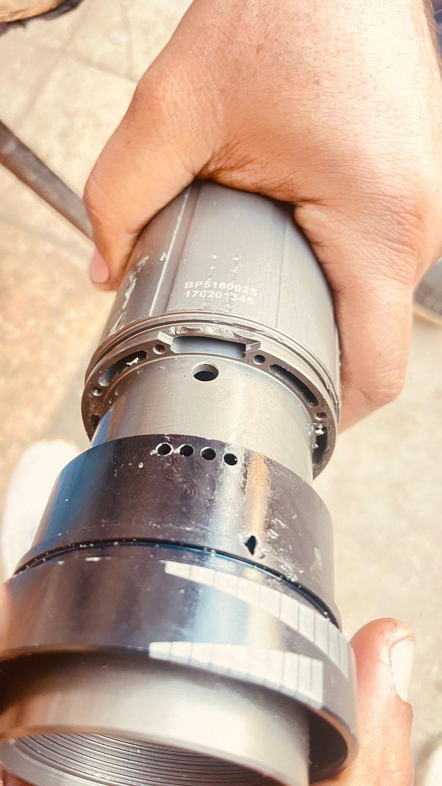

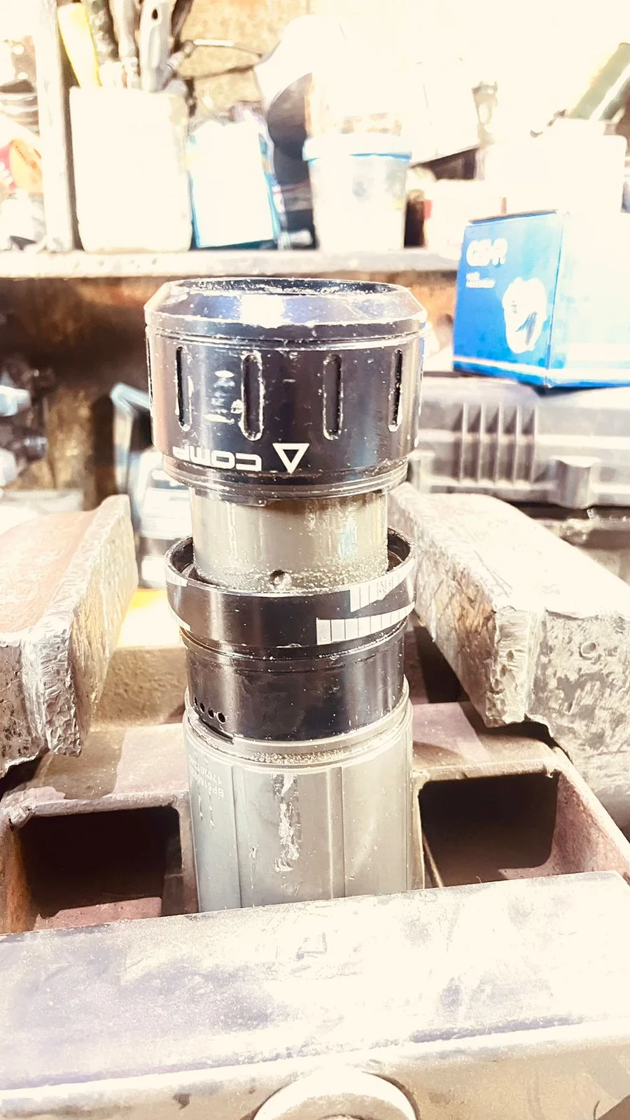

So you take apart the shock as you would any other 2.5 shock.. then.. using the adjuster spanner that comes with the kit.. you rotate the compression adjuster all the way down then keep going as it will start rotating on its self like a bottle cap until it comes completely off.. there are 2 oil seals that are 2mm thick on tthe top of it and one also 2 mm i think or 3mm in the middle of the compression adjuster once taken off..

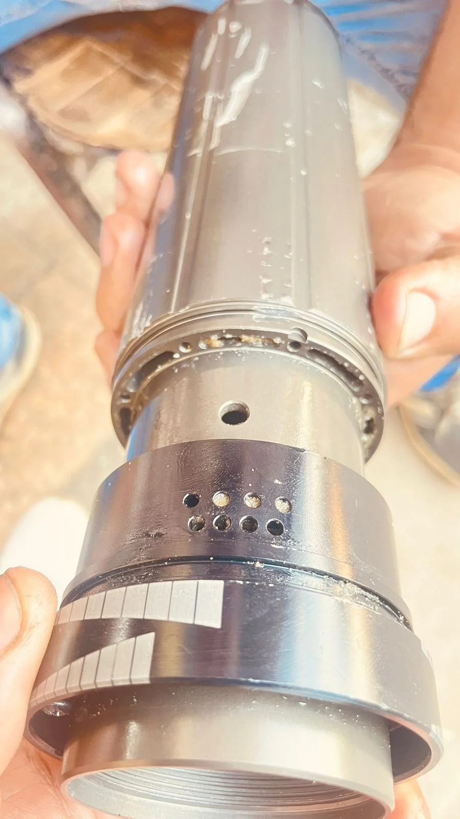

Then it would look like in the picture.... so to take apart the part where it shows the compression and rebound levels.. youll need a T10 hex screw set.. you will take off 4 screws that come up with shimlike spacers (2 on each screw). that twill then reveal a second layer of screws, same deal just take them out but becareful with the orientation of everythting going in and out because they have to align with the bypass tubes in a certain way.. here is a picture of the screwed ...
After taking both rows off. the whole thing comes out with the rebound adjuster that has 4 2mm oil seals 2 on the top and 2 on the bottom and as far as i can tell nothing in the middle... also here are simple pictures to understand the allignment
The 4 holes on top allign with the large bypass tube
and the 8 holes in the bottom allign with the small bypass hole..

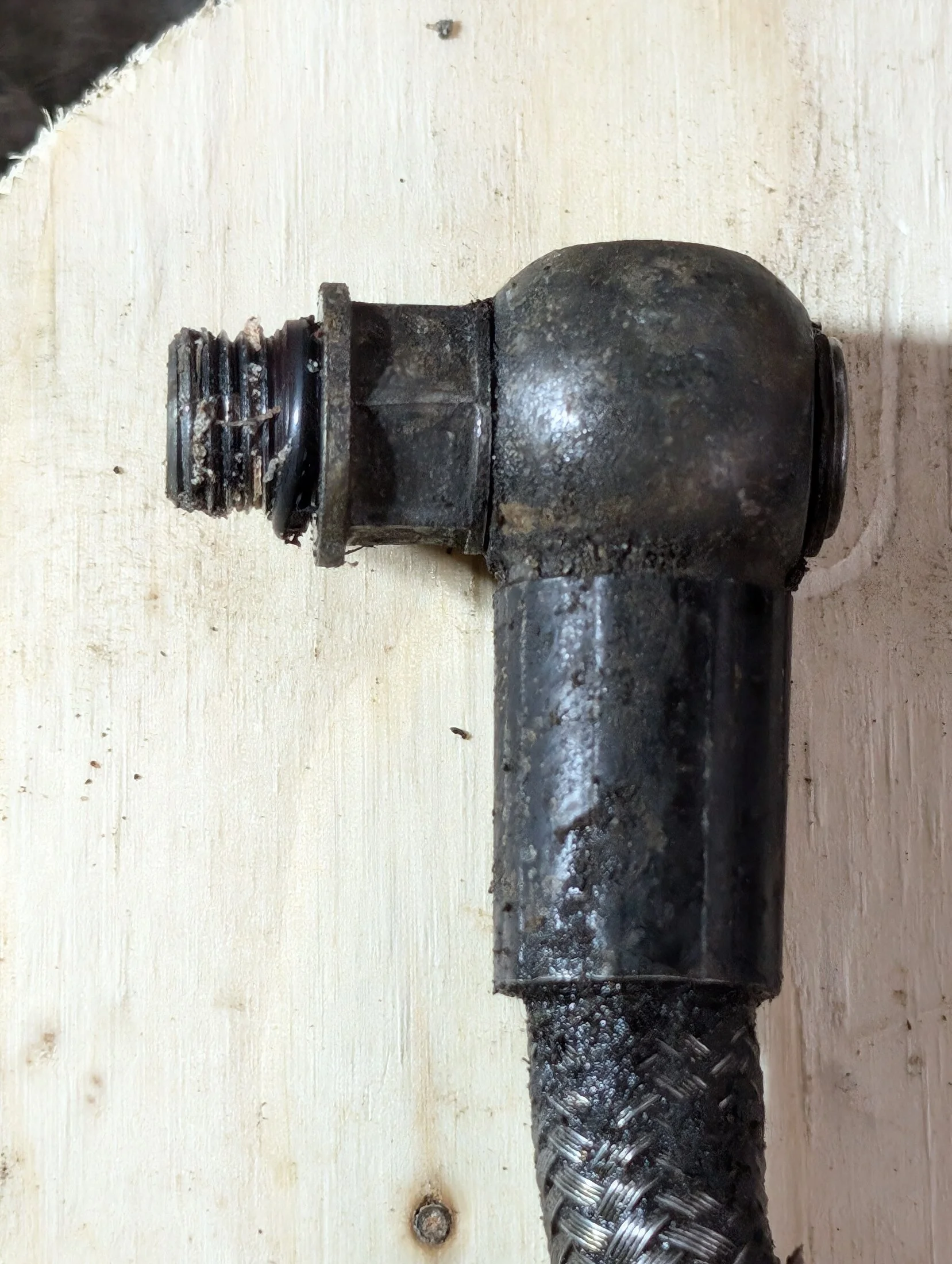

My hose I suspect is leaking. I had taken them to a shop and they said no they'd give it a shot but no warranty because no OE parts were available. Well I get them back and the hose is still leaking after driving on the street, no offroad.. I'll take them to a hydraulic shop and see what they can do. Saving this thread before big secret shock manufacturer takes it down.

Do you by chance know the thread and banjo size on the hose? I'll be taking mine off to measure but figure you might have beat me to it.
I redid it for me and a couple of people before but honestly I don’t remember the size.. I went to the hydraulic factory where they make them with everything and we fitted everything there so they can clamp the fitters and make sure everything is pressure tight…I recommend you do the same

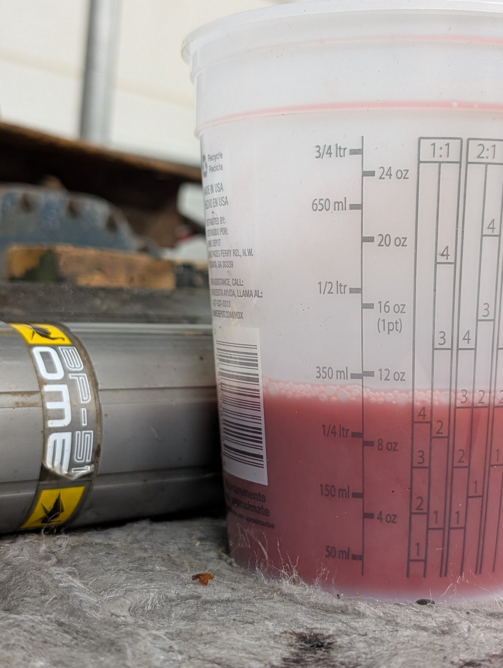

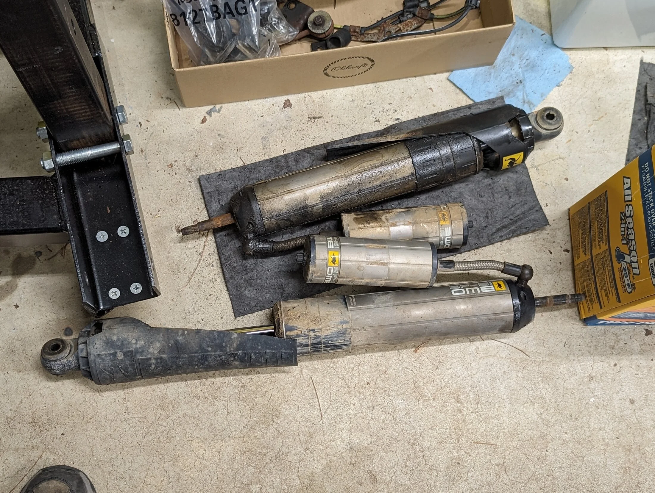

I didn't see oil capacity measured, so here's what I could get out of my one that leaked(just over 12oz after getting the hose all the way off and cycling the shock more). These were "rebuilt" by a shop already so this isn't factory capacity.
And the fittings measure to be oring m10x1.0
While I wait on the hydraulic shop for my hoses, they said they'd have to special order the fittings..

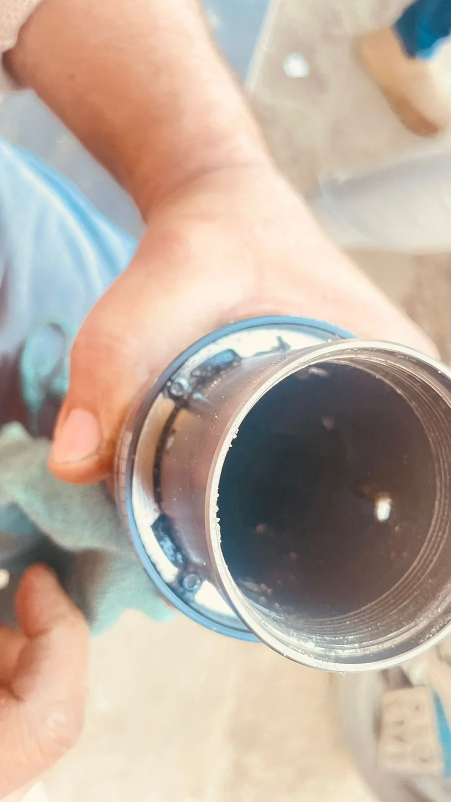

The previous shop had a hell of a time getting these caps off and mangled the pin holes. Since they had them off, I figured this would be much less hard for me.. Or maybe they didn't actually get them off.
