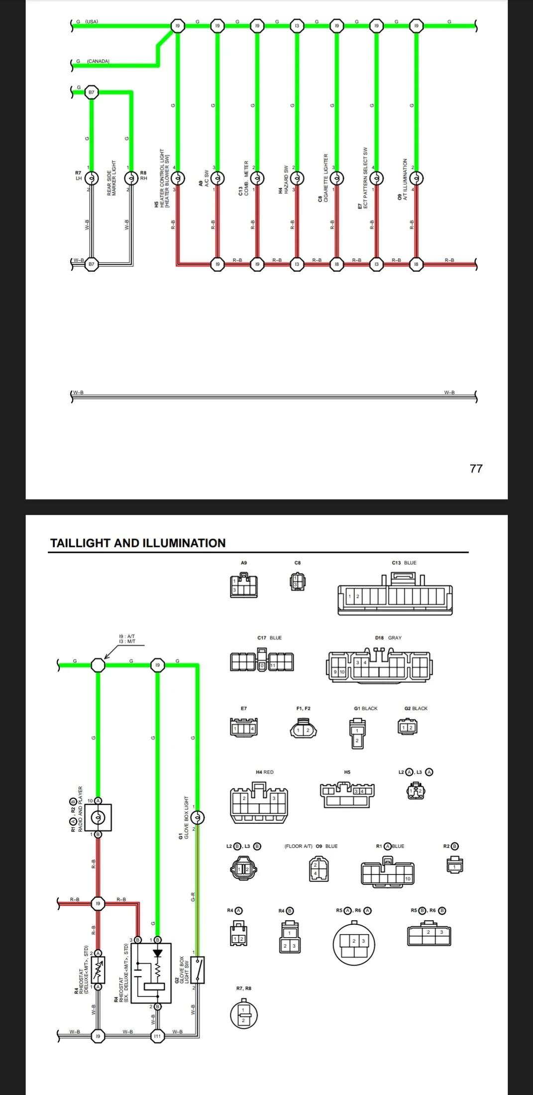

is the ground side good?
is it one of the ribbons that was damaged?
I have a different cluster from the one I posted the damaged pictures of. All ribbons are good on this new cluster. I do get the Brake, Battery and CEL lights when the ignition is ON but not running, so I assume ground is good for those lights to work?
those all run different ground paths.
illumination grounds through the rheostat
here
Thanks for the help with my cluster lights. The culprit was in fact the Rheostat with a bad ground. I pulled one out of the parts truck and tried it and all the lights work. So the SR5 cluster swap is complete. Nice to have an oil pressure gauge along with the others and a tach. Success!
