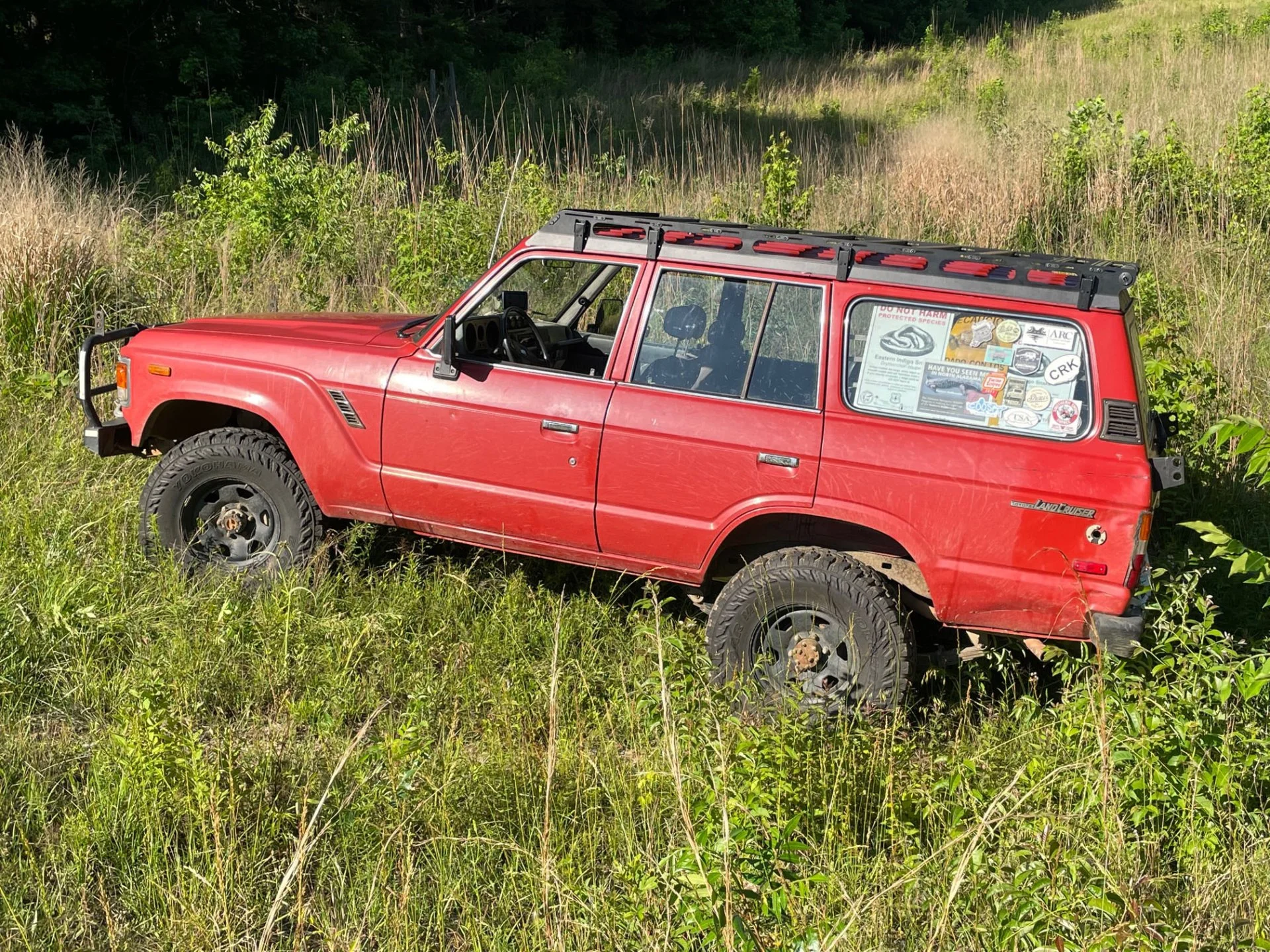

I ran a homemade rack on my 60 for 8-10 years and found that have a roof rack was very useful at times. The old rack needed some work so I pulled it off but as I looked it over I did not want to reinstall it. Having seen the Bowfin rack I knew that was what I wanted to go with and I'm glad I did. The Bowfin has a low profile, solid full length gutter mount, and is extremely versatile. Patrick @dogfishlake has been great to work with. I installed it a few weeks ago and immediately put it to use.

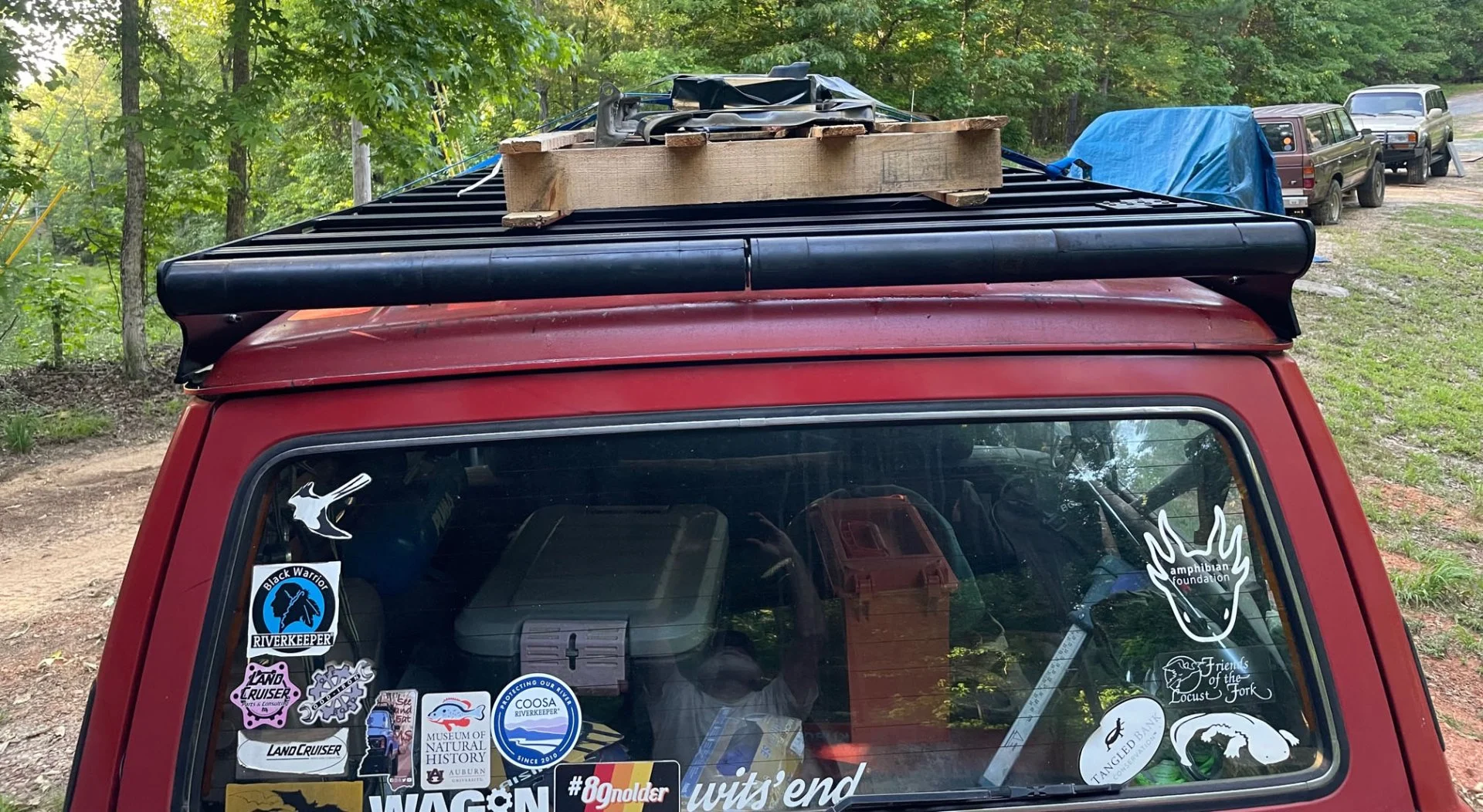

First use was to deliver a palllet with a Cruiser part for shipping. The pallet was bulky but not heavy and the addition of the roller on the rear of the rack made placing the pallet on the rack easy. At first I was unsure of the need for a roller but having drug multiple items across the rear of my roof over the years I think having the roller is a very worthwhile addition. It should be very useful when loading canoes this summer.

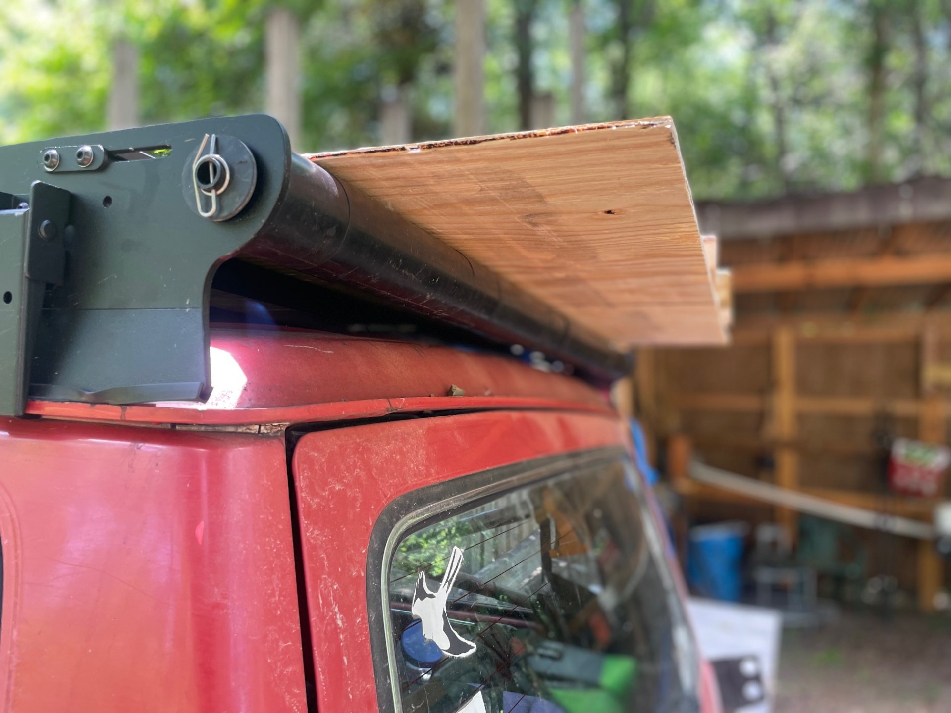

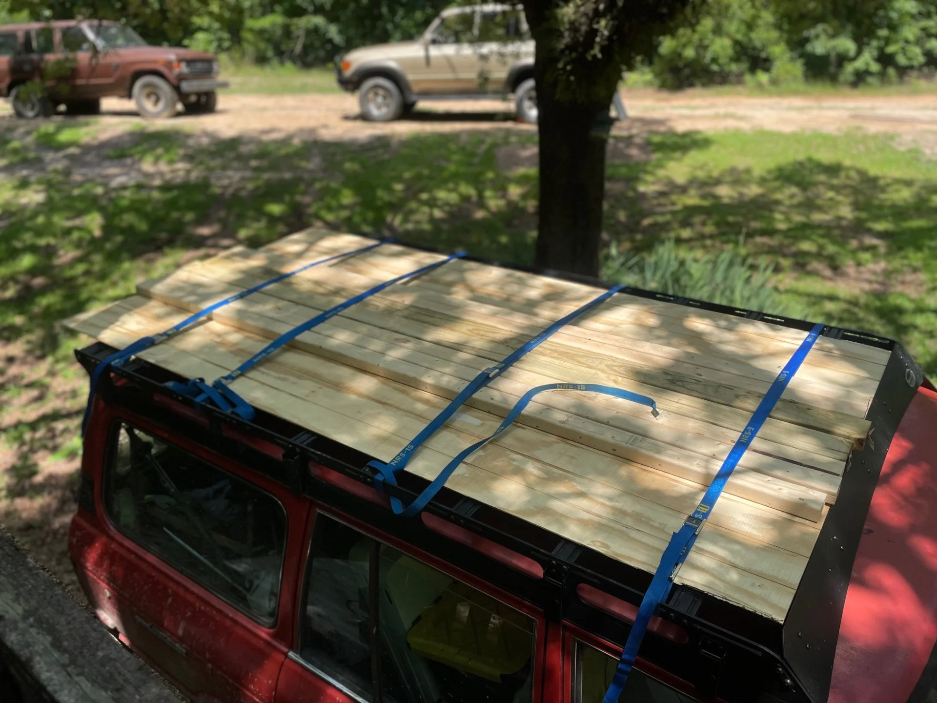

Using the rack for a light lumber load was preferable over a trailer and a sheet of plywood fits on just right with a little overhang. Again the rear roller made loading much easier.

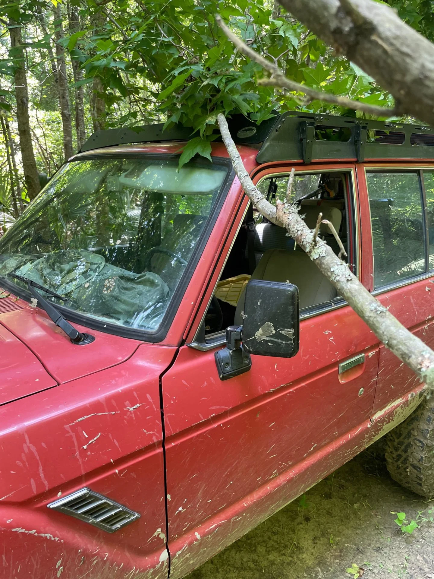

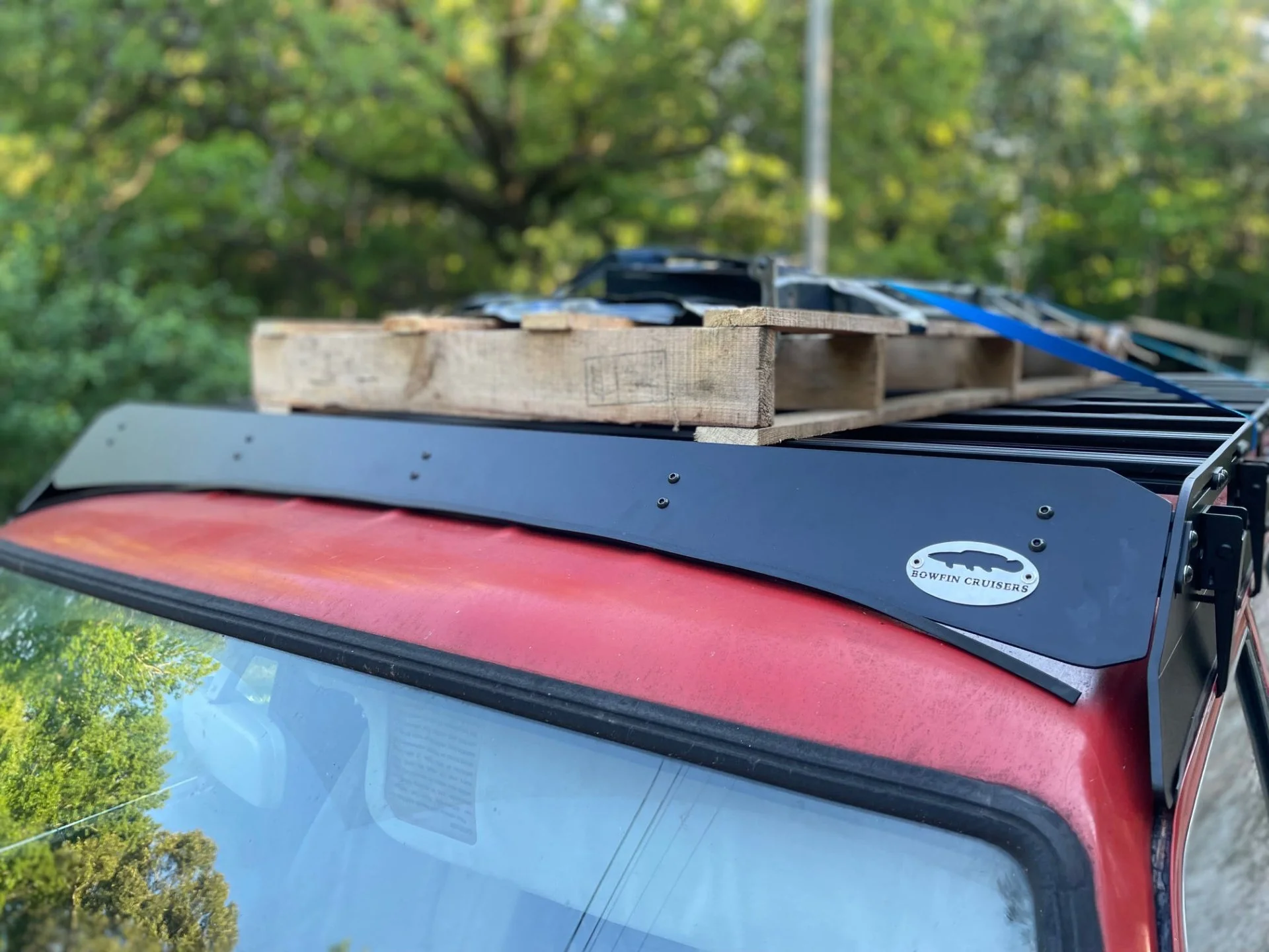

I sometimes get into spots with low hanging limbs and the most feasible answer is to push on. The low profile plus front fairing on the Bowfin allows branches and small limbs to ride over the rack without hanging up.
The bowfin rack has pushed many branches out of my way along trails. Works as intended.

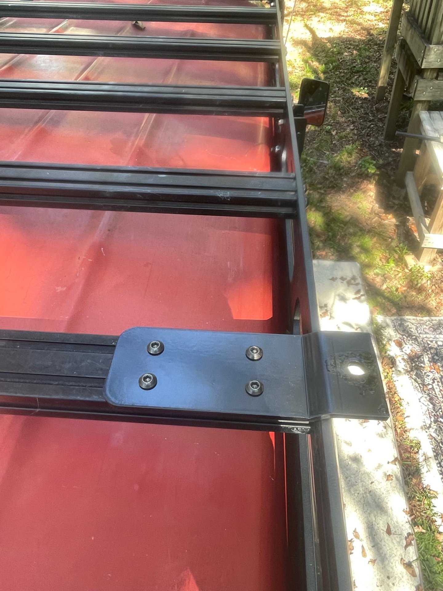

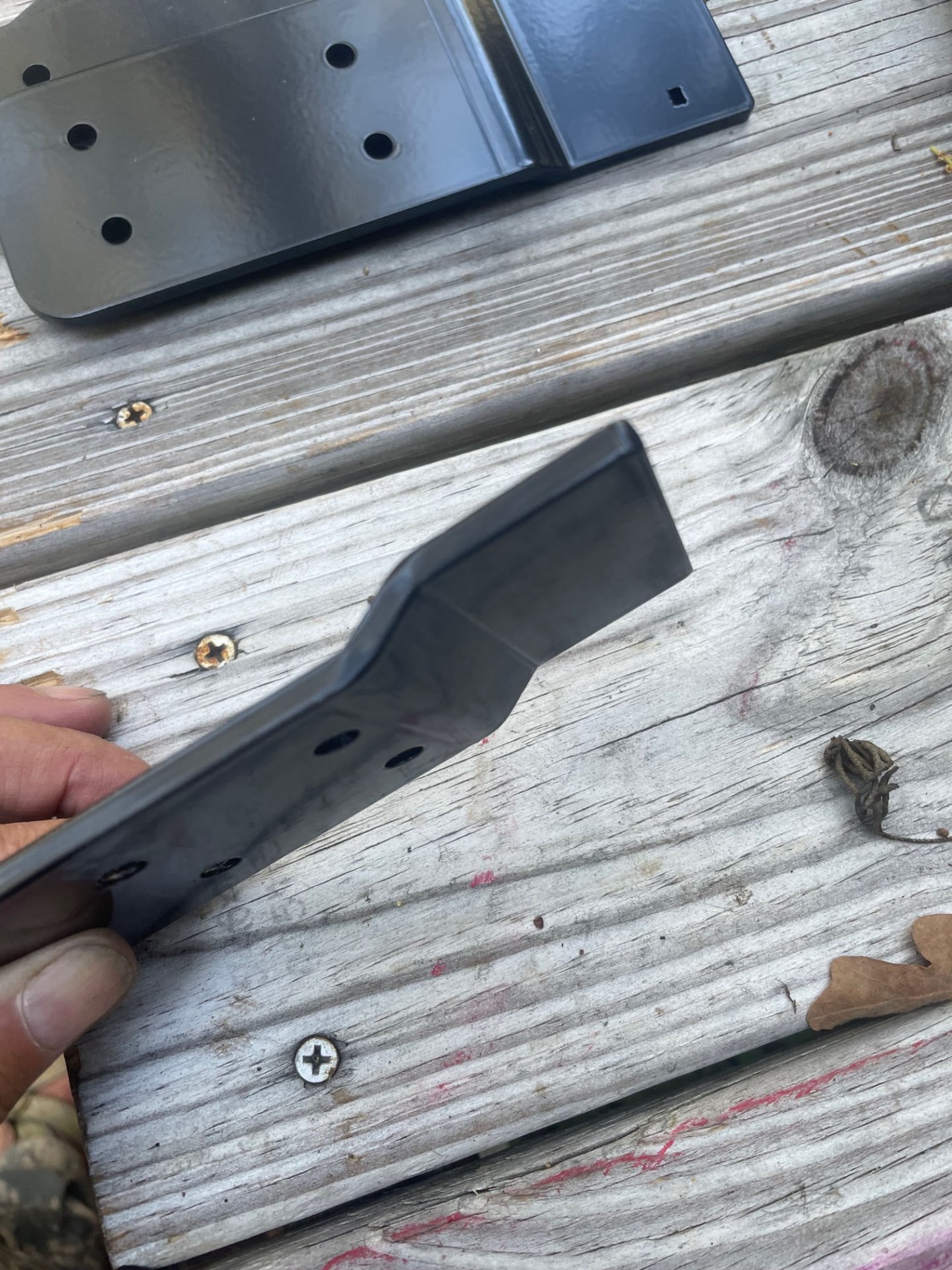

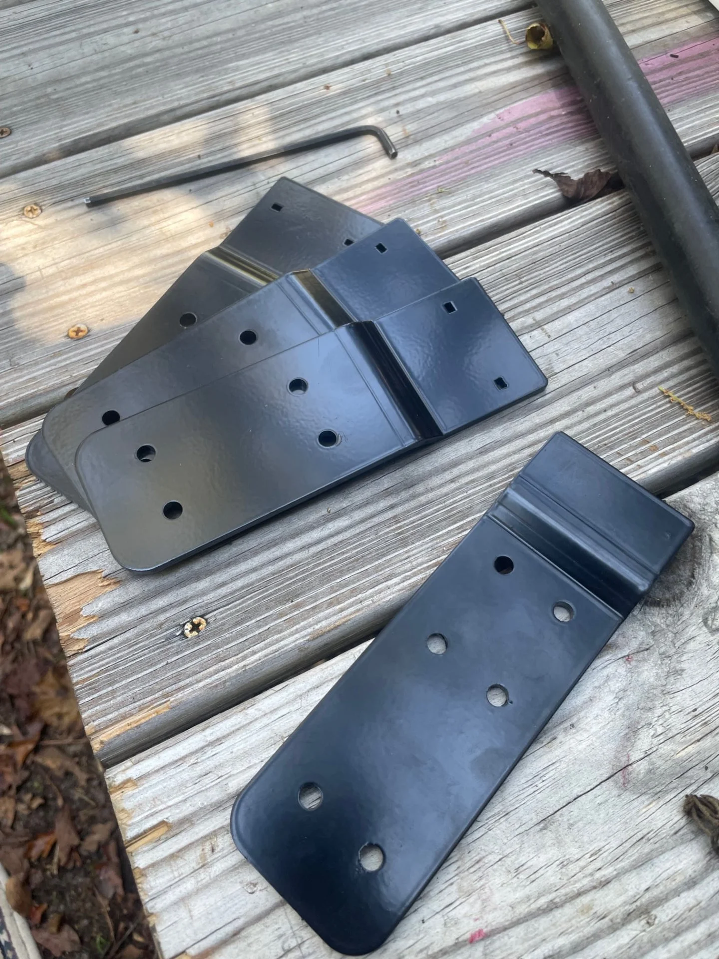

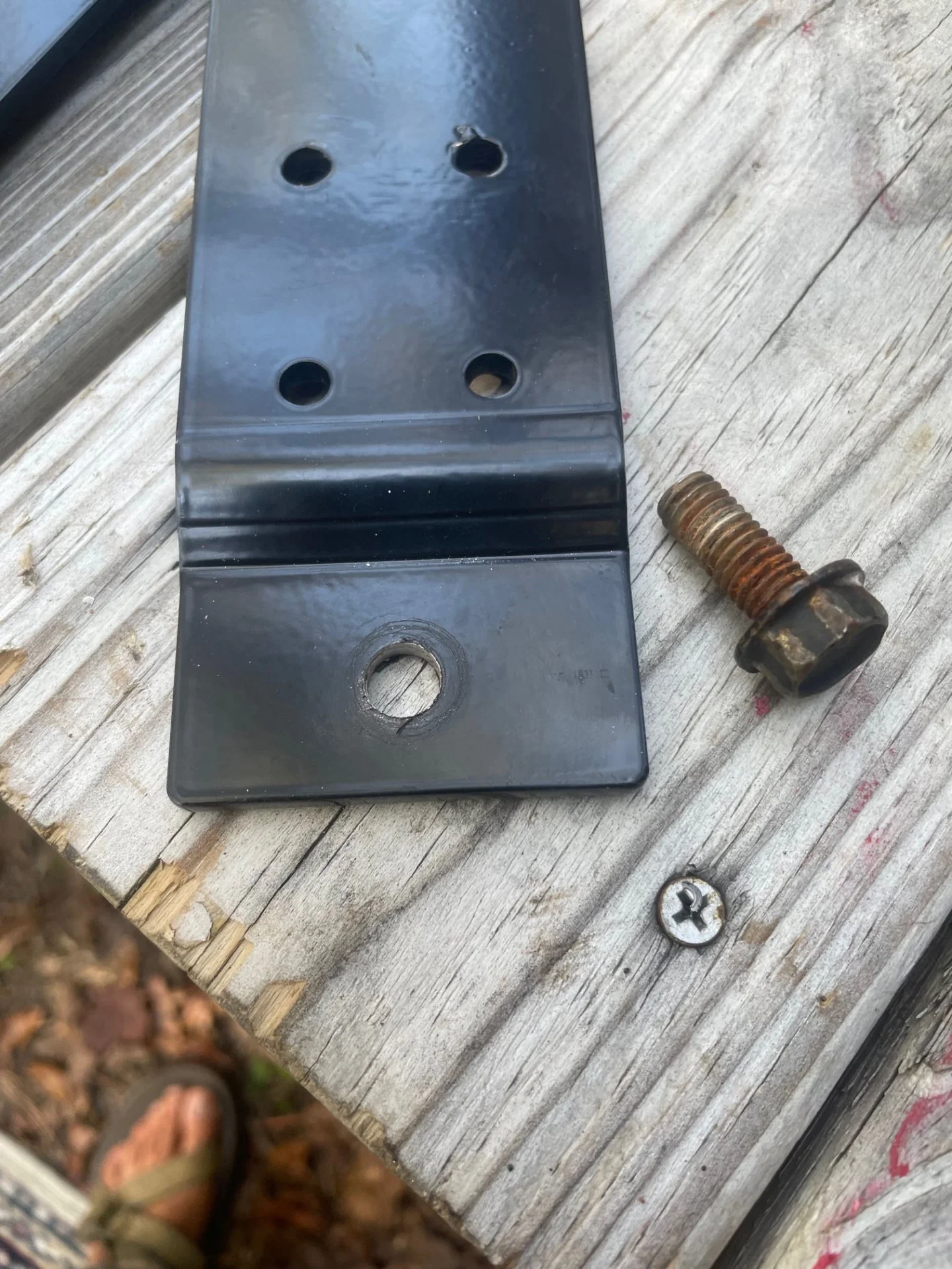

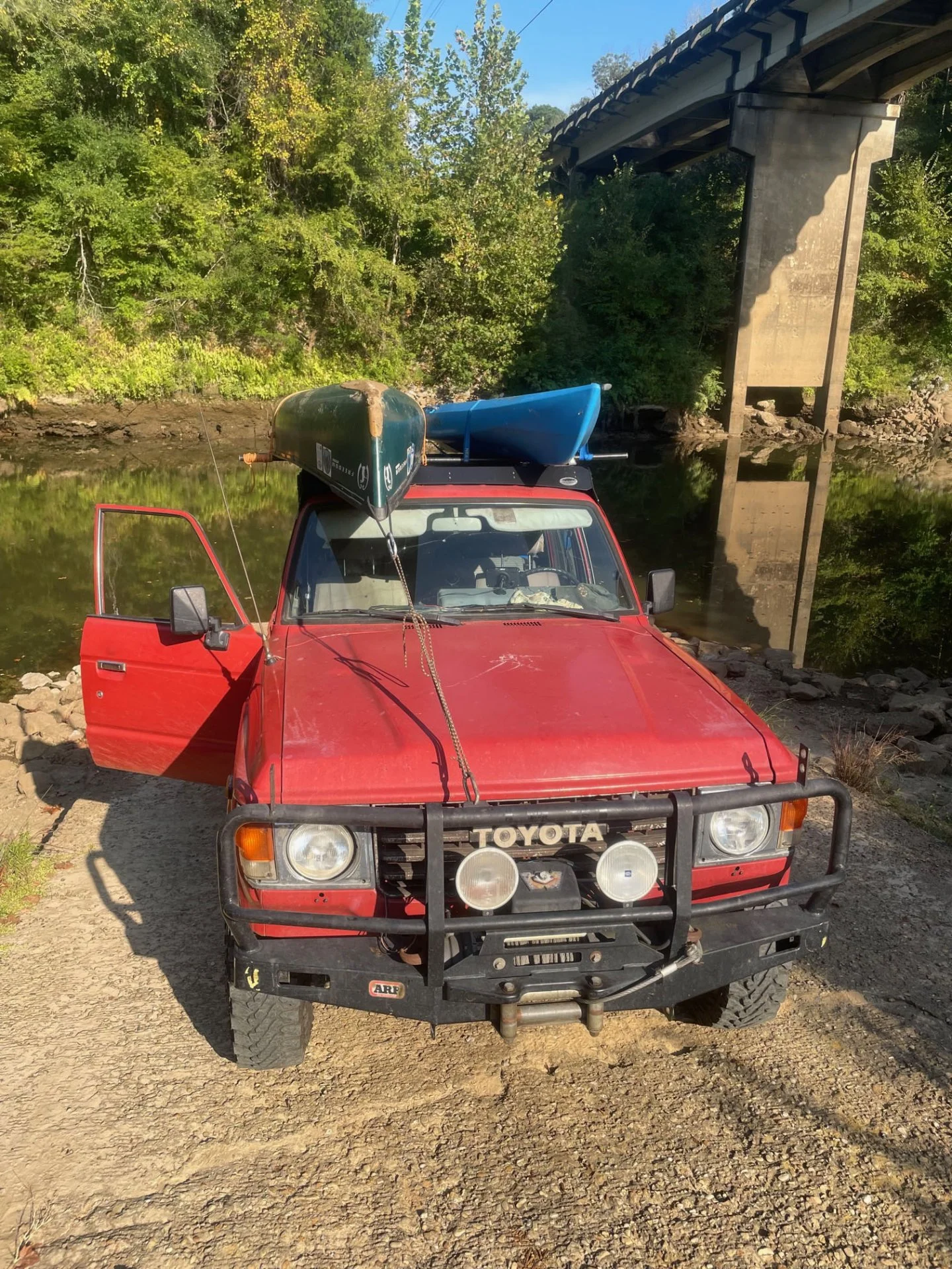

My previous homemade rack was set up for bolting on Yakima crossbars to carry a pair of canoes. Patrick has on the Bowfin website awning brackets and I thought the horizontal section with the slight rise to clear the side rail would work as a mod for mounting canoe crossbars. I was able to get two pair of only the horizontal plates and test them out.
I measured and drilled a 3/8" hole for the Yakima bolt to pass through and bolted the plates to crossbars.
Bolted on the Yakima bars which fit great and now provide the capability to carry two boats.

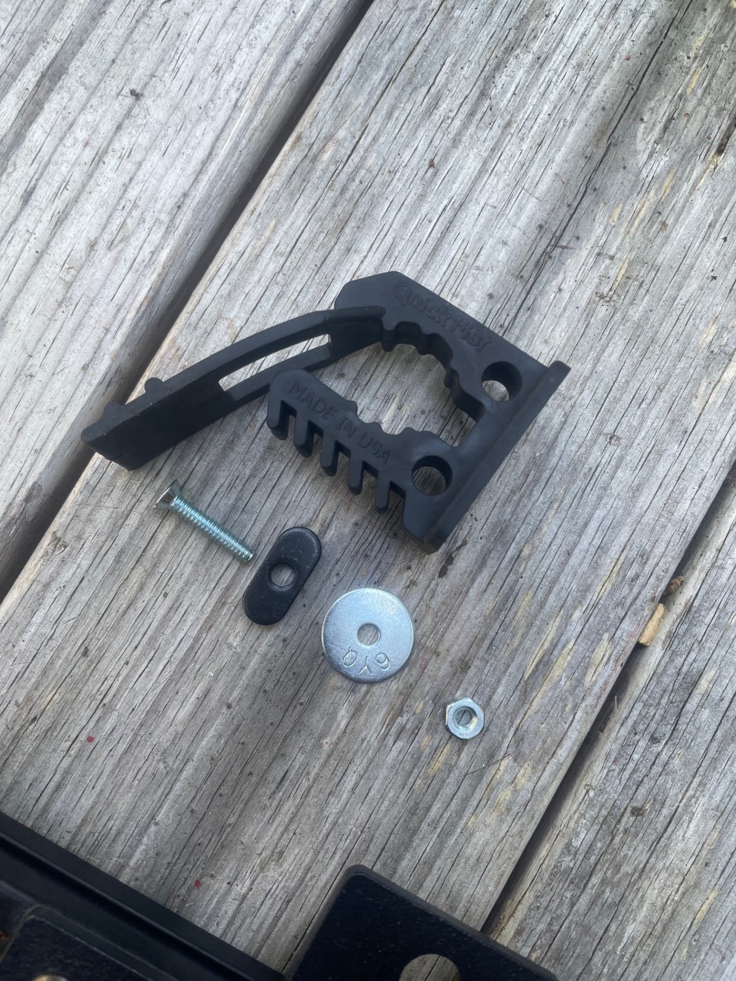

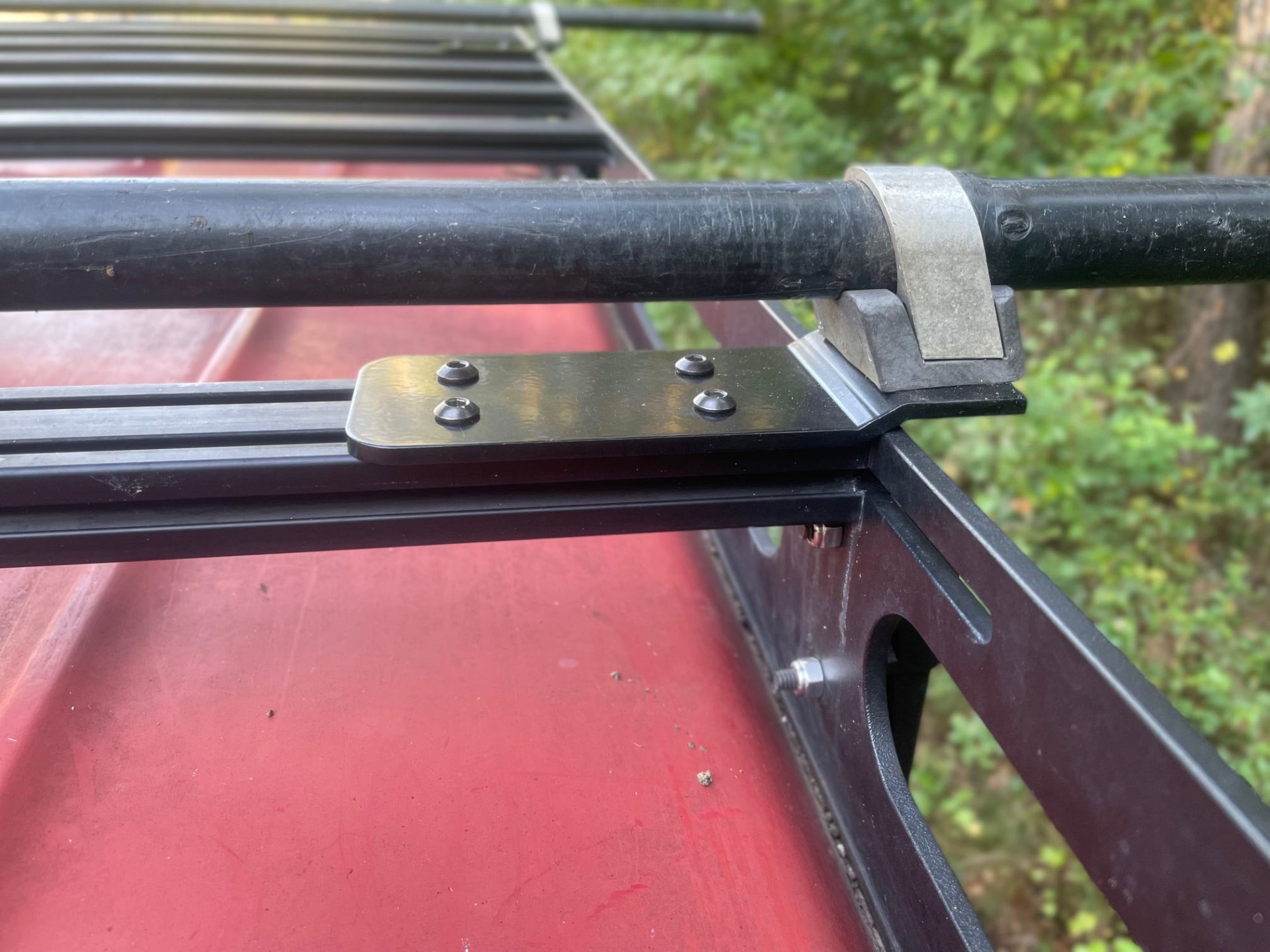

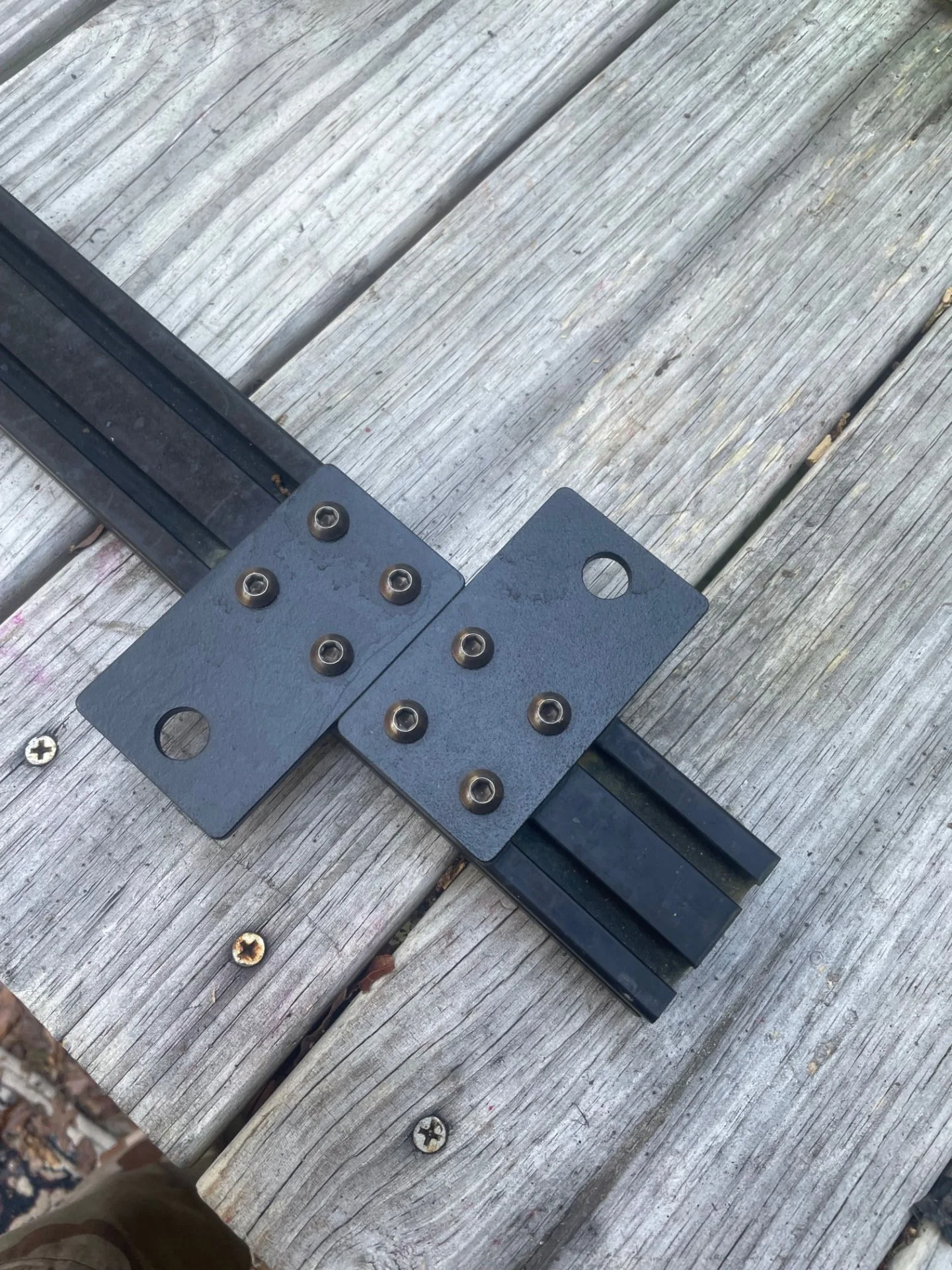

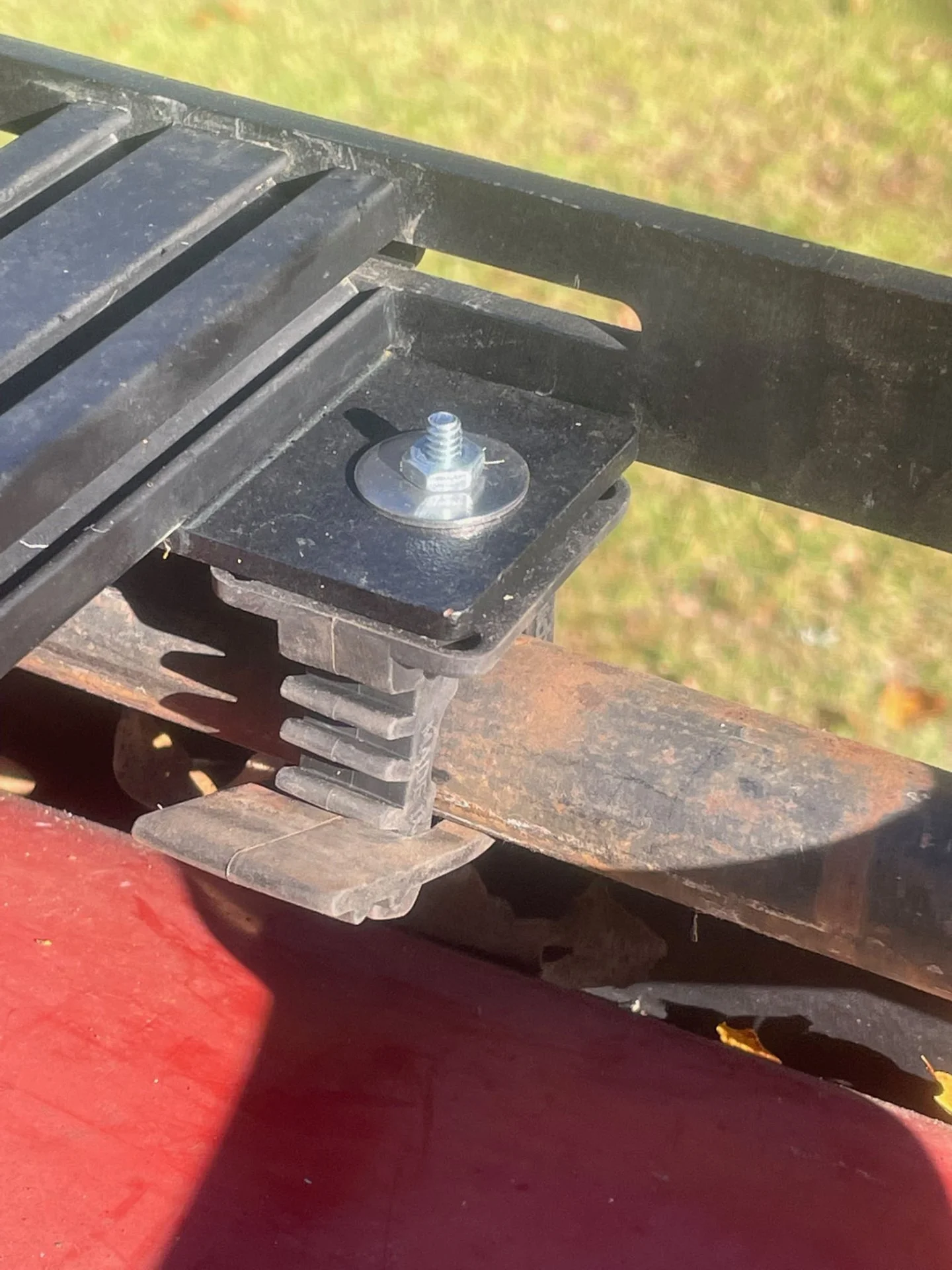

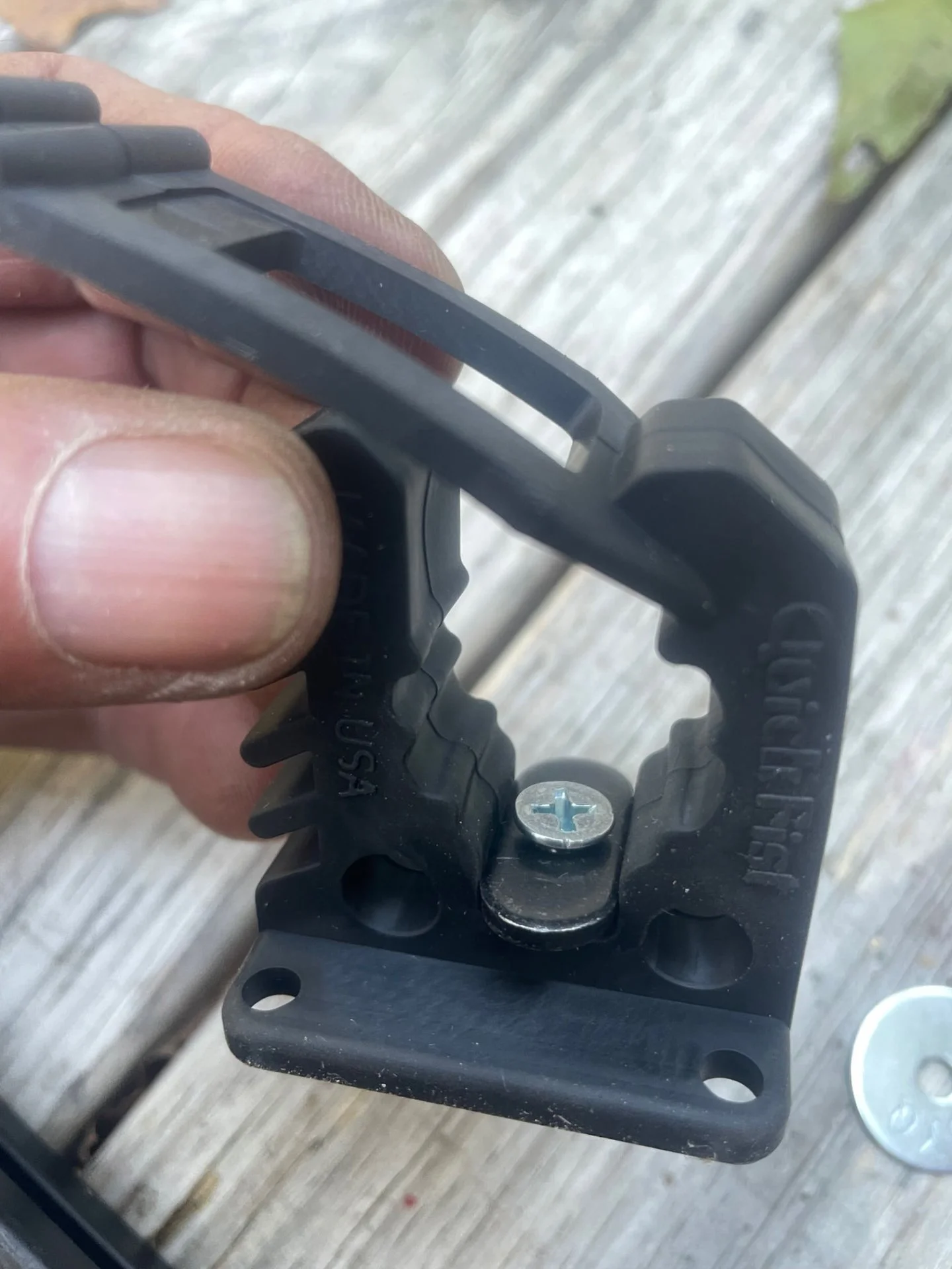

Next mod was to use two pair of the MaxTrac mount adapters https://www.bowfincruisers.com/products/maxtrax-mount-adaptersfor carrying a pair of long metal pipe that is use to hang a hammock from brackets on my 60. First test was to mount the adapters under the crossbar with a small Quickfist mounted upright. In my initial testing I thought this setup would allow a hammock bar to run parallel to the rack side and be low enough to pass under a canoe crossbar. I discovered that this configuration would not work as I could not fasten the Quickfitst around the bar, plus the Quickfists would interfere in carrying large flat objects, such as plywood, on the rack.
So with the MaxTrac adapters mounted on the bottom of the crossbar I mounted the QuikFists upside down and moved the MaxTrac plates to the edge of the crossbar. This works for carrying the long metal poles.

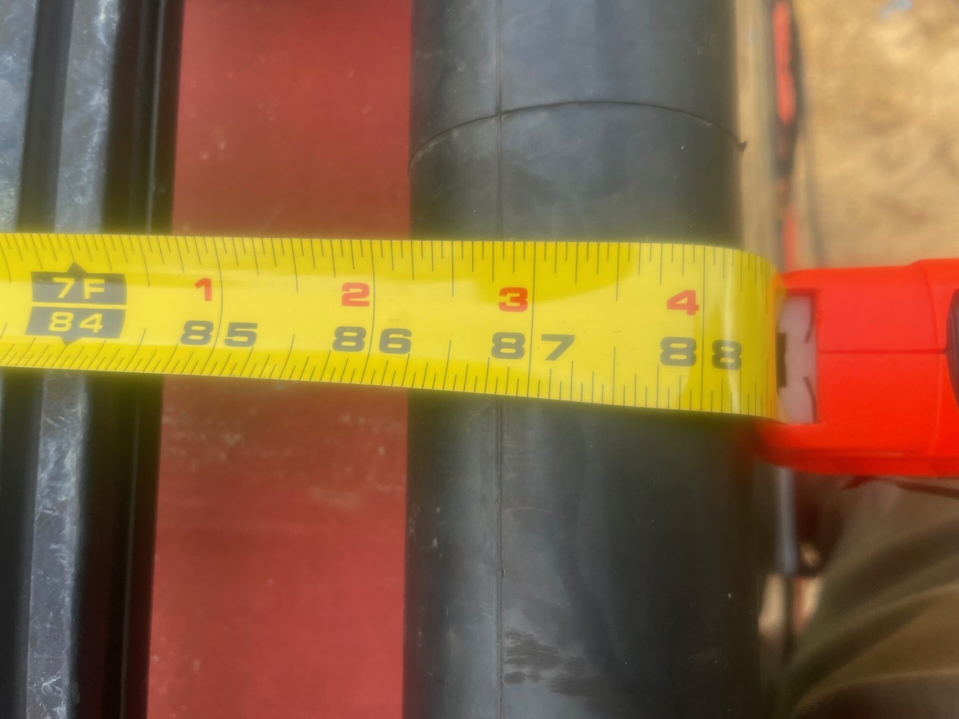

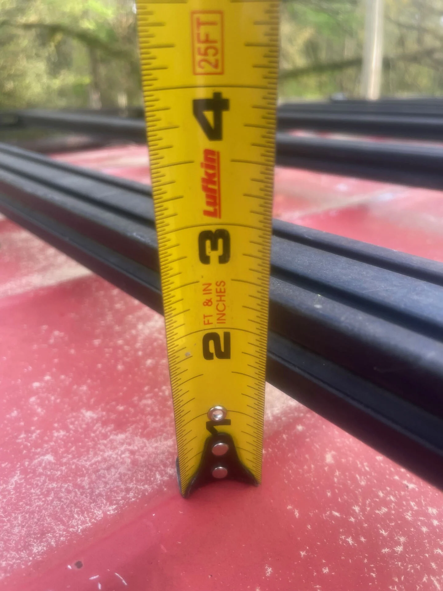

Width is just 53 1/4"
Length is 87" plus a little.
I measured the distance from the roof to the bottom of the crossbar, either 1 1/2" or 1 3/4". The 60 series roof is ribbed which accounts for the slight difference in height. I couldn't get a good measurement of the gutter channel to bottom of crossbar.
@Godwin Thank You! do you mind measuring along the side from where it sits in the gutter to the center of the 2 bolts where the cross bar screws in. And the thickness of the crossbar. So far it is looking like the width and length could work.
