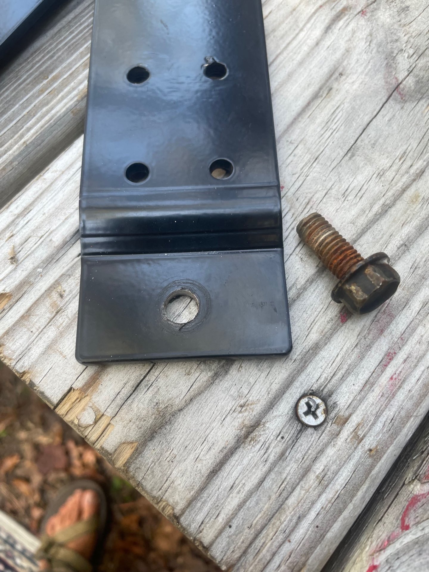

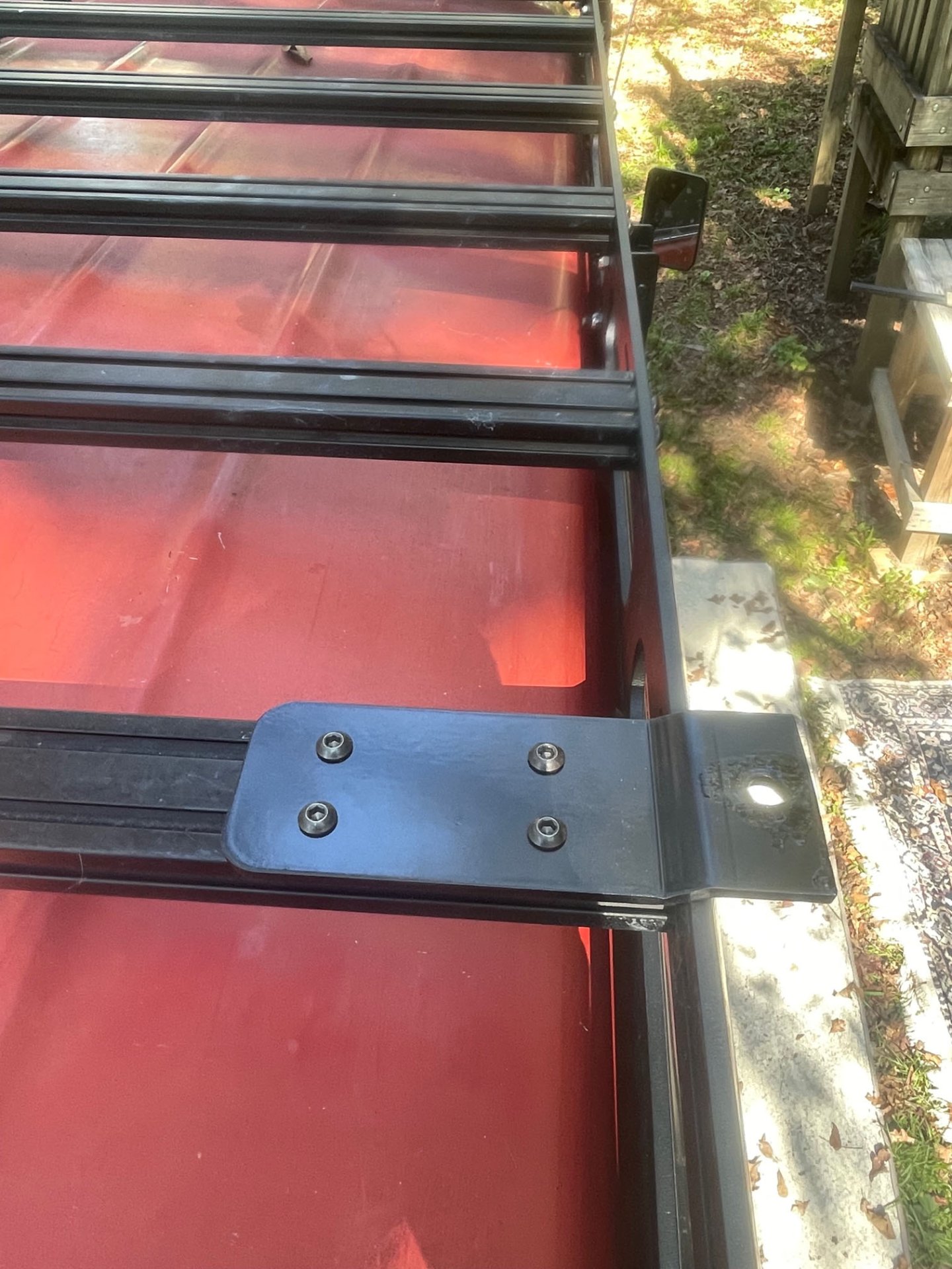

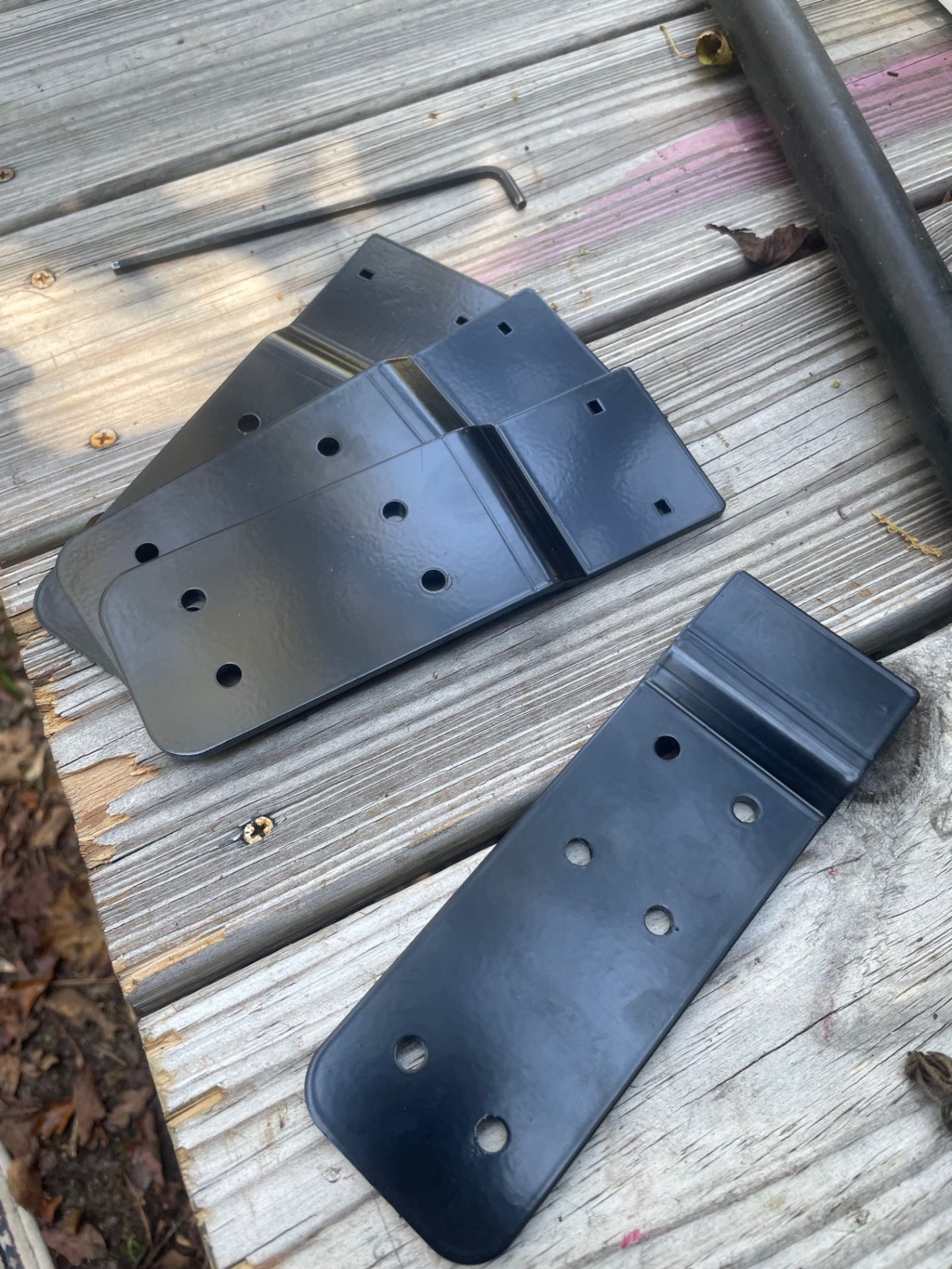

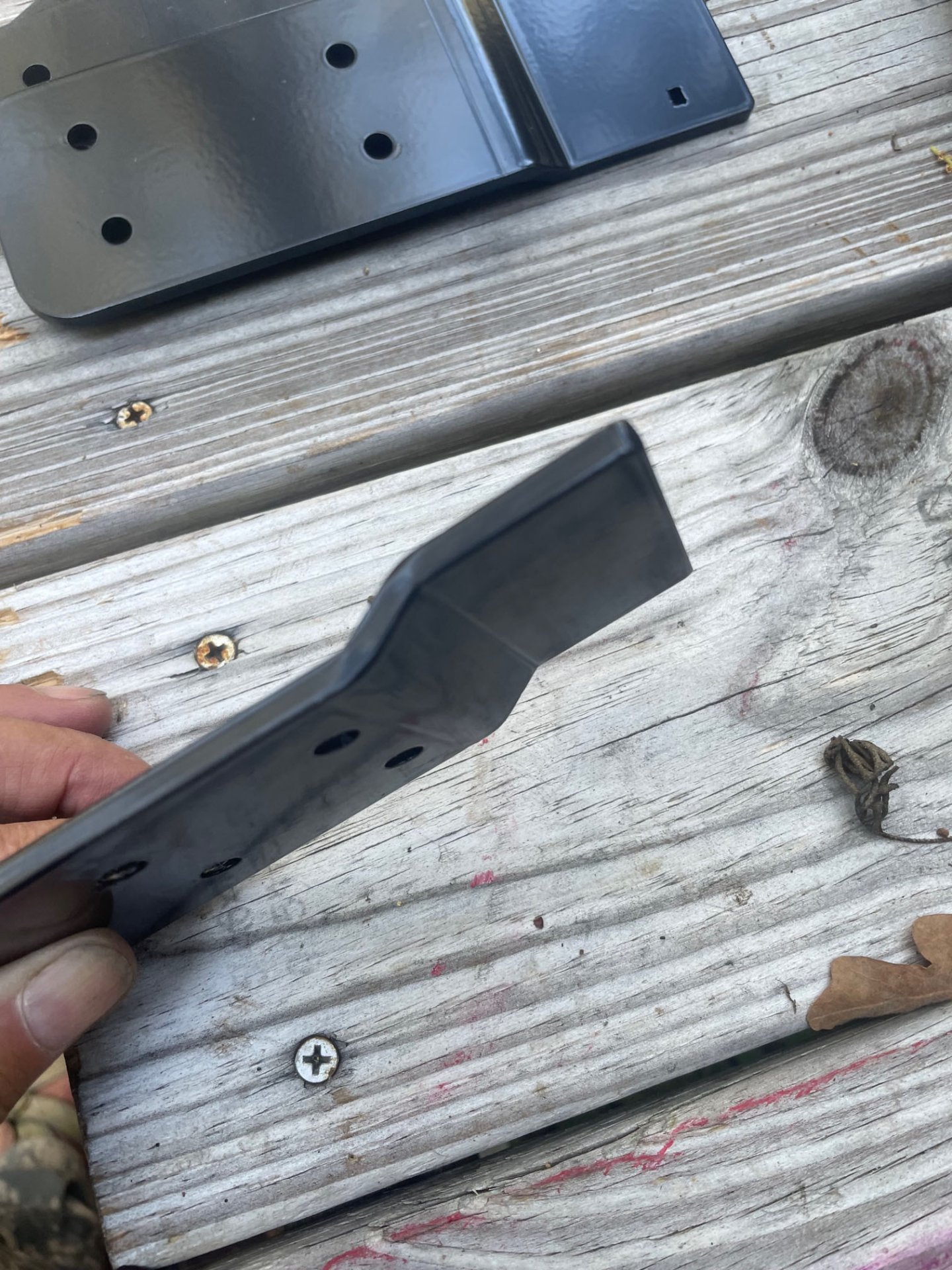

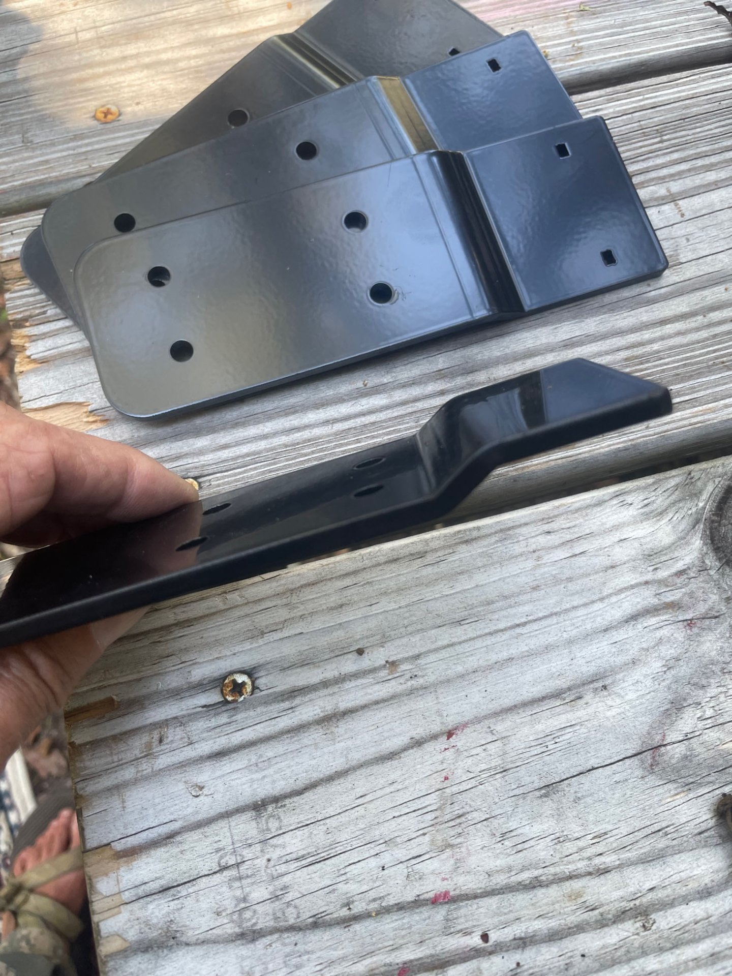

My previous homemade rack was set up for bolting on Yakima crossbars to carry a pair of canoes. Patrick has on the Bowfin website awning brackets and I thought the horizontal section with the slight rise to clear the side rail would work as a mod for mounting canoe crossbars. I was able to get two pair of only the horizontal plates and test them out.
I measured and drilled a 3/8" hole for the Yakima bolt to pass through and bolted the plates to crossbars.

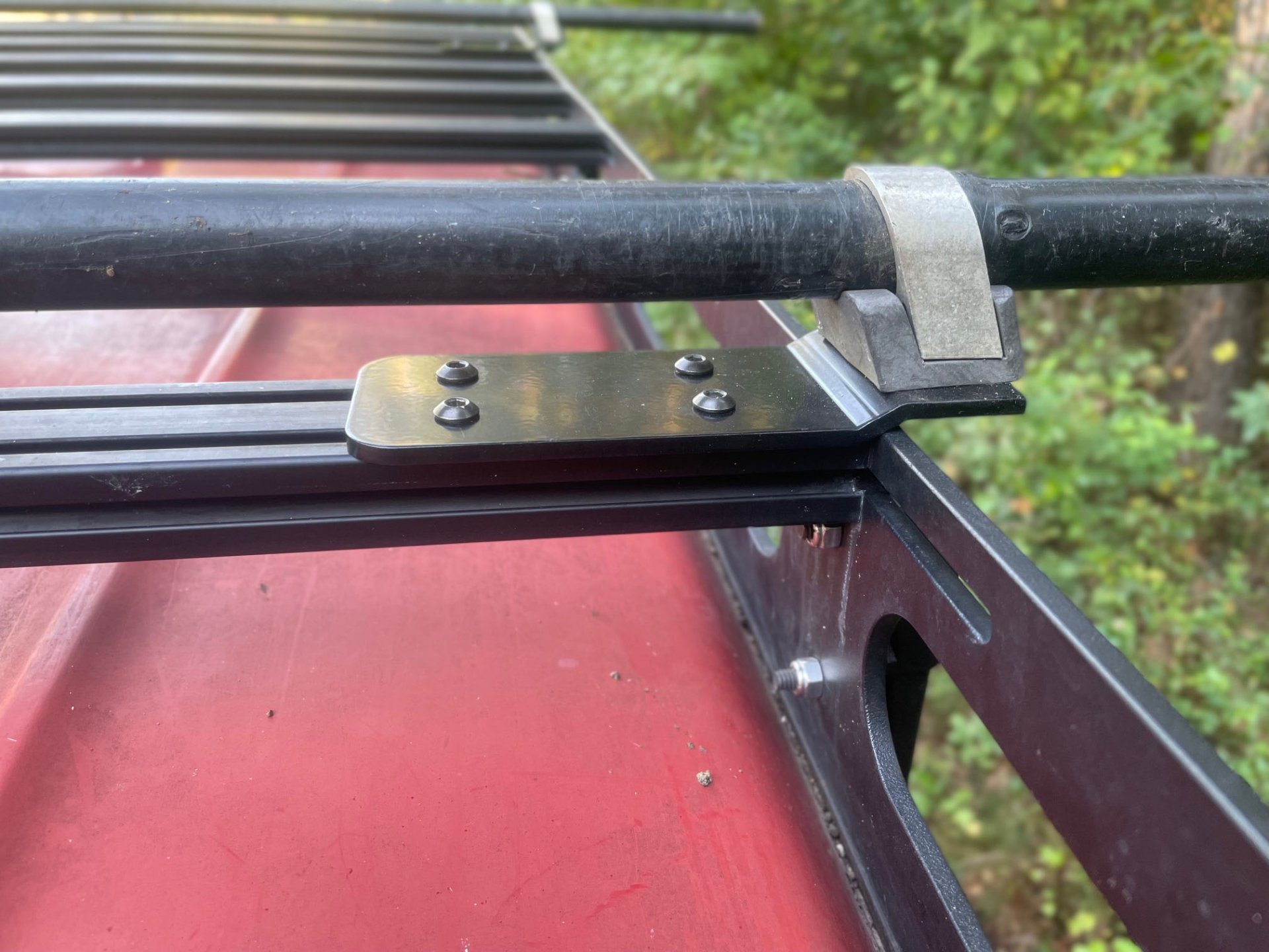

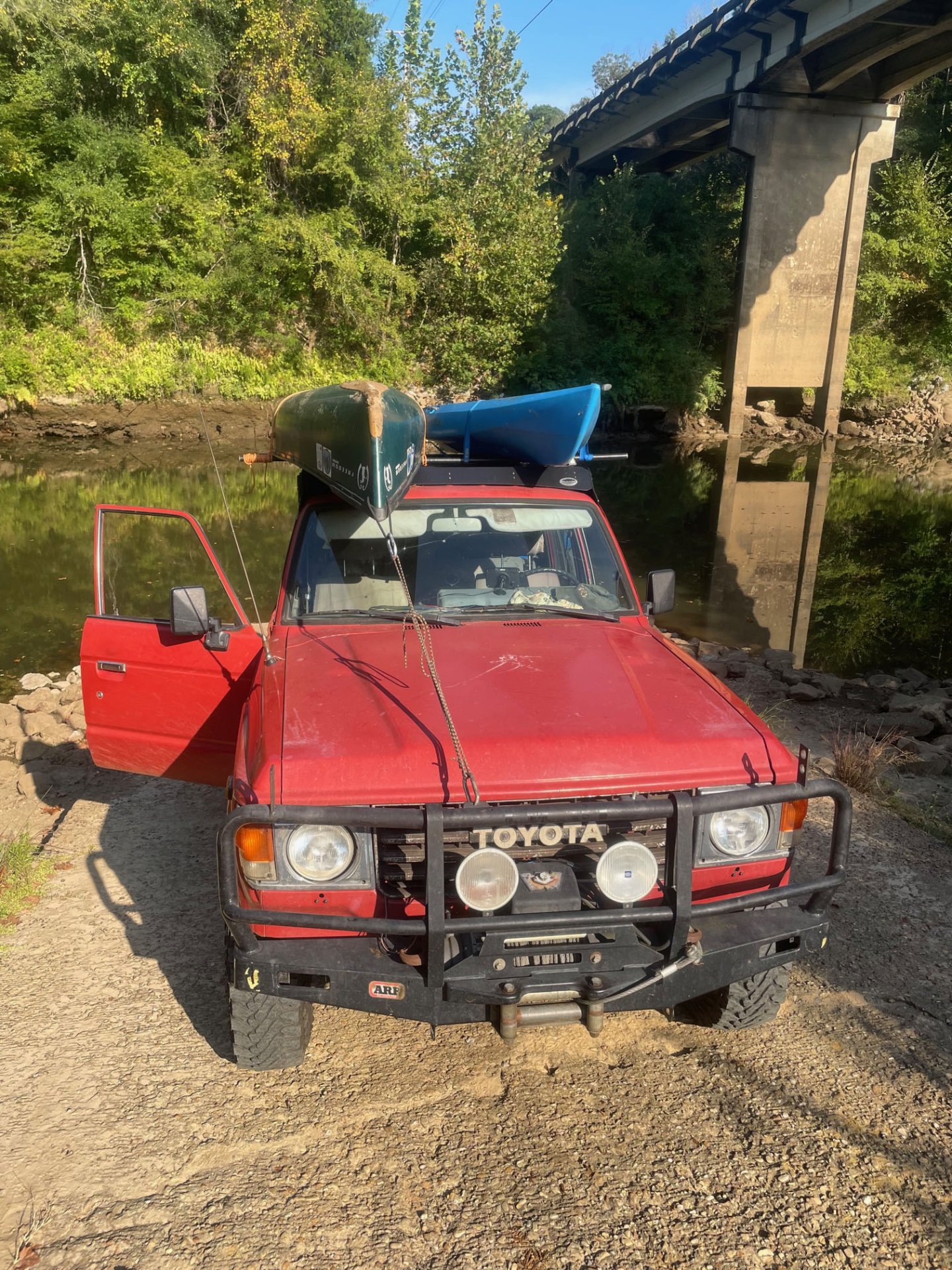

Bolted on the Yakima bars which fit great and now provide the capability to carry two boats.

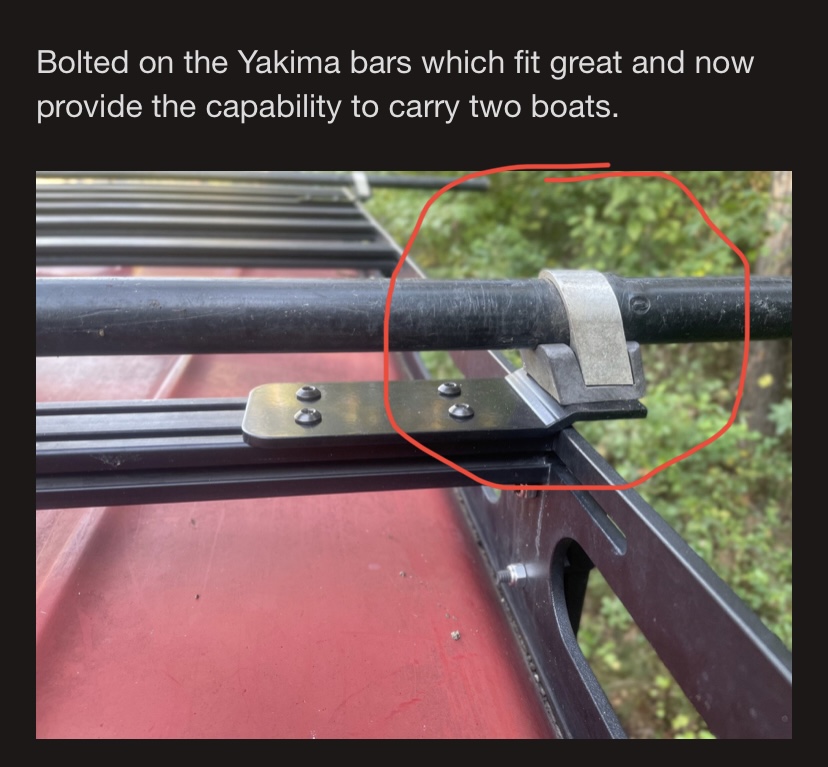

Awesome mod. Exactly what I need. Can you elaborate on the clamp for the crossbars? Are those available from Yakima?
I got these from @dogfishlake. On the Bowfin website are awning bracket mounts Awning Bracket Mount Set - https://www.bowfincruisers.com/products/awning-bracket, from these I had the idea of just using the horizontal plate with the slight bend as crossbar mounts. Contact Patrick and see if he can help out.
Thanks for the quick reply! I’m tracking on the plate/awning bracket from bowfin, but trying to see where the actual bar clamp that you mounted to the bracket came from?
The bar and clamp are just standard Yakima parts.
