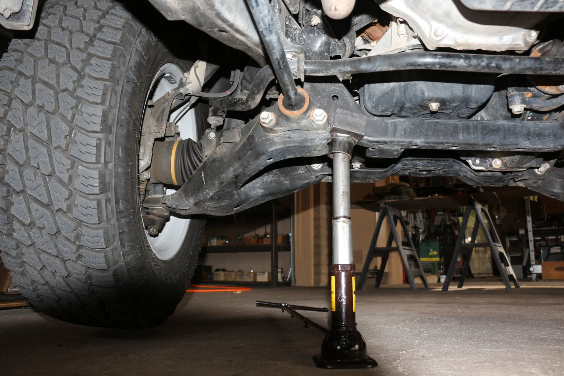

Ran into these guys last weekend at Northwest Overland Rally (no affiliation) and they said they thought their adapters would fit the factory jack so I hauled it over to them.
Bottle Jack Accessories
Turns out their extensions fit right on the factory bottle jack if you just knock off the stamped steel cap. It's just held on with four punch crimps. If you get the jack base you can drill/chamfer holes for the screws and screw the jack directly to it. I put some aluminum bushings on the screws so the wingnuts sit securely on the mount. The plate is a heavy bit of steel but it doubles as a Hi-Lift base.

In fact I may buy the LCP 2" adapter since it will work for my FJ62 and will go over the female ends (1.75" diameter) of the Jack Safe stuff allowing me to use their flat pad and posts as a jack stand while simultaneously using the bottle jack with the Jack Safe adapter.
I will say that the Safe Jack adapter fits snuggly on the OE jack with the cap removed (wouldn't fit at all with the cap on) and their longer extensions make it possible to also use the bottle jack with my teardrop trailer. The trailer has drop-down rear support legs which aren't lifts and with the longer extension(s) I can lift at the rub rail/sliders on the trailer for easy leveling in camp.

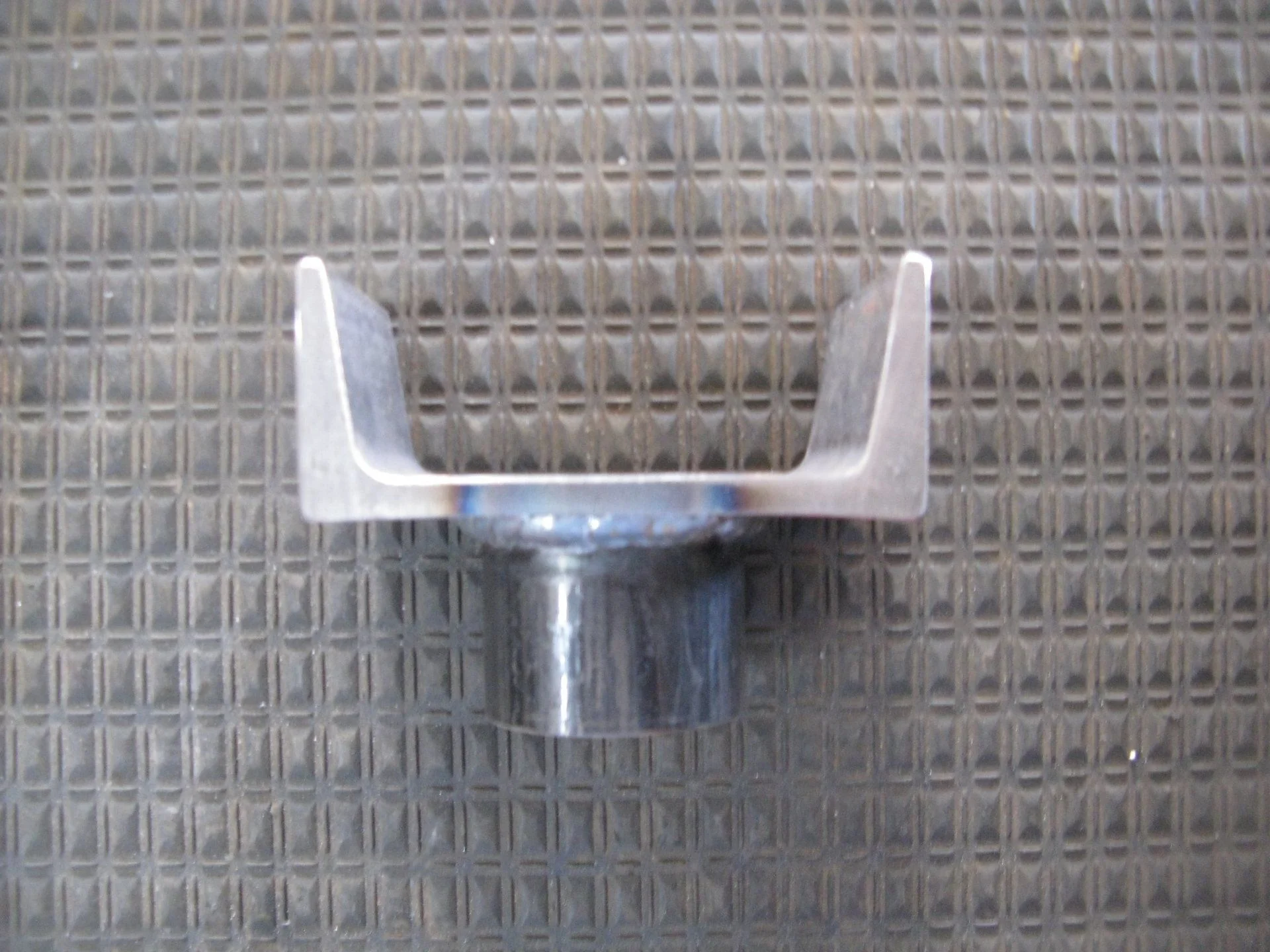

Our Jack Adapter was designed not to fit tight. This gives the adapter the ability to cant while the jack stays vertical. This provides a solid base with more adapter contact making it less chance of slippage.
This is not to say ours is better than safe jack just different. Also pointed out above can do things our cant.
