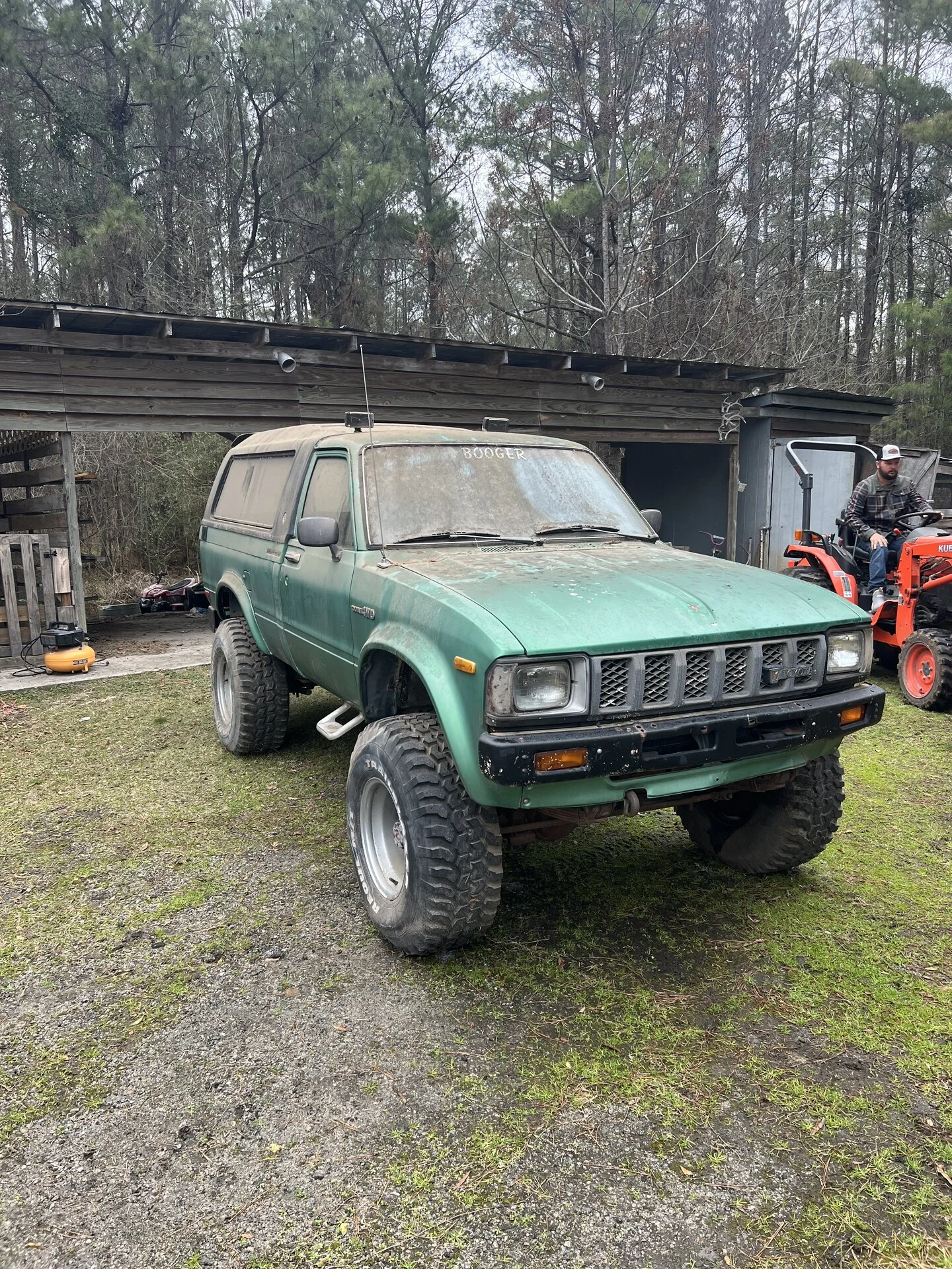

I road tripped down there with @GLTHFJ60 and his infamous Moonshine Motel to pick it up on Sunday and got it home. Luckily the trip was uneventful.

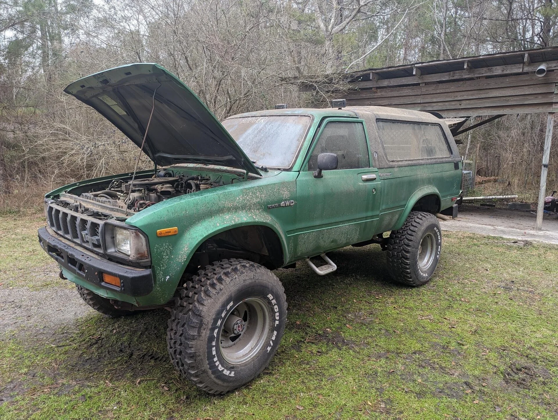

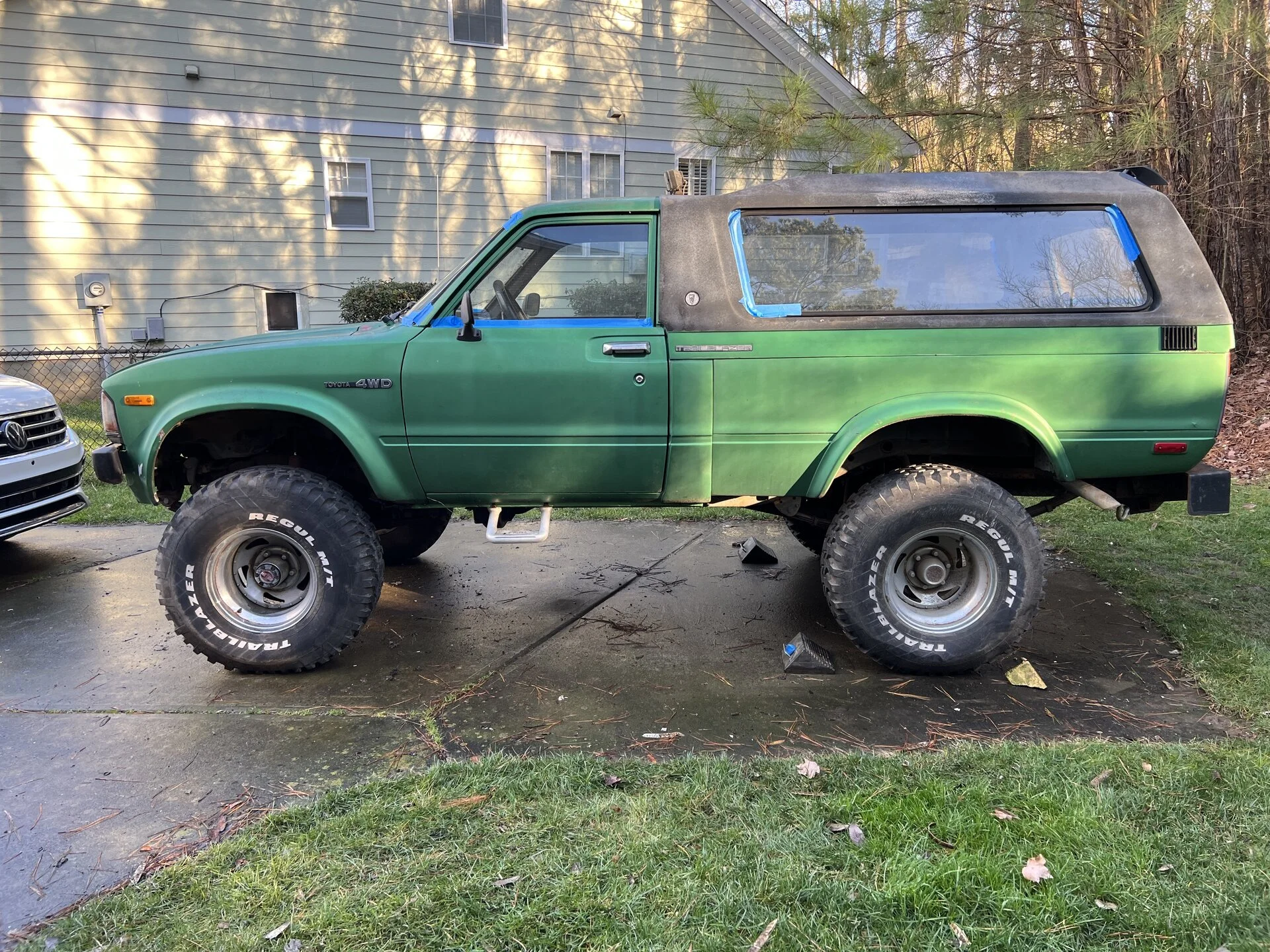

Now onto the truck...It's a 1982 Toyota Trailblazer that has been in the same family for >33 years but has been sitting and not running for at least 10 years. I knew this going into the sale and knew it would need a lot of work to bring back to life. It has been repainted >10 years ago but it was mostly complete. The three immediate issues are the engine is locked up, the floorboards are rusty, and the back glass was replaced with a sheet of plexi due to it breaking years ago. The interior was disassembled but it had some good new parts on it.
The plan for the truck is to go through it and make it roadworthy and then make it a nice driver. It won't get cut up or have big tires but will be a nice driver that can be taken on some mild trails.

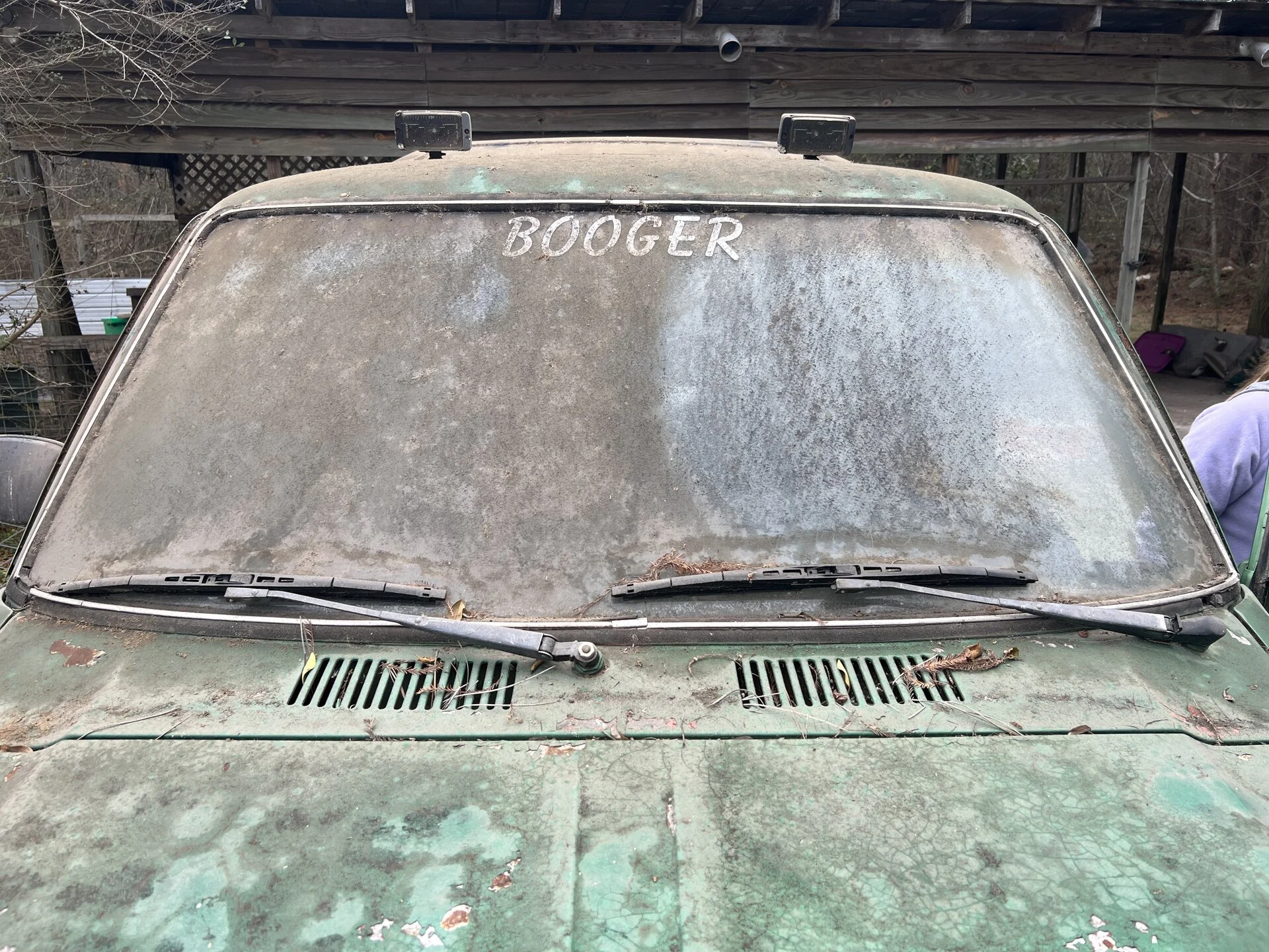

Here are some pics from the pickup and as received. The name Booger came with the truck as you can see by the windshield sticker which fits the truck well so the name will stay.

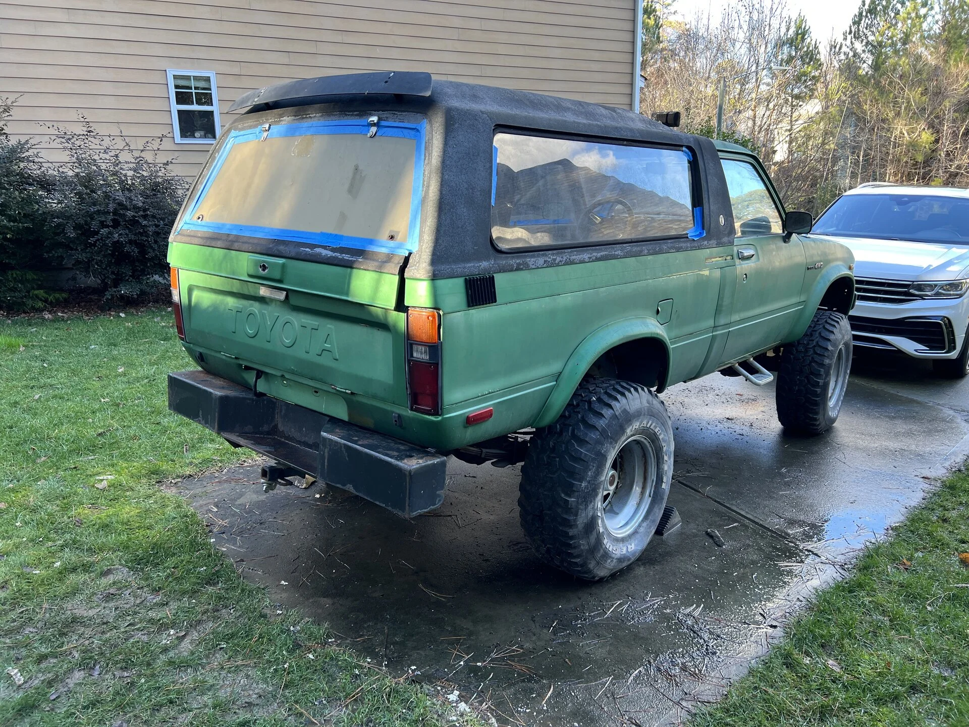

Got it home, loaded up the cylinders with some Marvel Mystery Oil and did a quick pressure wash and interior clean out. Peep the pro waterproofing I've done with some painters tape until the new seals arrive. Will need to get some custom seals made for the top windows which may be time consuming...

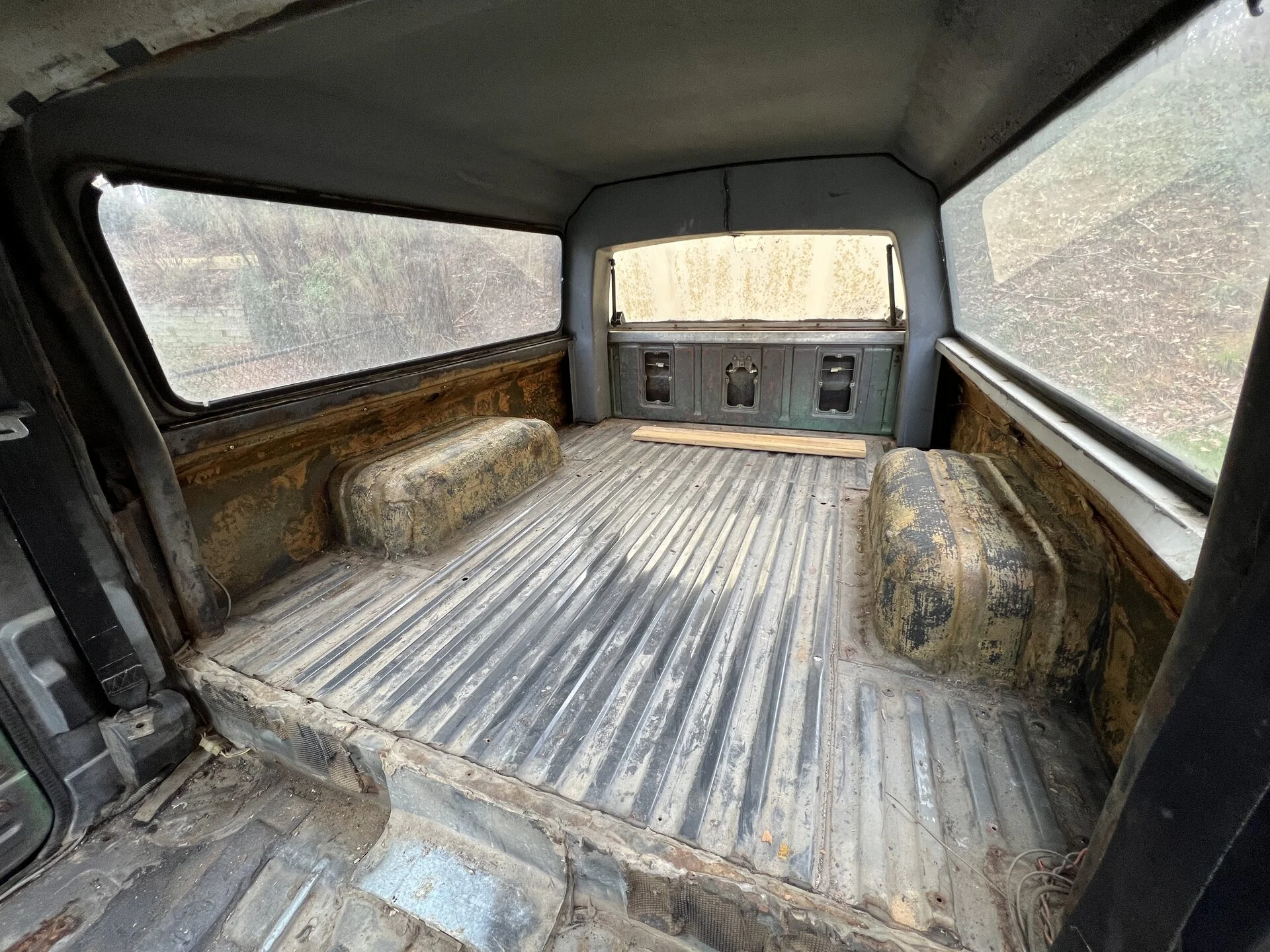

Luckily the truck had both sets of roll bar fiberglass covers. One is installed, the other is in my garage. The bed is very solid, the front floor needs some work. I'm trying to track down some full length pans but can only find a set from Thailand on ebay. I've found some front pans from c2c but really need to do the whole length. If needed, I'll buy the front pans and patch the back.
Nice score! Is the cargo area long enough to sleep in? Would be a sick wheel-sleep-wheel overnighter rig.
Thanks! I haven't measured it but I bet I could sleep in it. Not having the back of the cab frees up a lot of length in the short bed. The back will get sealed up, insulated and carpeted. I have the rear seat but TBD if it will live in the truck or if I'll keep it open
