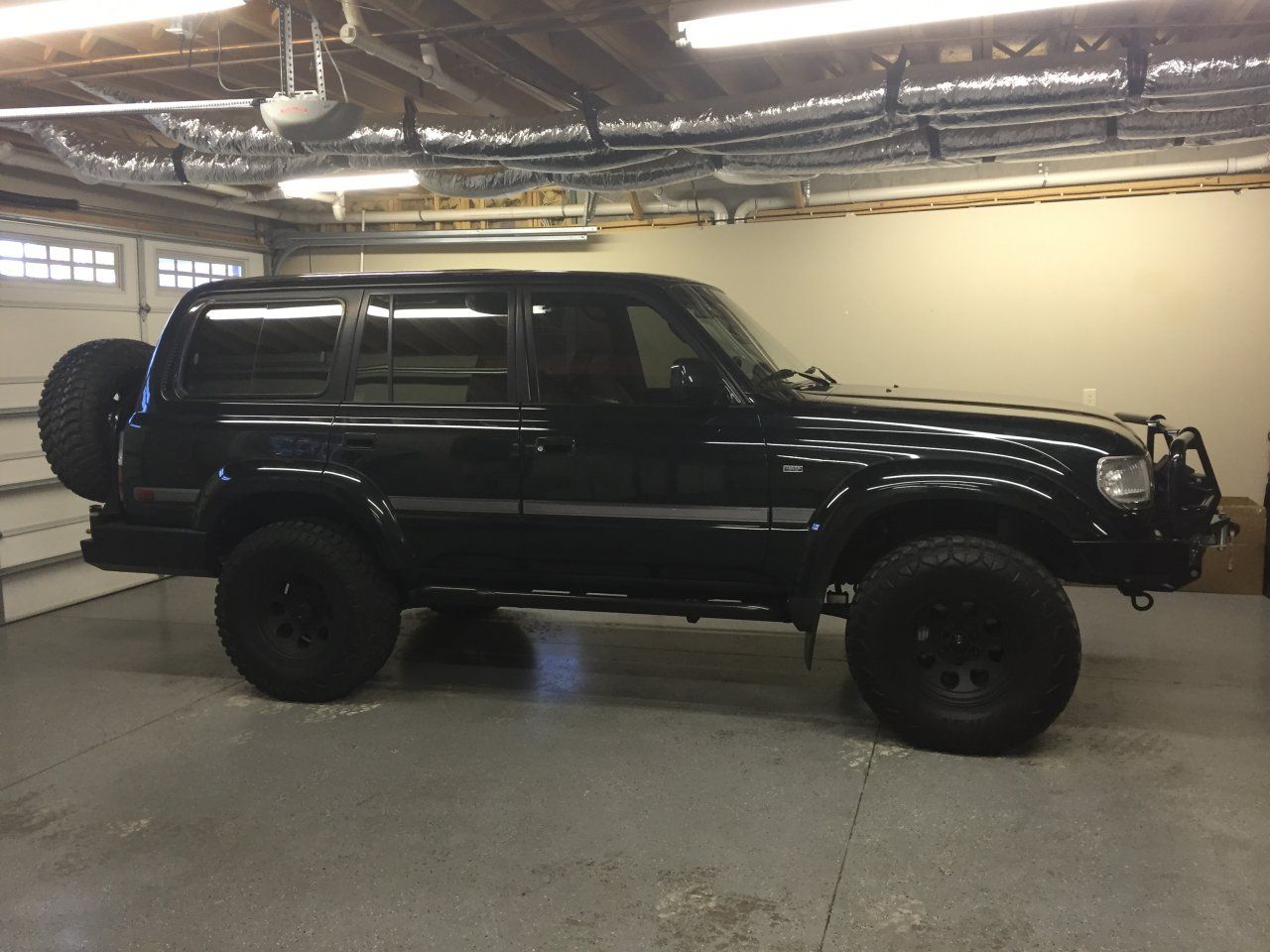

Had a chance to spend time with John yesterday and see and drive this beauty.
This is, by far, the nicest 80 I have ever seen. Not in terms of useless doo-dads, and "expedition" junk installed.
It is nearly perfect. Everything has a reason and a place and a use. Everything is functional and has utility--as it should be.
I'm proud to have been a small part of this great Land Cruiser.
This is truly an outstanding Land Cruiser, well done. It's amazing what you can do when you have time, money and motivation.

Onur - @beno
Thanks for taking the time to come over and visit, talk cruisers and give the truck a good once over with your discerning eye. Looking forward to starting to upgrade/replace the small things that will continue to keep this truck rolling for many years to come as well as improve her overall condition.
Your involvement in its transformation was no small part. You knowledge and expertise was paramount in the decisions made that truly made this build what it is today. Thank you for all the work and time you have provided me with...
