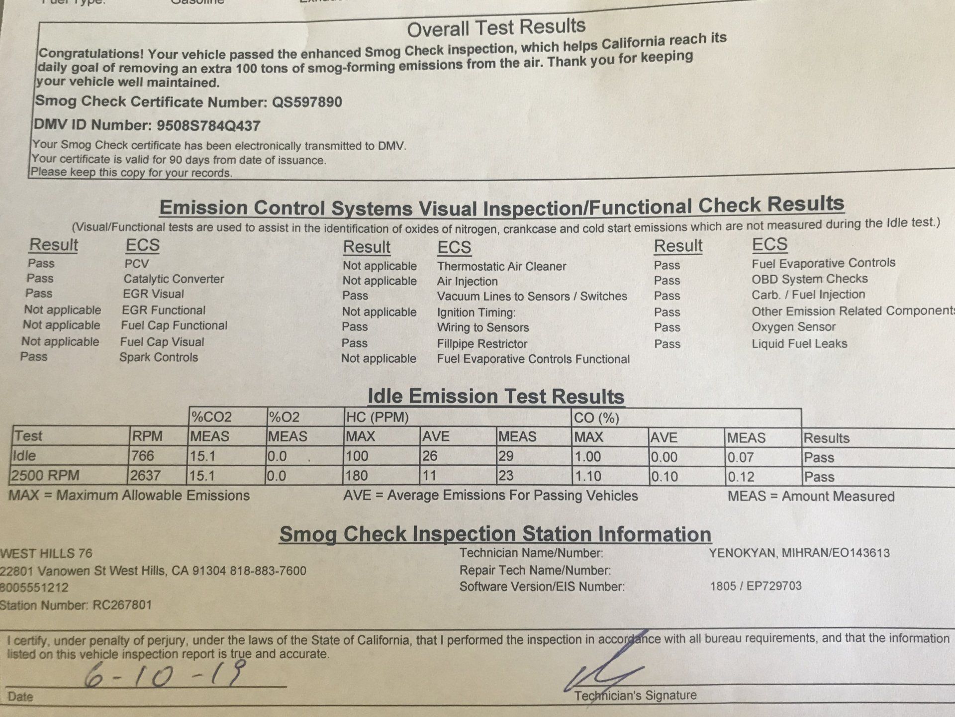

Finally found the smog check from before touching the truck back when I first brought it back from South Carolina:
And now the smog test post turbo from a week or so ago:
HA! So the turbo actually reduced your emissions, or did you put on new cats in all this process?
One of the requirements is it had to be initially tested with OEM cat and the final test needed to be with the same cat. But going with a new OEM cat at the beginning would not have necessarily worked in my favor.
