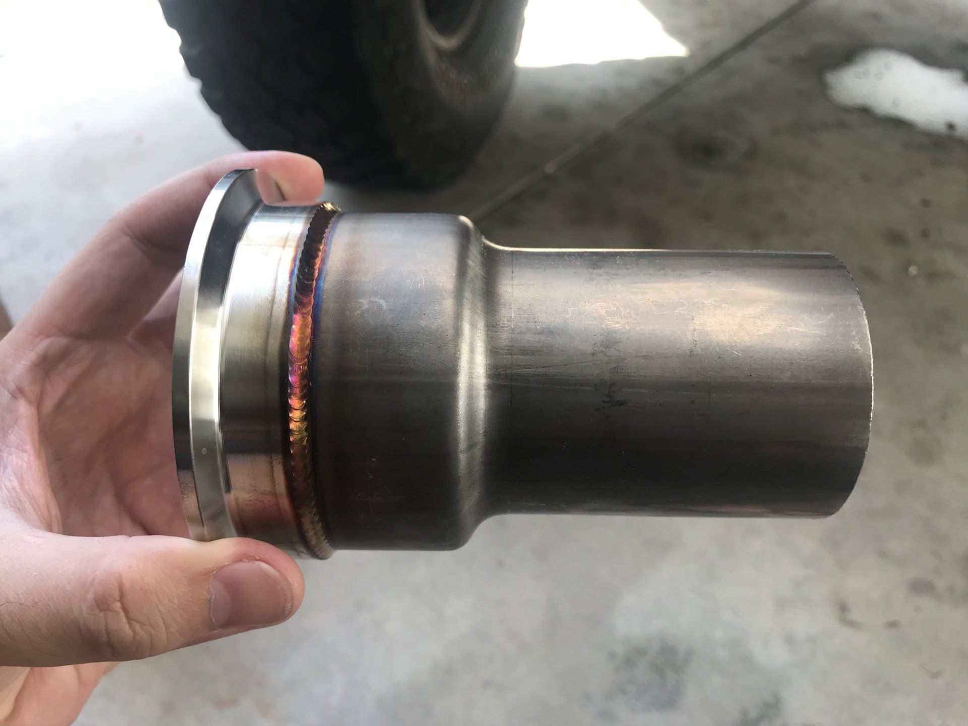

Getting some bits in today which is perfect timing since it looks like the next turbo is ready to go. By Monday the next 3-5.
The 3 remaining turbines arrived last night so now the remainder of the first nine aren’t roadblocked.
Are those bits including the down-pipe to cat exhaust part?
I didn’t see the band clamp hold-down bits that make them look tidy-er & additional heat wrap for A/C line. They could be in there, but I could have missed them. Just wanted to confirm.
Yup
Those aren't part of the kit. This is mainly because there are a few ways to handle if that, if one is inclined, and even for myself I haven't settled on something for my own truck. I'm hoping the band clamp-ons will fit the bill for me.
Doh! Yes, I did miss that. I'll send it out.

The Clamp-Aid band covers, I didn’t check what size I would need & quantity. Let me know so I can track those down today.
The extra bits that just arrived, can I blast out to you tomorrow & pick those up? Rig is in the shop 😁, so I’ll have to ride my motorcycle. I’m assuming the exhaust section & anything else will fit in my backpack?

I contacted PTP about maybe making some dedicated downpipe blankets for the turbo kit. They came back and said no problem, just need to send them a downpipe to work from.
I bring this up because my SC’d truck ran really hot on the passenger floorboard ever since I switch to non-OEM cats and Y-pipe. I solved it by using this:
The same could work for the turbo downpipe or I could get a blingy lava blanket made. Thoughts? Please don’t ask price, no clue. But guaranteed to be more than an off the shelf part from Thermo-Tec
