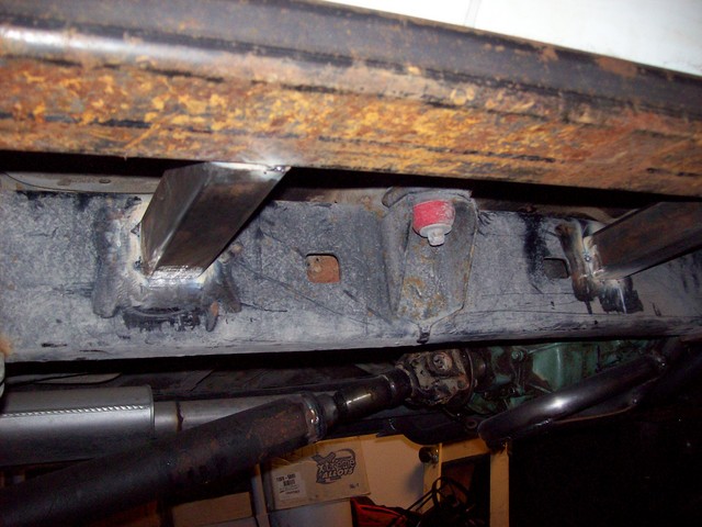

I'm no welder but. You may want to clean the metal a little better before you weld much more. I noticed you are using a wire feed with no gas. Wire feed welders do not like contamination such as rust. I was specifically looking at the mount at the rear axle link. Second pic in post 31. I would hate to see that thing brake. It will brake only when you bind up the rear. When it lets go it will take your pinion with it.
Ask me how I know.
Been there, done that.

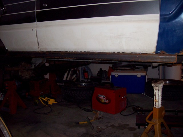

thanks guys... I hope it works well to ... and the wirenogas is just to tack it at home takin it to work to burn it in with a bigger unit ... an all areas are ground to bare metal some of the pics just dont look like it.... the xfer case member is the torq bar mount, got the sliders tacked today hope to take it to work nexted week and weld everthing up:grinpimp:

tacked the sliders on

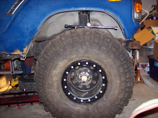

got the tires on I need more trimin

well i flexed it out at work to day ... sorry no pics and well i have to chop the fenders out about 3 in all the way around in the front :laughing: so much for only a in of up travel the rear clears great even with out a bump stop but the spring bends in all kinds of strange ways i guess i gota work on it more :grinpimp:

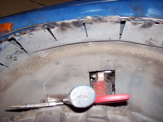

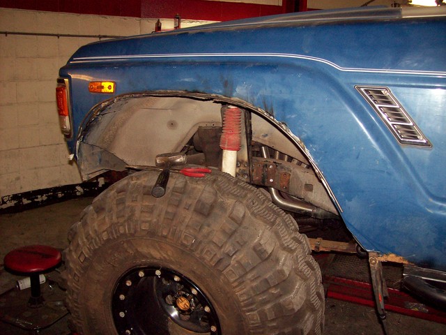

went to town on my fender tonight
got one side tacked both cut before I had to leave the shop
cut slots in the inner fender well to pull it out to weld it .. got abot 3in of new clearence and I need ever in jamminzz

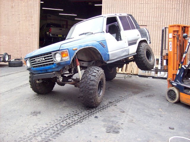

flexed it out before I left
had to trim ALOT off the front valance

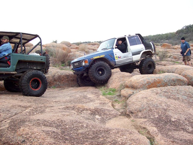

went across the crack at the bottom of Aggie hwy and didnt even hit the rear jamminzz
ran back braker the nexted day ... than after this pic my camera dies :(
I layed it over on the side on the comp corse on Sat
these are pic from when I got home pushed the B piller in 3 in to the seat
the tint held the glass togetter till I drove home
had GREAT time ... looks like the chop top goin to happen sooner
Great job, that looks awesome. I like how you cut the fenders instead of lifting it more. Too bad youre gonna cut the top off, i love to see a big full bodied wagon wheeling hard.
