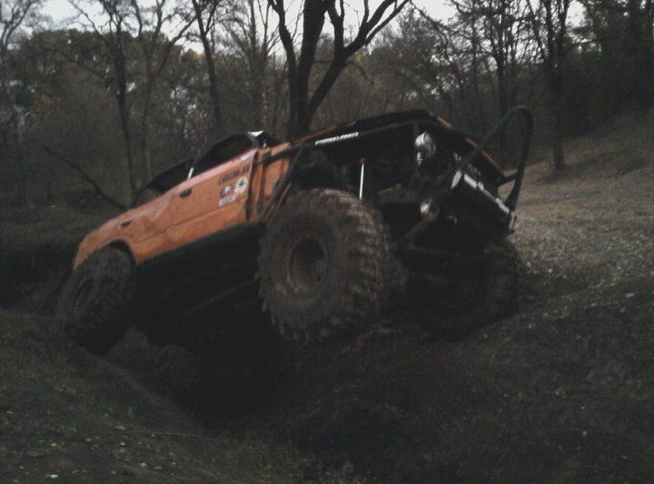

BObed the 60 16in
Well last time I took it out I lost the drive to the front wheels... Passenger side would sorta pretend to work but would not pull at all, driver side would make a loud bang / pop noise when in 4wd and applying the brakes to hold the front tires and just making the rear drive line spin. So that to me told me a busted driver birf.
Well today I finally got around to pulling it apart, so far the passenger side leaves me a little depressed... I was really hoping to find a busted birf or maybe a busted hub but now I am starting to think it is more serious than what I had originally thought...
The hub looked fine and none of the splines on the passenger side longfield set were stripped and it was all holding together just fine.
When I took it out I remember thinking to myself that when in 4wd it sorta felt like something as going on with the front but it was still pulling so i ignored it as it could have been something minor (did find steering arm studs had come loose AGAIN) then out of nowhere on an easy obstical it lost the front drive, it was so spontaneous i thought somehow the hub had come unlocked or had popped.
1.) was doing fine here.
2.) passenger side tires off of the ground and this is where i noticed it wasnt pulling up front, then after backing up to get a better angle noticed the welded rear had broke again. (spider gears and side gears are trashed from being welded then broke so many times before. I wondered how long it would last when I found their condition and re welded them again.)
3.) I had to winch to get to this point.
