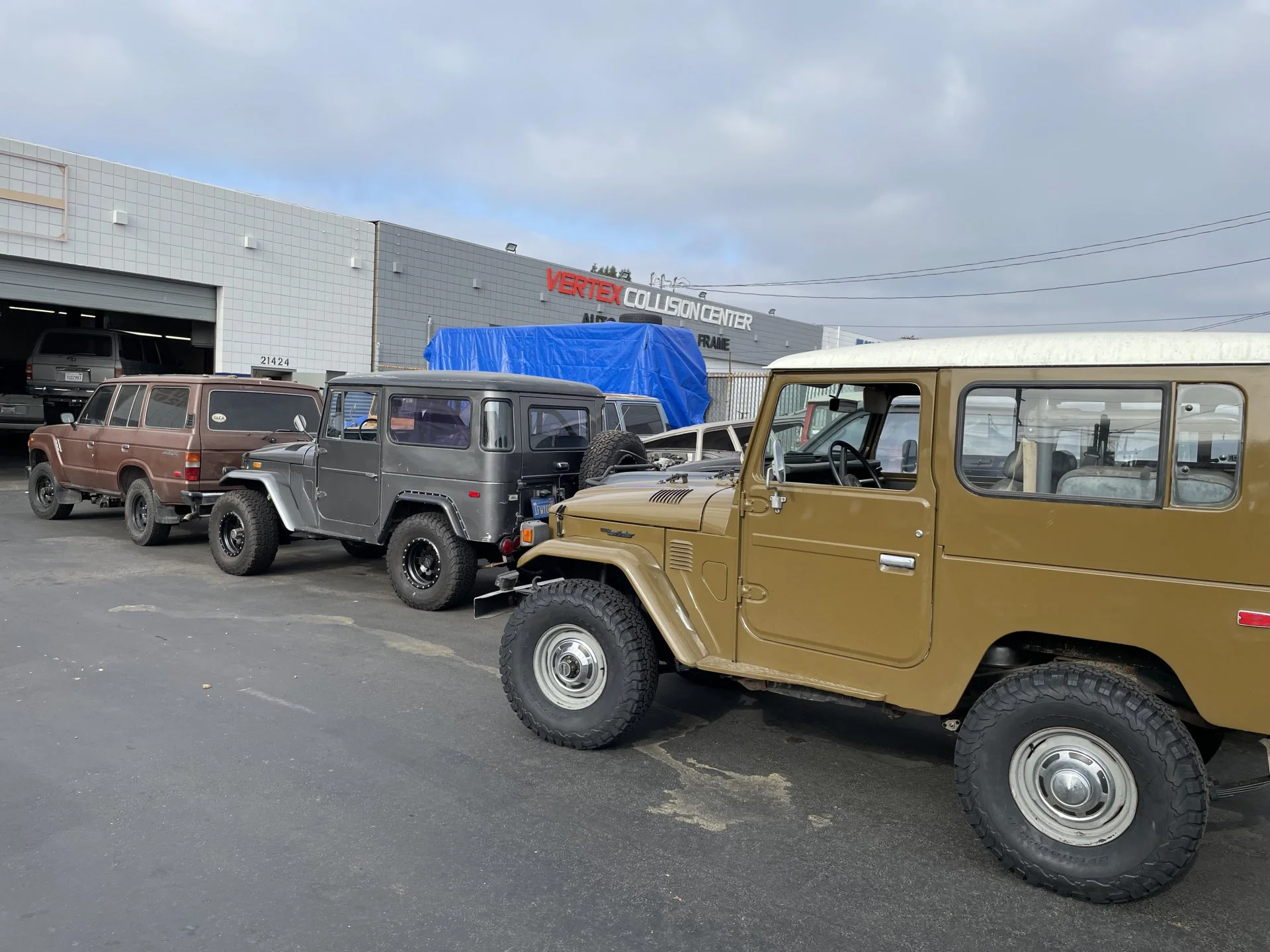

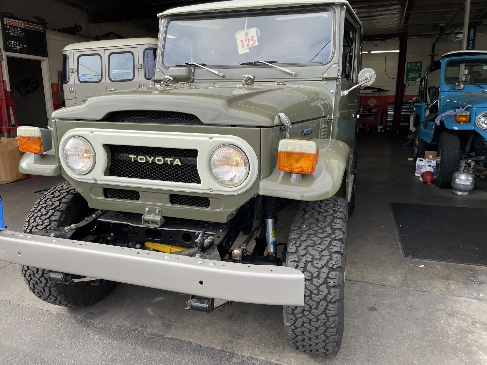

Cool shop though. Some photos for your enjoyment. This brown 40 is a 1979, sold for $19k.
Customer rig:

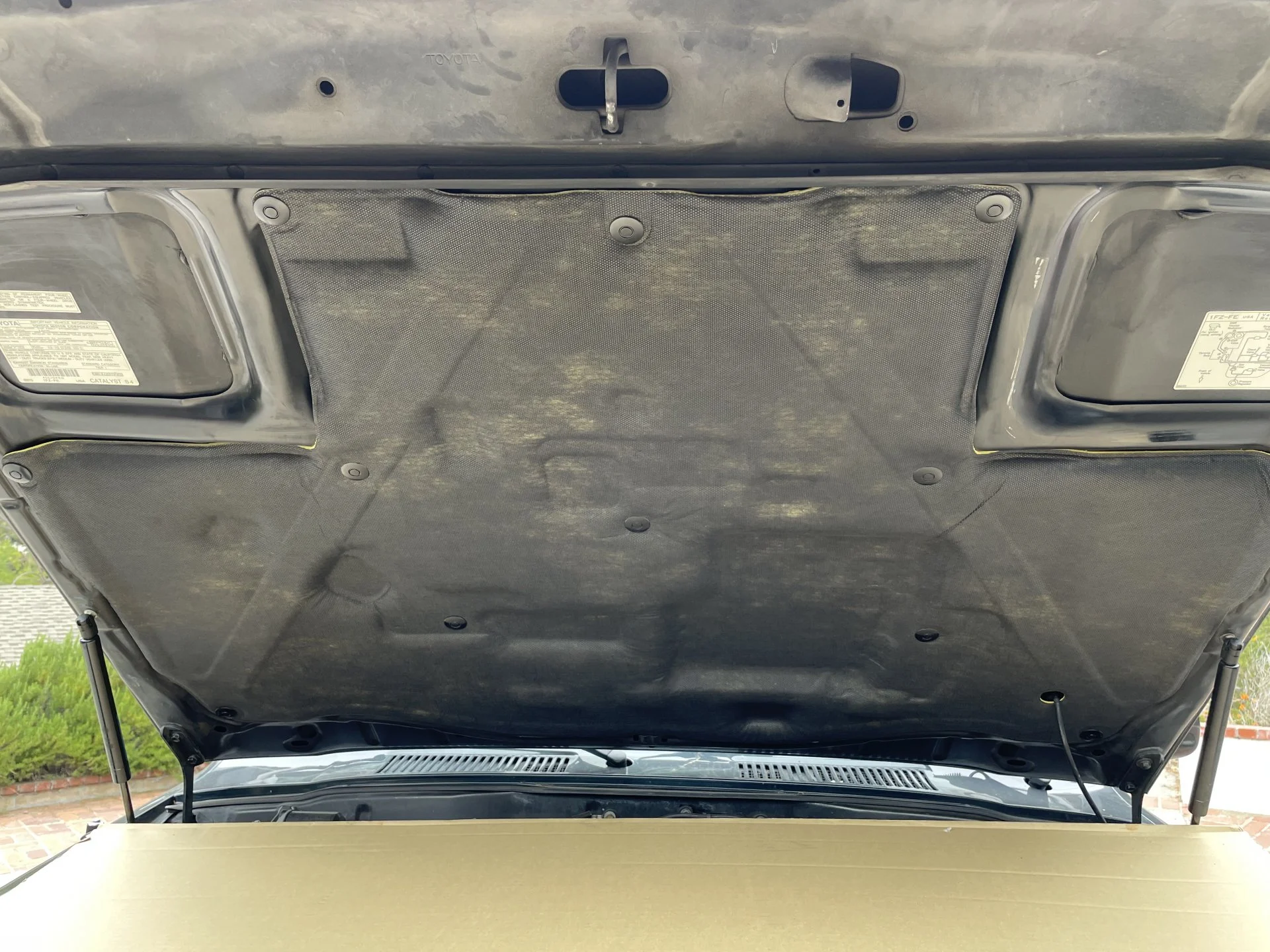

Placed order for a new hood insulator pad / clips, OEM PCV valve / grommet / hoses, and all new hoses for the charcoal canister. Going to rebuild the OG canister before heading out on this trip and tired of the slightly oily stink coming from the old insulator pad, which is caked in garbage.
Quick morning of small projects - hood insulator pad / clips, new OEM PCV valve / grommet / hoses, charcoal canister hoses and a new fuel soft line. Fun stuff and no more oil stink!
The before:
Pulled off and ready to install the new one:
Installed! Fresh and clean...

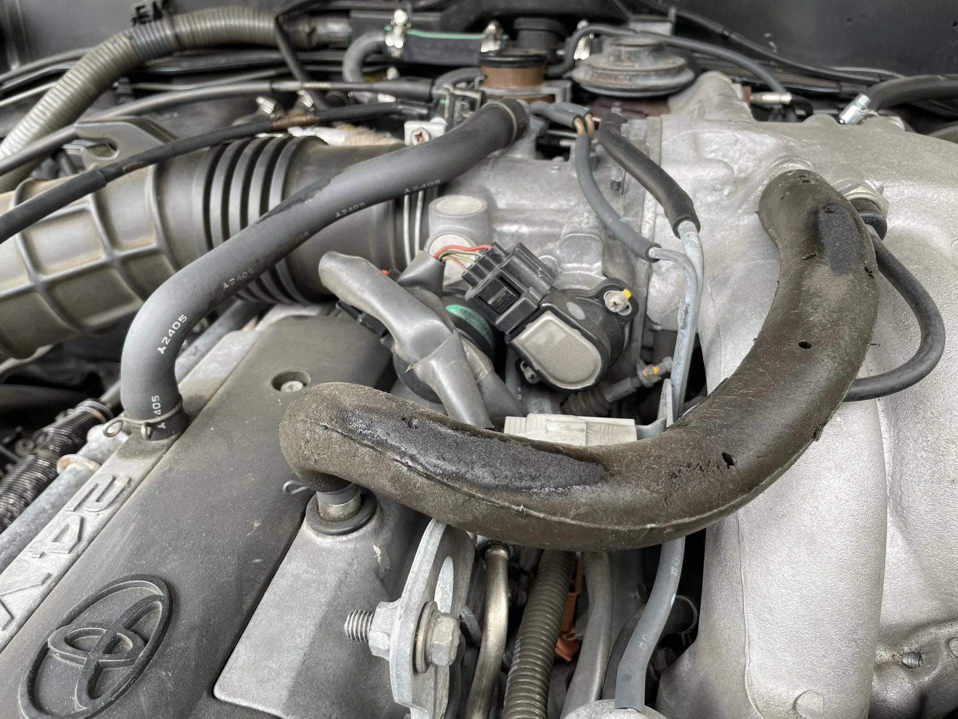

Old hoses. This PCV grommet was petrified, was finally able to pull off with a pair of vise-grips and some bean. Every time I opened the hood this insulated PCV hose irritated me...but it may have been OEM, no idea. It had an OEM-like hose inside. Who knows.
Grommet chunks. These were fun to fish out of the valve cover. I checked in there thoroughly before installing new parts.
New hoses, valve, and clamps.
