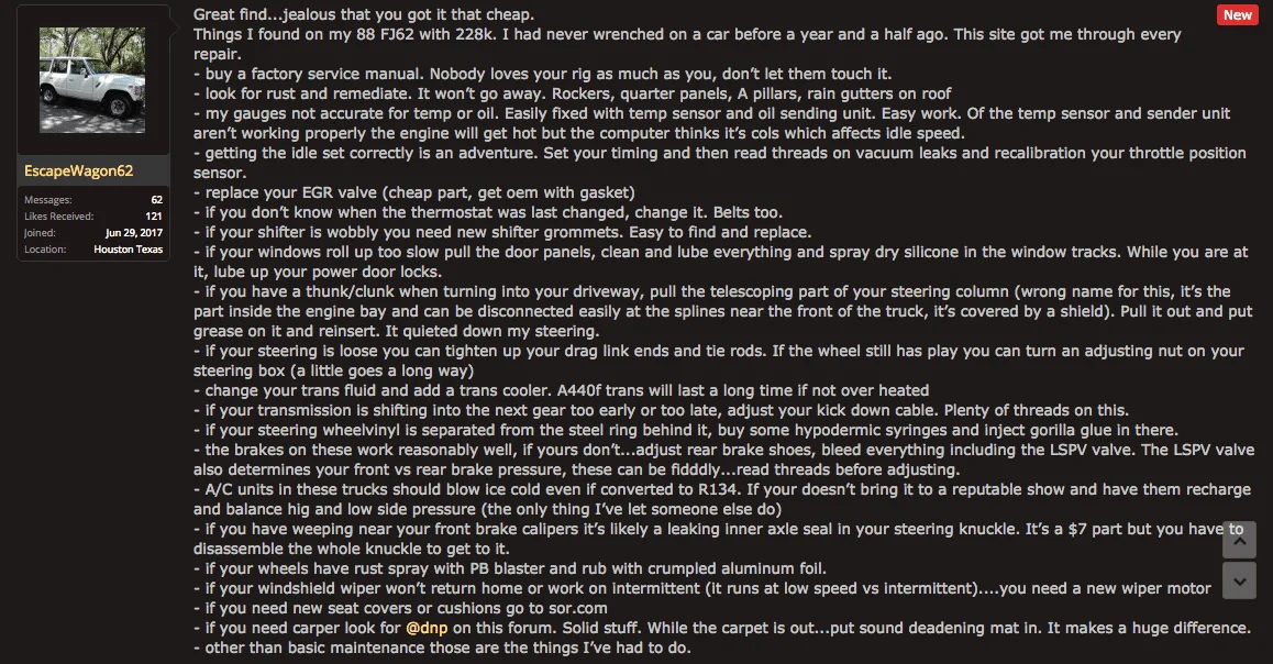

I found what I was looking for! it was a post by @EscapeWagon62 on this thread here is a picture of it

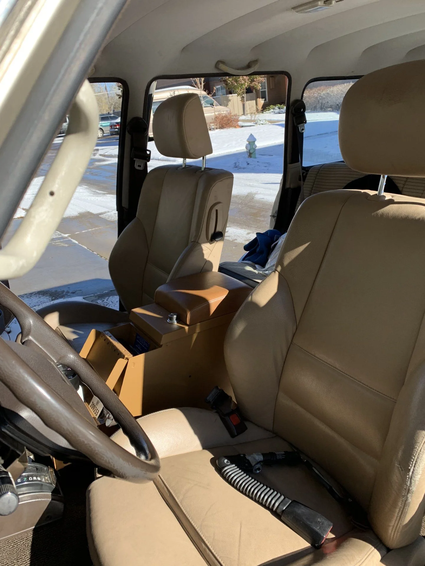

Finished getting the BMW 3 series coupe seats into the truck. Fully wired and working fantastic! TorFab brackets made this a breeze. It’s amazing how nice it feels in the cockpit now.
Can’t wait to have this done. The interior is going to be beautiful once I get everything reupholstered and matching.

Love the Pendleton and leather combo.
I assume you’re reupholstering the BMW seats? If so, I’d be interested in the seat covers in the last photo :hillbilly:
I am excited to see the final product for sure!
Unfortunately the passenger seat is the only one in good shape. The driver is as many are - destroyed.
If I do sell just the covers, I’ll let you know, but I think I can probably unload the full seats locally on CL.
Sounds good, I’d take the passenger if no one bites on the full seats.

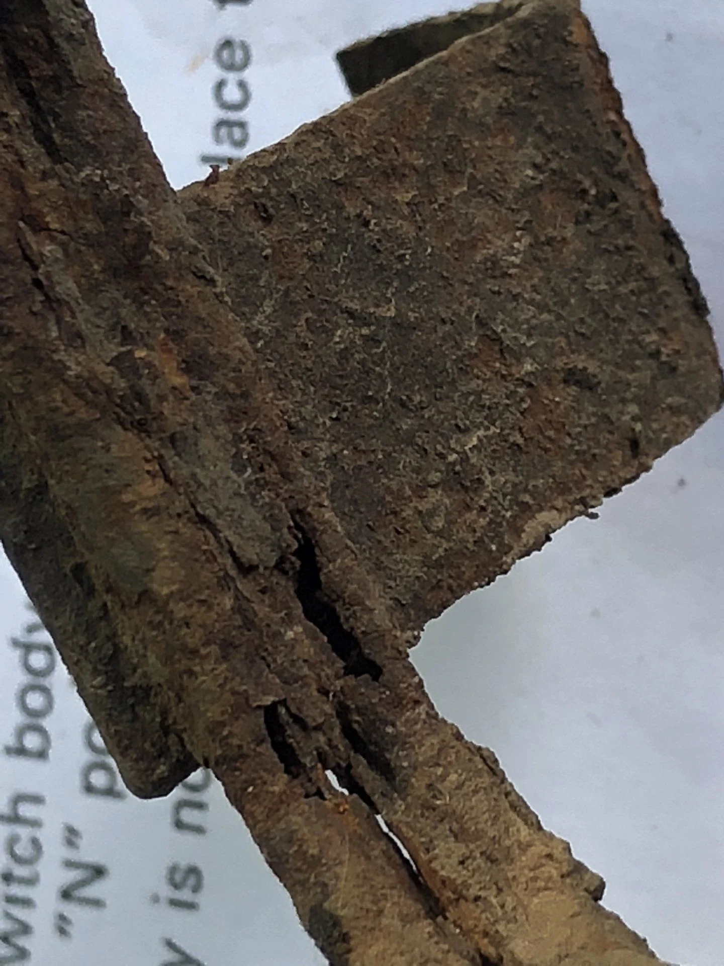

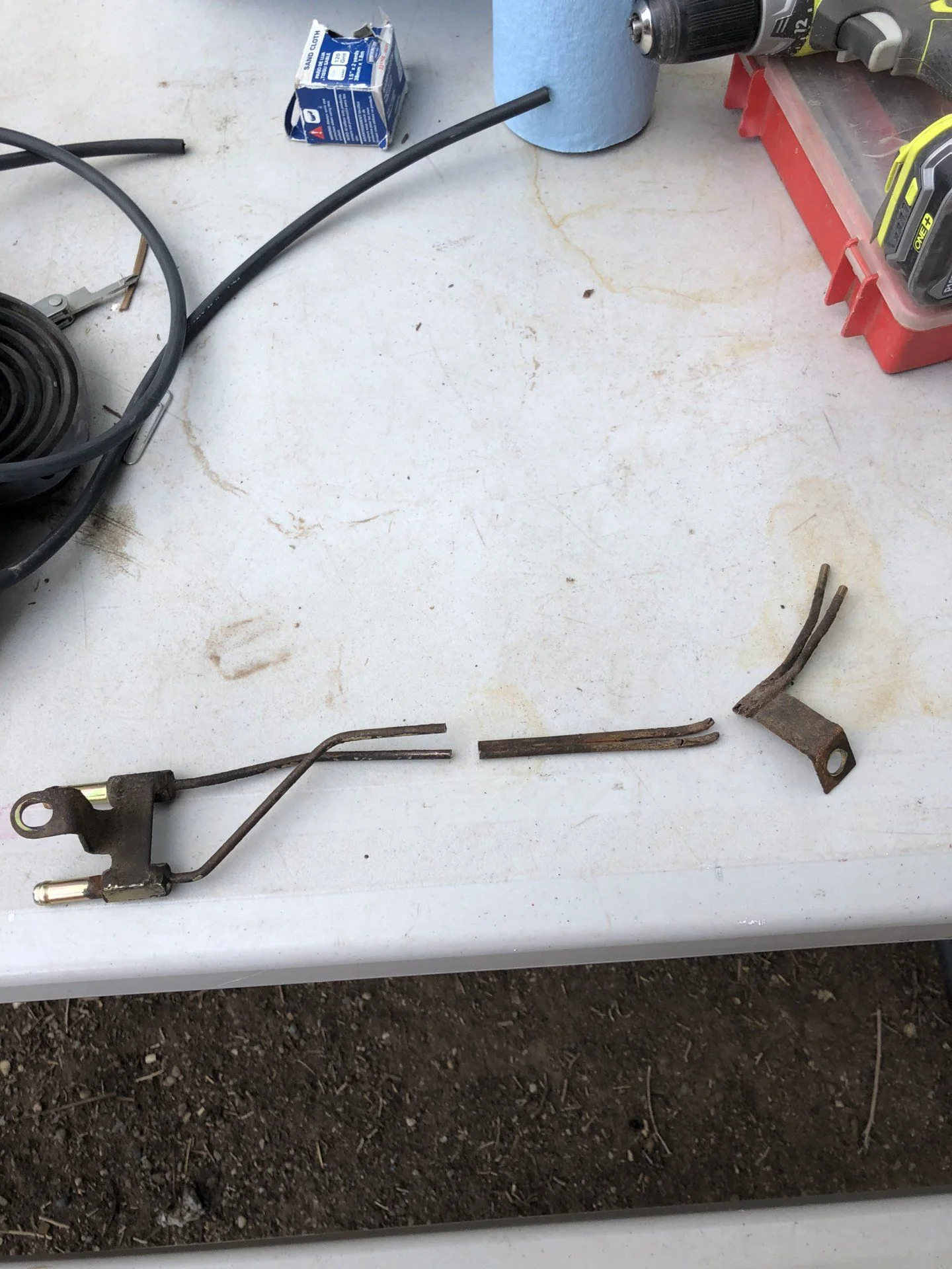

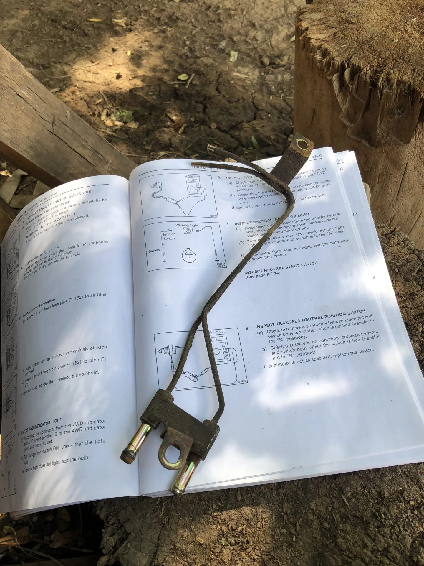

I cut out the cancer, and used vacuum tubing in place of the hard lines until I found used replacements. I WAS ready to bend up some new/replacements with steel brake line.
Note: the rusty lines were fine until I went under “exploring” while bolting on some WKOR sliders, I must have tweaked things just enough to open up a hole in the rust.
