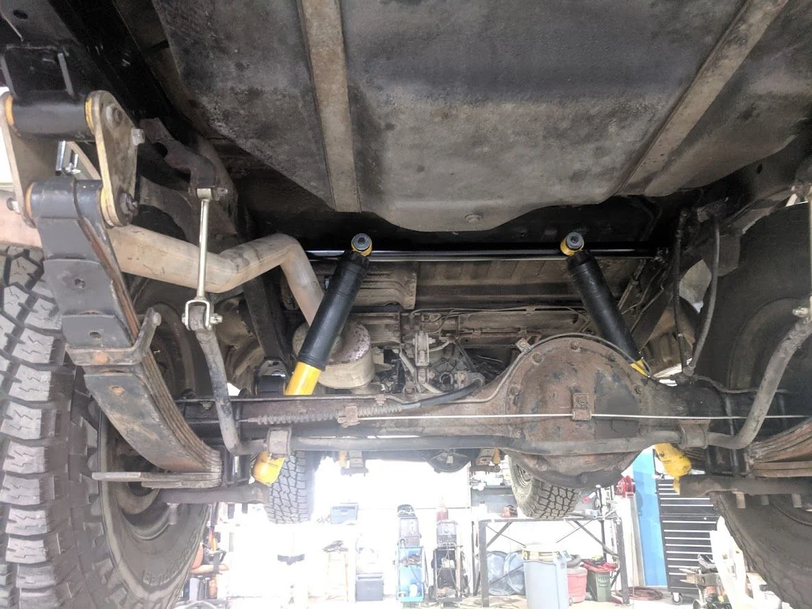

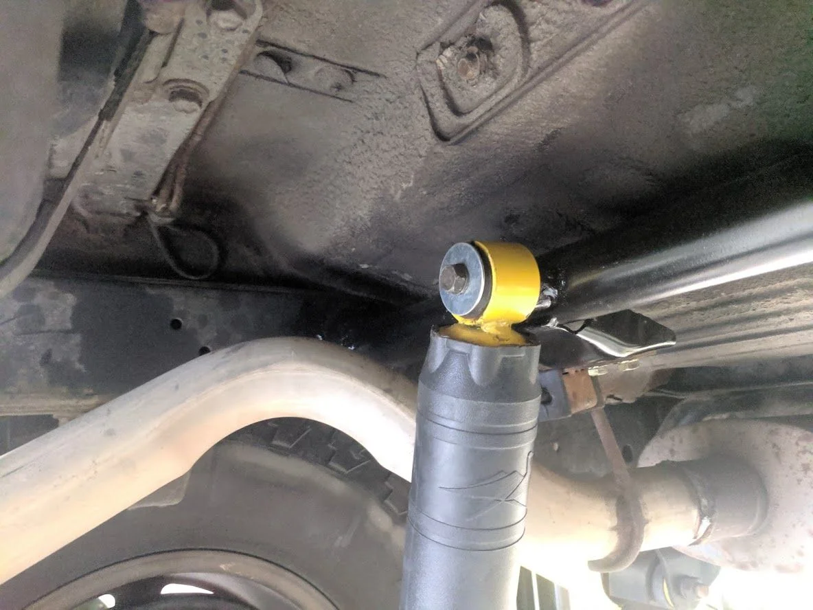

Well Sorted Automotive has had my truck for about the last month.

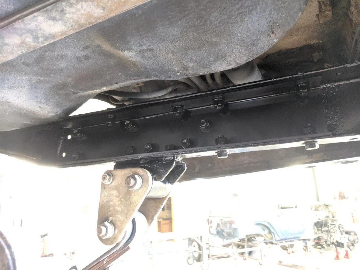

The main project they took care of for me was removing and rebuilding the C channels on the rear of the truck and replacing the Shock Tube for the rear struts to reattach to the truck. Here are some pictures from Doug at Well Sorted.

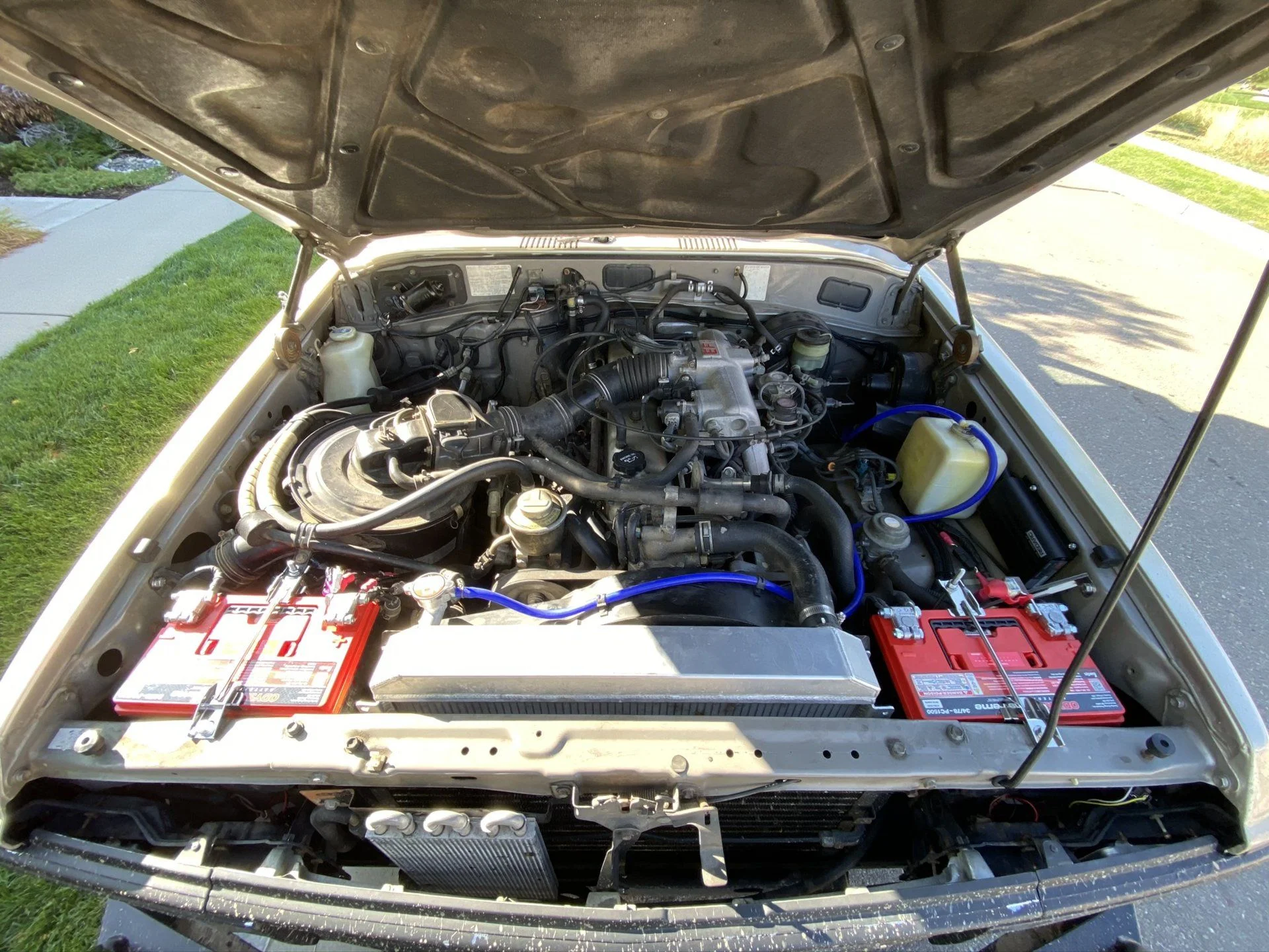

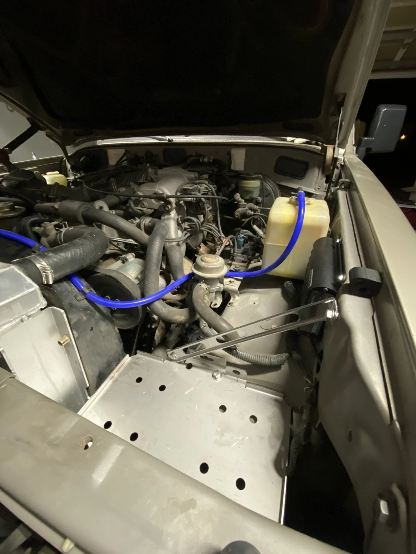

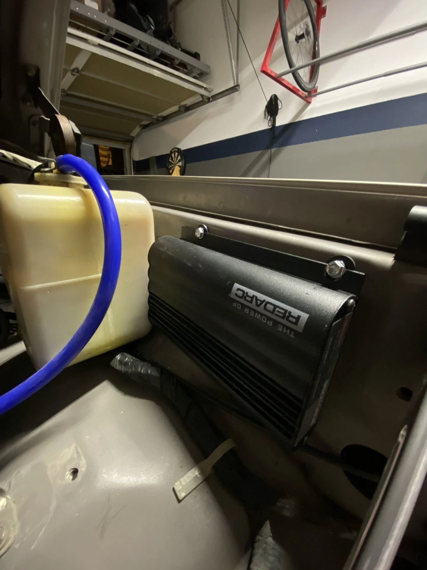

I have started down the road of the Dual Battery setup. Working alongside Juniper Overland in Denver Colorado to get this done right.
I am installing as much as I can and leaving the wiring to them.
Here are a few pictures of the install thus far. Removed the Vac Canister and relocated the Expansion Tank.

First a pic of the dual battery setup.
Worked like a charm this weekend with the inverter and the Roof Top Tent. Speaking of ....

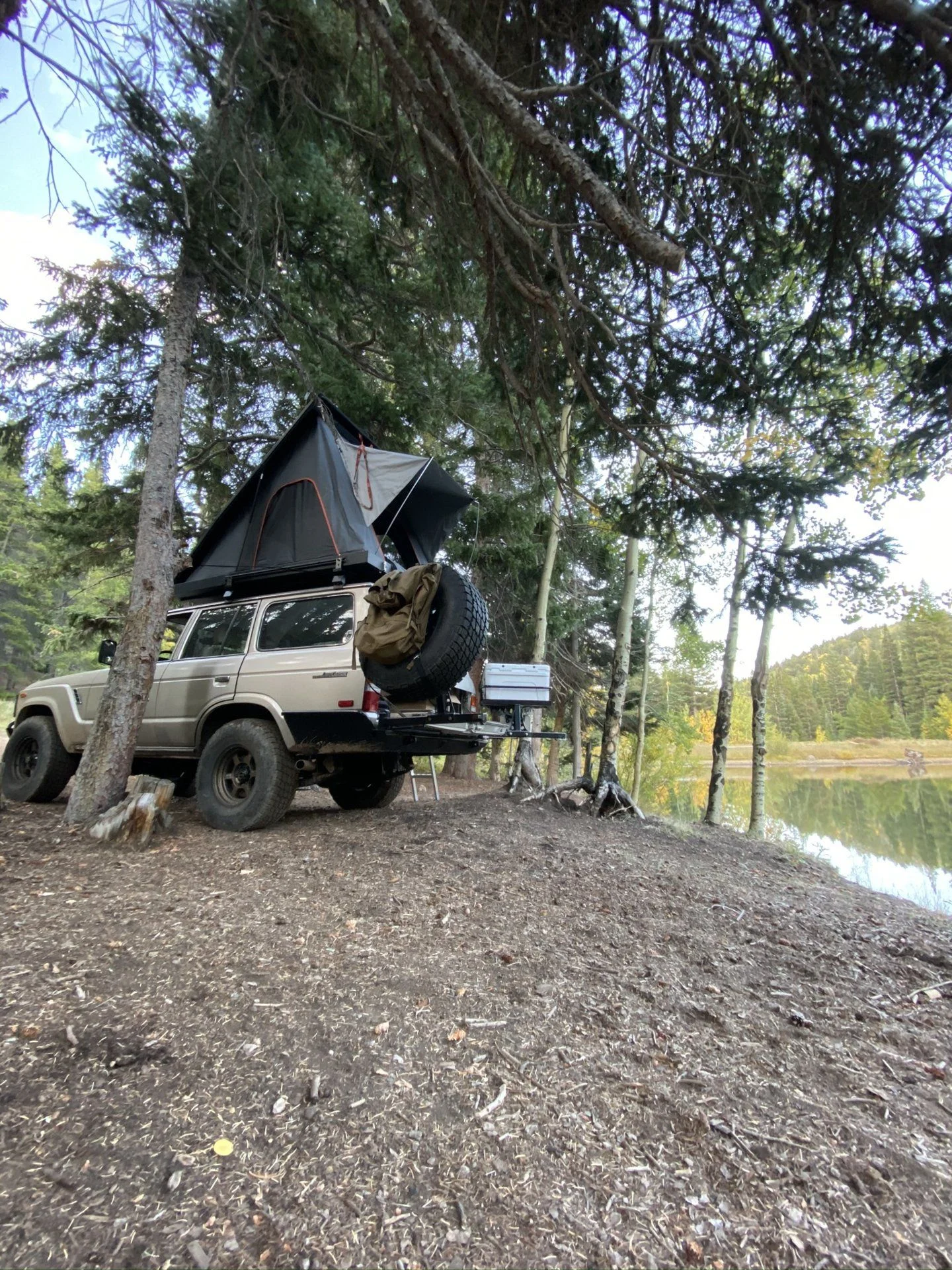

First 4x4 trip was a success. Did a nice easy and short trail US105 off of Rollinsville Pass. Was a bit cold, but me and the pup suffered little in the Roof Top Tent.
Now to start getting the essentials right for a trip down to National Sand Dunes or Moab next weekend ...!

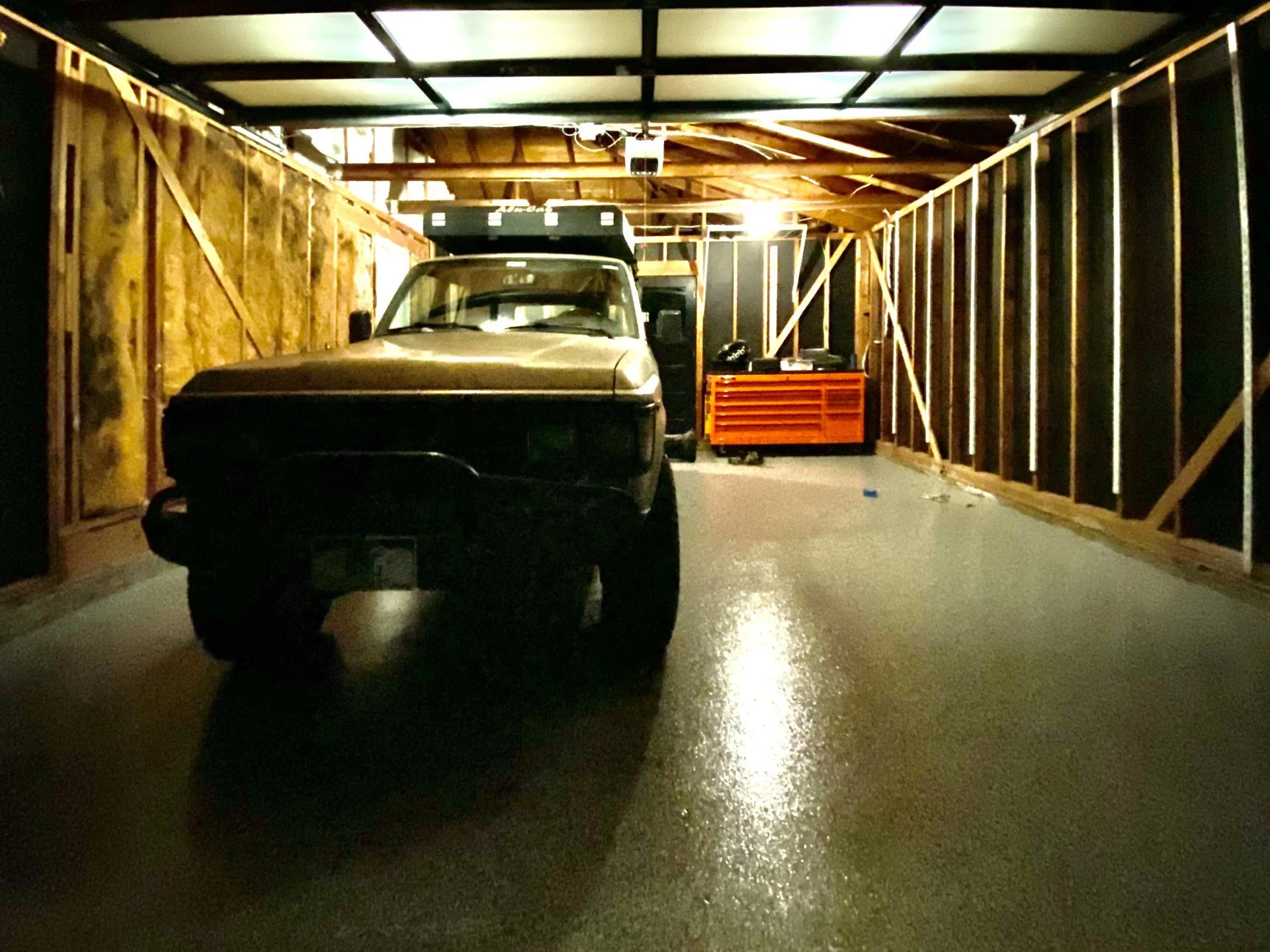

Garage (Engine is 1987 BMW M20b27 Super ETA) - I tore out the drywall to gain access to some wiring in our kitchen.

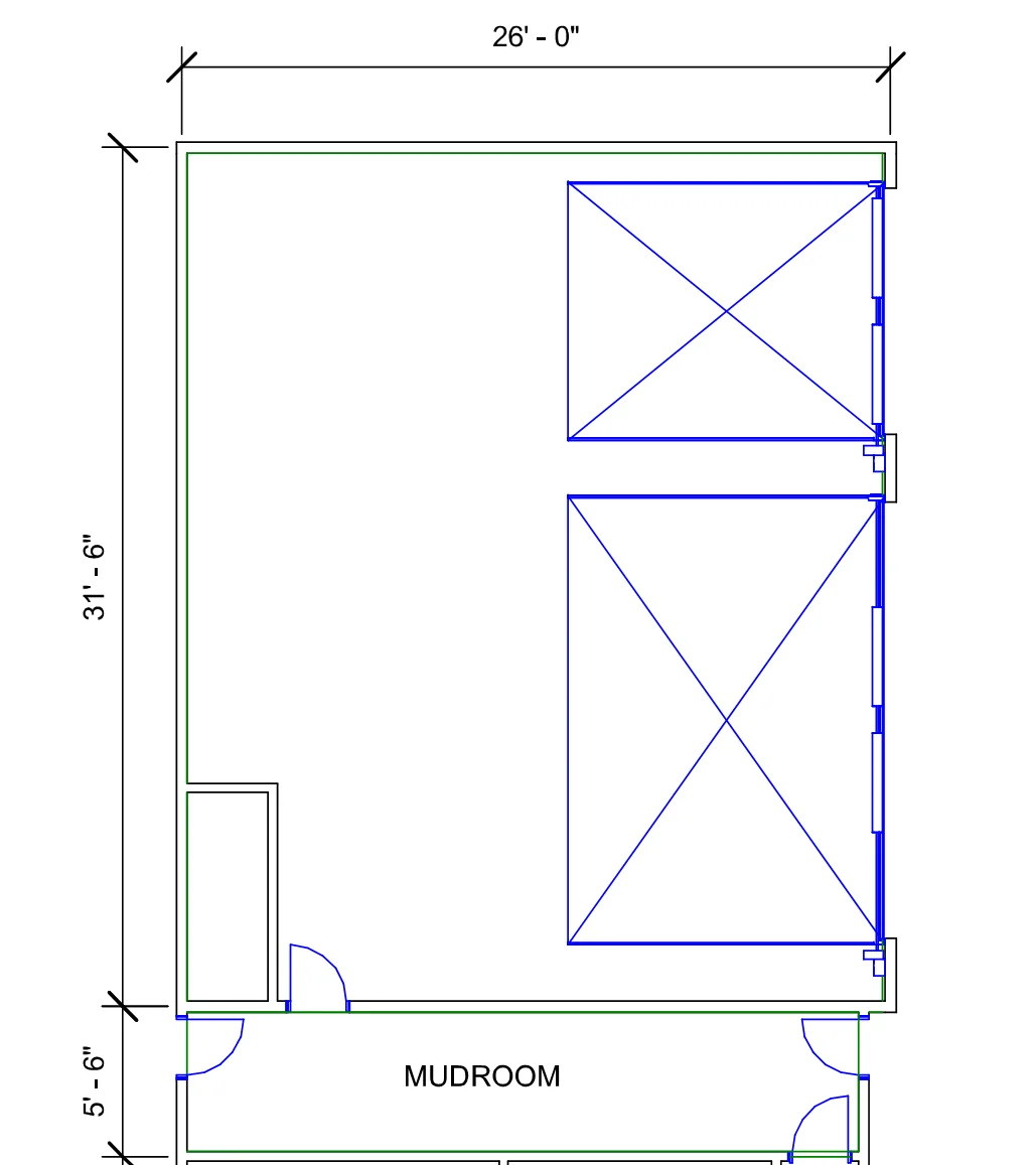

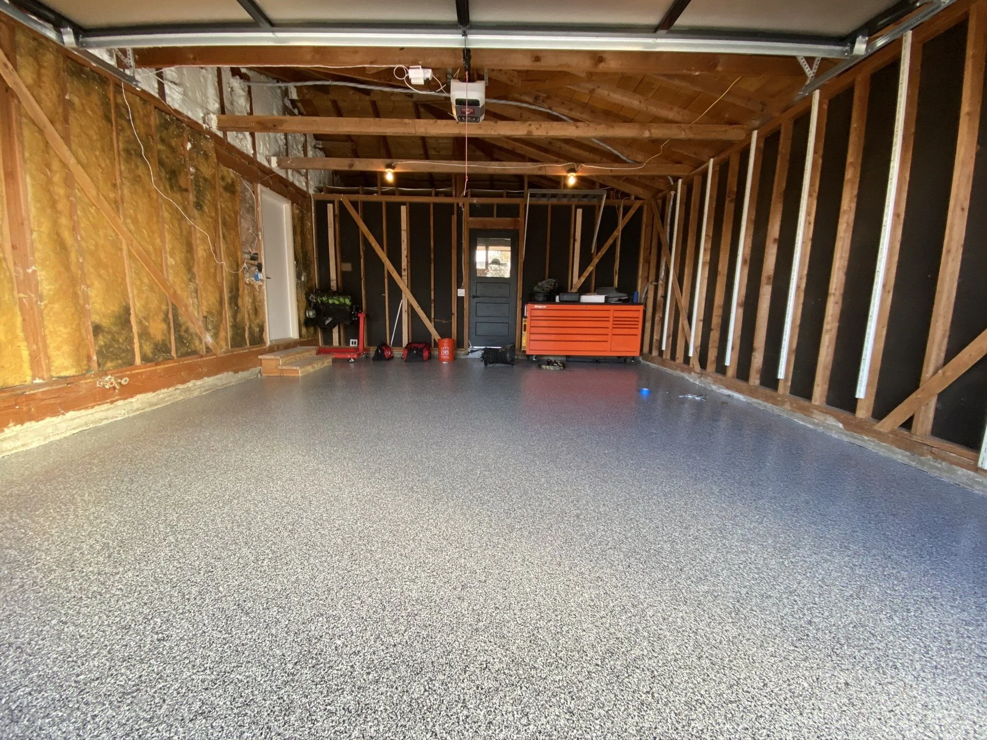

So we are going to add on a master suite while remodeling the current garage into another living room area. Which means, I finally get to design a garage how I want. I also don't know everything I need/want, so will definitely be looking for recommendations from the mud community and BMW2002FAQ on some of the needs/wants list I should try to squeeze into the garage.

@jackhossross, electrical outlets, install em at about 6' apart, 4' off the floor. i'd strongly suggest 2 220v circuits, one for welder, one for air compressor
Haven't thought about two 220v circuits, I am planning on building an air compressor closet with one 220v in there.
As far as a welder goes, I've got zero experience in that regards. I was planning on doing a simple epoxy coated floor .. but hadn't thought about heat impacts.
Appreciate the ideas -- keep them coming mud!
well then, it's time to learn how to use a hot metal glue gun! re: heat impacts, talk to a reputable flooring or painting company as both our flooring and painter do epoxy floors for us but i've never discussed weld splatter effects on it with them.
oh yeah, if it's in the budget, seriously entertain putting in-floor heat, you'll thank me in the middle of winter. i regret not doing it
I’d suggest enough height and pouring the floor to accommodate a lift

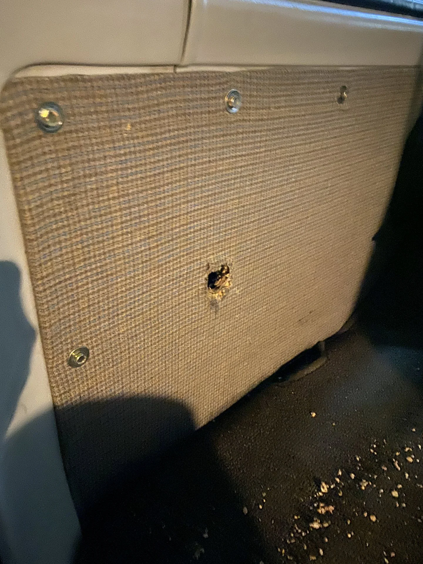

In order to wire it to the rear, I had to remove the trunk cards - which gave me the idea of replacing the pendleton fabric with the relicate leather i purchased.
