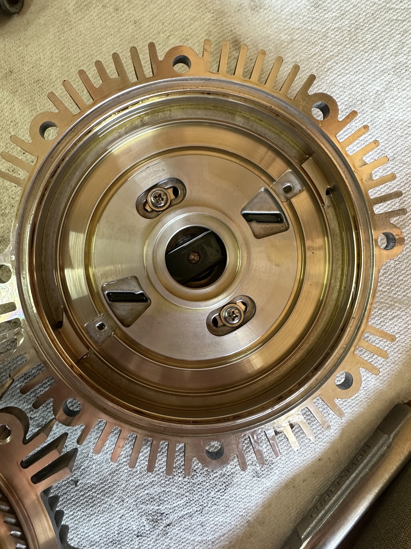

View attachment 3352919 View attachment 3352920
I used a heat gun to warm up the two sides of the case to aid with draining oil.

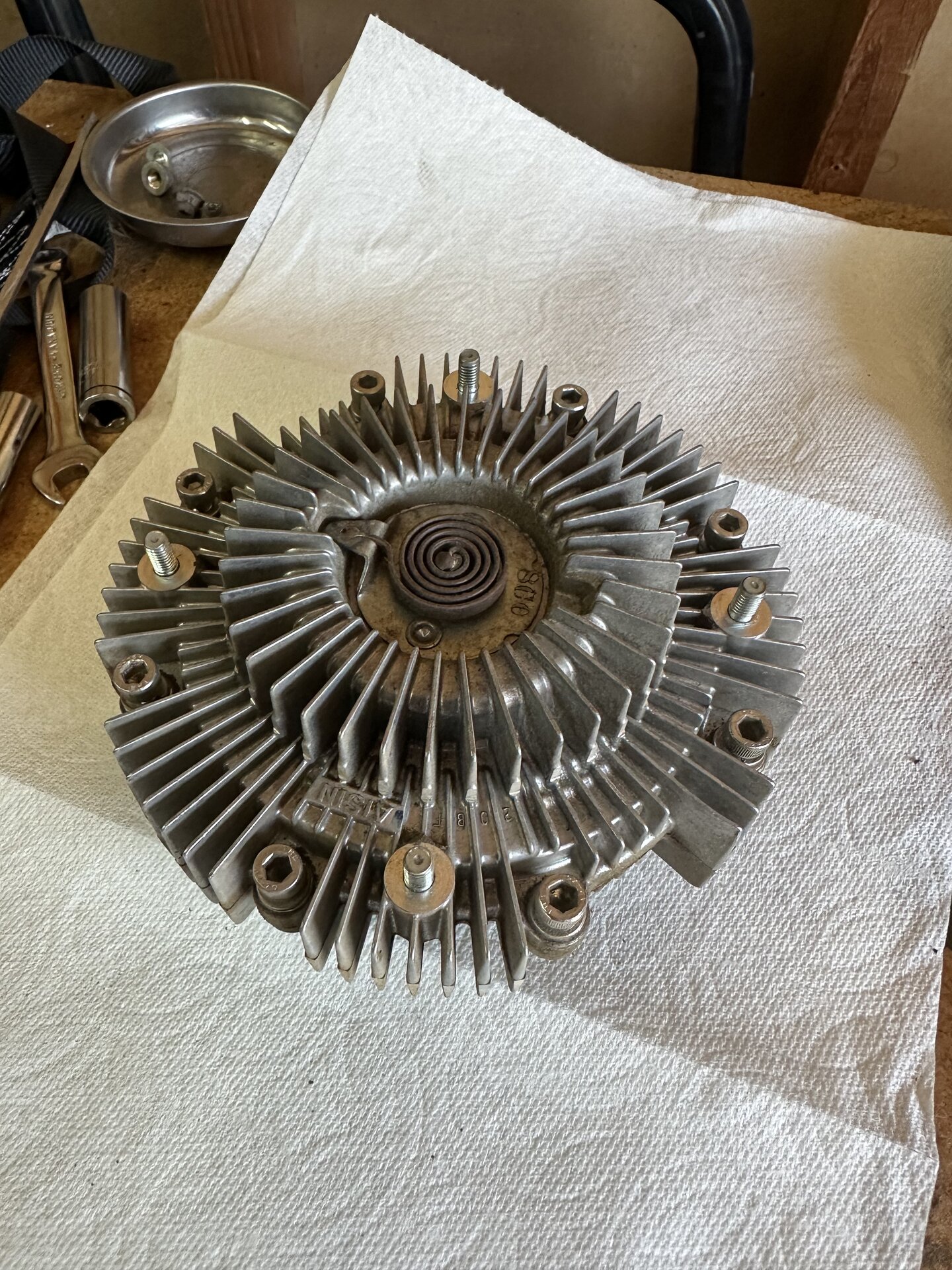

∆∆∆ This method works great, I spaced the bi metal coil (tstat) off the bottom of the pan but used the cool down method. I wanted to ensure the bi metal strip was fully and evenly heat saturated for adjustment.
The picture shows a brand new aisin blue fan clutch that didn't work well at all out of the box.
I brought the water above what I was going for with temperature with the bimetal strip and about half the body fully submerged then shet heet off, with my fluke multimeter tracking temperature, then adjusted.
I tested it 3 times watching the valving open and close, added 15cst oil and it's been great 2 years now.
