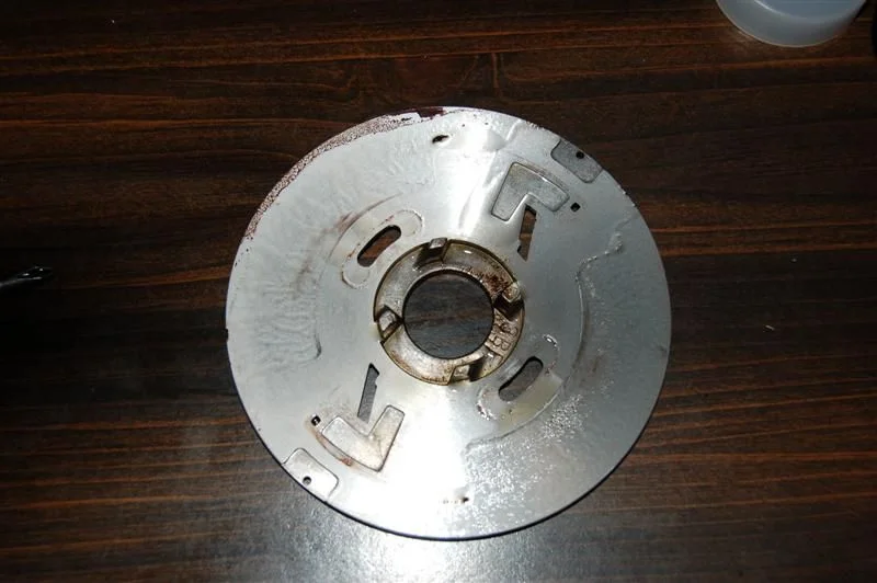

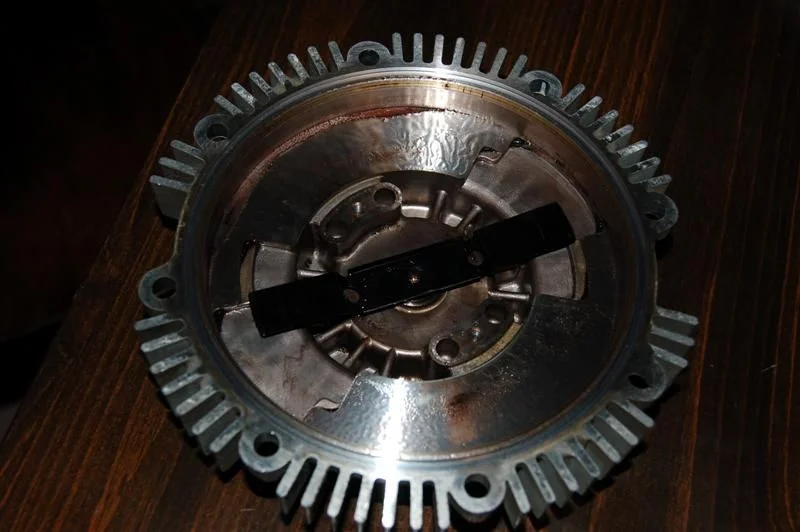

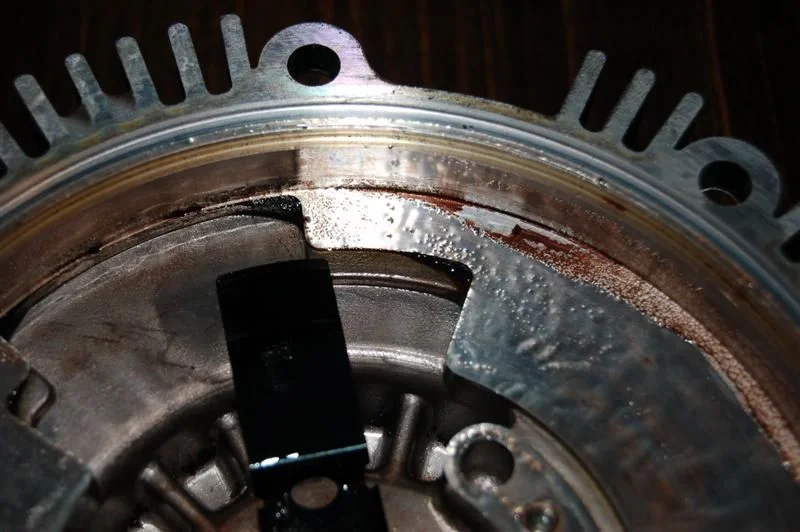

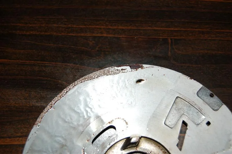

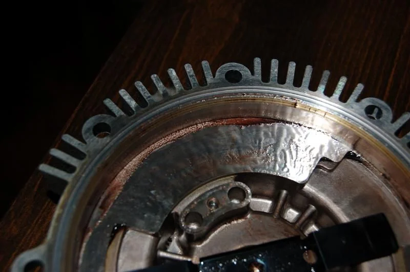

in another thread Cruiserhead05 had an issue which was resolved by replacing his blue fan clutch. I asked him if he would send me the "bad" one so I could autopsy it.
He did and this is what I found when I cracked the shell open
When I saw the debris in the clutch I suspected a timing issue and the clutch being set too early.
Boy was it, at @ 70* room temp the clutch was almost fully open and there wasn't enough adjustment to get it back to where only the primary stage would engage.
It would seem that these bimetal springs can change over time and I think people should take that extra step to ensure the clutch they are working with is one worth working with.
