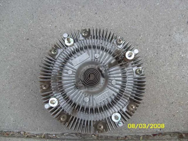

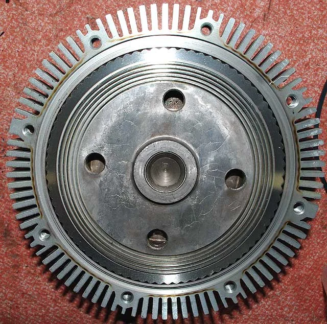

So i just opened it up and found nice deep amber colored oil in it. Also the on the inside on both sides of the plate surface there is some nice heat stress cracking. Now really thinking about going new all together and not even bothering with this one. Has anyone else seen this cracking before?

Some pix would help? I have never seen any cracks, have seen some casting marks that look like cracks. What brand/type of clutch? In Texas I would think about thicker fluid, like 10K+.
I thought about that but its not that hot here, only a balmy 100 degrees. But really i didnt want to hinder the performance if i go someplace colder for a trip. A buddy here put 6k and he's thinking of upping to 7k and another put 10k and i could hear some off idle knock real bad on his. I remember somewhere in this beast of a thread something about too thinck of an oil not allowing for proper running temps.?.
If your referring to the "crack" looking lines close to the center of the hub, those are casting "webs". Normal lines from the casting process, nothing to worry about.

Is that clutch a blue hub? It looks like an early style, if so it's the only other one that I have seen. They are good clutches, have more shearing area and a bigger reservoir than the newer style.
It has a black hub and is off my 94 which a had very good maint. history by the first owner. I thought it might be an aftermarket like i've read about but it has the aisin stamp and the cast thermo holder like the one you posted. I thought it was the same one, how is it different?
It does not look like any casting marks i have seen, it just looks disturbing to me.

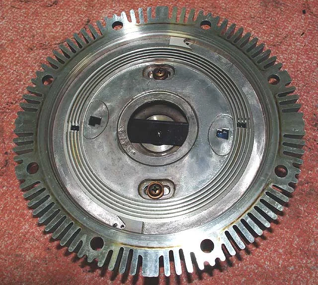

From that pic it looks like my "early" blue hub, shoot a pic of the other half?
It's hard to tell for sure from your pic, but they look normal to me. If they were cracks, they would extend across the machined part, in the pic it doesn't look that way. Maybe post a closer crop of the center area.

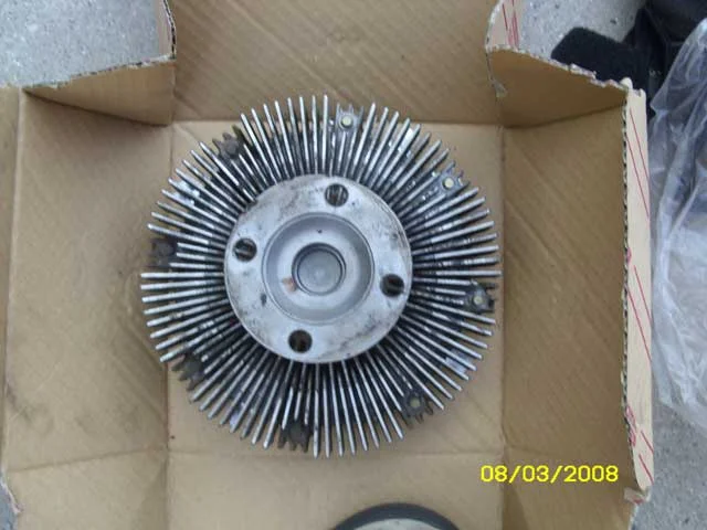

Here are some more...
So is this one worth tweaking and re-using like the blue. I have already gone this far so im just going to try it out. THe question is how to fill with new oil? Im using hobby shop oil so i cant make it "so many tubes of toyota stuff." The bottle i used is a 40cc plus a little more of another but i cant see the underside of the inlet hole like Landtanks pic.
I guess the question at hand is, If i just fill it up to the top lip of the plate on the hub side, is that too much?

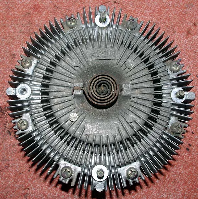

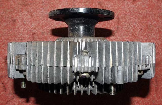

A “new” clutch to look out for. We did HJ60’s fan clutch on his ‘94 FZJ80. It has a black hub, but full cooling fins like an Aisin and still had some drive, so we pulled it instead of ordering a new blue hub. Sure enough it is an Aisin, with a black painted hub, haven't seen this before. Have no history on it, so no idea where it came from, how old it is, etc.
Inside the design looks the same as my early blue hub. Larger reservoir, boot type “3 speed” valve and extra shearing area/grooves. These are the most powerful clutches that I have seen and this one didn’t disappoint. We put 13,000 fluid and it moves major air. If you have one of these clutches, hang onto it or send it to someone who can use it. They are great clutches and probably no longer available.
Lately I have saved and measured the fluid drained from two blue hubs (40 & 42ml) and this black hub 51ml. This number is what could be removed from the pan, there was some lost in rags, residue in the pan, clutch, etc. I have been putting 50ml in the new type and we put 55ml in HJ60’s black hub, my guess is the older design clutch could hold 60ml+ and still cycle correctly.
