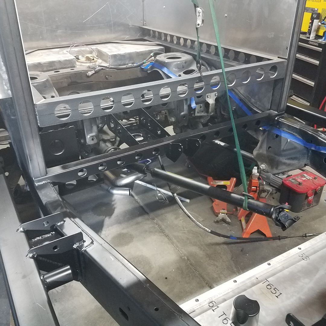

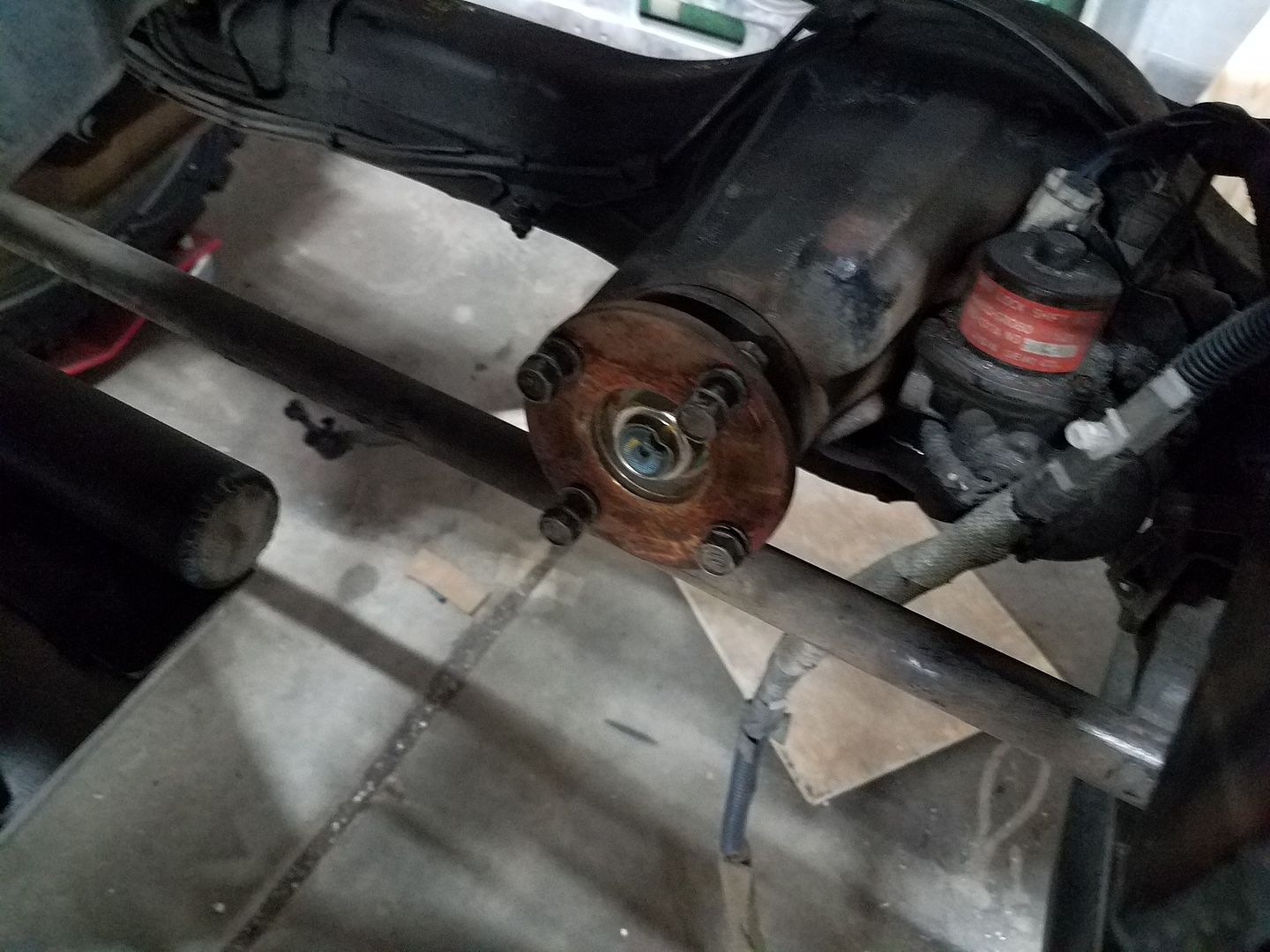

Tonight I mocked up the rear driveshaft from Tom Woods on the #LX45 tonight. One neat thing about this project is that the front and rear driveshaft are the same length. This means a common spare will work on either end. In order to make everything exactly the same I needed to drill the regular 10mm Toyota pattern on the 80 series rear flange. Now everything uses all the same parts. I also really like that the driveshafts are protected up in the frame with the flat belly! I also did a little work on the t-case center diff lock, but didn't get far on that. More tomorrow.

The front shaft test fit.
It really gives you a perspective for how low the truck is with the driveshafts hidden by the frame. That's a rare thing with tires this big!

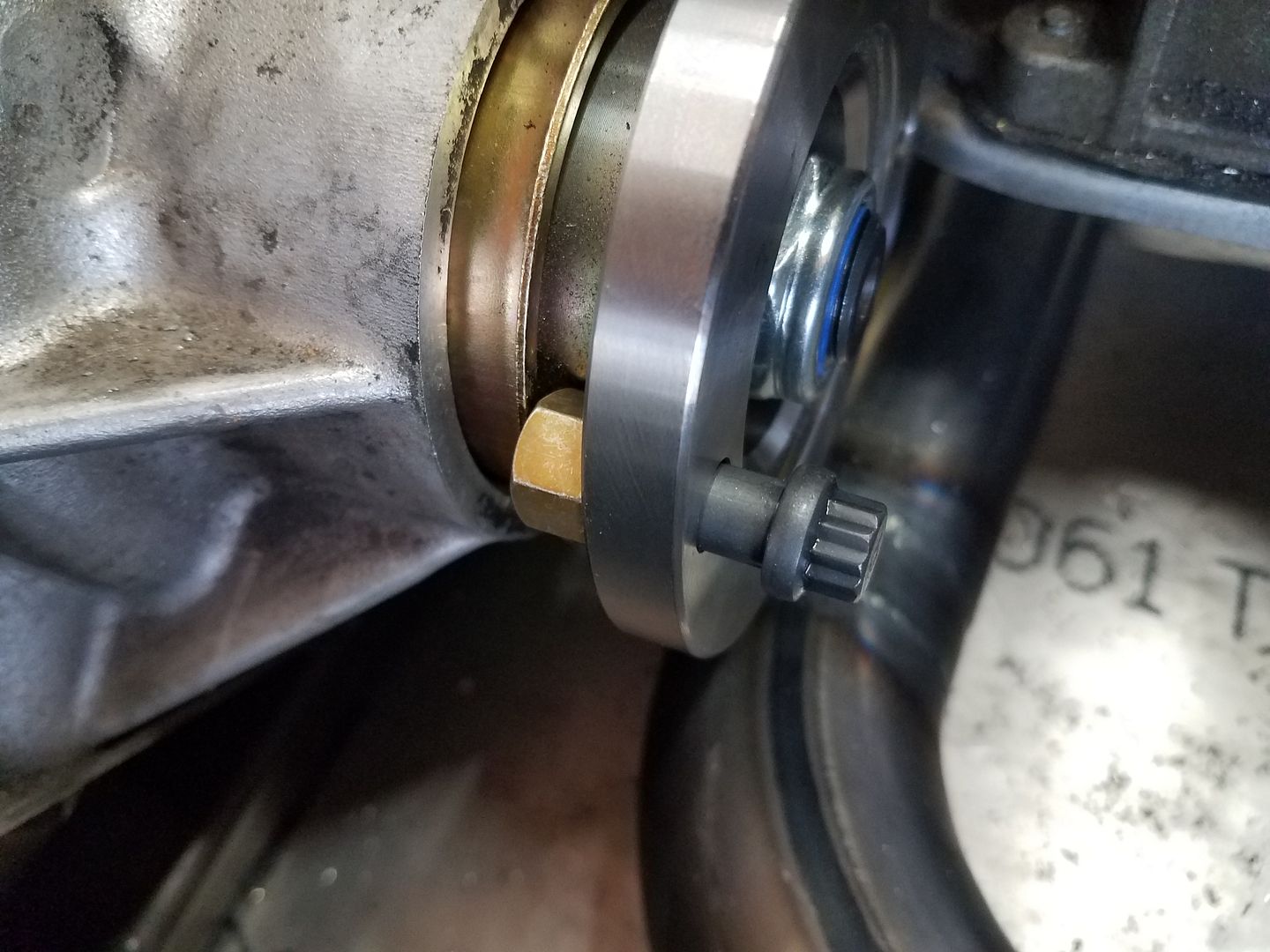

Made some custom length grade 9 fasteners for the LT230 side of the driveshafts along with a full set of spares. The LT230 flange uses a 3/8-24 fastener. I wanted the shoulder of the bolt past the seam of the flanges for the best strength. I ended up having to buy long units and cut them down to the length I wanted. The LT230 flange usually traps the bolt, but I didn't want to have to remove the flange to replace the bolts, so I reversed things. The nut is trapped basically from spinning so you only need one tool to check/remove/replace things on that side.

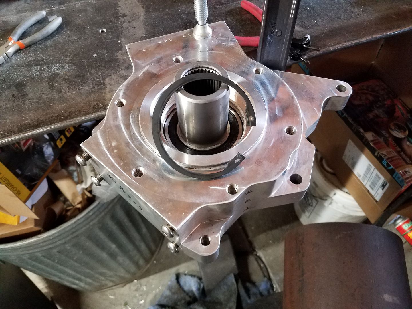

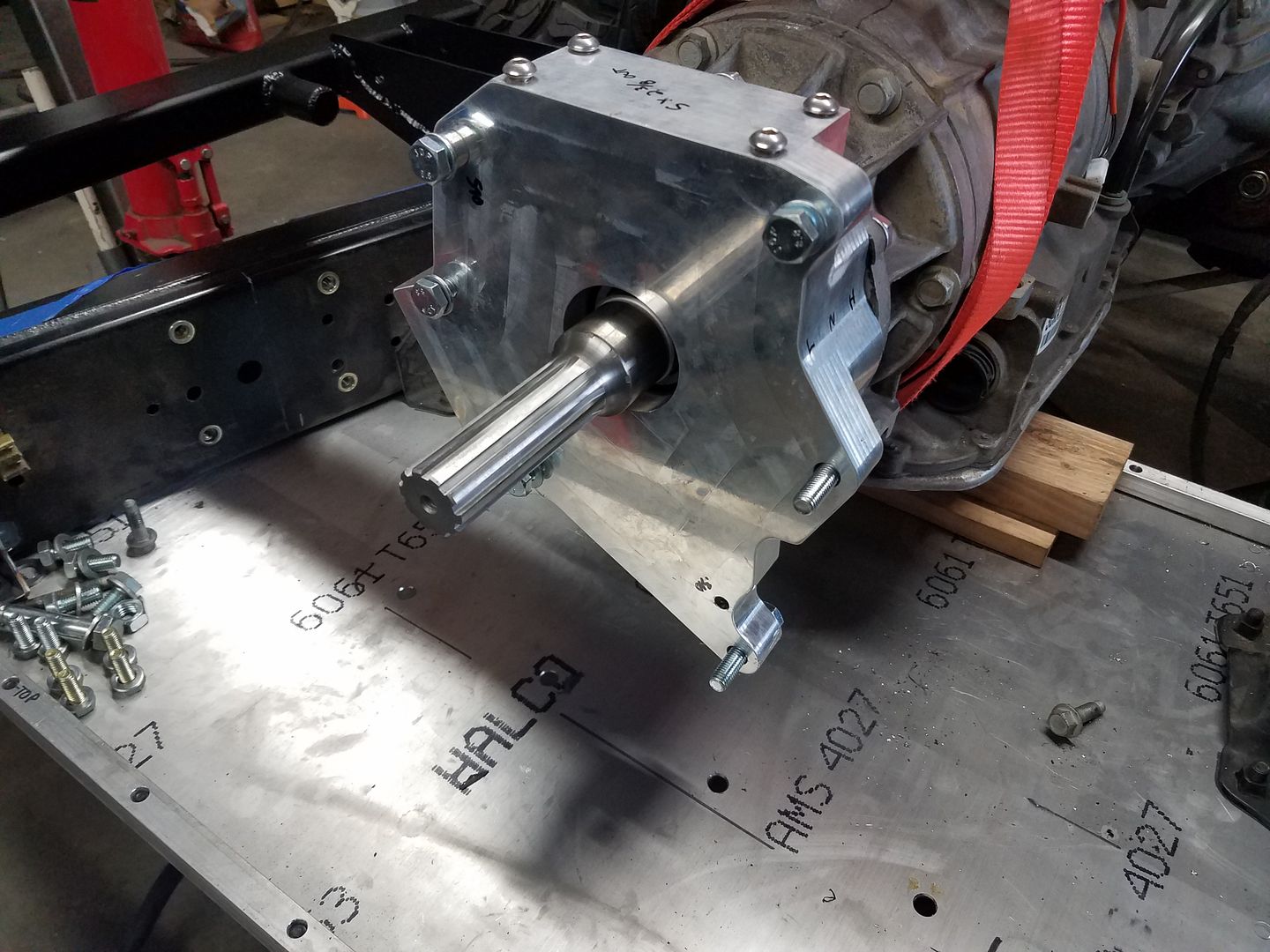

Worked on assembling the adapter with the bearing and spud shaft, but got defeated by a monster snap ring. I ended up having to borrow a set of LARGE pliers from work.
Made a hollow alignment pin thing for the adapter setup.
I got the adapter back on the transmission. I need to get some more metric hardware to hold it all together.

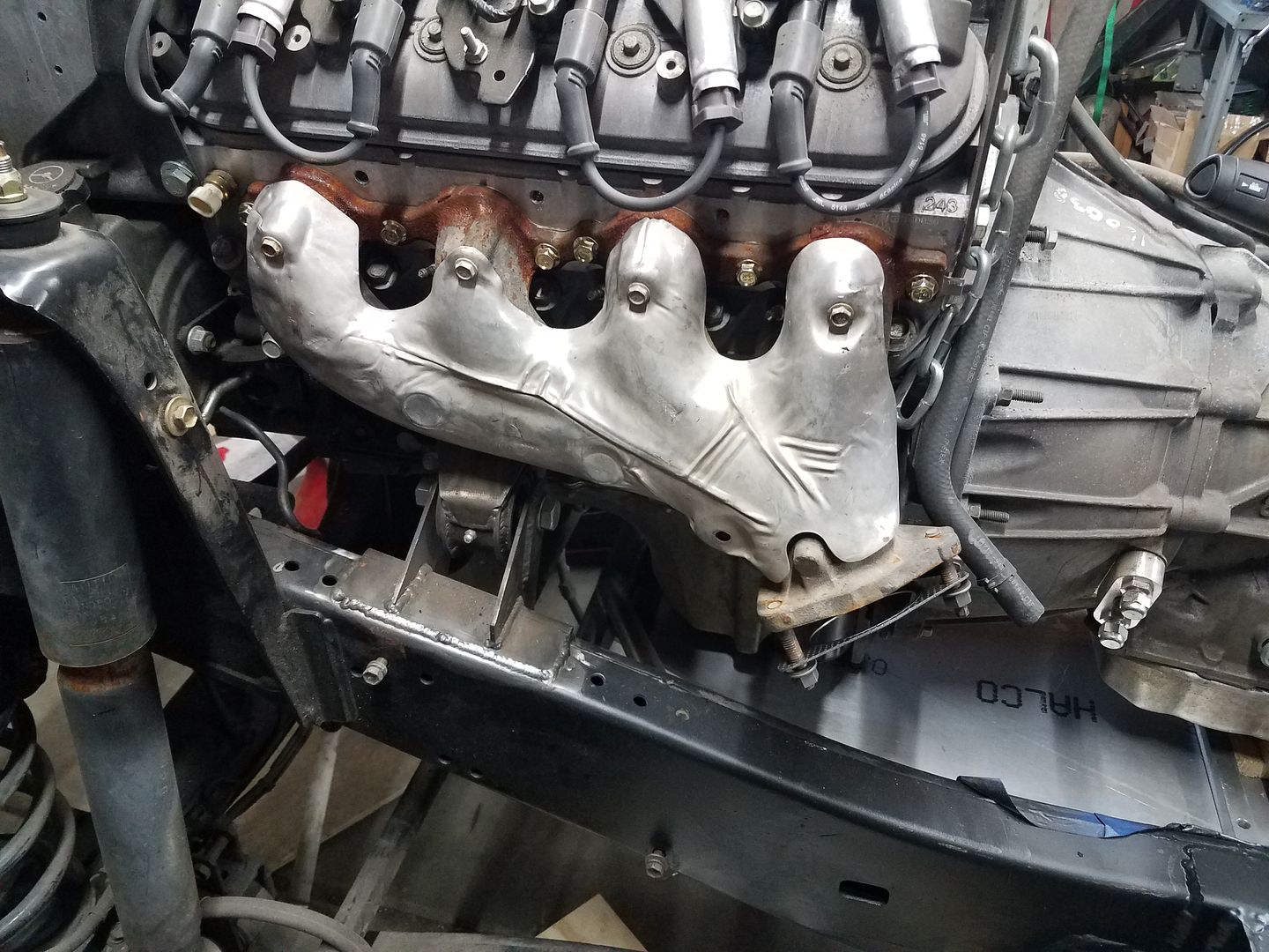

Off with the old exhaust manifold. It had a broken stud that kicked my butt.
I used a new gasket and hardware to make sure it sealed up like stock.
A friend was nice enough to send me a clean replacement manifold.

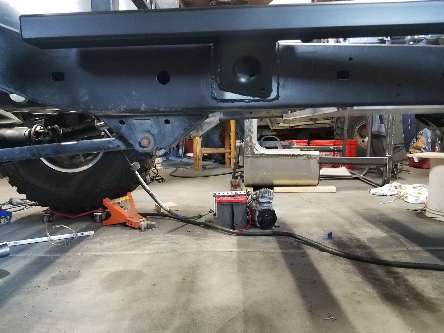

Killing some time painting some of the rear crossmember stuff along with the battery, air compressor, and tank mounts.

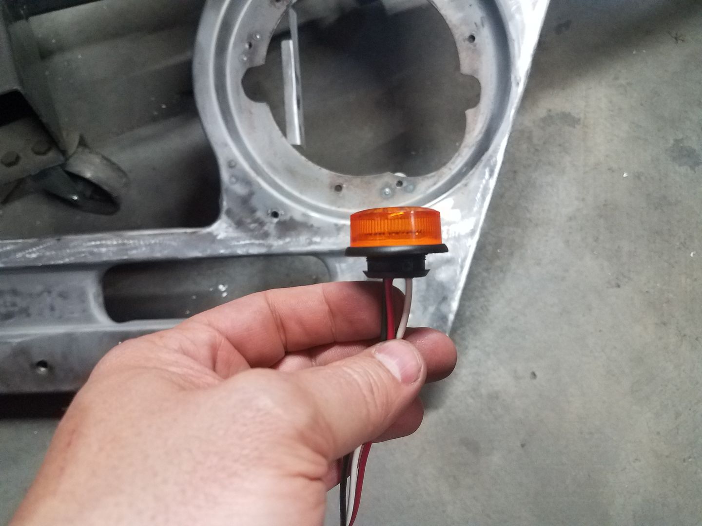

I finally found some turn signals I liked thanks to an Expo Portal member. I made this little layout template to help me center the hole I needed. I find it easiest to locate stuff like this based off the OD when dealing with pressed cavities like this.
These lights ( Peterson Lighting M286A LED ) mount with a grommet, but are surface mount so they stick out of the grill a bit. Hopefully they will be able to be seen from the side more.

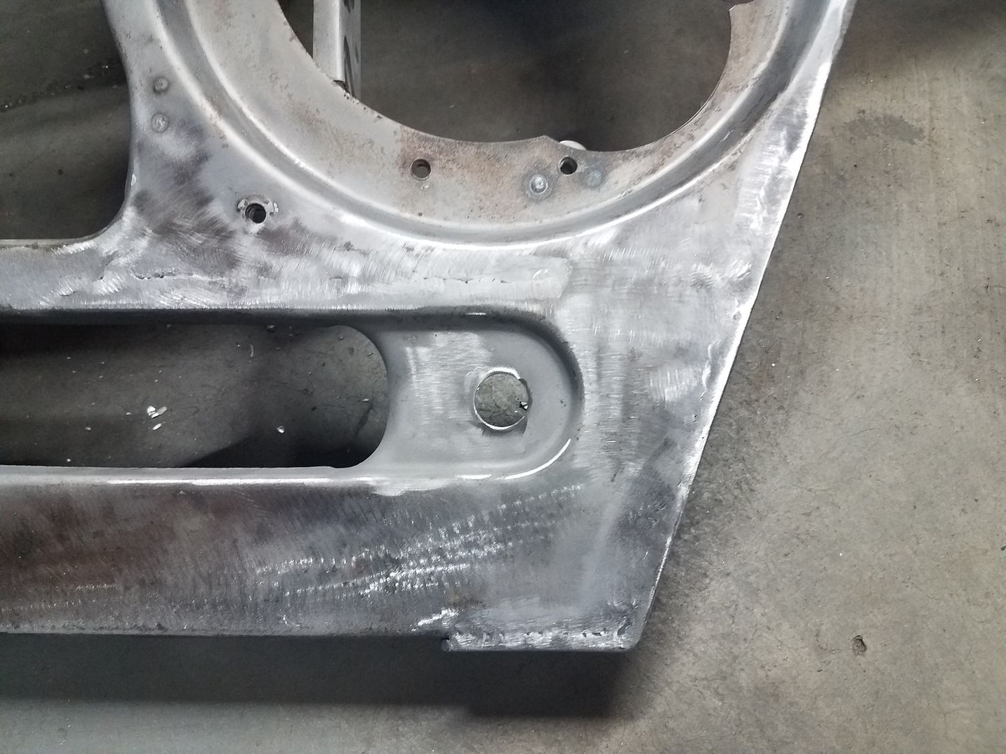

Somewhere in there I forgot to get the forward support for the belly pan powder coated. I dropped that off, got it back like 48 hours later, and then went ahead and installed it.
I am really liking these large clip nuts for the attachment of stuff like the belly pan where possible. They only take one tool, you can replace them, etc.
