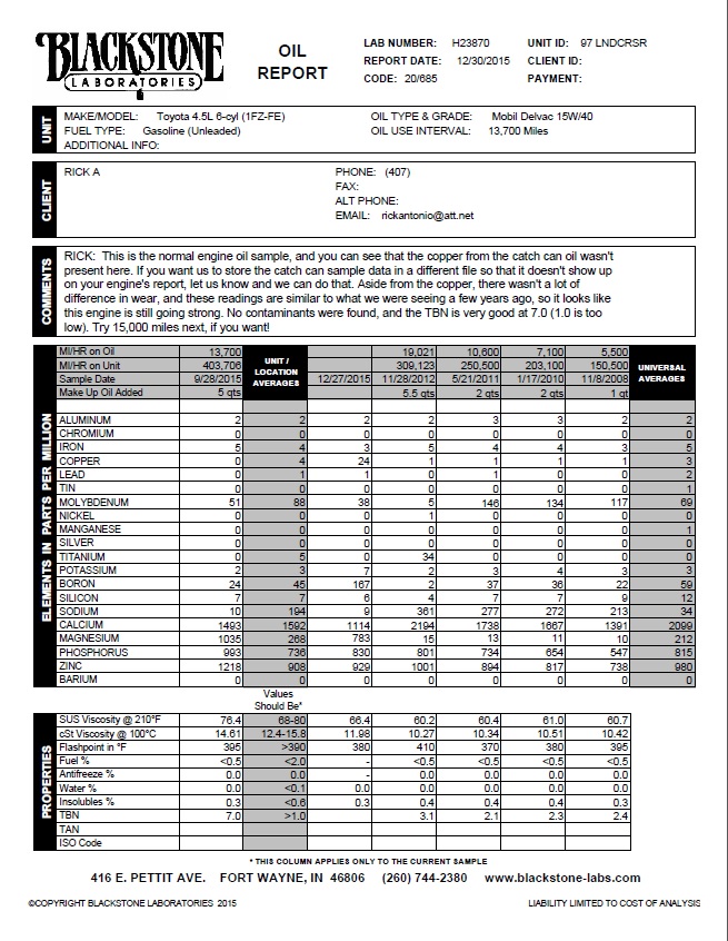

Sent in another sample to Blackstone :cool:
This one was taken at 403,706 miles with 13,700 miles on the interval
Oil used was Mobil Delvac 15w-40
Wear looks the same, but the TBN jumped to 7.0 :eek:

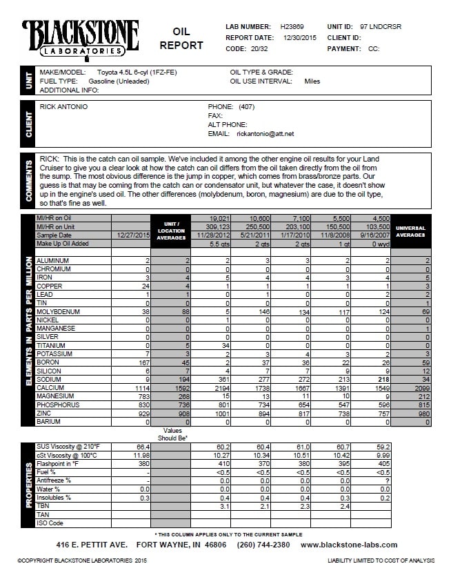

Also sent in a sample of the catch can oil just for kicks :hmm:
It showed high levels of copper due to the hardware used in my catch can setup, but none shown in my crankcase oil sample :cool:
I've always been curious about the quality (or lack of) of the oil caught in catch cans as I know many people who tend to dump theirs back into the crankcase (sumthin I'd never do) :eek:
Given these results, I figure if I did dump it back it, I'd get a false wear readings :doh:
Some incredibly good and scientific data here. This is sort of the holy grail of engine wear data - an analysis of the engine oil (et al) for more than half the engine's lifespan. I will link people to this thread when they obsess about engine oil for no reason. Seems like the time has finally come for a new head gasket for you - I would say that, after 400k or so, you've gotten most of your money's worth out of it. Bravo.
