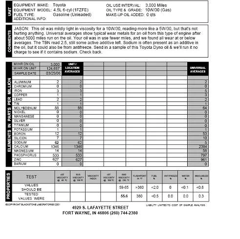

A few days ago, I sent BS an Engine oil sample as well as a Gear oil sample from the front diff....
Engine oil used was Toyota Genuine 10w-30 (non-synthetic)
I usually change the oil @ 3,000 religiously, but for this sample, I stretched it out to 4,500...
I was also harder on the rig than usual with multiple full throttle stoplight sprints and longer idle times in the hot Florida sun :o
My main concern of course was coolant contamination and after the results came back with high sodium, I'm not really sure what to think :confused:

Everything looks fine. Once again, we have support that the 80 is very easy on engine oil and that even 5000 mile intervals are easily done on mineral oil.
For the money, I would pass on the Toyota oil and if you insist on using a 10w-30, use any good quality mineral that will be cheaper and every bit as good (preference for Chevron).

Part of the oil additive package, used in some newer oils.
This is what I'm hoping for :doh:
I'm gunna do as they say and switch to another brand for the next change and retest, but how do I know which brand doesn't have a sodium additive :confused:

They said it from their report that send them "virgin sample oil" to them for no charge. Do you have some left over that you can send them? Let us know.
Save yourself some worry....
When I was using Toyota oil and sent in a sample I got the same results with the sodium. If you're thinking HG don't worry about it --- my original HG looked perfect when it was removed.

Well, I sent in virgin samples of both oils on Monday and just got the results (that was pretty damn fast lol)
I've got good news and possible bad news :doh:
Good News:
Possible Bad News:
Now the reason I say possible is because Molybdenum was found in the first sample that was mixed with previous oil that could possibly have a Molybdenum additive (or so I hope)....
I still don't see any traces of mixing, so I'm not too worried about it :cool:
