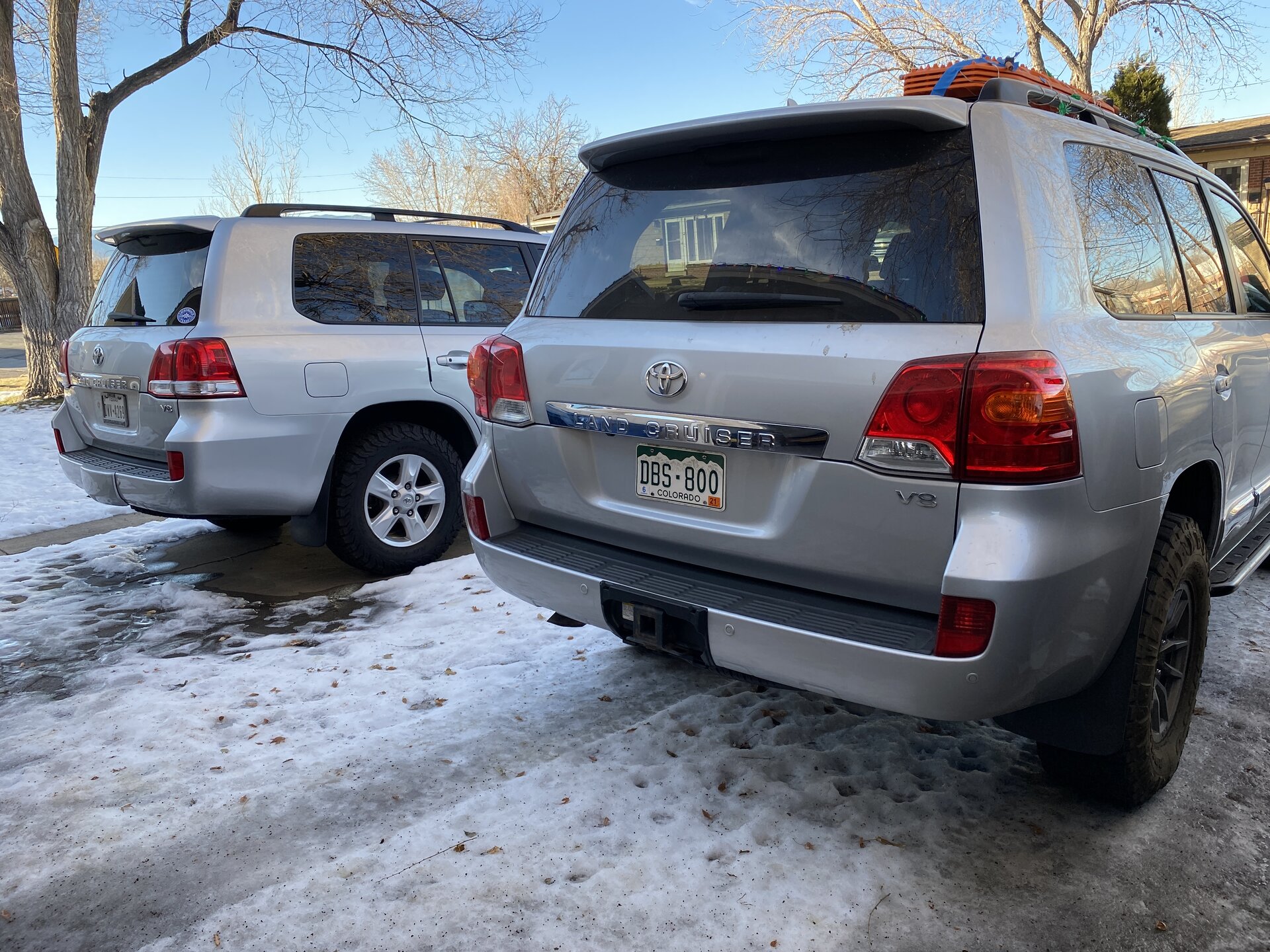

Pre-2016 LC200 trim fits and is black.

Most people just paint or wrap it (which doesn't require removing). I think the trim is integrated into the glass for the rear quarter. But yes, there is no part to order to only replace that trim. It took me a couple hours to paint it, wish I had done a couple more layers of paint and scuffed the trim a little more. After 6 months or so it's chipped in a few places. Still looks fine from 10 ft, but the chips are there. Any semi-gloss black looks fine. Maybe a clear coat would have helped with chipping.

Here's an example part. You can see that piece of trim is integrated into the glass.
Right.. should have said that,,, you would have to buy new windows with the trim. from a 2008 iff I remember correctly. IDK... I abandoned the idea before looking up part numbers for that.
Nah not necessarily… even newer models are sold in the non-blingbling version but not in the US.
6271060F30 should fit.
In case take a look for aVDJ200-GDMNZ model that has definitely no bling bling s*** on it so the parts should be nicely black.
