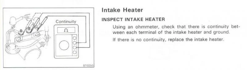

2) The glowscreen appears to have continuity between the 2 terminals (as per the FSM) are there other things I should check/review before I reconnect the glow screen?

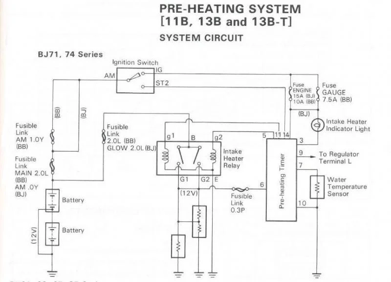

Well I guess I'm pretty much an idiot because I've looked at those diagrams (from the manual that I have (in hard copy and downloaded) - I've tested the continuity but looking at the second diagram - I still don't know where to connect the blue wire and the white wire.:bang:

I think the 13BT glowscreen wiring ... with colour codes ... should be in the back of the Oct 1984 Chassis & Body FSM 36262 but it isn't. (Toyota only shows glowplug systems there.)

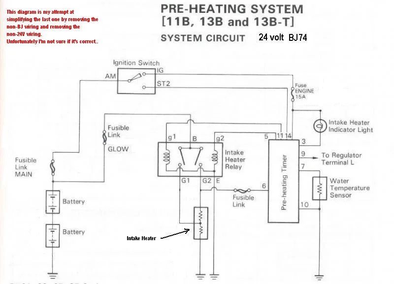

This is what I get, when trying to remove the irrelevant stuff from the last diagram I posted:
(Maybe Rudi/BJ40green might like to comment on whether I've got it correct or not?)
Do you get any voltage on those wires when you're try starting your cruiser? If so exactly what happens and when?

Wow Many thanks for the effort!.....I will see what I can come up with, testing wise....If I get voltage for say 14 seconds and then it drops off maybe that will be a helpful clue.......

Hi Rob & Tom,
Is it safe to say that those 2 studs are just connecting points?
In other words: that's the place where the glow screen wires meet the glow relay wires? Nothing more, nothing less.
If the answer is yes then we have to figure out which stud is low ohms en which one is a bit higher ohms.
Once we have that figured out we have to meassure which wire is pre glow and which one is after glow.
How am I doing so far?
Rudi

Hi Rob & Tom,
How am I doing so far?...Rudi
Sounds a good idea to me Rudi.
