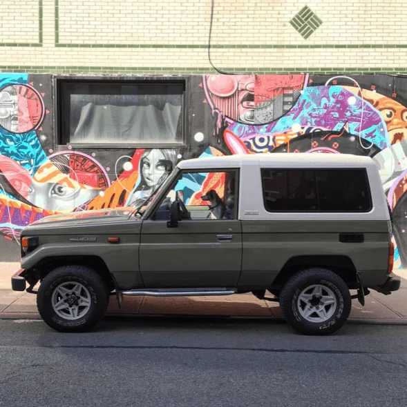

Im getting conflicting info from different sources if this conversion would help me get up hills without slowing down.
Currently with a 3B and thinking to make the upgrade.
Some say definitely, some say not so much.
Wondering if the extra cost will be worth it.
Thoughts?
The 3B has a blown out head and need to be rebuilt or replaced.
