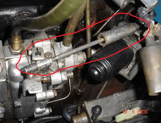

This is the rod you need to pop off.. if the problem stops when this rod is not installed.. you have an EDIC fault..
Thank you! I just found it. I did not pop it off yet but I did see it moving every 5 seconds when the lights and fan are on, causing the engine to stop shortly. However once I turn them off the EDIC doesn’t move at all. What can this problem be?
