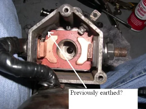

Not much of a surprise to me since I'm pretty sure I screwed it up somehow. Below are pictures of the replacement parts and the starter post repair. The kit I purchased did not come with new bolts and the contacts were shaped differently, not sure if the shape of the contacts caused a problem. My gut feeling is that when I was trouble shooting all the fuel problems, diesel somehow got into the starter. When I opened it up this time I noticed the smell and residue. I used an electric parts cleaner to degrease. I also used dielectric grease in some spots. After trying to make it crank, the smoke was coming from the wire from the yoke. I immediately tried to remove the battery leads and burnt myself pretty good, it got that hot. What other damage should I look out for?

Near the beginning of this thread it appeared to me that you said that the wire I have "arrowed" here was "wrapped around a cover screw". And then - if I understand you correctly - you say you moved that wire "to its correct position" (where it sits in this photo):
If that is the case, then that wire has been swapped from "being an earth" to "being live (at + 12V)" whenever the starter solenoid closes. (Hasn't it?)
The starter surely can work properly only in ONE of those positions (and not both).
I can see that wire shouldn't be "wrapped around a screw" - but did the starter actually work that way?
:frown::frown: Or where did I go wrong in reading your posts?
PS... I'm probably talking complete rubbish now. ..... But I'm just thinking .... Perhaps that wire is for the "pull-in coil" (because it would act as an earth only untill the solenoid pulls in). And what if the "holding coil" was knacked so the PO wrapped that wire around a screw to energise the "pull-in coil" continuously when the key is in "start". Perhaps in that way, the PO could get the starter to work with only the "pull-in coil" (running the risk of burning out that coil too if he cranks the starter for too long).. ....... Just brain-stormin. I didn't even know there were 2 separate coils until working on this thread so I am really quite ignorant about our starters and I certainly don't recall exactly where that wire goes on my starter.
You're right, that that wire was extended and poking outside the housing and wrapped around a screw. It had been that way for a while because the gasket under the cover has wear showing its location.
I really did not think this through as you are trying to figure out now from my posts, I did a point a shoot. The starter worked before as you say. I guess I should have left it alone and just replaced the contacts. The FSM does not have a view of the inside of this part of the starter like I've shown, I really wish it did. I think I will pay to rebuild the unit, approx $250. I'll probably remove the unit this weekend and ship it to them. I'm now a bit concerned about all the heat put into the wires after my last attempt to get it started. Any ideas as to what I should check before trying to start her up again?
Before sending it off to get rebuilt give me a few minutes to take a photo of my spare starter!! That should clear things up.
It looks just like my spare starter inside! The wire that "lostmarbles" has an arrow to is in fact connected correctly as per my spare starter. Pictures will take awhile.
Here's a picture of my spare starter. It is good so the wires are correct. 12v
Wow, what I notice right away is that the wire from the yoke is very well insulated all the way to the contact. I now see the purpose of the plastic ring held by the contact bolt, it holds the insulation preventing the end of the contact from being exposed. On my starter both contacts are exposed and the plastic rings are broken. I can see how oil, and diesel dripping on these parts can cause a short or damage over time. My first attempt to isolate this wire only used a bit of electrical tape and that really is not the proper use for the tape. I think Ill call the repair shop and see if they include the proper insulation and plastic holders to prevent this in the future. Thanks for the picture.
