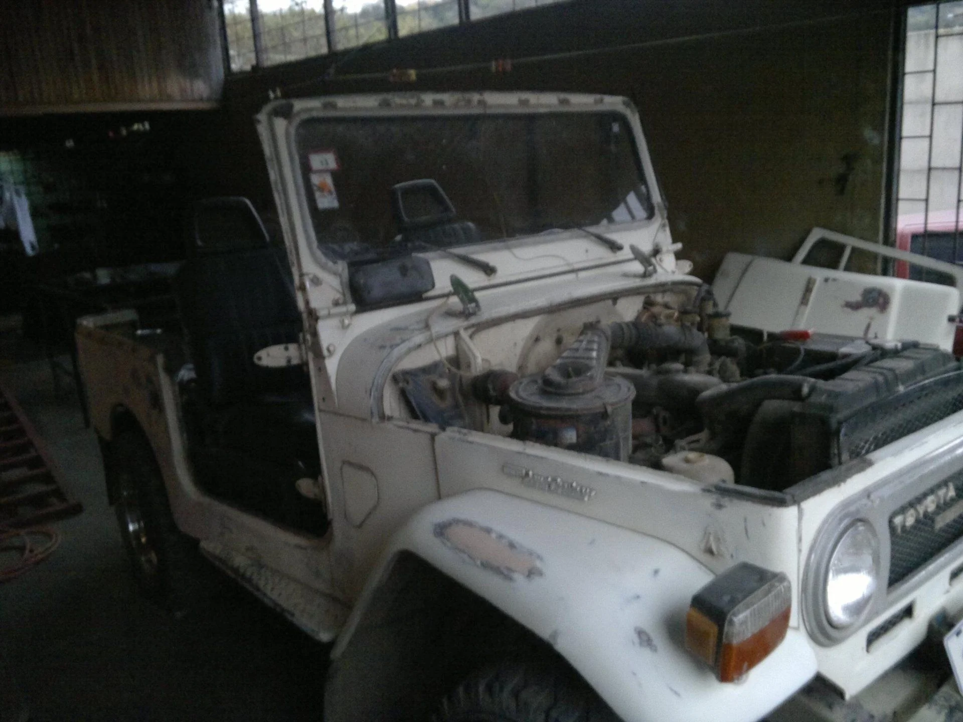

Here is a photo of the BJ40 right now. (Im doing some work to the chassis)
One question... What is the pressure of each piston in the B engine? to test it on the compression test?
Looks like a good start!
