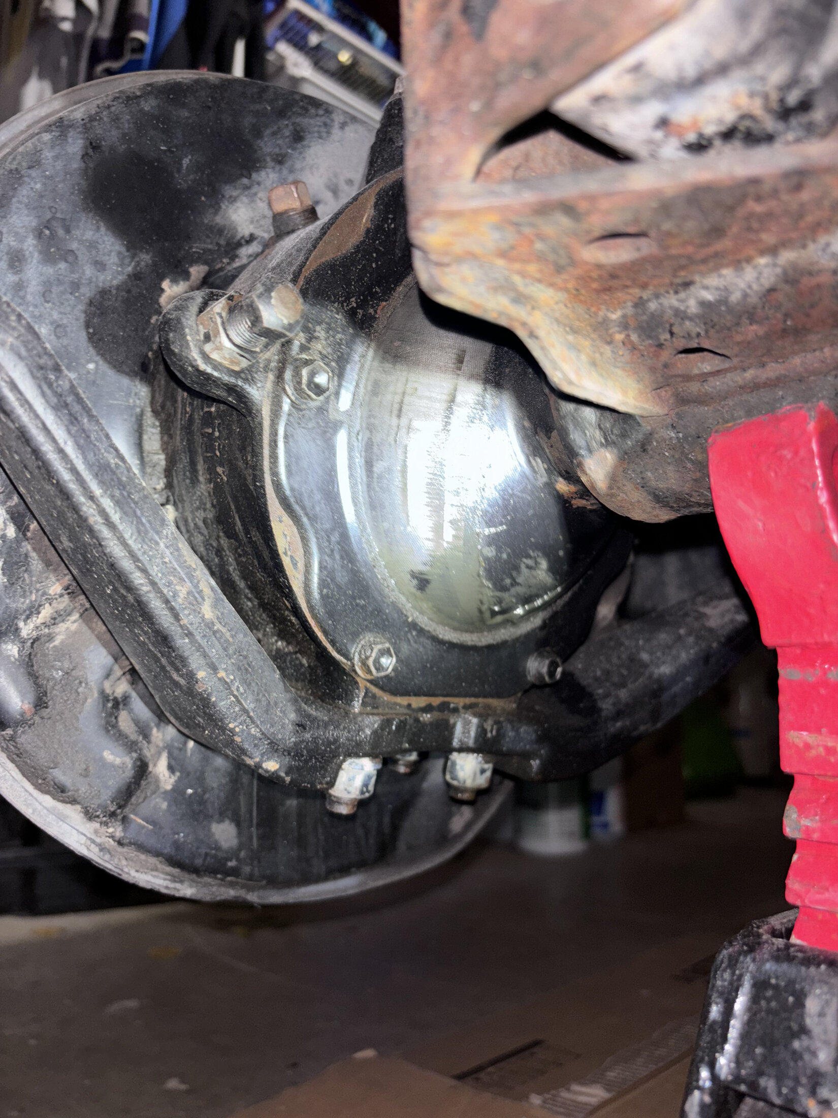

Okay, I did a reasonable job removing the 30 years of accumulated Dolly Sods, WV dust. I checked the 12 17mm bolts for the Trunnion bearings. I would say the top two on the passenger said moved slightly before the torque wrench "clicked." All of the others did not move before they torque wrench clicked. I backed them off minutely, and then torqued them down. Nothing remarkable. The zip tie confirmed they were about 2/3's full.

View attachment 3642333View attachment 3642337
Strong Work and thanks for the Pictures. Smart on the Torque Marks.

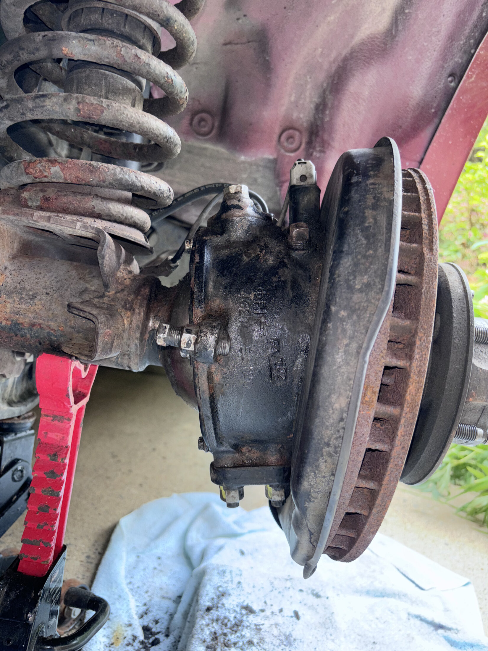

Ok in late May, I cleaned the Birfields best I could and posted pictures. Today I looked at them again with the car on stands and took photos. I am concerned one bolt on the drivers side is "wet" and on the pax side the ball is much wetter than the drivers side. Can anyone educate me? Car had 235k mostly highway miles, Birf's have not been touched.

Did you recently rebuild your front axle or just tighten up some bolts??
What you're looking at is not the "birfield" but the swivel ball that the steering knuckle rotates on when you steer. Birfield refers to the type of CV joint our trucks use which is located inside the swivel ball or end of the axle housing and the knuckle.
Seeing some grease on the swivel balls is not unusual, but if it smells like gear oil and starts dripping out of the knuckle past the wiper seals that's refered to (on the forum) as "Birf soup", a mixture of grease and gear oil which means gear oil is getting past the axle (shaft) seal.

I checked the torque on all the bolts and marked with paint sticks, two moved before the wrench "clicked." I have watched the videos. Real challenge for me is for work space I am limited to a narrow 1 car garage. Technically, we are not supposed to work on cars in the driveway----but I do it all the time.
My sense of smell is beyond limited, not certain I could distinguish diff oil and grease. I am just going to keep an eye on things for now.
The entire back side of ball should be a little greasy and oily. It's a "total loss" type lubrication system. The felts and wipes are there to keep the grease "contained" and not just flowing out all over, but you have to top off the knuckle ball with grease. I give mine about 35ML every 7500 miles, when I do all the other regular maintenance. Looking at yours, it appears you only have grease about half way up the ball, but it could be the lighting.
Grease, by its nature is an oil suspended in a carrier. When grease gets warm the oil flows out of the carrier and when it cools the oil goes back into the carrier. The drip of oil off the bottom of the knuckle bolts is totally normal.
