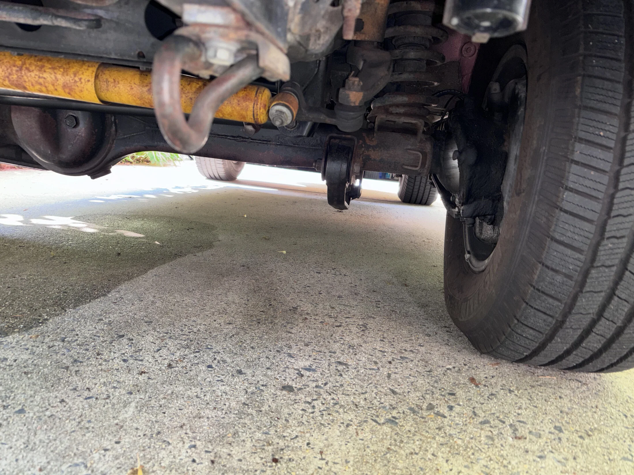

The car is about to be handed from the owner (my 90 year old dad) to my daughter. 1994 Series 80 with 234k miles and in fairly good condition. It spent 24 years garaged, now 6 outdoors. We are doing some work before handing it to her - essentially rubber brake, coolant and heater hoses. There are a few other issues that will get cleaned up.
One question is the Birfields. I have all the service records except perhaps 2-3 oil changed I did and there is nothing related to Birfields. Front bearing have been serviced every 30k +/- miles, no record on rear wheel bearings. No clicking.
Diff oil appears to be free of grease and the stuff in the Birfields looks about like the CV grease in my lexus. It is being topped up at every 3k oil change. Here is a exterior photo. Is there an obvious concern? Nothing has been cleaned to my knowledge.
I am willing to do them, just worried that I may be asking for more issues opening them up.

The birfield's themselves may be fine but I would recommend doing an axle service if it's been a while since the last one. Can check on the birfs during the service and get all new grease in there. Looking at the photos there appears to be greases caked up all over the knuckle.

If the bearings are tight, there's no clicking in turns and oil isn't running out onto the inner sidewall, I say leave it the heck alone.
If you're bored and it will make you feel better, open it up and have at the rebuild. The "first one" takes a weekend if you clean everything spotless as you go. It's not a difficult job, watch Otramm's video to be sure you have all the tools (basic stuff really) order the parts as a full kit (makes life much easier) and go to town, so to speak.

The owner would go with your first sentence. I would too, but the car is going 1,700 miles away to Denver. If I do it now, it i at dad's hourly rate but I can probably afford to pay. I am sort of assuming these Birfields were used on other older Toyota trucks and are not a unique Landcruiser item -in terms of finding a mechanic with appropriate skills out there. She is never going to do it herself.

Leave that Birfield till it needs it, and get a Gallon of Fluid Film (Amazon $45) and Astro Sprayer (Amazon $25) and go to town on that Surface Rust.
Confirm the Birf has Grease (Square Fill Plug at Top) and Change the Differential Oil.
Make sure you smell that Diff oil and Report back here.
See those 4 Bolts below the Eyeball?
Clean them with Brake Cleaner then Put on a Socket and Confirm they Tight.
Then Witness Mark them with a Paint Marker.
They Important-er than the BIRF right now.
