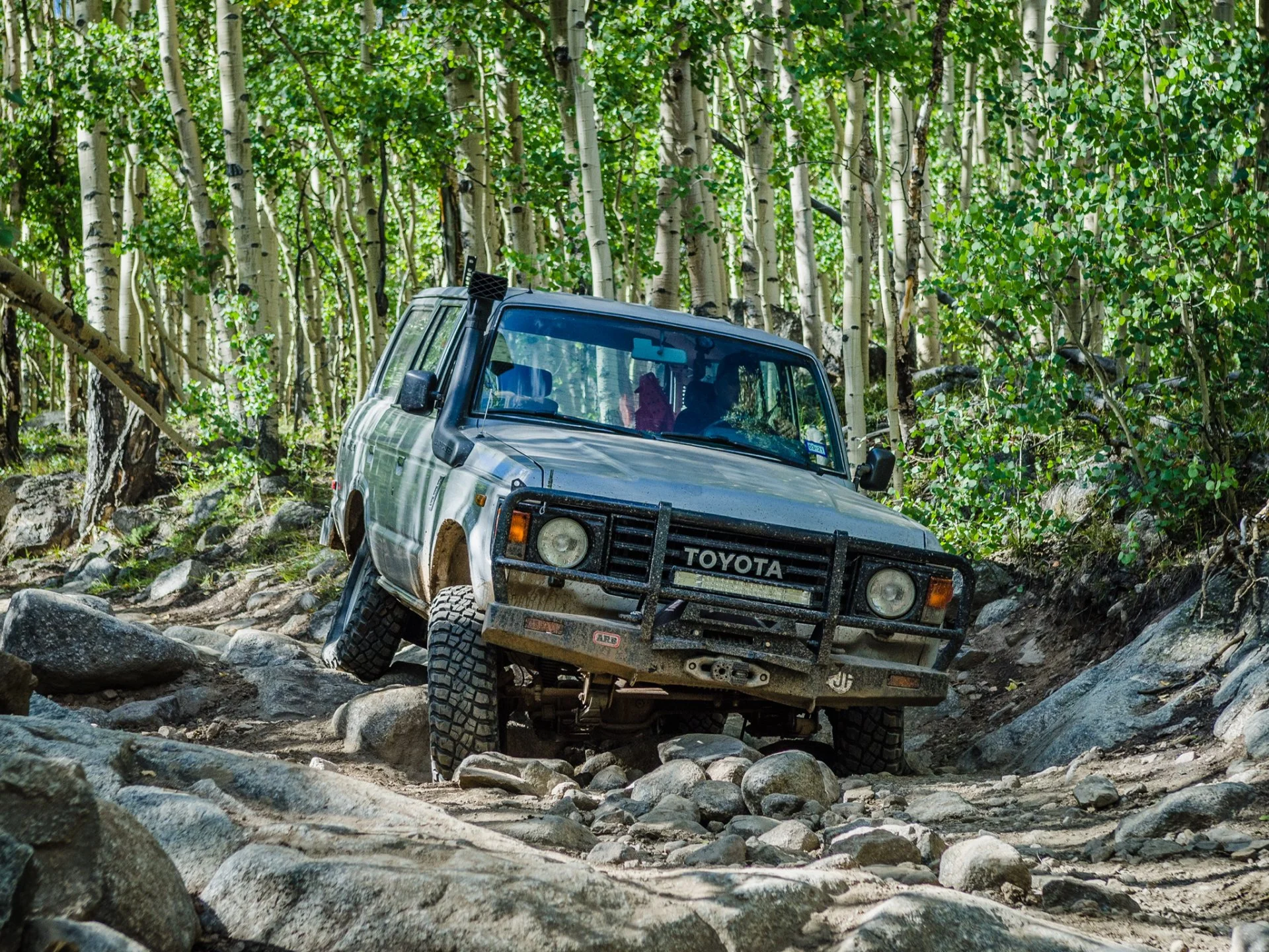

Go with the Bilsteins. I've been running a heavy/heavy OME setup on my FJ60 for 12-14 years, initially with the OME shocks. Swapped those out for Bilsteins a couple of years ago and the ride improved significantly.
Second example is a with our 80 series. I had it set up with OME stock height springs and OME shocks. Installed Iron Man coils and retained the OME shocks, the ride was ok. A few months ago pulled the OME shocks and installed Bilsteins and that dramatically improved the ride.

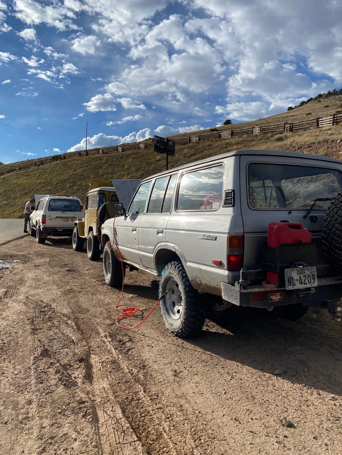

I’m running ome heavy/heavy with cs005 springs and it rides great.
I’ve done 100 miles of dirt roads in a day with no issues. It also flexs really well off road and I run my on road E rated tires at 50psi.
I’d use them again.

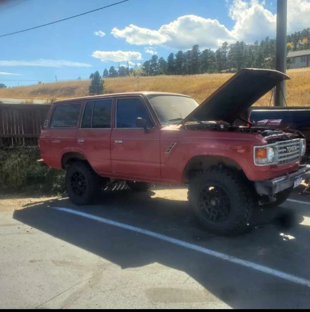

i'm loving my Bilsteins. Pretty sure @HemiAlex was instrumental in that decision. Please dont ask any spec or other pertinent info...bc im clueless.
