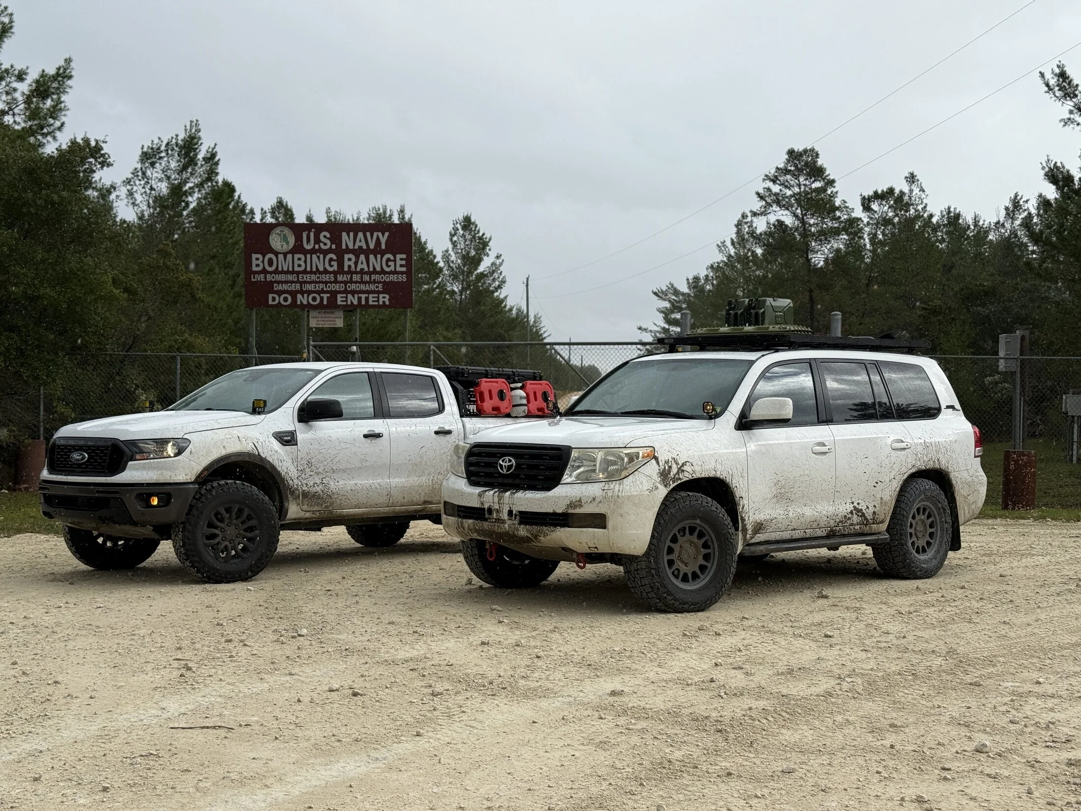

Got the brakes bled and some real measurements:
Front is on 3rd clip:
Measurements Before (no 3rd row, half tank of gas)
DF: 19"
PF: 19 3/4"
DR: 21 1/4"
PR: 21 1/4"
RAKE: 1 3/4"
Measurements After (no 3rd row, half tank of gas)
DF: 22"
PF: 22"
DR: 23 1/8"
PR: 23 1/4"
LIFT FRONT: 2.5"
LIFT REAR: 2"
RAKE: 1 1/4"
Im not concerned about the 2.5" in the front because the stock ones on there were worn and sagging and almost an inch lower thant newer 200s ive measured, guessing its closer to the claimed 1 3/4" lift as advertised, so shouldnt be an issue with stock UCAs. That, and there will be some settling.
Will shoot for alignment tomorrow and report back.

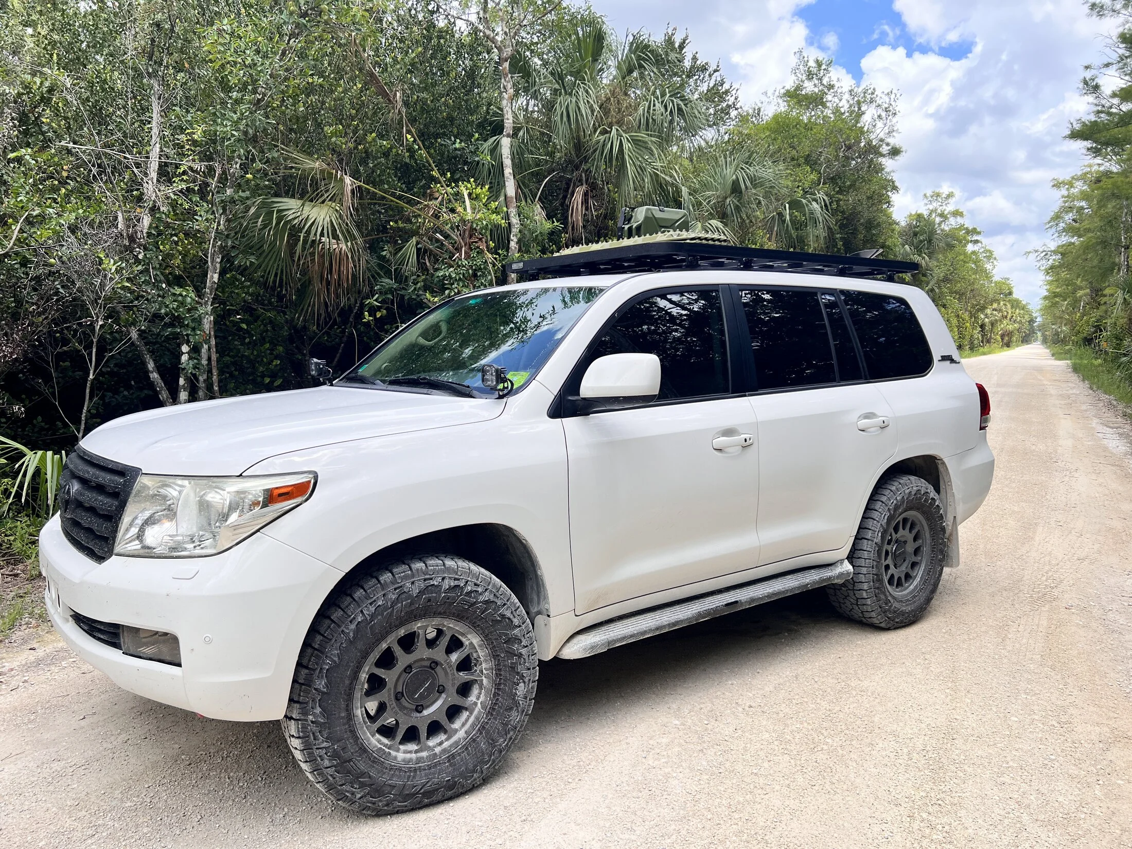

3rd clip.
Stock rear spings.
Front: 21.5"
Rear 21 7/8"
Old 275/65 Coopers.
Can't seem to get a good pic.
3rd clip.
Stock rear spings.
Front: 21.5"
Rear 21 7/8"
Old 275/65 Coopers.

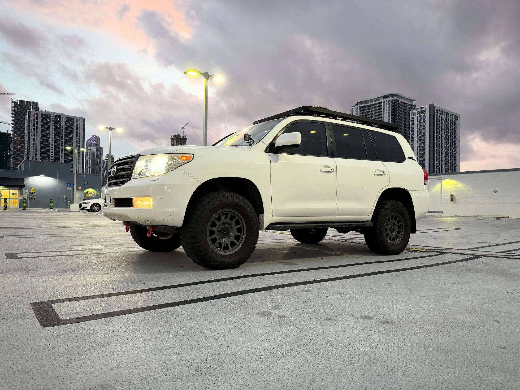

2021 HE no factory 3rd row. 5th perch up front, stock HE springs in rear with a 5mm coil packer. Tires are 275/70 R18 General Grabber A/TX. Ride is fantastic, I was worried that it would be harsh and take away from the factory plush ride, but it has been great. I wish I would have done it sooner.
Center of hub to bottom of wheel well measurements.
Stock-
FL- 20" FR- 20"
RL- 22.5" RR- 22.75"
After-
FL- 23" FR- 22.5"
RL- 24" RR- 24"
