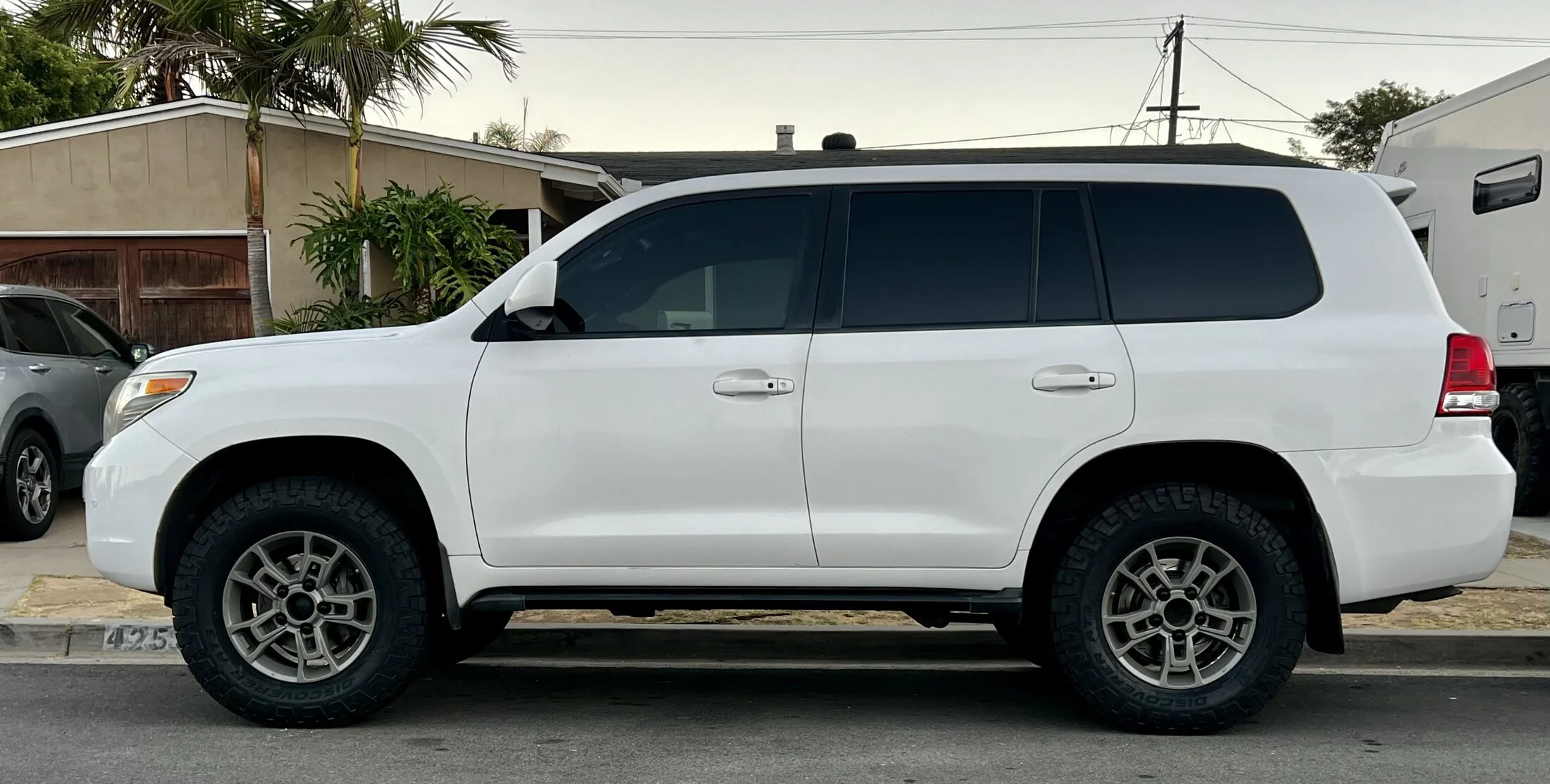

Do not regret it at all. When I have the whole family wife n 3 kids fully loaded for camping the OME levels out nicely with the front and no sag. Pic here is sitting empty and after 2-3 years on the setup.
What size tires do you have? How much rake do you have when the truck is empty?

22x9.5 wheels +30 offset with 275/50/22 Autturo ATS tires.
Ground to fender measurement is 38 front/ 38.5 rear.

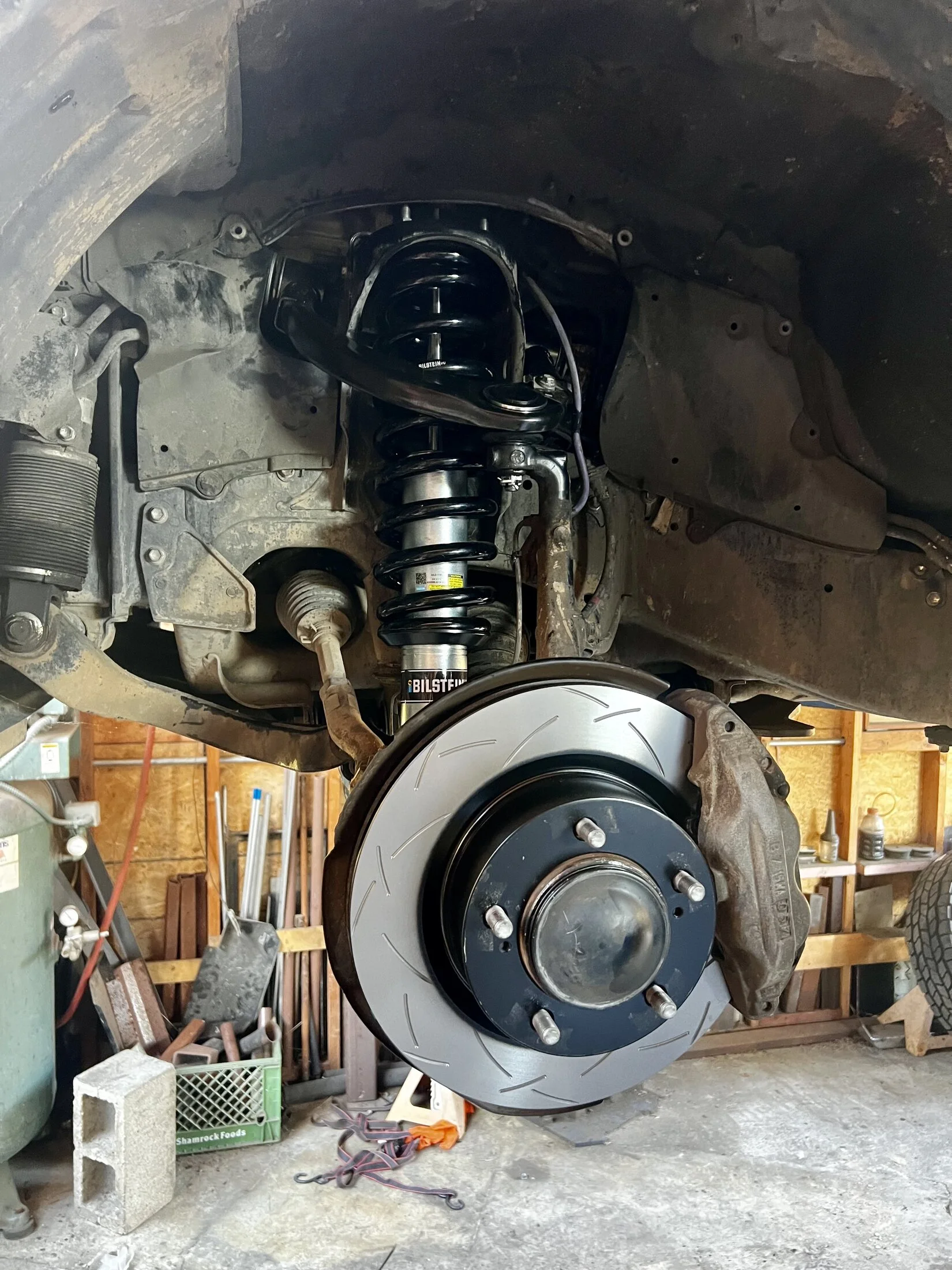

Got this all done and installed this weekend and replaced all control arms (LCA, UCA, Rear lowers, Rear Uppers) and all new sway bars links and bits at the same time.
Truck drives 10x better and the loose goosy wallowing feeling is completely gone, as is the front brake dive. Guessing the Bilstein kit AND replacing ALL control arms and sway bar bits factor into this.
Also installed the DR KDSS bracket and a new track bar.
Install of it all was fairly straight forward, but a few notes for the DIY folks. I’d rate it all a 3 🍌job

DBA rotors and Hawk pads installed as well, and brake feel is night and day better, but the rotors and pads I took off were totally roached, so anything would have been an improvement on that front. Still need to do a full flush and bleed, likely tomorrow.

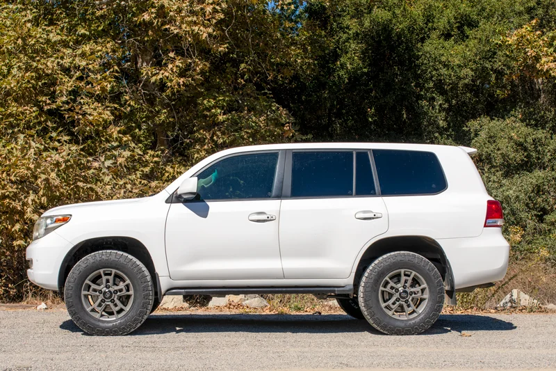

As per Internet rules, I’ve attached a few pics below. Too tired to find level spot for measurements, will do that soon, but looks close to 2” all around and kept factory rake, which is a what I was after.

Here is the bracketry that needs to be removed to access passenger upper control arm, trickier than it looks. Note: I flipped the bolt around so I don’t have to deal with this again if I ever has to come apart

Got the brakes bled and some real measurements:
Front is on 3rd clip:
Measurements Before (no 3rd row, half tank of gas)
DF: 19"
PF: 19 3/4"
DR: 21 1/4"
PR: 21 1/4"
RAKE: 1 3/4"
Measurements After (no 3rd row, half tank of gas)
DF: 22"
PF: 22"
DR: 23 1/8"
PR: 23 1/4"
LIFT FRONT: 2.5"
LIFT REAR: 2"
RAKE: 1 1/4"
Im not concerned about the 2.5" in the front because the stock ones on there were worn and sagging and almost an inch lower thant newer 200s ive measured, guessing its closer to the claimed 1 3/4" lift as advertised, so shouldnt be an issue with stock UCAs. That, and there will be some settling.
Will shoot for alignment tomorrow and report back.
